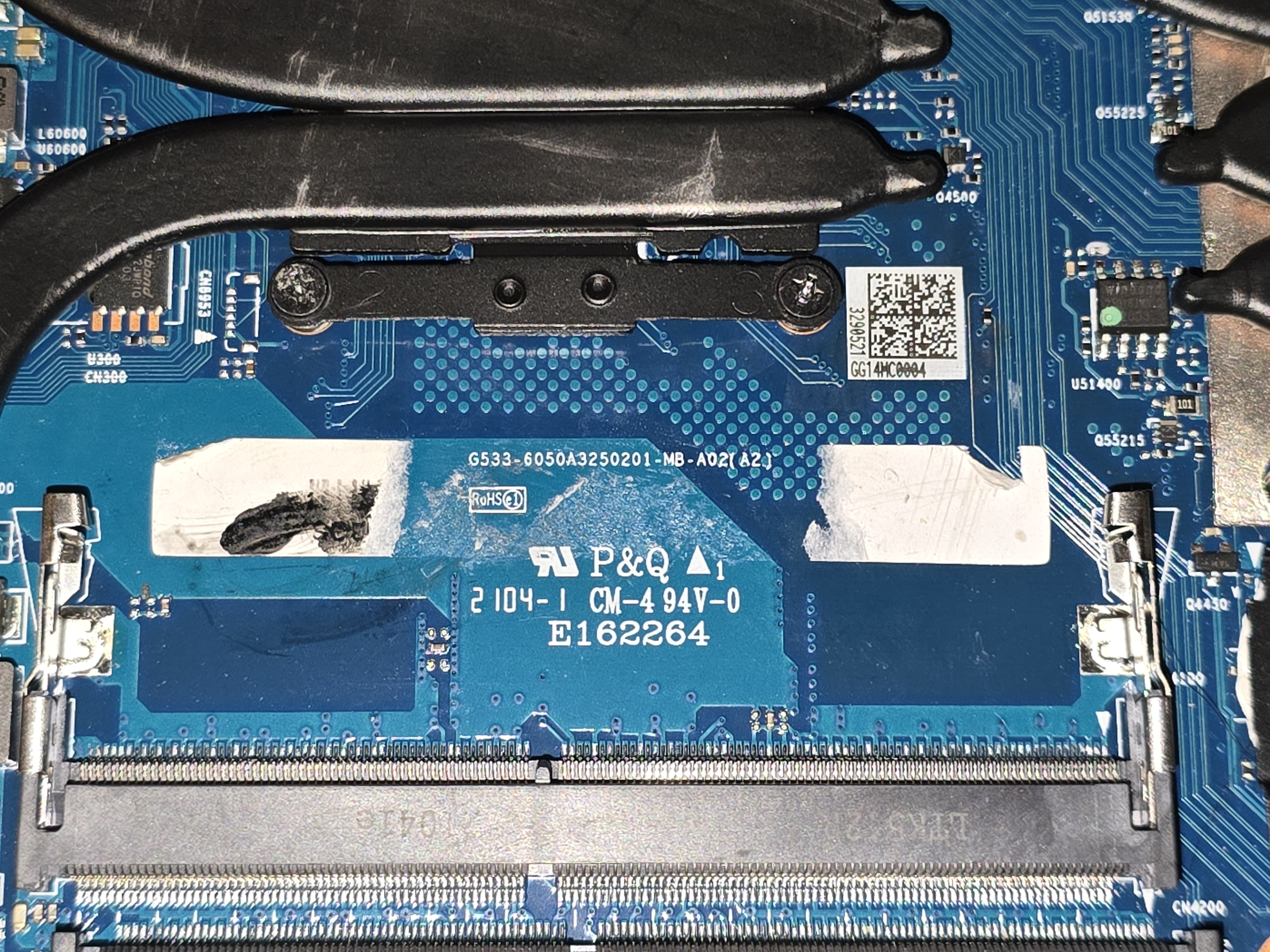

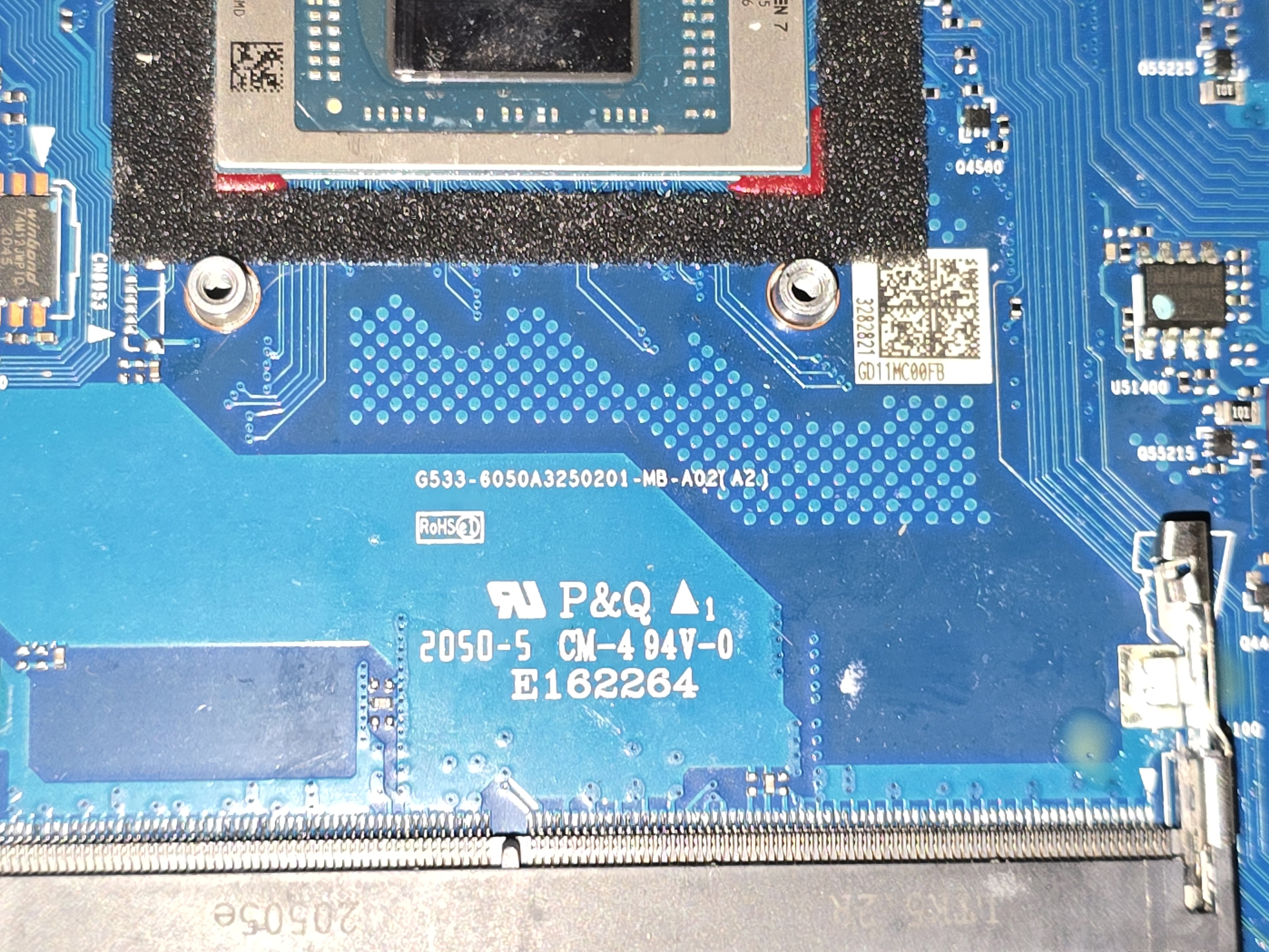

    There are extra keys on the G733QM keyboard compared to the G533QM , the keyboard mapping is different, the EC firmware will be different, so besides trying a different bios you might have to flash the EC with a programmer, if it doesn`t self-flash from the bios (if the EC is in the bios ?) Do both motherboards have the same EC and bios chip part numbers.
    Do both motherboards have the same model number and revision.

      Thank you for the information. I have had a look at the board that is in the laptop now and the old dead board. They both have the same name and model number (G533 - 6050A3250201 - Mb - A02(A2)). The G733 board (The one in the laptop that works) even says it's a G533 on the motherboard itself. I have attached pictures.

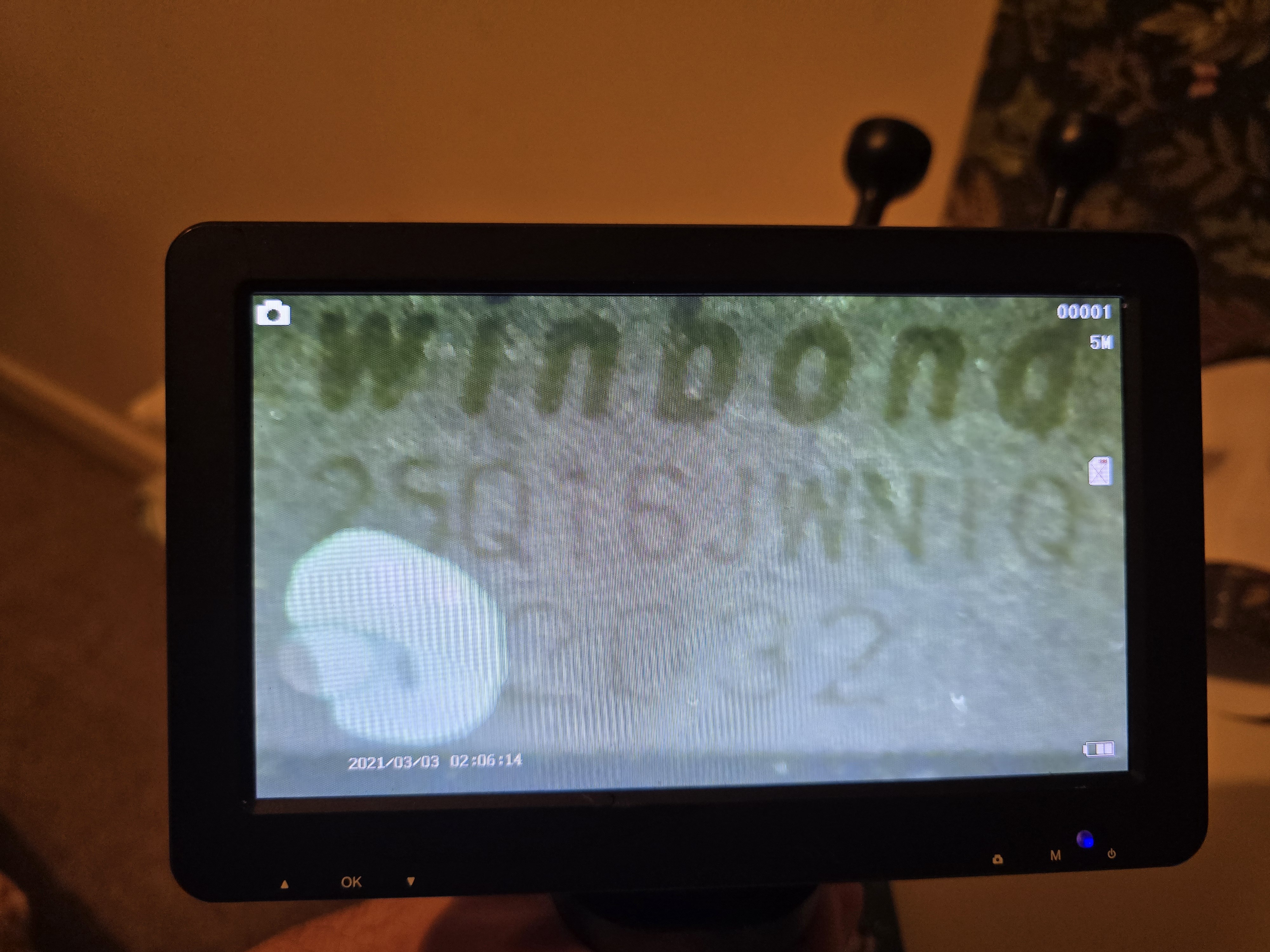

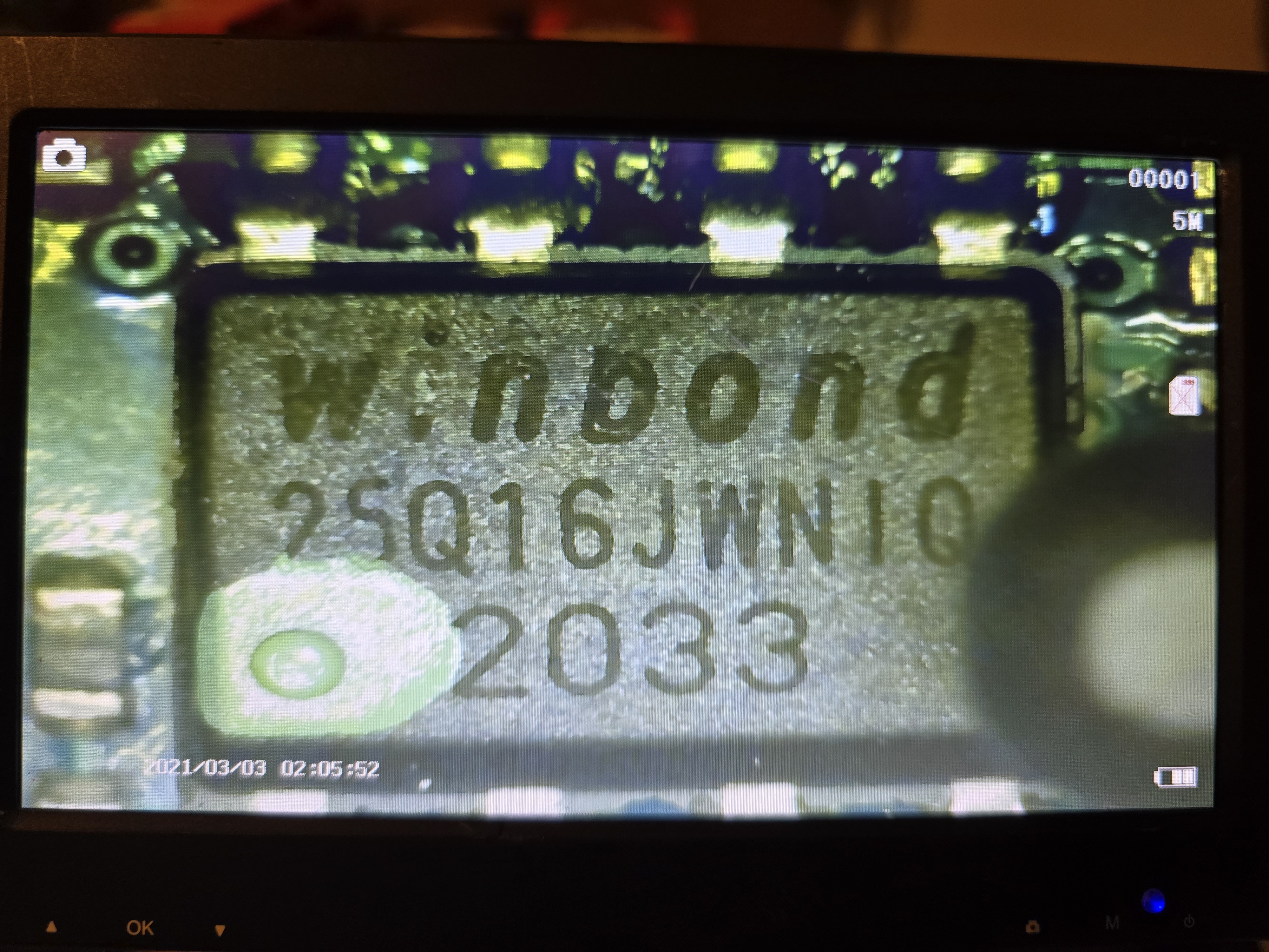

      I think that I have also managed to find the bios chip, but I am still new and not too sure if it is or not, but again both of the boards have the same chip and numbers. I have also attached pictures of the chip that I think is the Bios chip.
      Would it be safe to assume that I could try and flash the EC with the information/files from a G533 to make this board into a true G533.

        Just had a thought, if the chip that I attached in the previous comment is in fact the Bios chip for this board, would I just be able to de solder it from the original board and then re solder to the new one and see if that would work from there, or would there be other chips that have to swapped over too.

          So I took the Bios and EC chip off the old motherboard, and transferred them to the new motherboard and the laptop would power on (keyboard lights and activity lights, however it would not post or display anything. Would there be another chip related to a bios change as I have just reverted back to the original EC Chip to be able to somewhat still use the laptop.
