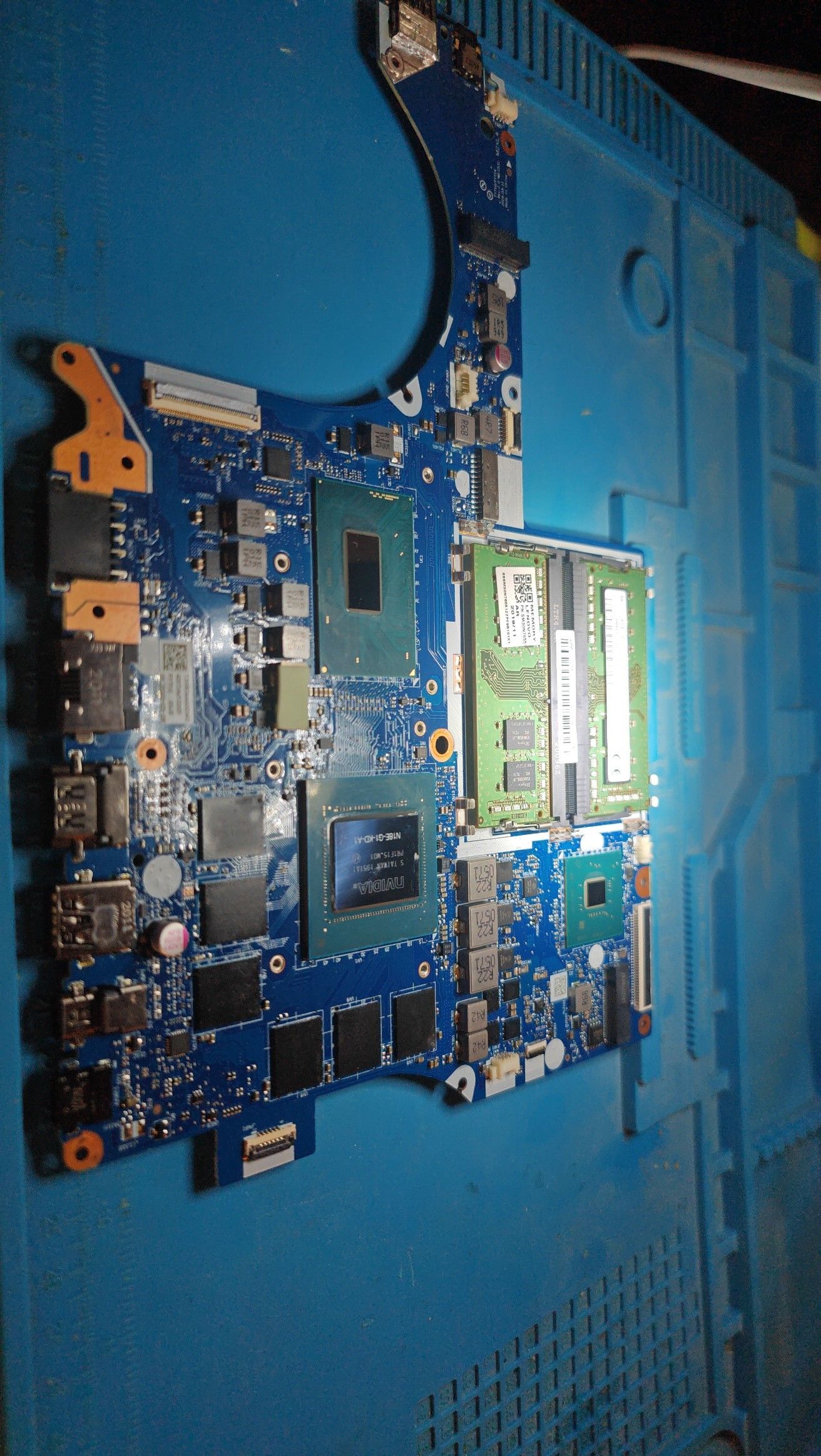

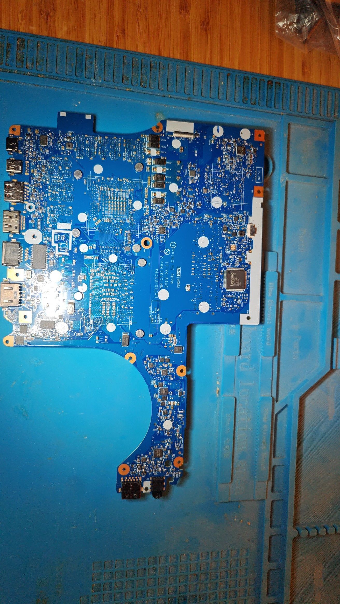

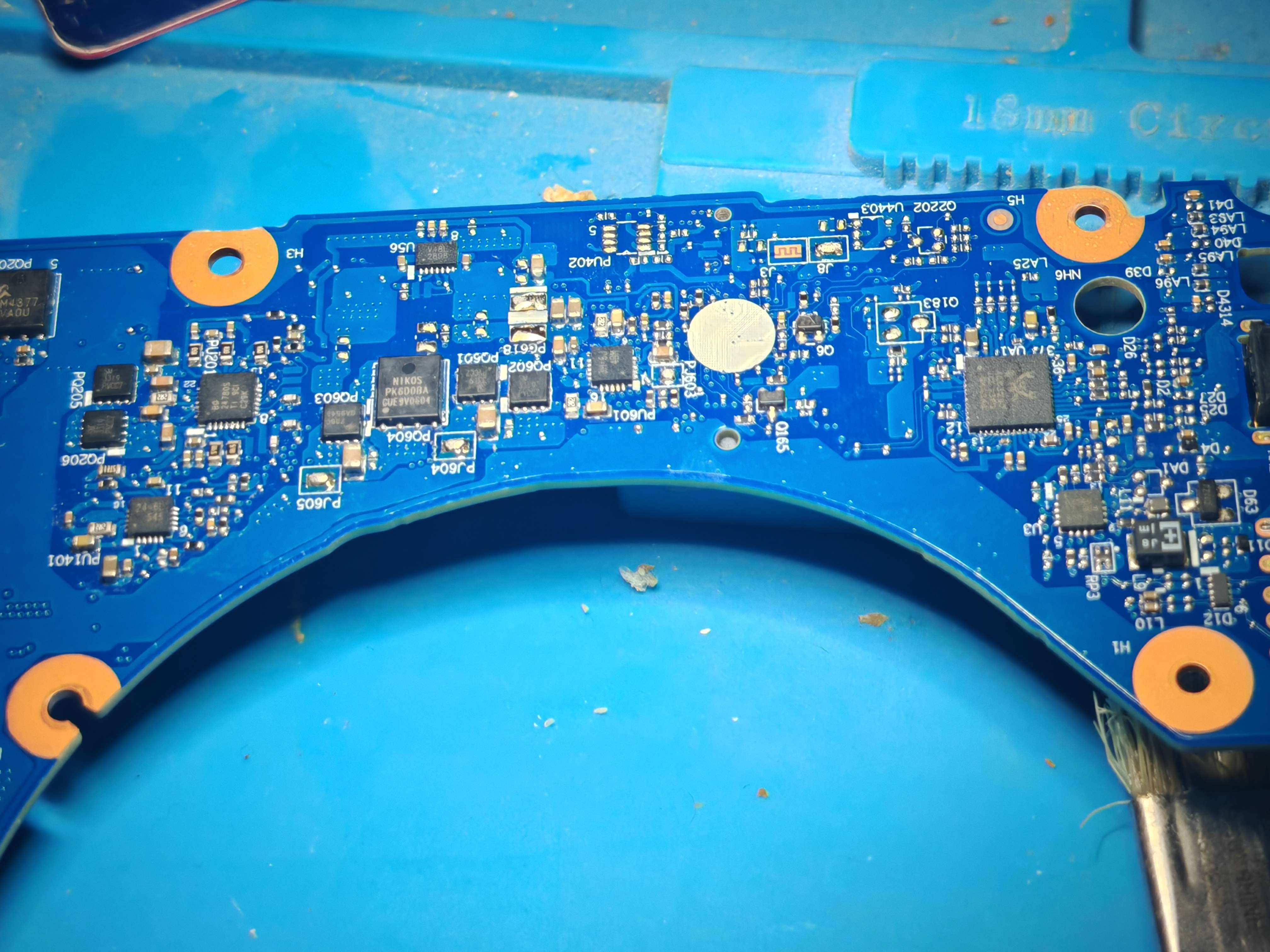

    Hi everyone 😀,
    I'm here today to ask for help with repairing the motherboard of a Lenovo Legion Y540 17IRH.
    To give you some context, I'm passionate about computer repair so much so that I've invested in a lot of tools and started practicing on dead and old hardware. I've been learning how to solder and desolder components, mostly focusing on phone repairs.
    Recently, I bought a broken Lenovo Legion Y540 17IRH for just €150, and there are two main reasons why I made this purchase:
    1. I already own the exact same model, but its plastic chassis is badly damaged. Replacing all the parts would easily cost me around €250. The one I just bought, on the other hand, has a perfectly maintained chassis, so I figured it was a great opportunity to rebuild a fully functional laptop.
    2. The second reason is that the motherboard is dead, and I saw this as the perfect chance to start exploring laptop motherboard repairs something I've been wanting to learn for a while.
    Symptoms 🤧:
    The laptop doesn't power on and shows no signs of life, even with the charger plugged in. I tested the charger and it's working perfectly. I don't know the full history of the laptop, so I asked the seller. He told me he had taken it to a repair technician, who said the motherboard was burnt. That's all I know for now.
    From my side, I've started inspecting the motherboard, but nothing looks burned or damaged nothing obvious to the naked eye or under the microscope.
    I tried doing some multimeter tests, but I quickly realized I didn't really know what I was doing 😅. I just knew that I had to put the multimeter in continuity mode (the signal icon) and check if components beep when I touch them with the black probe on ground and the red one on the component (that's how basic my understanding is!).
    (Of course, I didn't plug in the charger during the multimeter tests I know enough to avoid that kind of risk.)
    I'm fully equipped to work on it. I have:
    • A trinocular microscope
    • A GVM T210 soldering station (really solid station)
    • A hot air rework station
    • A multimeter
    • A lab power supply
    • All the necessary tools like tweezers, screwdrivers, glue, air blower, cleaning brushes, etc.
    I'm creating this post to learn as much as I can about laptop motherboard repair and hopefully bring this one back to life (so I can give my old one to a family member).
    If you need any additional info or pictures, feel free to ask.
    I'm hoping to get as much help as possible from this post 🙏

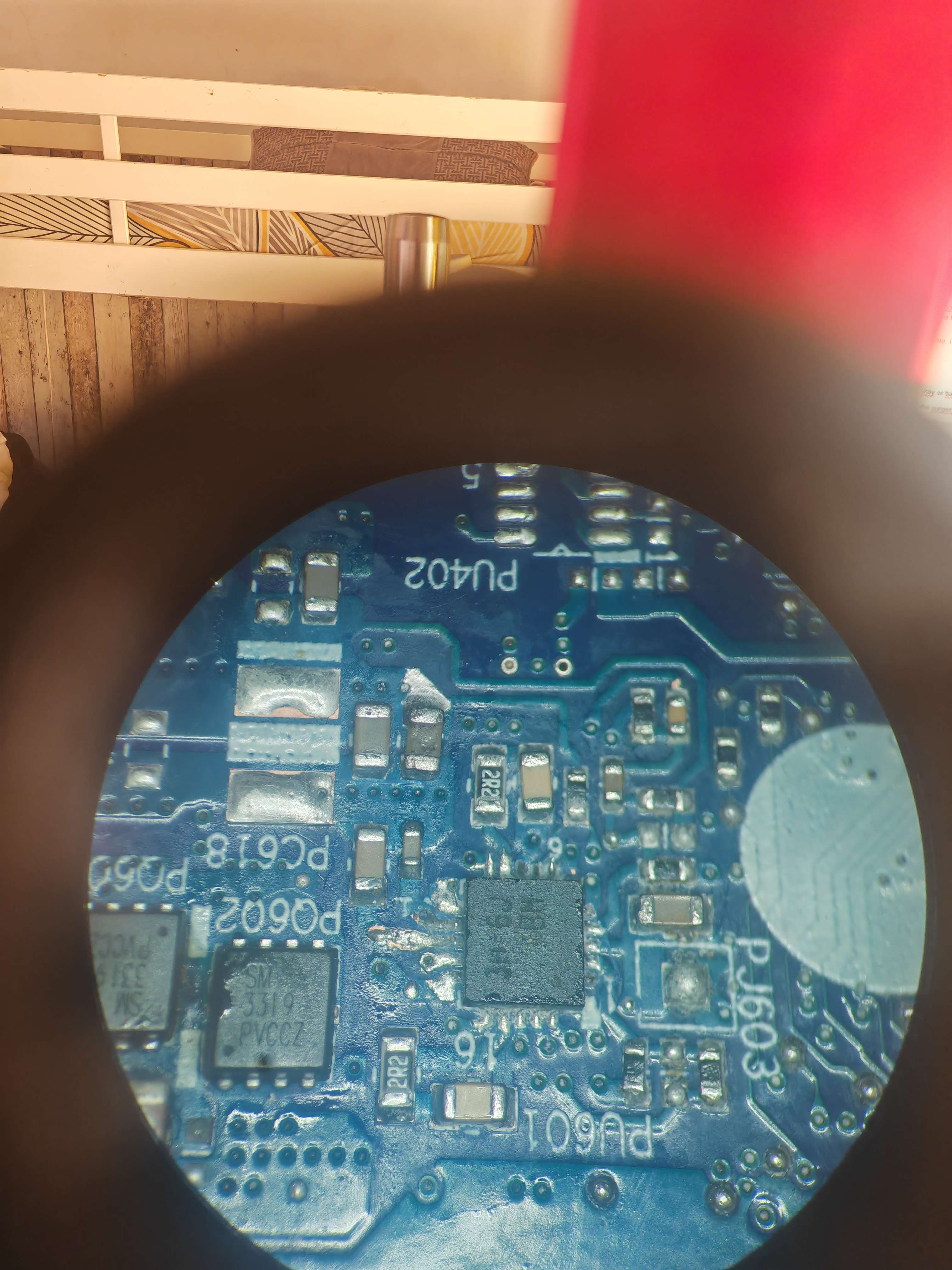

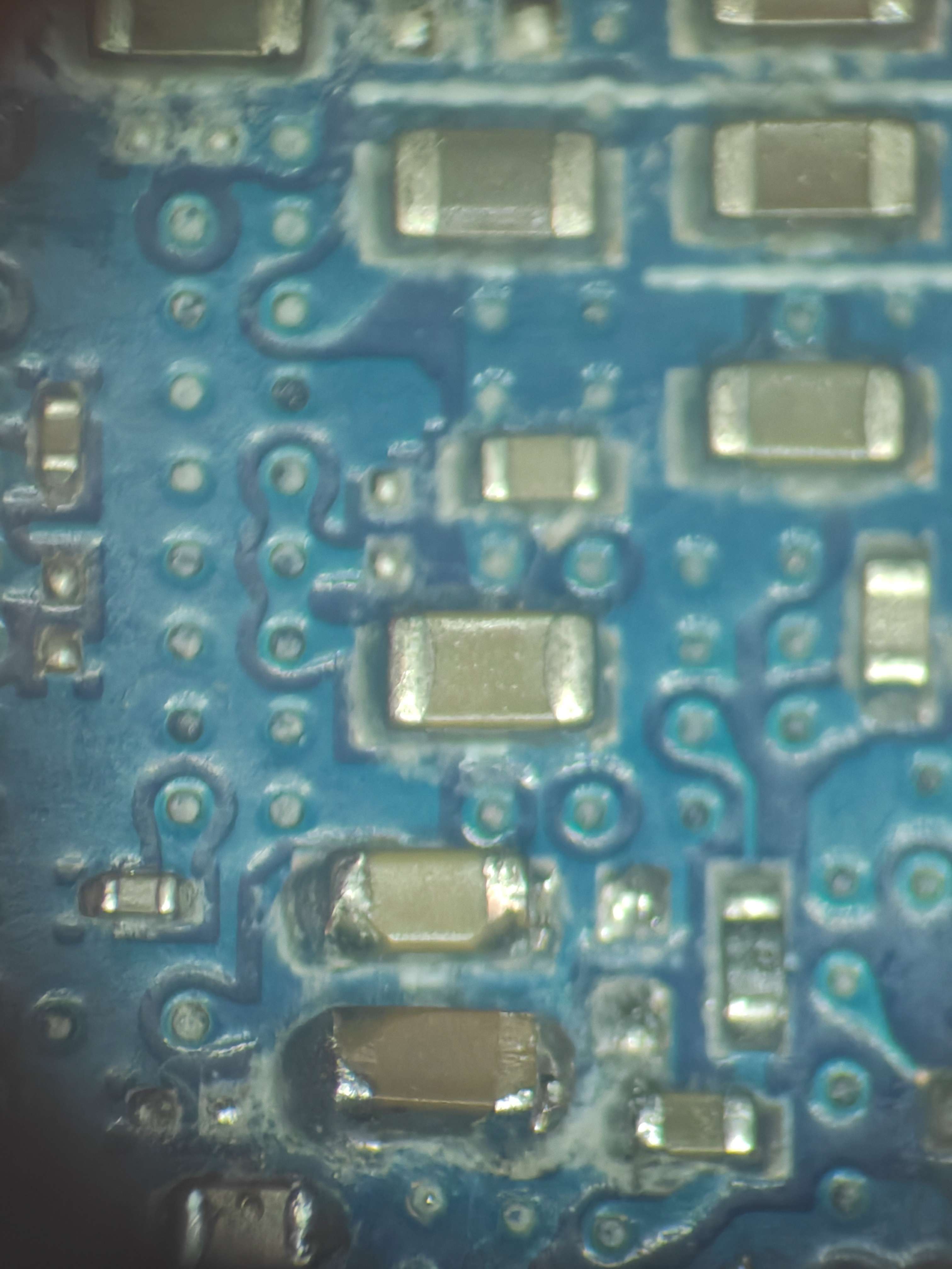

    After some youtube videos i found something : with 95° alcooI i found this component which heats up and is close to the main power control chip (the BQ24780S on this model) according to the schematic of the similar model (the y540 15irh) that this chip is a 5v-3v control chip.
    So now i want to know what to do to know if the issue is the chip itself of the component aroud (capacitor ? resistor etc...)

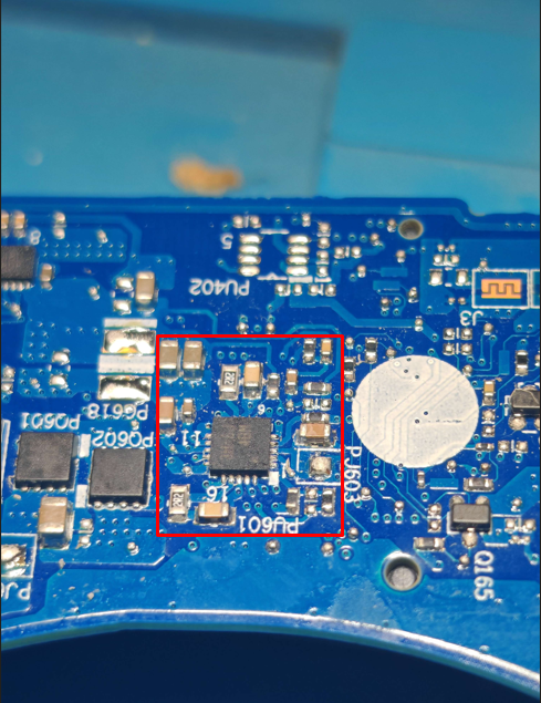

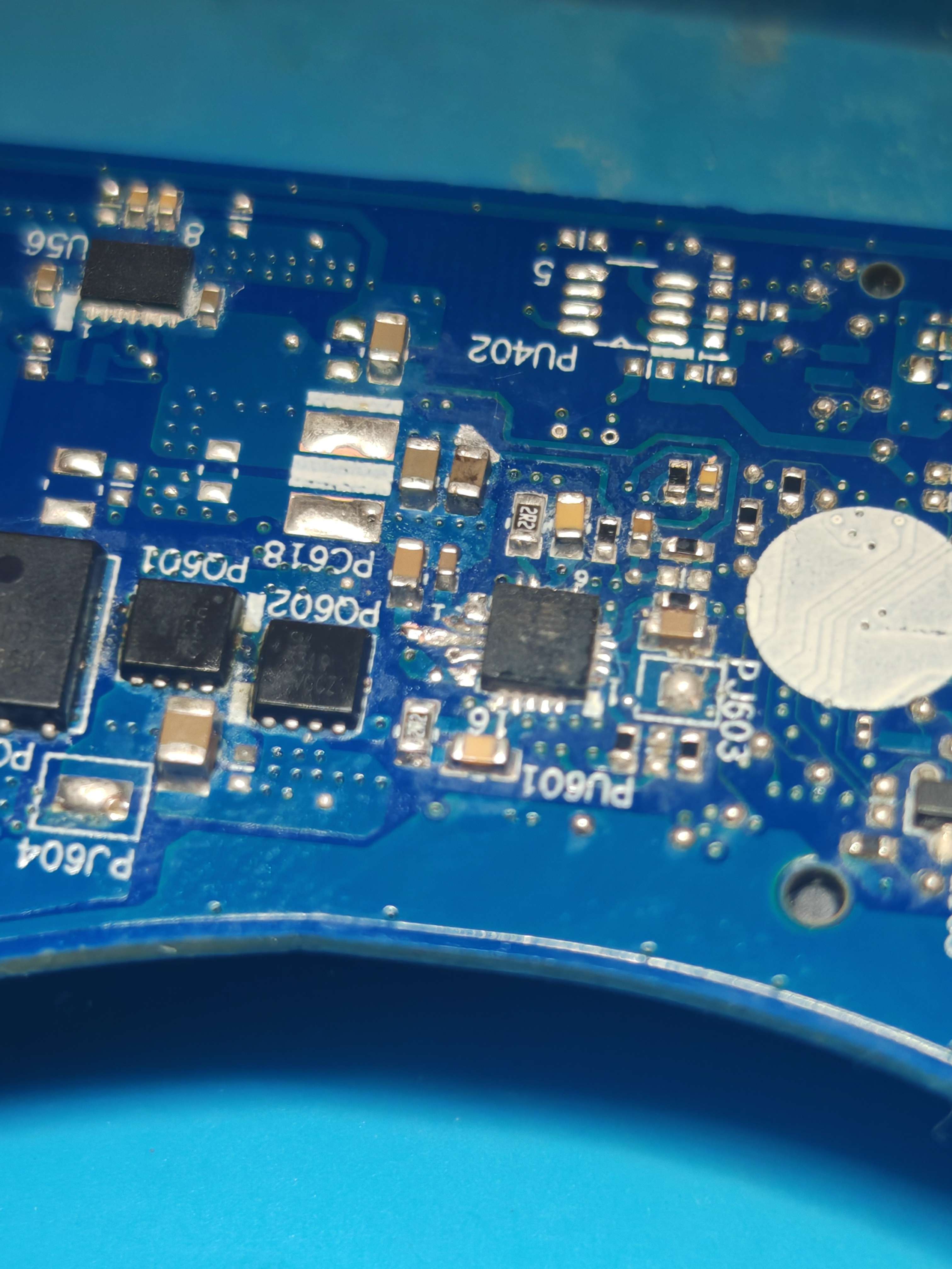

      Schematics here https://www.badcaps.net/forum/troubl...arview-request
      Board view I haven't found an exact match, the NM-C221 may be similar, post#5
      https://www.badcaps.net/forum/troubl...rh-boardviewer
      3H=** = RT6585B
      It could be the one of the outputs of that IC that's shorted, measure resistance to GND on
      +3VLP, pin 13, there's a suitable cap connected to it PC603, and a solder blob jumper PJ603
      +5VLP, pin 3, there's a cap connected to it, PC601
      +3VALW, on a coil connected to pin 8, PL602 on the top side of the board, close to the wifi slot
      +5VALW, coil connected to pin 18, PL601, to the left of PL602

        In the meantime, I tried to remove the chip that I thought was at fault but the short circuit is still present and I'm afraid I've made the case worse (the chip heats up for a tenth of a second then nothing) and while trying to remove the track from the dead BQ24780S chip I took measurements and it displays 20.6v on the first 3 pins, 26v on the 4th pin, 0v on the 5th pin, 2.9v on the 6th pin and 0v on the 7th pin, I don't know if it's normal so I unsoldered it to try to measure the values ​​without the chip and this time I have 20v only at pin 1 and 28 and 0 in the others except the 6th pin which still displays 2.9v

          Put back the BQ24780S, it's not dead (yet), it was doing it's job... Check the schematics
          Did you measure resistance on those pins where the 3H chip was? Don't solder this one yet until you confirm the resistance values (don't apply power to the board)

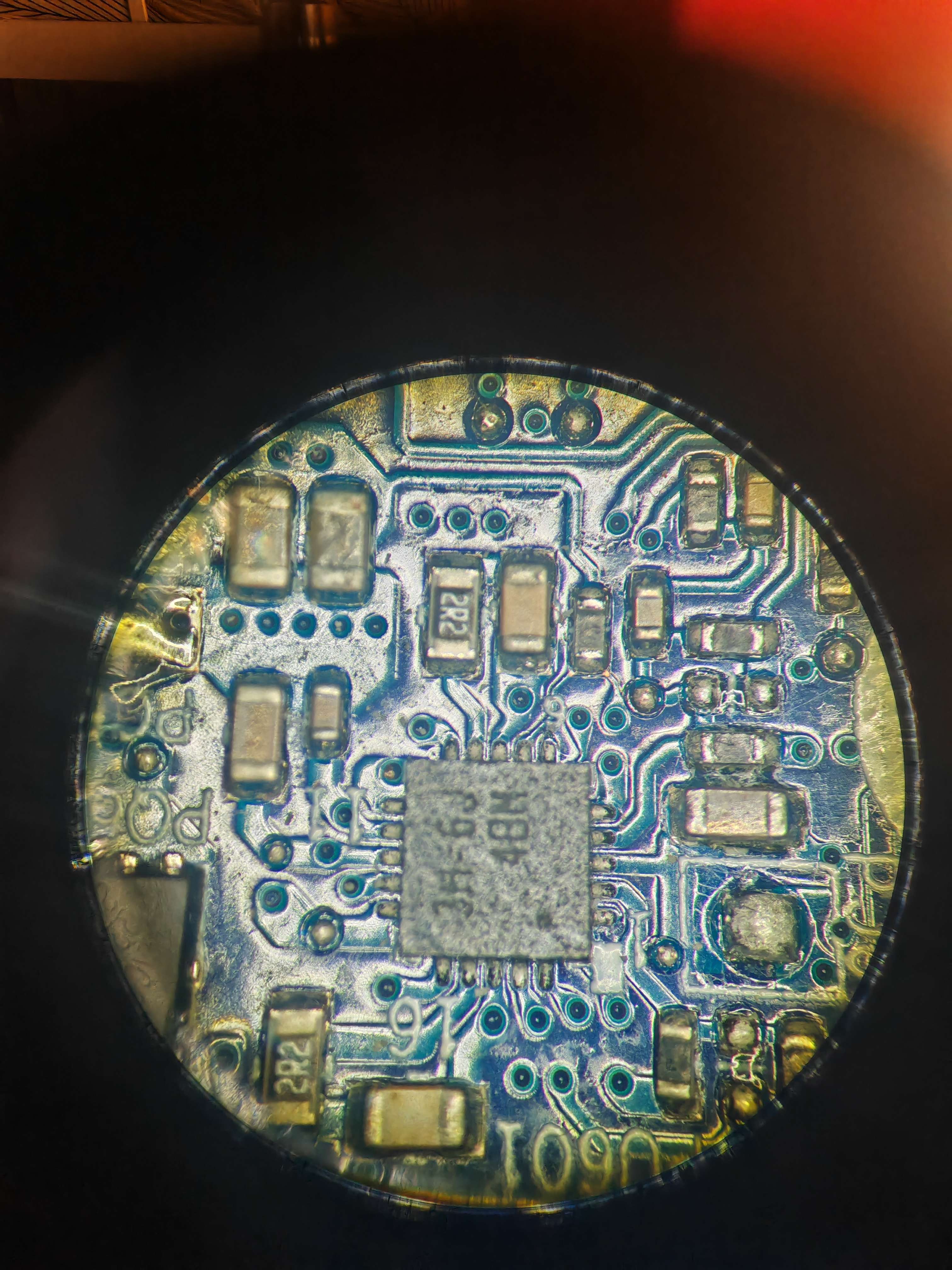

                    • Yes, I removed the RT6585B (PU601) after noticing that it was heating up significantly as soon as I plugged in the charger. It was no longer on the board when I took the last measurements.
                    • The BQ24780S is still in place, and I never observed it getting hot. It does deliver 20V to pin 28 (VCC).
                    • Voltage readings on the other pins of the BQ24780S (with the RT6585B removed) showed mostly 0V or 0.3V, except for pin 6 which read 2.9V.
                    • I now understand that powering the board without the 3V/5V regulator in place is a big mistake. Thanks for the warning I won't do that again.

                      i already solder it after i desoldering it the last time. i tested them :
                      • +3VLP (via PC603 / PJ603),
                      • +5VLP (via PC601),
                      • +3VALW (via PL602),
                      • +5VALW (via PL601).
                      ​and they all bipping after i mesure them , it is okey or bad ?
                      PS: i added image of the bq47 and rt658 after the surgery 😭

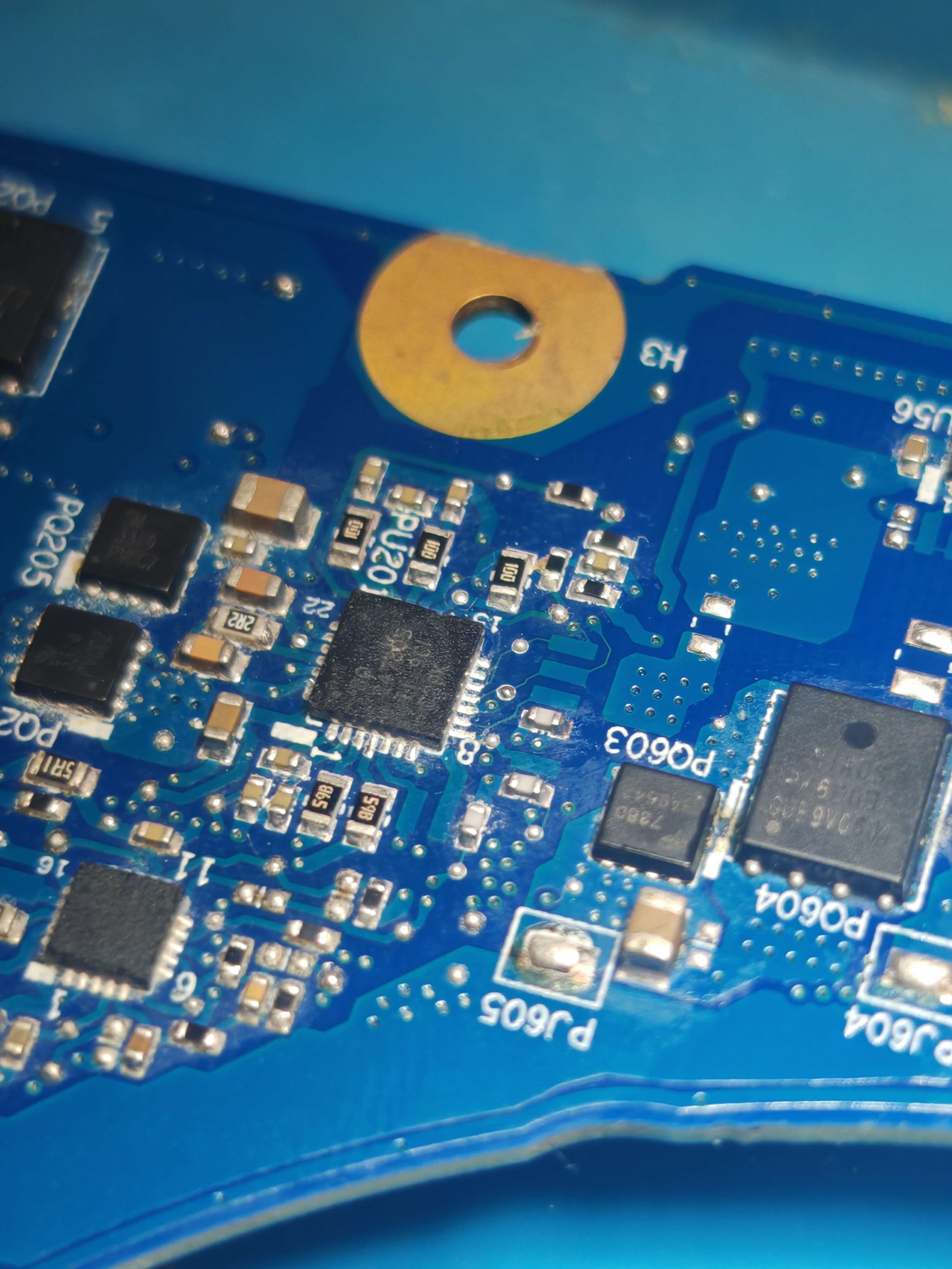

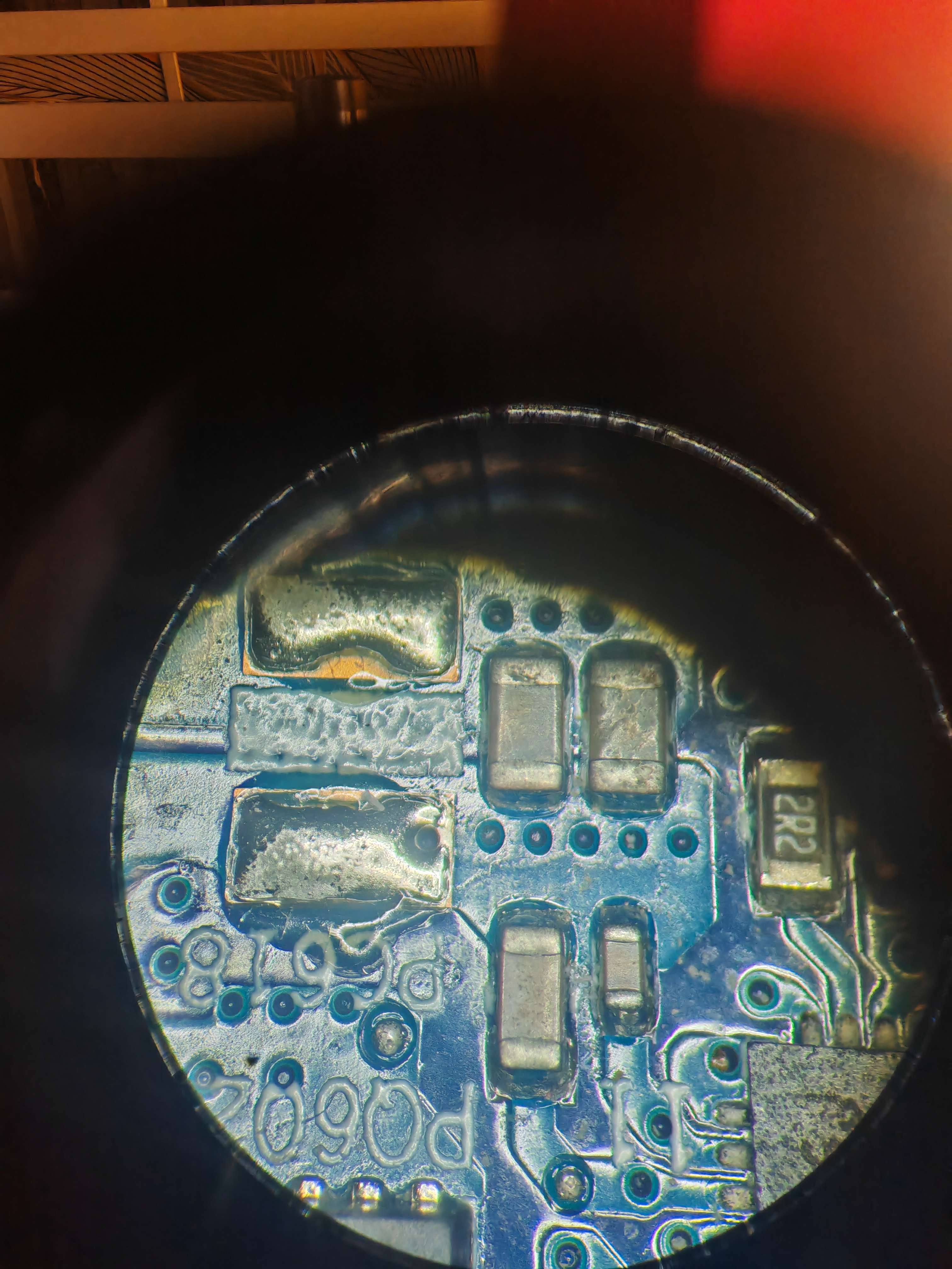

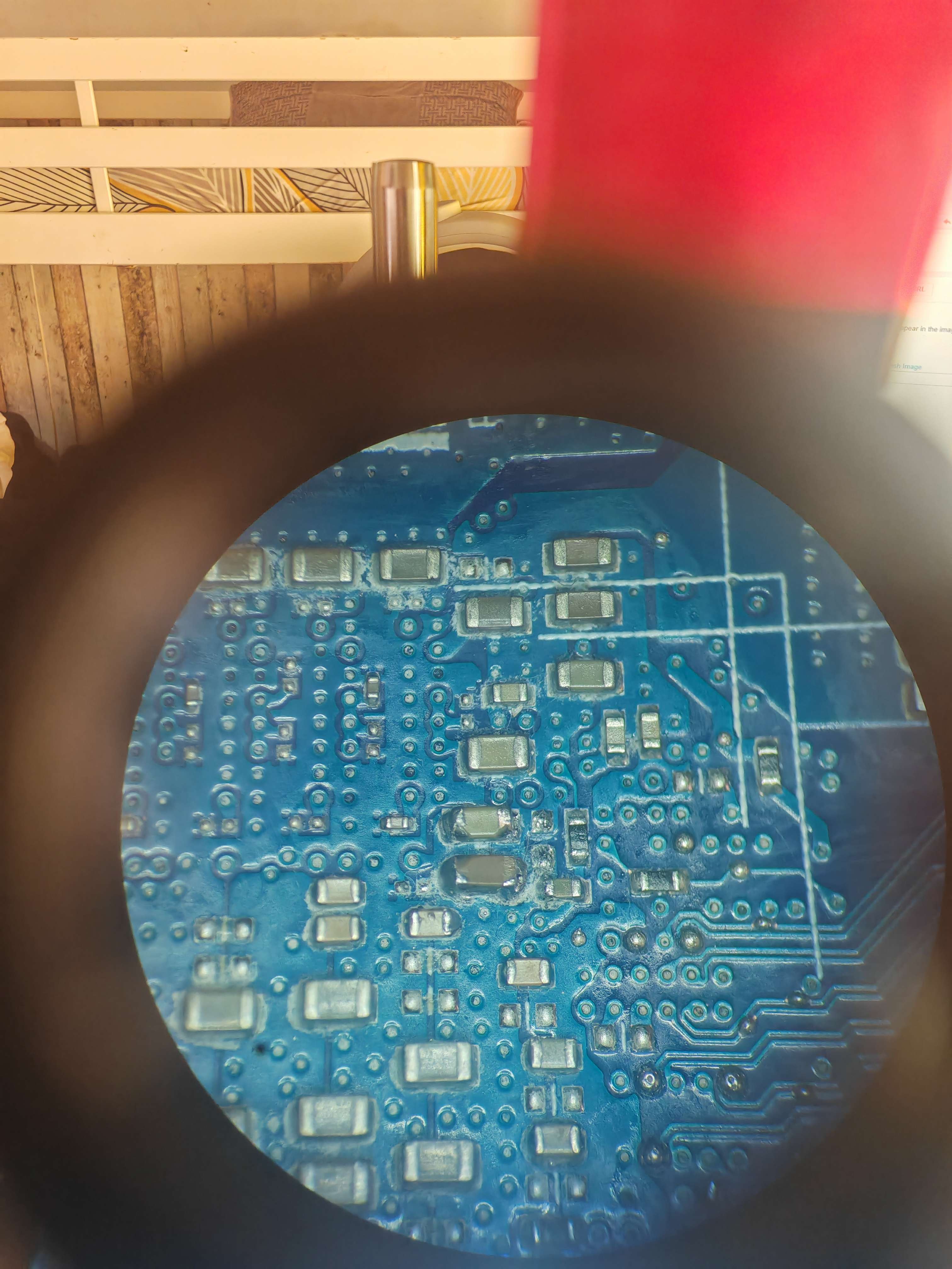

                        oh, i forgot to show you something. During my surgery with the rt685 chip, i accidently destoyed some coil under the cpu and put them back , are they still living or are they death ( i plugged the charger to test the rt685 chip after resolderind those coil )
