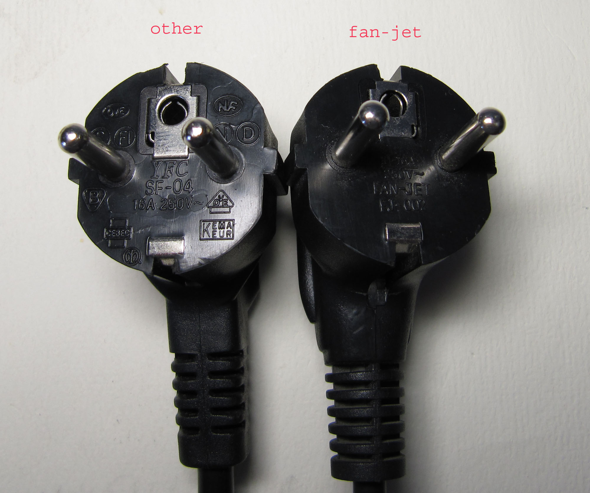

    Ok, this is getting very irritating...
    I have a bunch of computer cables and lately I had 2 of them suddenly catching fire!
    My explanation is that 1 of the 3 wires got very thin or was completely cut and then it made sparks and melted the plastic.
    This is very dangerous because if the cable is sitting on a carpet or wooden floor it can start a big fire and.... burn the house...
    Does anyone have a similar experience?
    I found out that those cables usually have several logos and marks on them and some technical info I am not familiar with. The cables that caught fire have only the name of the company Fan-Jet Enterprise Co. LTD, model names FJ-002 FJ-013 and the typical cable rating 10-16A 250V~.
    Do you think I should toss any FAN-JET cables that I have, even if they still work (and haven't caught fire)?

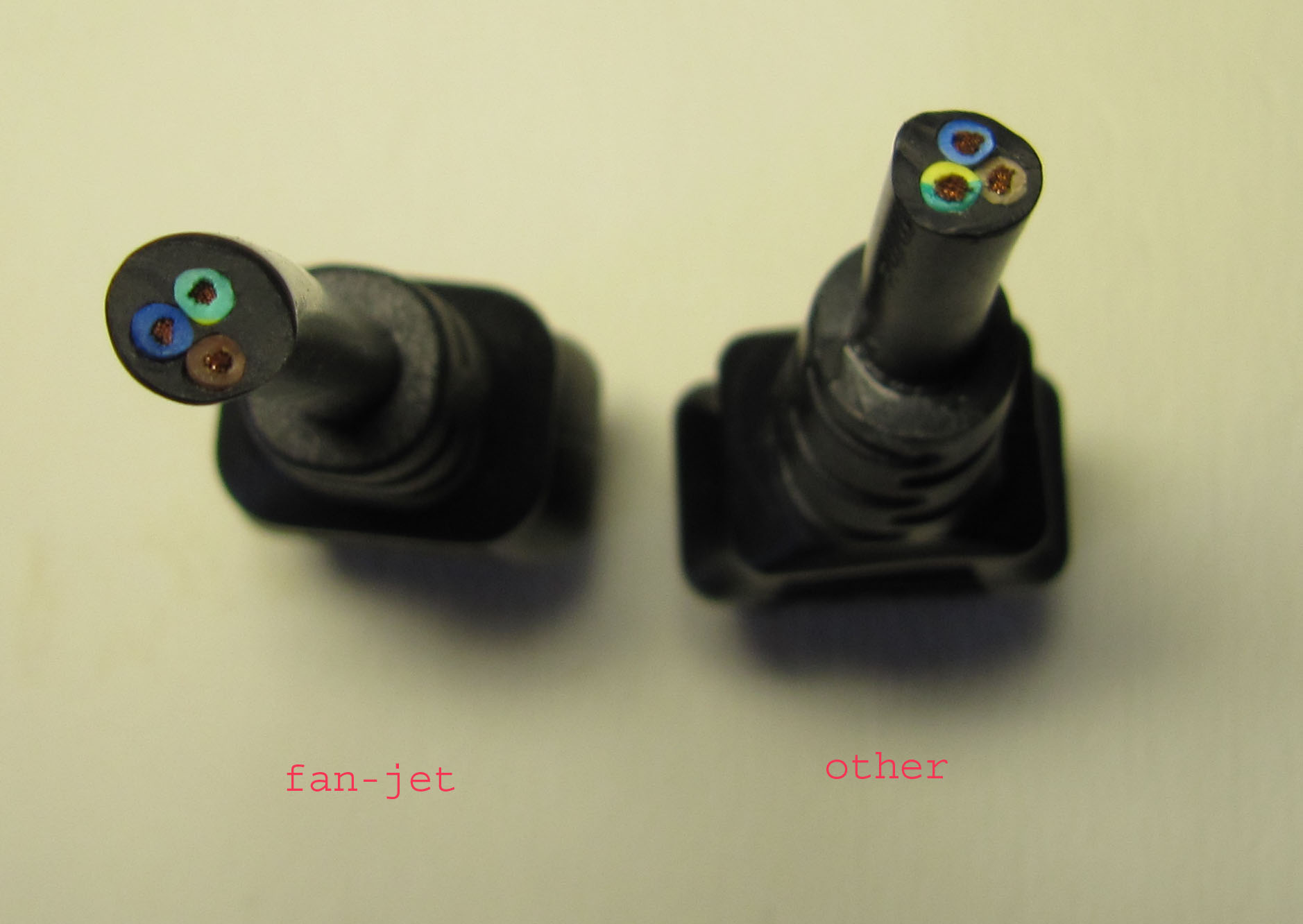

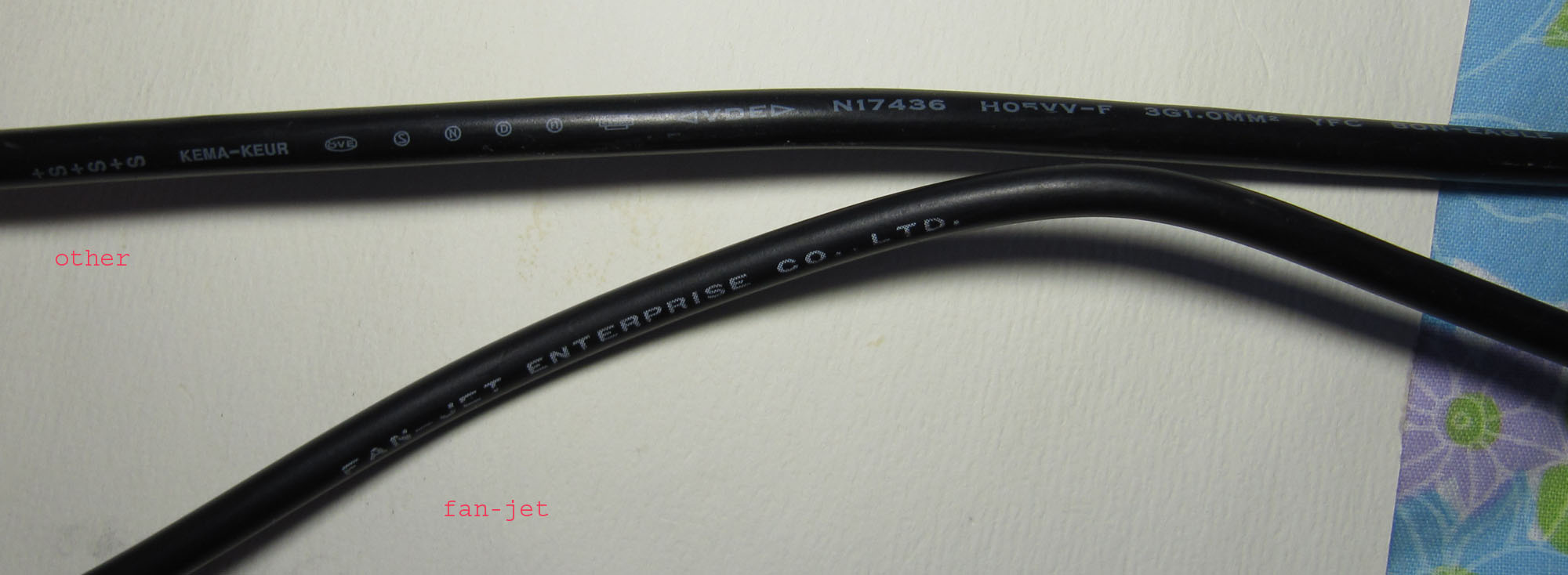

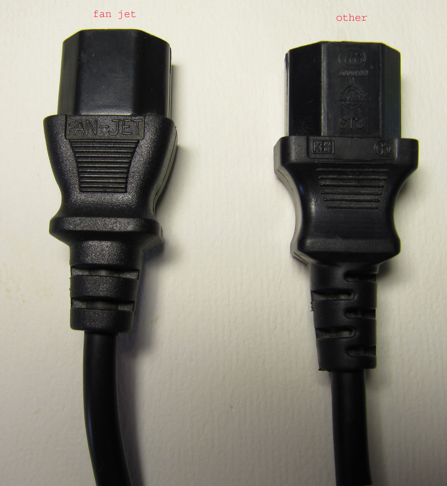

                Re: Fire starter PC cables
                Here are the photos... I put a random power cable near the jet-fan to compare...
                Notice the complete absence of logos and specs/ratings on the cable, socket and plug of the fan-jet.
                Other than that, I cannot find anything strange.
                  Apart from Fan-Jet, I've seen two other types of counterfeit power cords. One was branded "DHT Electrical" (for the record, their AS plug has the L/N closer to the outside edge than the E ), with fake ratings (I don't remember what they were) and one was completely unbranded, with "18AWG" and "6-10A" markings. Before I knew they were fake I left two in use at someone else's place. Better go and hunt them down, before something terrible happens .
                    The Fan Jet cable does seem thinner than the other one.
                      Also note the gap between the L and E wires in the Fan-Jet - unlike the neatly bundled wires in the real power cable. The Fan-Jet is actually about the same overall diameter as a real cord of type H03VV-F 3G 0.75mm².
                      This does look like a serious safety hazard. I'm glad you made the thread goodpsusearch - have to make others aware of the problem. To some extent they get away with crappy construction because PCs generally only draw about 150-200W. Of course it's only a matter of time before someone plugs a kettle into one of those...
                      I can bet that there would be a LOT less fires if strict quality standards were enforced on electrical equipment. I just thought up a good way to test IEC leads for safety - wire up a small electric heater with a C14, and insert the lead under test in the middle. If the lead goes poof, you have your proof.
                                        Looking at the picture of the plugs above the copy ones have no safety marks so I would put them in the rubbish where they belong and get supplies from reputable sources in future and always disconnect plugs from the mains when not in use?
