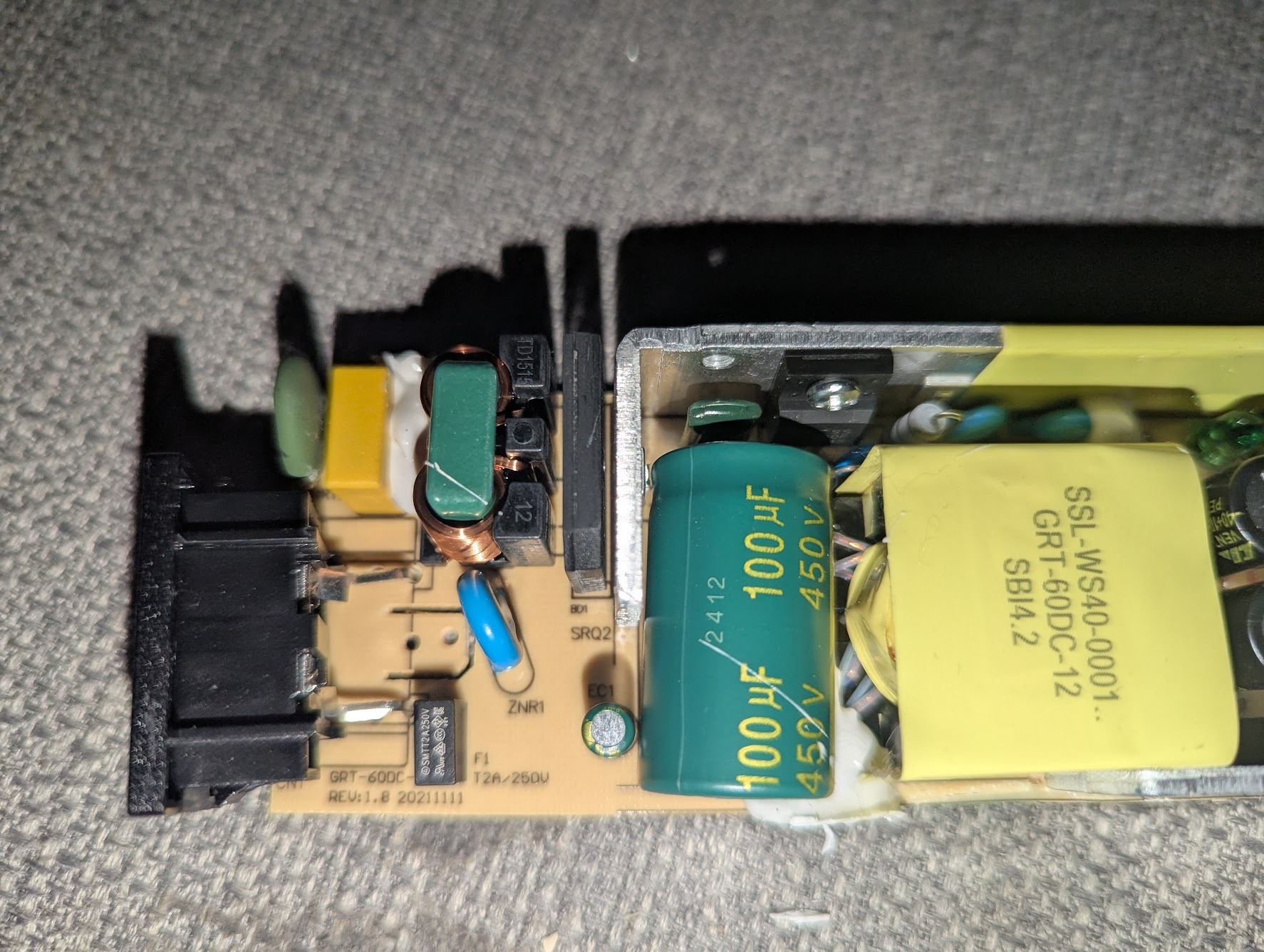

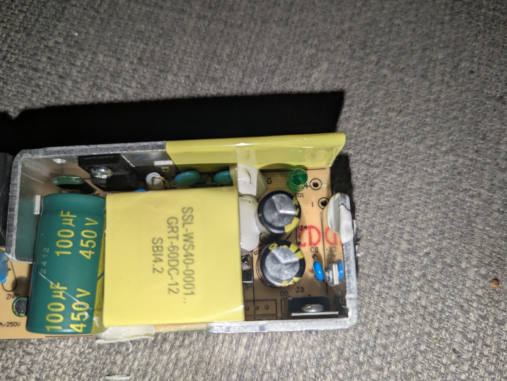

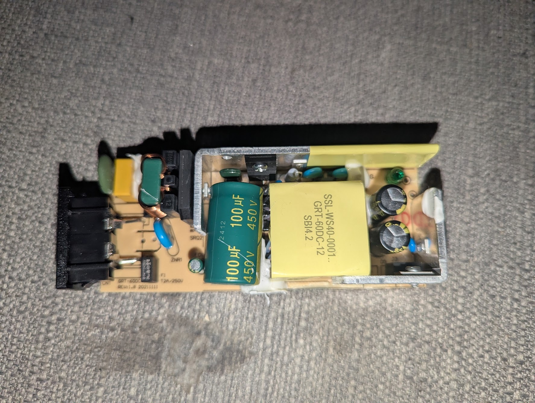

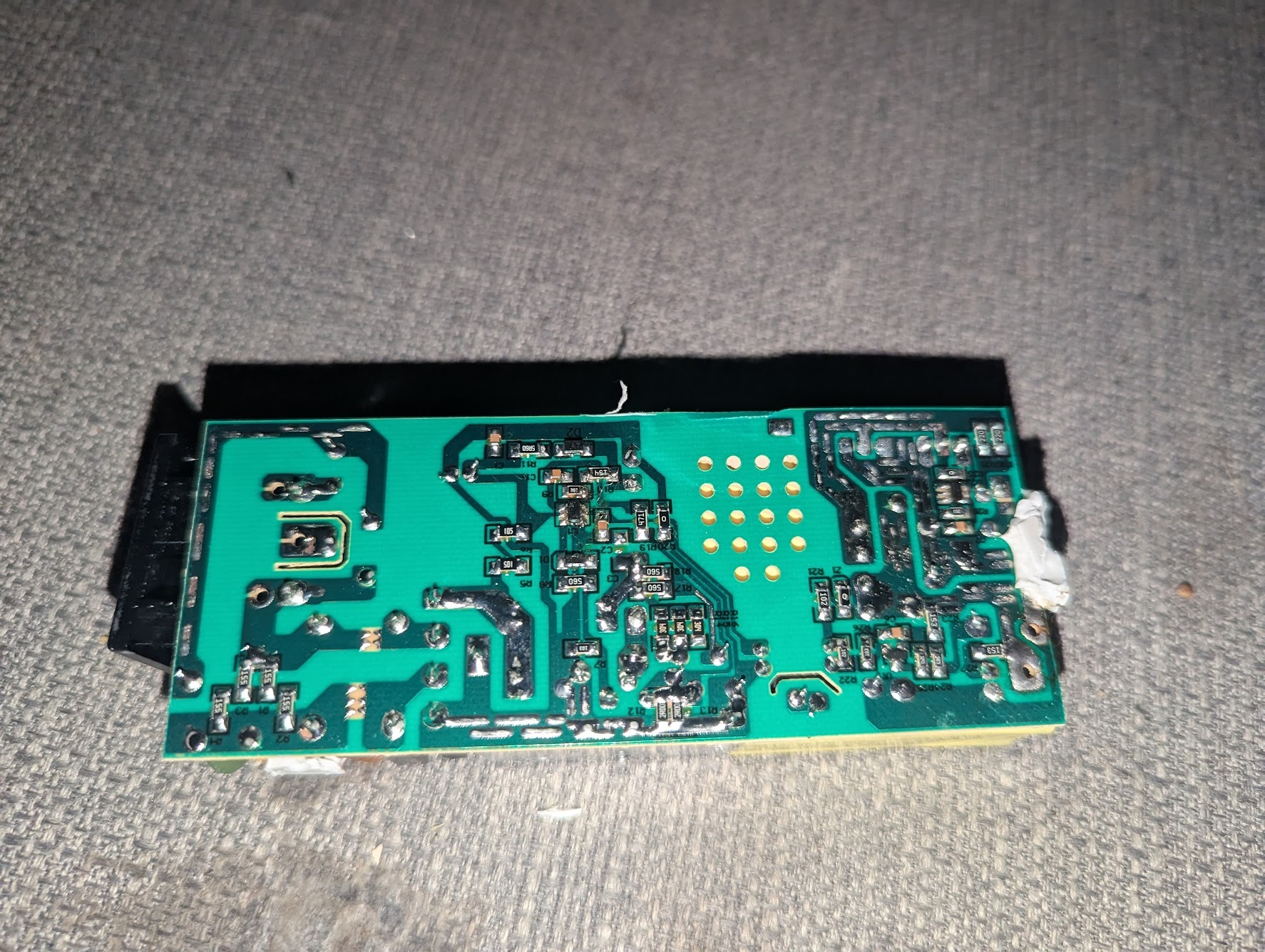

    GRT60-145410 brick PSU, how much of a fire hazard is this thing exactly?
    I bought an Alpicool C20 fridge, which is a 60W compressor fridge that runs on 12V or 24V, which can come from either an AC/DC adapter from mains (240V here in UK) or a car battery. The fridge itself is really good quality, so I was surprised to find the power supply (DC14.5V, 4.1A) pretty questionable. Despite being 240V/1.5A the plug was fitted with a 13A fuse - concerning, but not all that uncommon for imported chinese electronics here. But when I felt how light the brick was I immediately said hell no and transferred the proprietary connector to a MeanWell GS90A12-P1M brick (this supply is held together with screws rather than glue and the molded cable from the original PS fit nicely in the MeanWell).
    Just curious as to this forum's assessment of how much of a fire hazard that original supply is? Pics attached.

    it would probably be o.k. if it was properly assembled.
    what's with the airgap between the final diode and the heatsink? !!!
