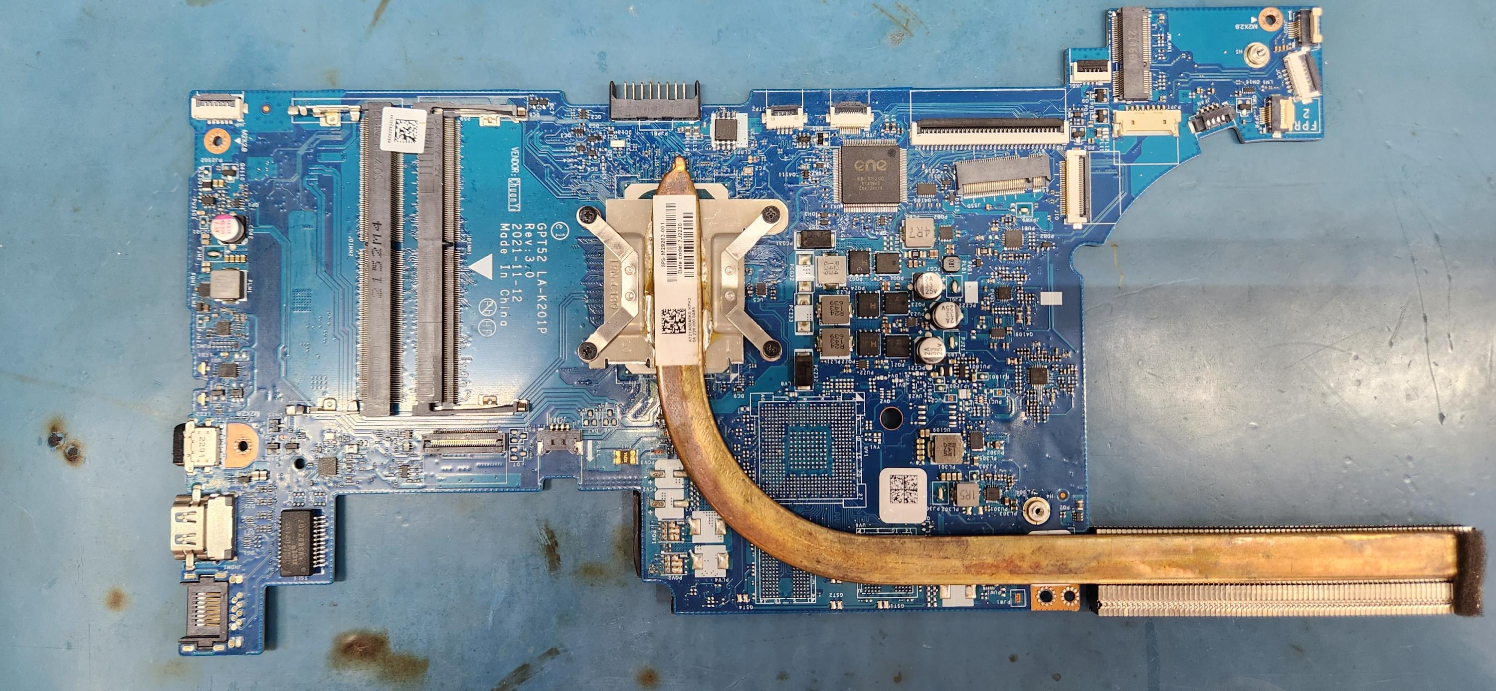

HP 250 G8 Motherboard GPT52 LA-K201P CPU fire
  • paulocoob
    • Jul 2020
    • 6
    • Brasil
    Hello forum friends.
    I want to ask for help diagnosing this GPT52 LA-k201p HP 250 G8 card (without dedicated GPU).
    The motherboard turns on and consumption is 2.2A (CPU fire)
    All voltages seem OK.
    The coil resistances are these
    [FONT="<font style="vertical-align: inherit;"><font style="vertical-align: inherit;">Lucida Sans Unicode</font></font>"]PL302 = 3.2kΩ
    PL301 = 30.1kΩ
    PLB2 = 10.1MΩ
    PLZ1 = 22Ω
    PLZ2 = 22Ω
    PLG1 = 77Ω
    PLM1 = 5Ω[/FONT]
    Could you help me identify if this CPU and PCH are dead?
