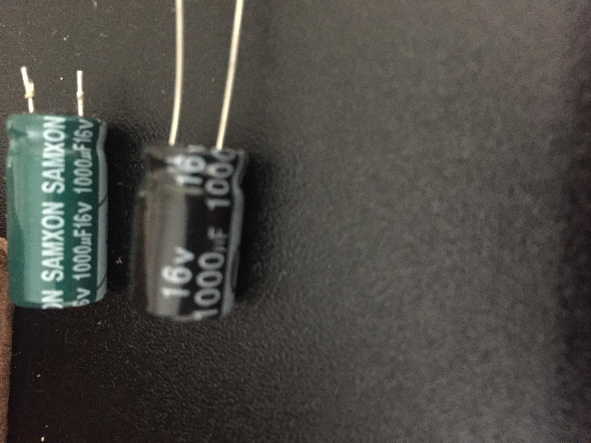

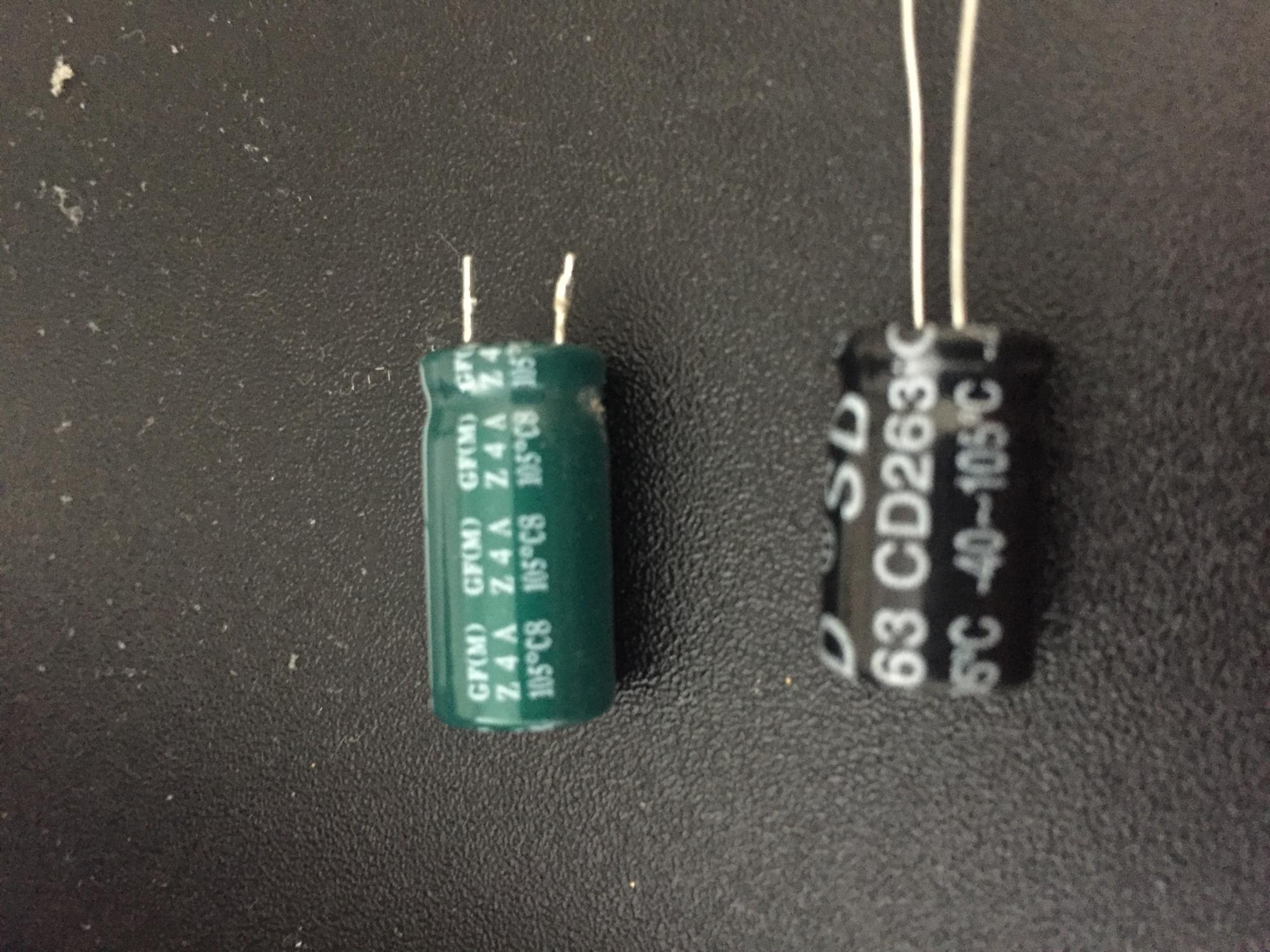

    Hello all I need some info I have posted to photos of two caps the green is the defunct cap the black is the so called replacement,but different size,can it be used.

    where did you get the black crap-cap?

          You go by uf and voltage not the temperature get a good make replacement for example 100uf 16v you can go higher on voltage not on the uf

            The are like for like but not in size

                i brought some of those sd caps from ebay a couple of years ago, they lasted about 6 weeks on a tv inverter circuit before failing again, try and find a Panasonic replacement if i was you.

                  Both look nonpolar?

                    Re: Cap question
                    In the first picture you can see the polarity stripe on both caps. And yes it will work, for how long... Let us know. Or use a name brand like Panasonic if you are worried.

                      Re: Cap question
                      Originally posted by LEEDASH
                      Draw find eBay I think
                      Trash-can them!
                      A good 99% of the caps sold on eBay are either cheap no-name junk like this or counterfeits of big-name brands like Nichicon, Chemicon, and Sanyo/Suncon. Just get some caps from one of the big online component distributors (RS, Farnel, Mouser, Digikey, Badcaps.net, or even member Behemot here).
                      Go with either Panasonic (as suggested above), Nichicon, Rubycon, or United Chemicon and skip the drama of wondering why the device you fixed with those crap caps is broken again.
