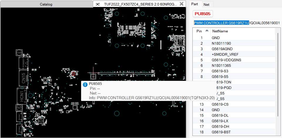

    Hello everyone!
    Please help me determine which microcontroller was in this place.
    Logically, I guess that this is a ddr4 PWM memory controller and some kind of Richtek, but which one?
    Thise motherboard came after another service, where they say that water got on the controller and it burned down and they dismantled it.
    They did not take photos before the intervention
    The DANJLFMBAB0 REV B board, schematics, boards and photos of the motherboard were not found on the network, but I may have searched badly-((
    Maybe someone has a photo of this piece, this board, where the designation of the chip is visible, or maybe
    someone knows and will tell you which microcontroller is there.
    I will be very grateful.​

    First make sure missing IC is a ddr4 regulator.You can do so by checking continuity between ddr4 coil to this IC.
    If indeed its a ddr4 regulator, you can safely try Richtek 3T= or 24=

      Thank you for responding!
      On another forum, it was suggested that it could be G5619RZ1U, most often they are on Quanta,
      but RT8248AGQW, RT8231B are usually installed on Asus motherboards themselves.
      Now I identify the pins -))

        PWM CONTROLLER G5619RZ1U

          Thank you very much! On 12/24/24 I repaired the laptop and handed it over to the client.
          Sorry that I forgot to post the information right away.
          Perhaps this information can be useful to someone in the future.
          This is actually a G5619RZ1U PWM controller.
          Thanks for the help to everyone who helped.
          The implementation scheme of this node is suitable from another scheme
          for the ASUS FX506H Quanta NJ DANJJMB1AA0 Rev 1A.
