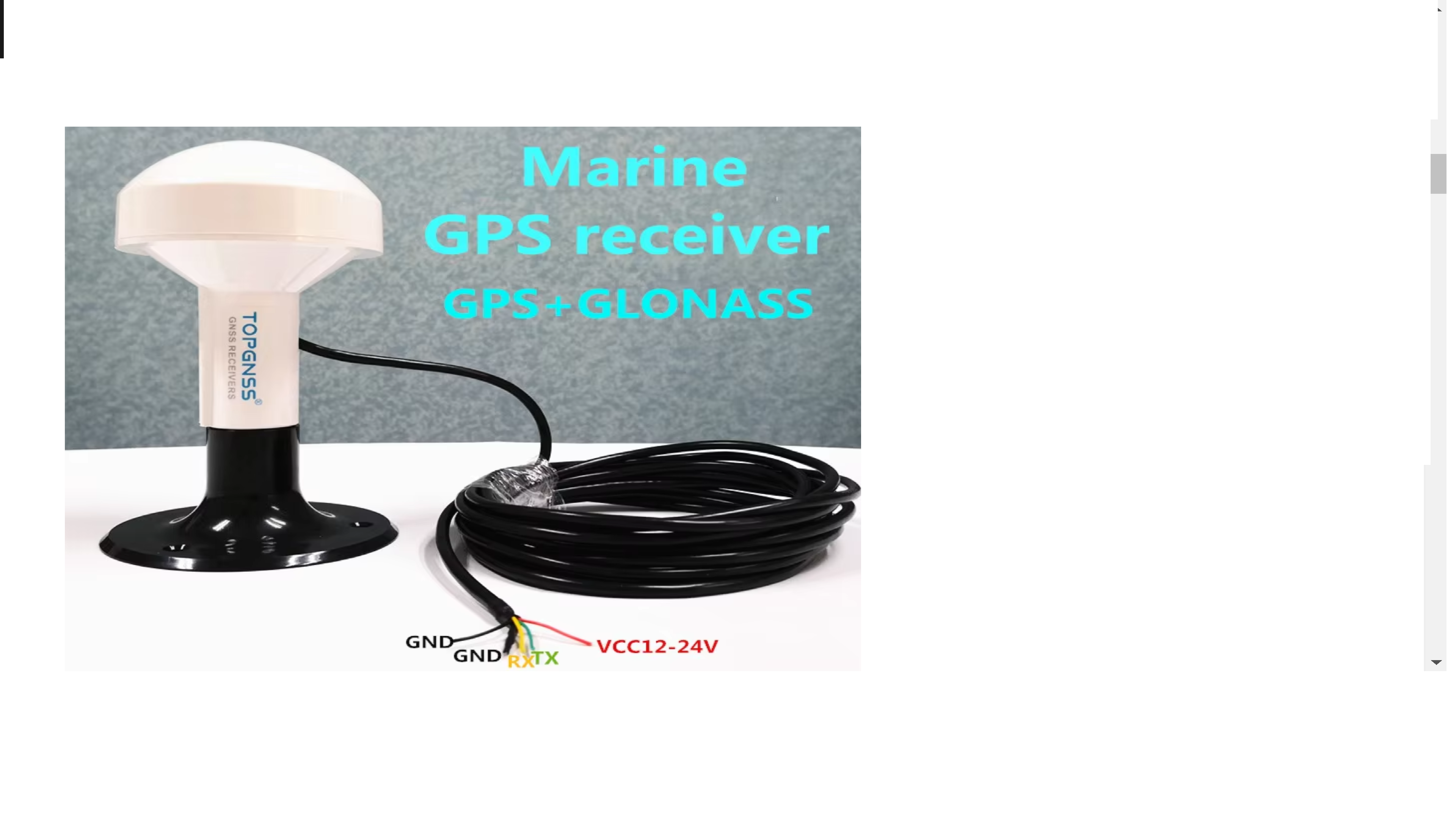

    Anyone know what the end is called on this gps wire?
    https://www.amazon.ca/dp/B01N3QHLDE
    I see you can buy gps antennas that have wires exposed and no cable ends. I need this end for my hondex plotter.

    TOPGNSS antenna wiring is different, for some reason I thought you had the SCU-31. I think no big difference if RX- is connected to ground or TXB.
    *Note the thin/skinny black wire is special and not a ground but NMEA OUT-/TXB(-). The thick black wire is GND.

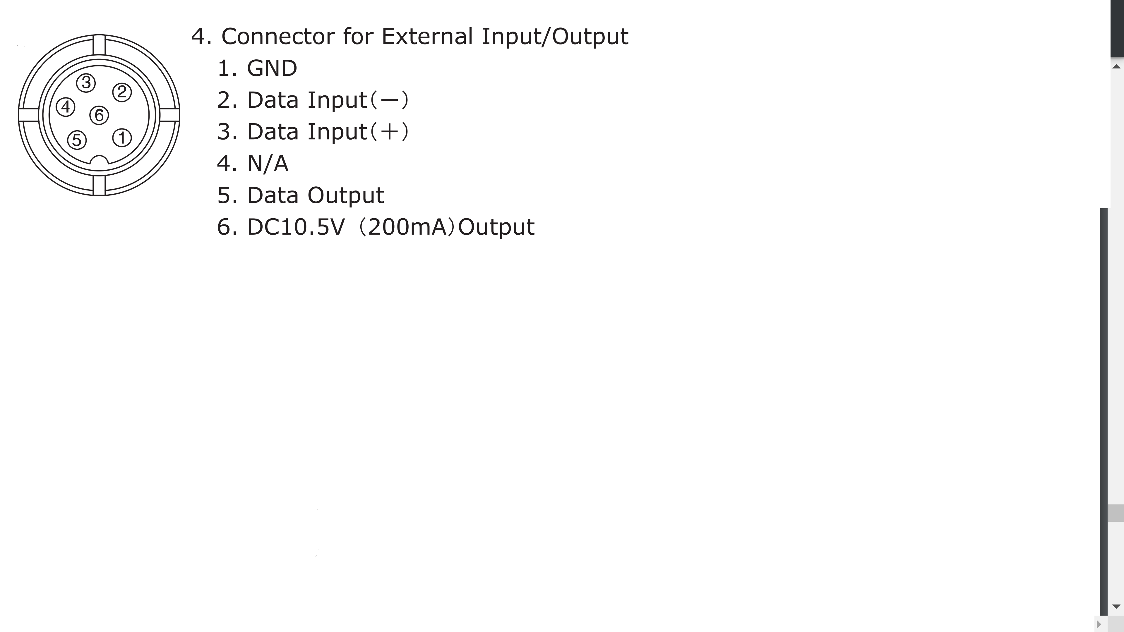

ID:	3468018 Click image for larger version

                        So i received the GX16-6 and they do indeed fit. I may need help wiring it now though. Would the two ground wires on the antenna go to pin 1 of the connector? I'm also wondering why there is a data input - and + on the connector. Im pretty sure red would go to pin 6 and maybe RX to pin 5?
                          • 30977
                          data input +/- is probably RS485 differential signalling

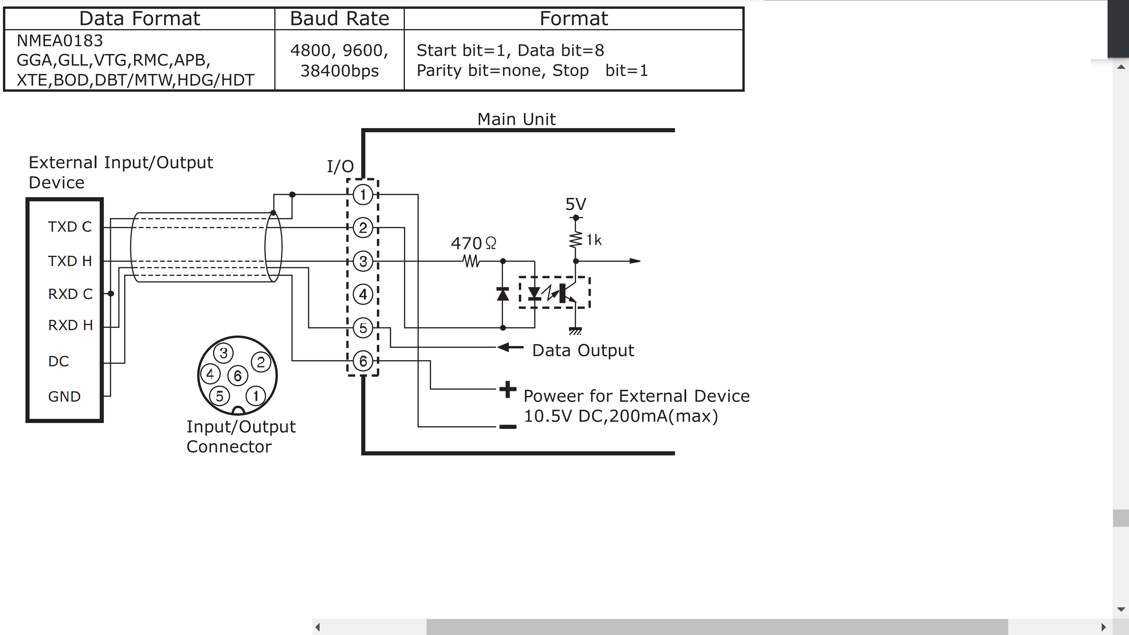

                                    This diagram from the manual shows it a bit better.
                                    Here's what I did:
                                    Red - 6
                                    Yellow - 5
                                    Blacks - 1
                                    Green - 3
                                    The green I just kind of guessed. My other option for green was 2. I will test it tomorrow.

                                      I tried green on prong 2 and 3 and neither worked so I'm not sure what to do next

                                        OK give me some time to draw a diagram. It's hard. The H and C (TXD H,C etc.) is hard to know what they are doing.
                                        *HEY what colour wires are there in the SCU-31 cable? The manual gives only 3 of the 6: red, green, brown, blk and I also find this pic for the SCU-31 GPS antenna/

                                          This is what I would try for wiring the SCU-31 GPS antenna to the Hondex HDX-121 plotter. Problem is the Standard Horizon SCU-31 GPS antenna seems to have unknown wires (blue, yellow) not in its manual.
                                          You must program the correct baud rate in the plotter for whatever port you are using:
                                          Menu 7.EXT TERMINAL – {not sure if you need to use the output feature, which is when the plotter can also send information to the GPS antenna).
                                          3.NMEA1 OUTPUT ON/OFF
                                          4.NMEA2 OUTPUT ON/OFF
                                          5.NMEA1 PORT BAUD RATE
                                          6.NMEA2 PORT BAUD RATE
                                          7.GPS PORT BAUD RATE. (4800, 9600,38400) {SC-31U is 4800} GP-16H: 4800, GP-17H(HD): 9600 AIS: 38400
                                          Reboot the unit after change of this set-up.
