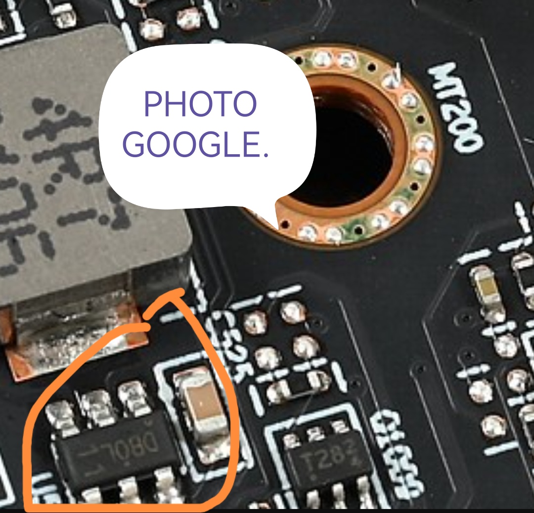

Help please to identify ic of RX 6600 eagle Gigabyte (not xt) attached photos.
  • AZZEDGPU
    • Jul 2022
    • 5
    • Perú
    Help please, i need to identify this integrated, i came to the conclusion that it is a 5v output ic.
    Attached photos, please thank you very much.

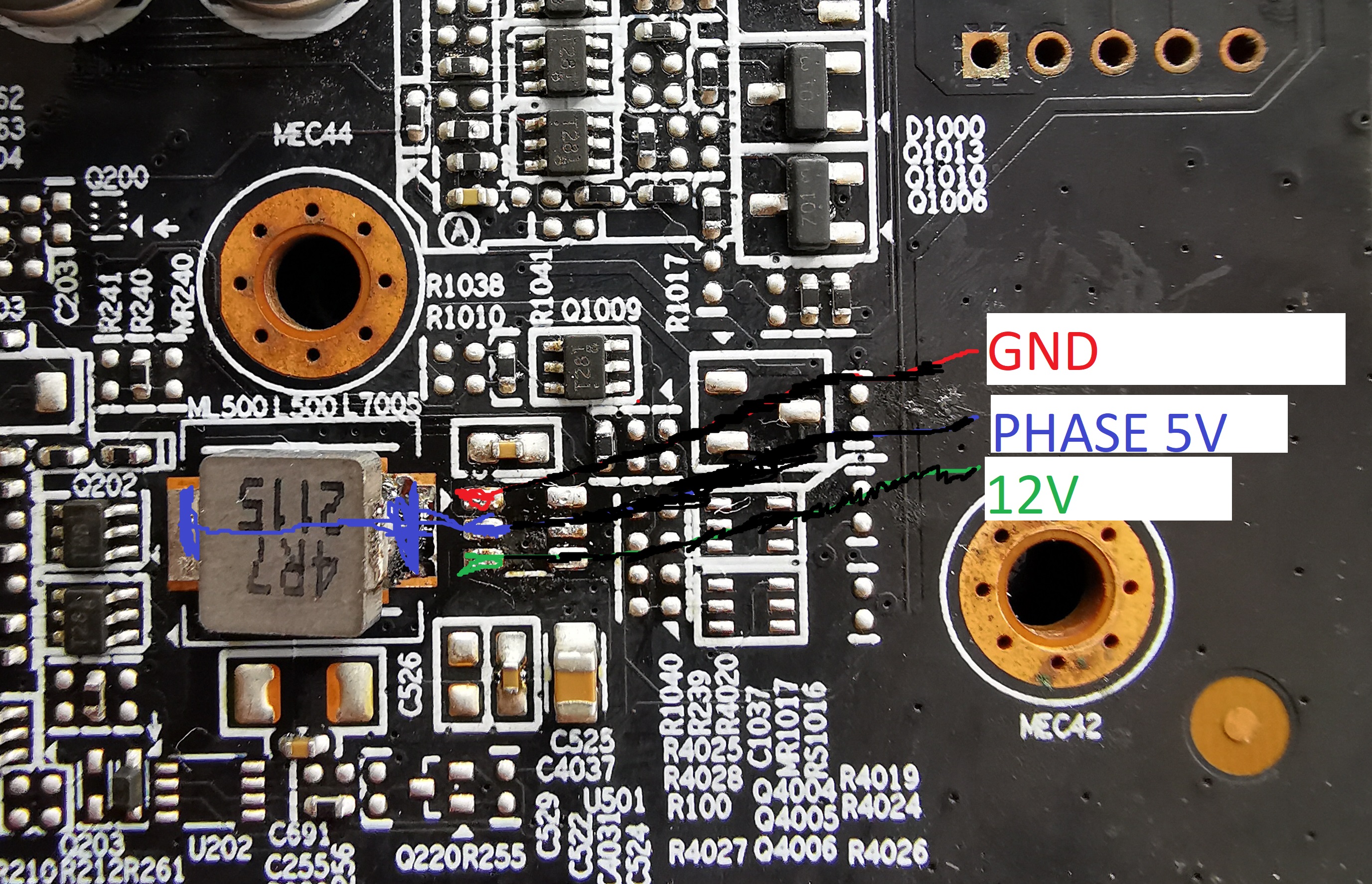

    Hello, i have the same problem, do you find something on this chip ?? thank you

      its sot23 6pin voltage regulator to make 5V. something like this
      https://www.ti.com/lit/ds/symlink/tp...=1724129138937

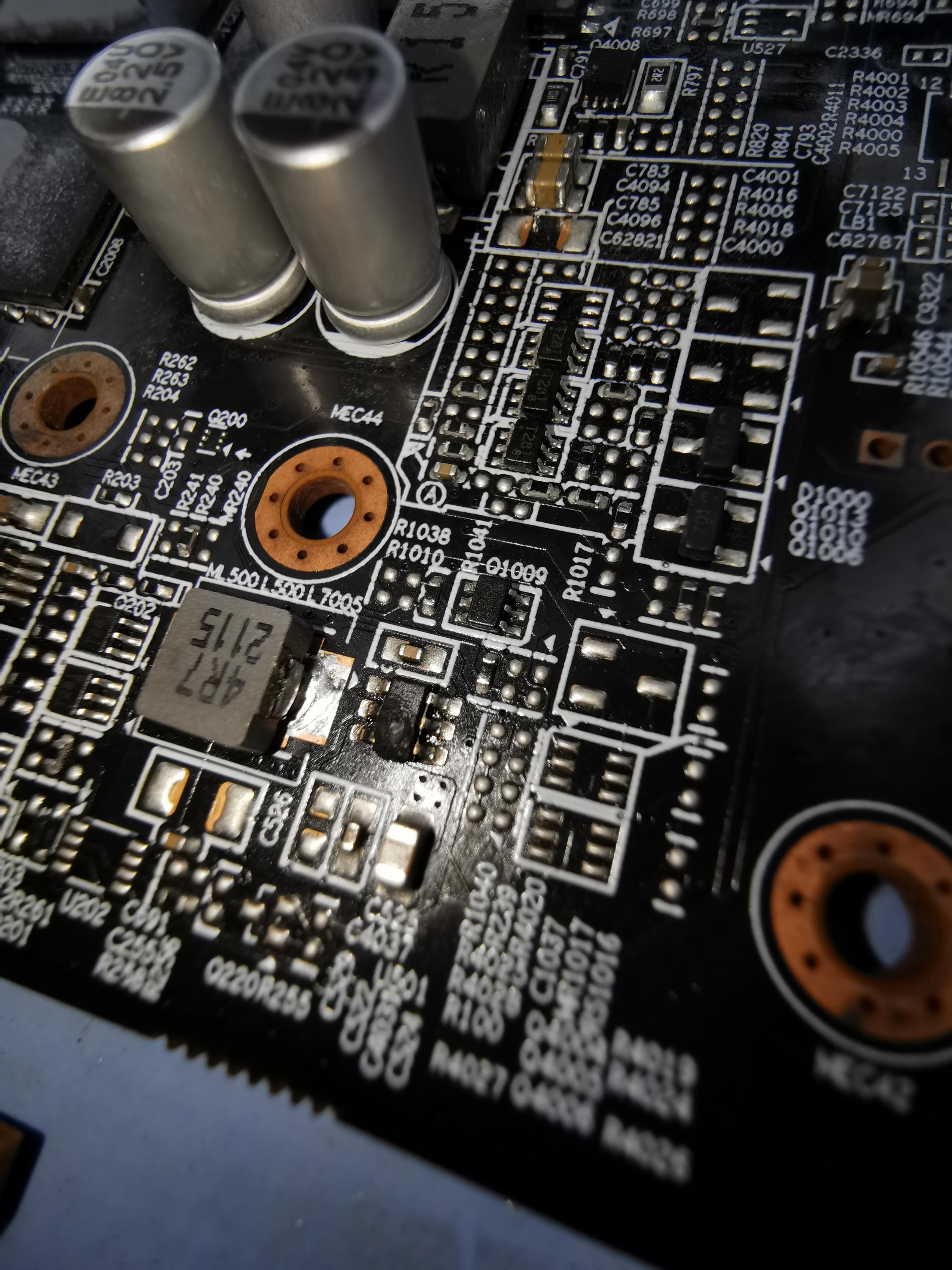

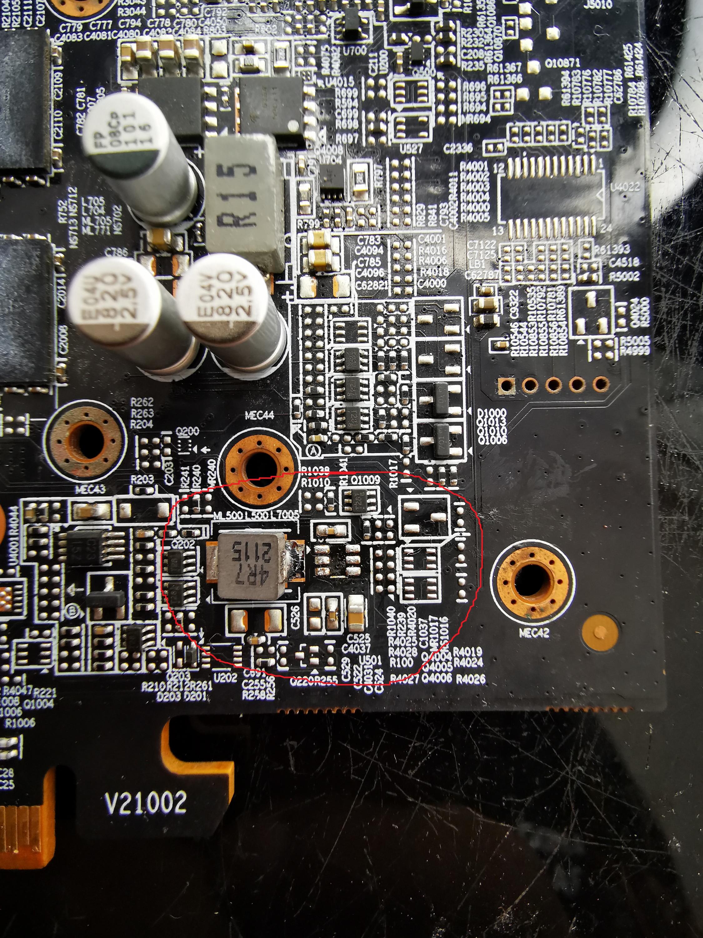

            Hello RJ, thanks for the over Ref, i will look for that too, i have bad vrMOS on this card due to the failure of this chip, but it look like this Thanks. The ground pin and Vin pin is good, but does "EN" or "LX" is where the 5v goes out of the chip ?? I don't really understand where is the output on the 3 ref schematic you post (KTM and you)
            Thanks for the help btw !
            • R_J
              • Jun 2012
              • 9583
              ENable turns on the ic, the output is LX then through the coil to the load should be just like the sample on page 1
