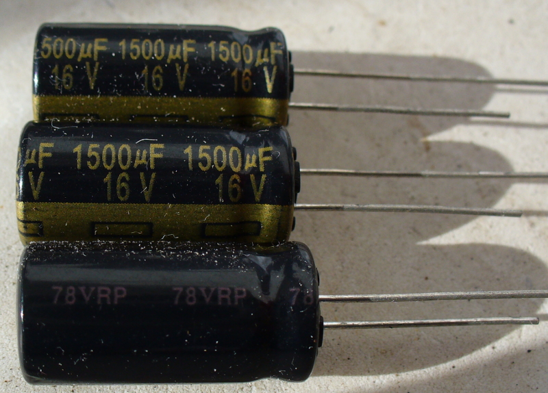

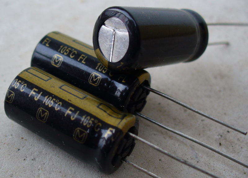

    I bought these caps on e**y from HK and I would like to know if they are genuine. Thanks

    Re: Panasonic FJ/FL genuine or not?
    I think they look genuine to me.
        I would say they look genuine to me as well. I just compared them to a few 16V 1500 uF Panny FL caps that I pulled from an Xbox 360.
        Can we see a picture of the voltage/capacitance rating and another of the bungs too? Just to really make sure they are legit.
          +1 genuine
            They look like the right bungs.
            However, is that a picture you took? If not, we need to see the pics of the caps you got. Some sellers will fool you by putting pics of good caps on the listing, then give you fake ones.
              Of course. This is the voltage/capacitance picture. The pictures are mine.
                look real to me
                  Yup. I've seen plenty of identical-looking Panny FJs on motherboards.
                            my 1000uF 6.3V looks similar like yours...
                            dissect one of it... the chemical colour looks correct...
