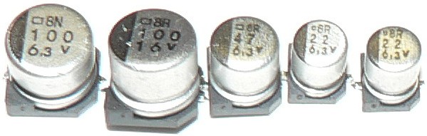

      Are these SMD's really Chemi-Con? There is like a their logo, but it's very small and the 8R/8N don't seem to be names of series.
      I also founded some low Panasonic caps without serie label at all. Any idea which ones these could be?
      Thanks.

        Either Chemicon or Sam Young.
        Sam Young sometimes makes caps for Chemicon.
        They 'stole' Chemicon's logo for a while until Chemicon files a suit.
        Then for a while Samyoung just added a dot in the middle of the shield before making their own logo.
        http://www.samyoung.co.kr/sub_info/history_eng.asp
        http://www.samyoung.co.kr/sub_produc...nfo_list_s.asp

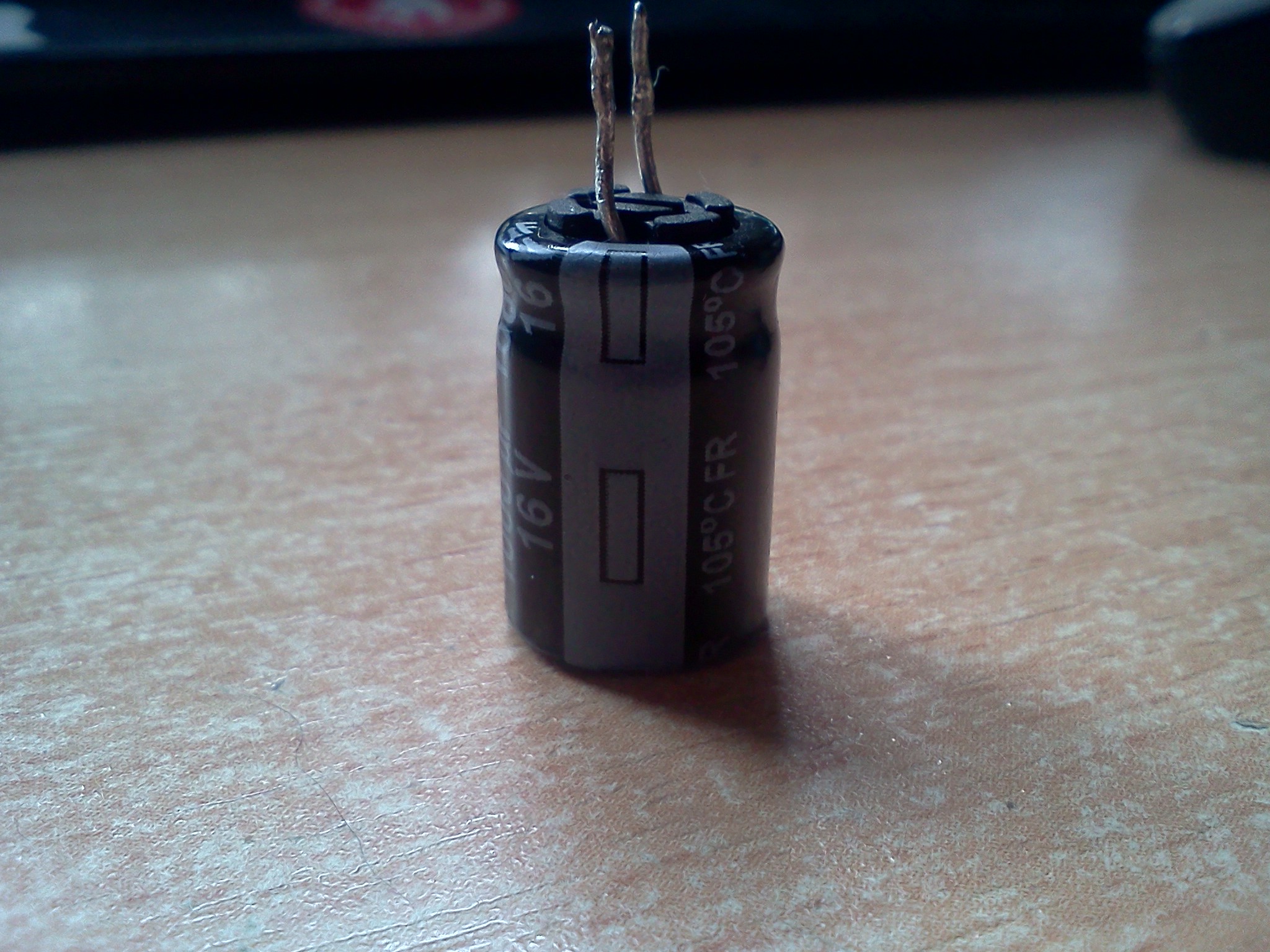

                          Quick question here! I got some presumably Panasonic FR capacitors off some dead motherboard, but i am not sure if they are real. They have the usual T shaped vent and they look like Panasonics, but there is no [M] logo on them. They are rated for 16V 100uF and the printing quality is somewhat questionable (big print). 16V 1000uF 105c FR 23IDA.

                            Panasonic FR series doesn't have the M logo on them, and it's plain white ink on black plastic.
                            I actually have some 100uF 16v panasonic FR capacitors, here's how they look:
                            btw, the 100uF shouldn't have a T vent at all, the size is too small for the capacitors to do any real damage or have enough gas to explode, so usually such small capacitors don't have any vent.

                              I know small caps don't have vents I meant 1000uF not 100uF They are probably real ones. Thanks for a quick reply mariushm!

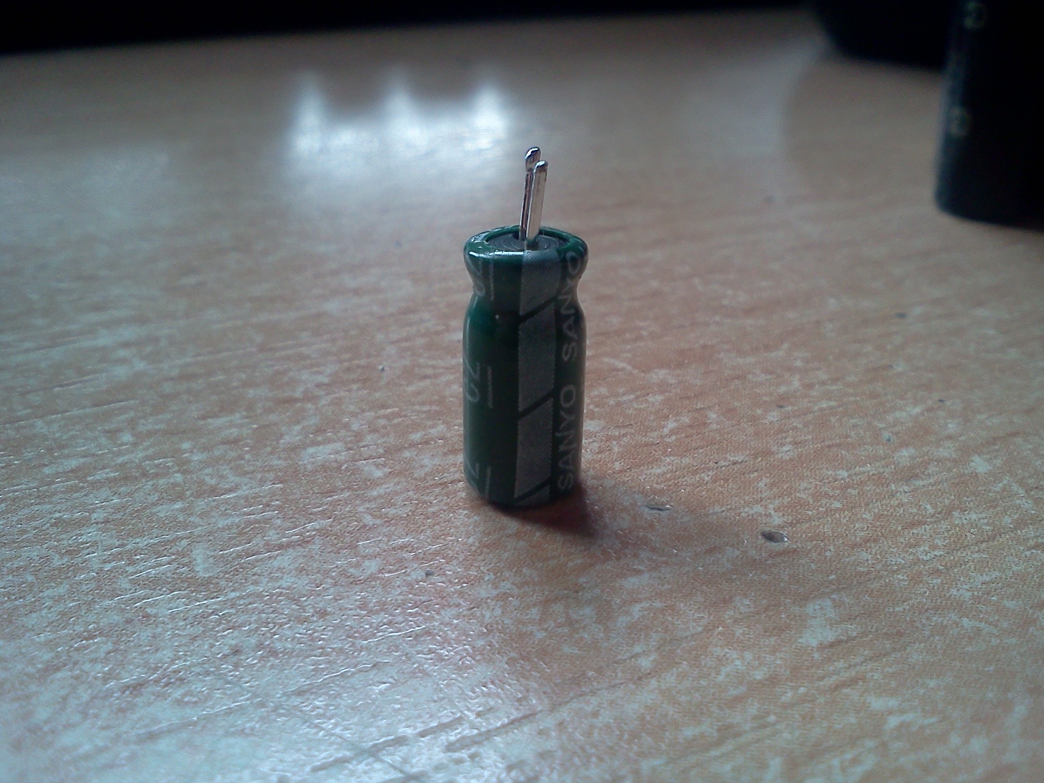

                                  Here are some caps i have, that i do not think they have pictures of them posted here.
                                  Panasonic FZ: Dark blue, light golden stripe.
                                  Panasonic HFQ: Got them from a Compaq branded psu (probbably Delta). Dark blue, white stripe.
                                  Philips M series? Not sure. Got them from an old monitor. They seem fine, i use them for psus. Blue, black stripe.
                                  Panasonic FJ: Black, golden stripe. Very good caps.
                                  Panasonic FR: Black, white stripe. NB! They do not have the [M] logo, but they are genuine! (thank you Mariushm for the info!)
                                  Rubycon W: Very old caps, from an old monitor. I use them for psus, probably not low enough ESR for boards. Light blue, dark blue stripe.
                                  Fujitsu M: Yellow, black stripe. Not sure of the quality, should be ok. Vent is like the Sanyo K vent, but different from Rubycon K vent.
                                  Panasonic FL: They look like polys (4v, 680uf, tiny, flat top, no vent) Black, golden stripe.
                                  Sanyo CZ: Light green, white stripe.
                                  Nichicon RZ: Not sure if genuine, they have a generic round (circles) bung. Black, white stripe.
