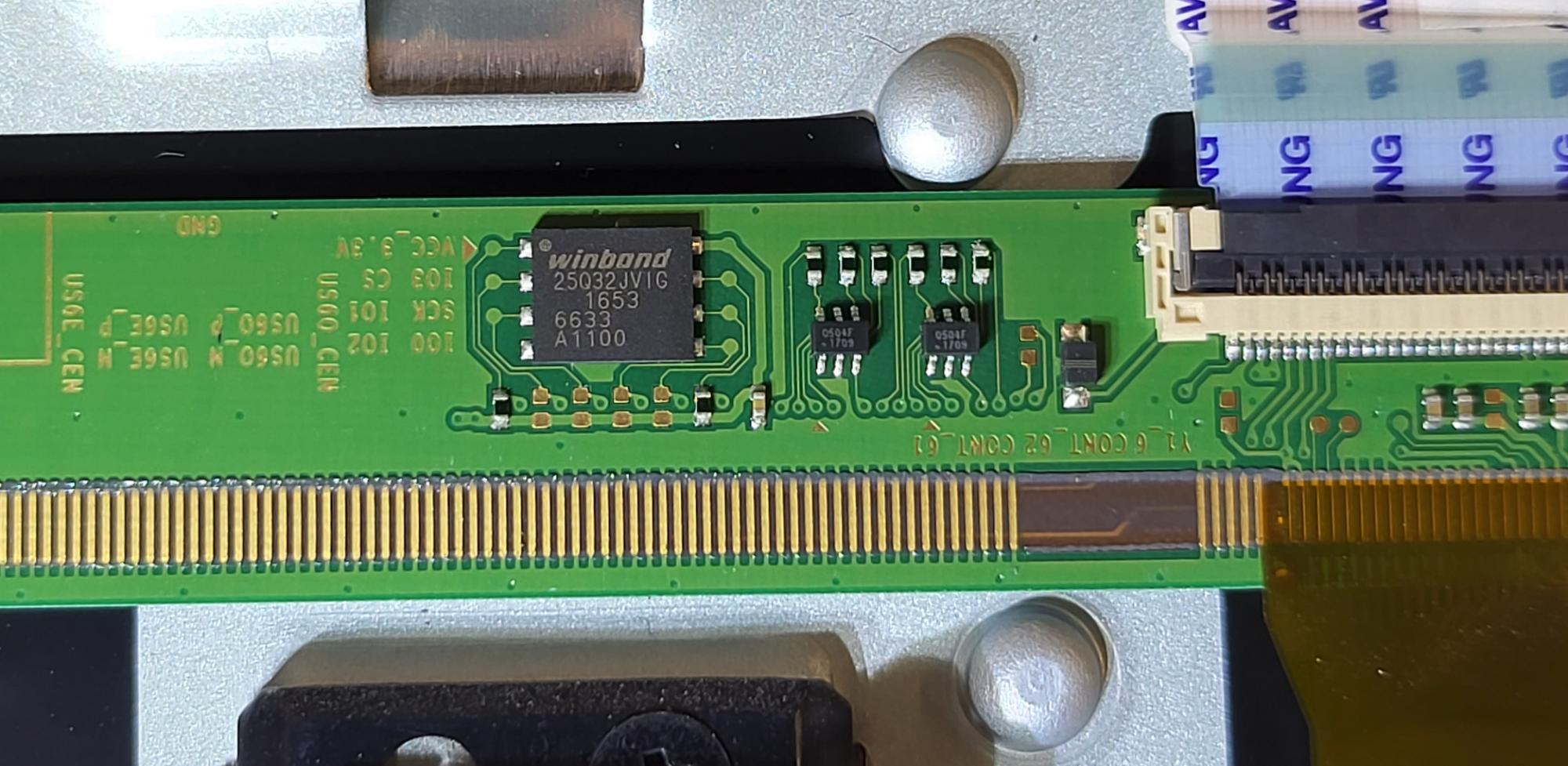

    So you have convinced me that this is primarily a panel issue...possible multiple issues within the panel. And the chances of resurrecting it is slim. I can now temper my expectations. But this is not a total waste as I can use this opportunity to learn about panel repair which was one of the main goals of doing this repair.
    So you say one of the issues would be with the WINBOND 25Q32JVIG chip pictured here? Its the only SPI chip on the panel board. When I tested it it was not shorted and it had 3.3v going to it.
    To fix this problem I would have to remove it and rewrite the firmware to it.
    [This is something that I have absolutely no experience with but I have am sure I could learn it easily.]
    Another option would be to find the SQI from a donor TV or LCD Panel board with the same part number.
    The part number of this panel is 16y_10vu55sl4lv0.0 left.
    Would this work assuming that the donor TV was actually working?

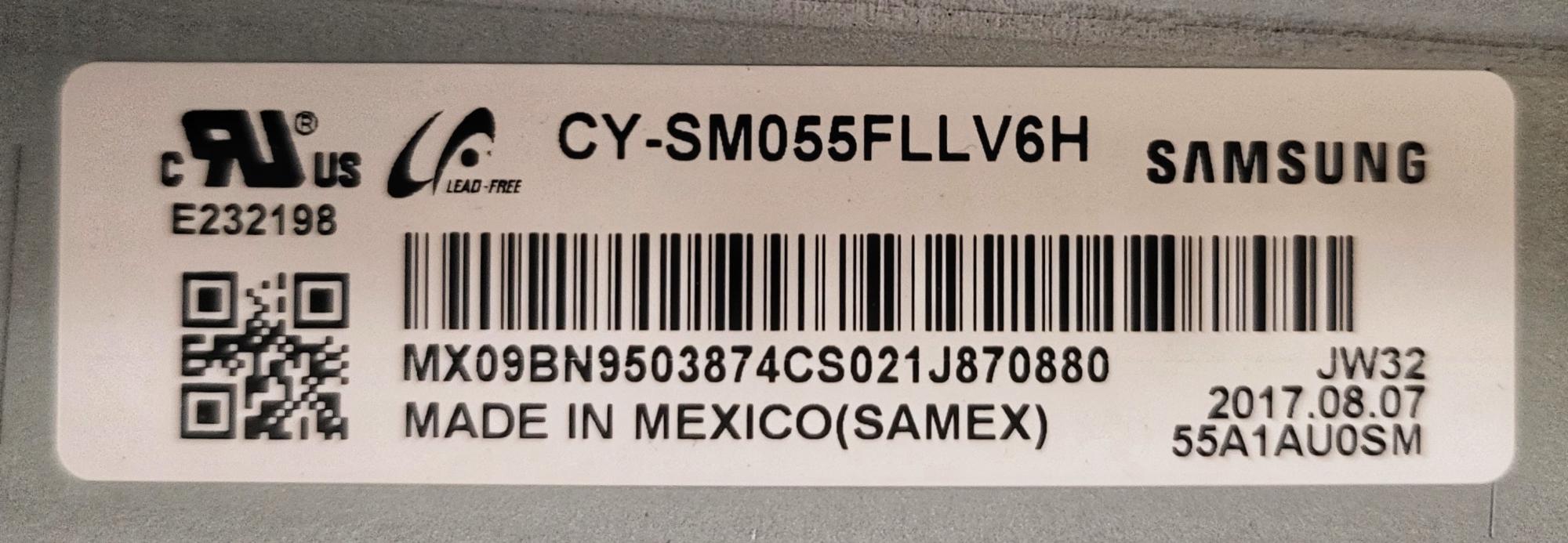

        The actual Samsung part number of the LCD Board Panel is BN96-41982A but is a secondary part number printed on the board.
        The panel itself (which I think is what you were actually asking about is CY-SM055FLLV6H.

          I was able to pull the firmware off of the panel board's chip and posted it to the eeprom dump thread. I had to pull it off and read it via an WSON-8 adapter and a CH314A programmer. Im hoping to hear back soon on what's what. Pretty excited to get here. I've never done this aspect of TV repair before. Also excited to see what new adventures this CH314A Programmer will lead to.

            Well i hesrd from @lotas and he tells me that the chip that i pulled off the LCD panel board woudlnt have anything on it that would prevent the panel from displaying a picture. If i understand it correctly thst chip is used to store calibration/corrections wheb its manufacturered.
            He did point me to a proably suspect which would be any other 25-bios chip on tbe mainboard. It would be the one that stores the t-con firmware. And THAT would certsinly give us a no picture problem on the display. Im learning a lot with this particular repair. When inget home tonight i will try to identify this T-Con chip and see if i can get a dump off of it.

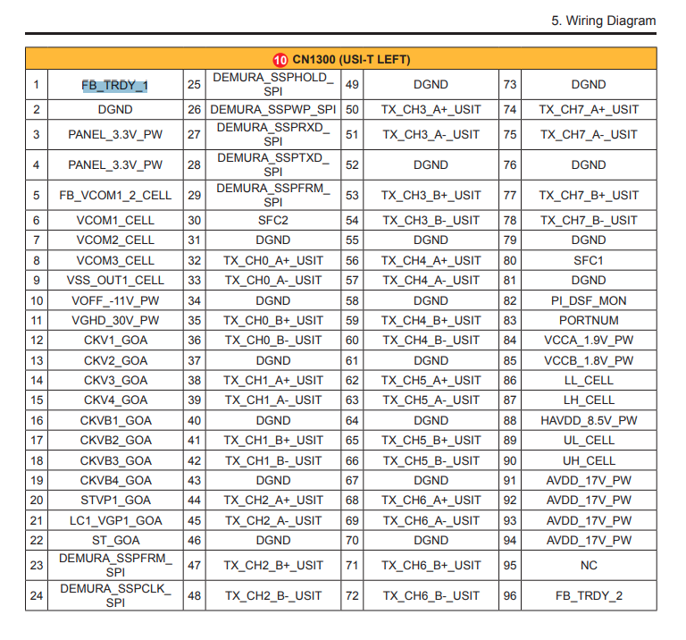

                          To run T-Con without a panel, you need to put a jumper on the motherboard (imitation of the panel).

                              No, you need to connect the points FB_TRDY_1 and FB_TRDY_3.

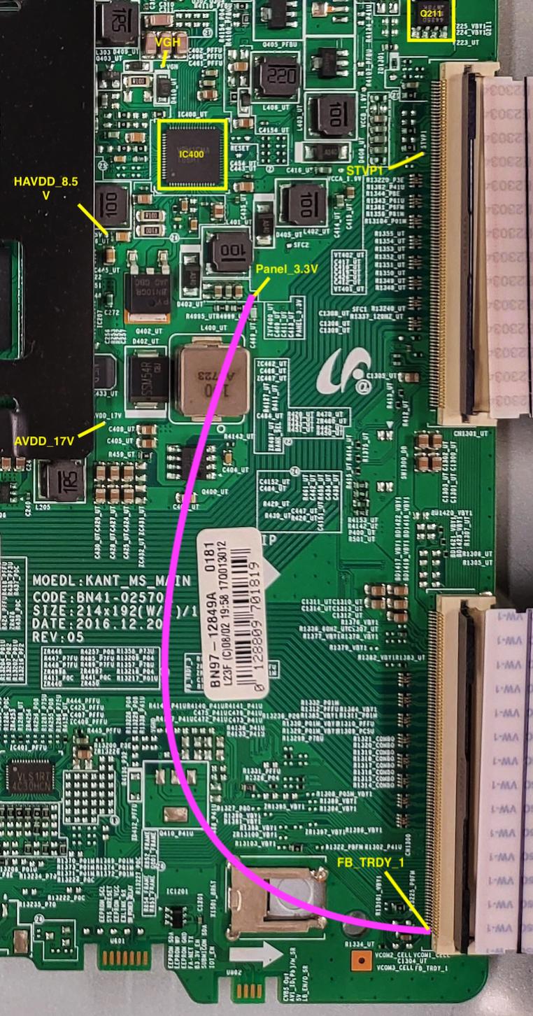

                                    So I went in and added 3.3v to FB_TRDY_1.
                                    I used the Panel Testpoint which has 3.3v and verified that it was getting to the correct pin.
                                    After powering up the set and using the remote control to get to the main menu (via sound prompts) I tested AVDD_17V, HAVDD_8.5V, VGH and STVP1.
                                    They all read 0V.
                                    Just want to confirm that doing just FB_TRDY_1 is correct. I think this would simulate having just 1 LVDS cable connected which should still work as we often test these TVs with either panel cables connected.

                                      Who told you that the node should apply 3.3v to the FB_TRDY_1 point?
                                      https://www.badcaps.net/forum/showpo...3&postcount=74

                                          My apologies! The way i read the conversation between you and Davi.p was he mentioned injecting 3.3v to the T-CON test point but you came in and said it needed to be injected to FB-TRDY 1 & 3. So i take that there is no need to supply voltages anywhere for this particular test.
                                          So when i get home i will connect FB-TRDY 1 & 3 together and check the test points again.
