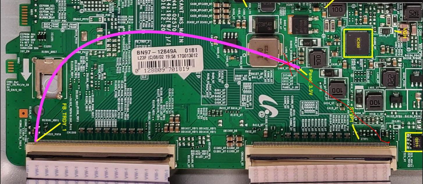

    You don't need to supply any power, you just need to put a jumper between FB_TRDY_1 and FB_TRDY_3.

      Okay I am back with voltage readings after jumping FB_TRDY_1 and FB_TRDY_3.
      AVDD_17V = 0V
      HAVDD_8.5V = 0V
      VGH = ~0V (actually it was 0.065v
      STVP1 = 0V
      Panel_3.3V = 3.3V
      There were a few other test points I hadn't noticed or paid attention to before so I took their measurements anyway.
      SFC1 = 1.85V
      VCCA_1.9V = 1.9V
      If I recall correctly there is no change from before jumpered the FB_TRDY_1 and FB_TRDY_3.
      Does this mean that the T-Con portion of the mainboard is non-operational?
      Is that a firmware issue? I remember checking all the PMICs and they seemed okay.
