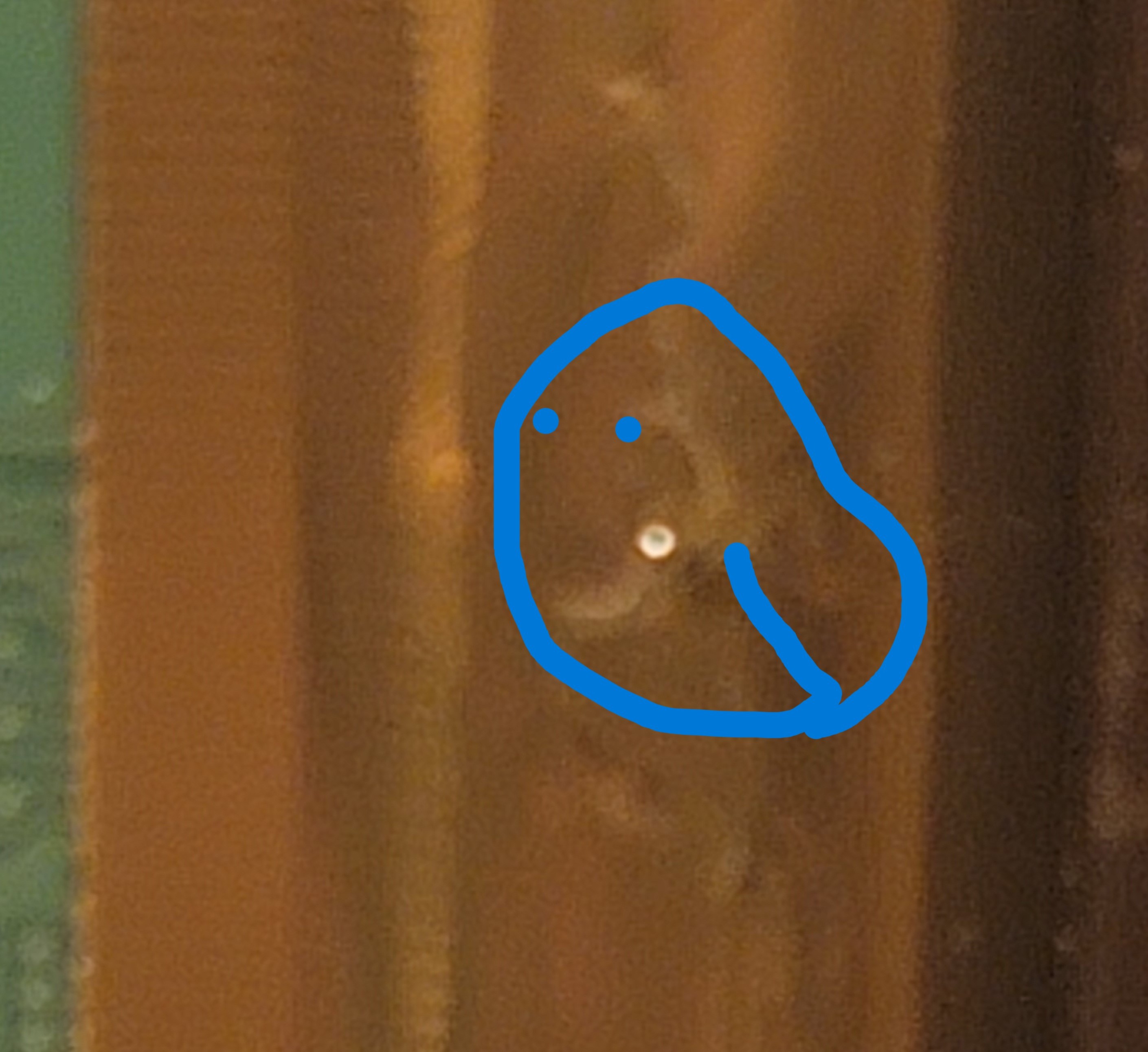

    Well, I will be the first to admit that I screwed up...
    In attempting to replace the backlight in a UN65TU8000, I made a hole through one of the ribbon cables between the board that runs along the bottom of the back of the TV and the panel. This lead to a between a 1/4 to 1/2 inch vertical stripe running the full height of the image.
    I don't have the experience; personally, to solder a bridging wire for the paths that were cut. So, I have been on the hunt for other Samsung TV's of similar size.

            hold on.... i cant catch what you mean with hole and witch cable.... can you show me complete photo of the back yours Tv with hole in cable... RU i have all parts new.. of complete 2 set TV----

              Lol, ok I see it's a panel ribbon that has the hole in it, I thought it was one of the ffc cables.

                RU / NU / No separated T-CON... LVDS goes from MB to Panel Always and they are white cable always too
