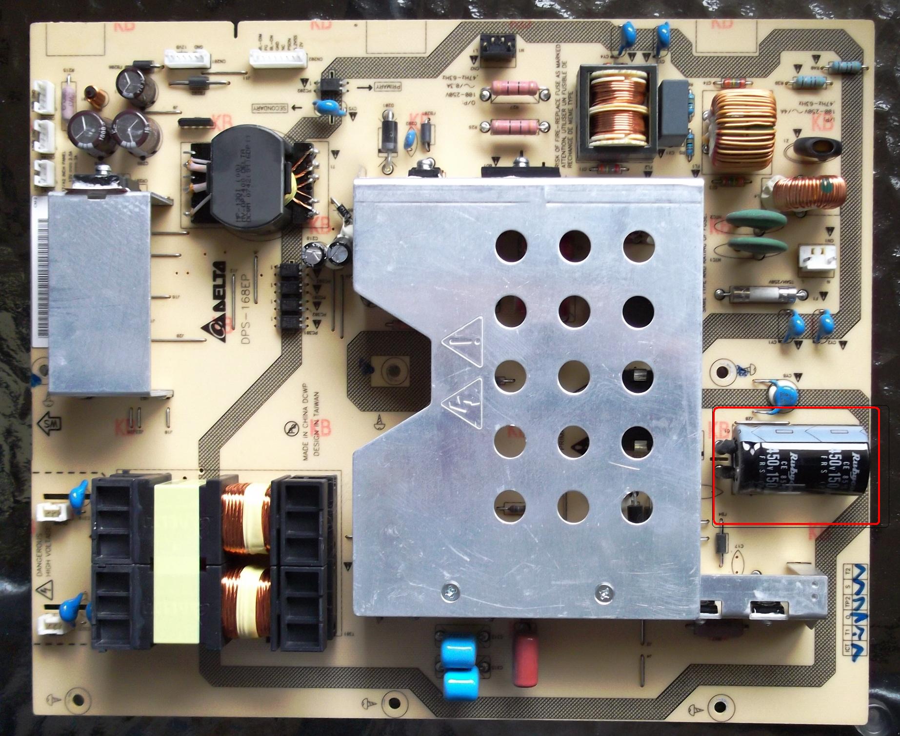

    The no light - no image problem returned after a few days so I tried the trick suggested by selldoor of heating the large capacitor (see red box in picture) with a hair dryer before startup. It solved the problem so I ordered the replacement cap until they got the proper one and I soldered it in.
    Unfortunately the problem has not changed. If I heat the new capicitor with a hair dryer, it starts up fine, otherwise no image. Hmmm.
    Any thought / advice would be apprceiated.

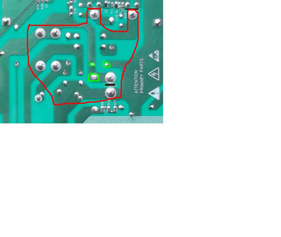

      OK If heating the area works it suggests a cold solder joint
      Re solder all the joints inside the red area except the green ones.
      If you examine with a magnifier you may find a cracked one in which case do that first

        Ok. I was not able to remove the old solder - 25 Watt iron didn't produce enough heat to let me suck it up. but I held it on each connection until it was liquid and added a bit more solder, but no excessive amounts. Some of the connections did look suspect before and they all joints look good now. But I've got nothing now, even with the heatgun to the cap - on one try.
        So I suspect I'm onto a problem here. Do you think I need to pick up a 40W or 60W iron to do this job properly? and do I need to suck up the old solder then resolder each connection?
          Re: 42PFL7422D/37 Service Manual Needed
          2nd time around resolding the connections outlined in the diagram -was able to suck the majority of the old solder and do what I think is a good resoldering. but still no resolution of the problem. Heating cap and that area of the board now does not work. I'm baffled.

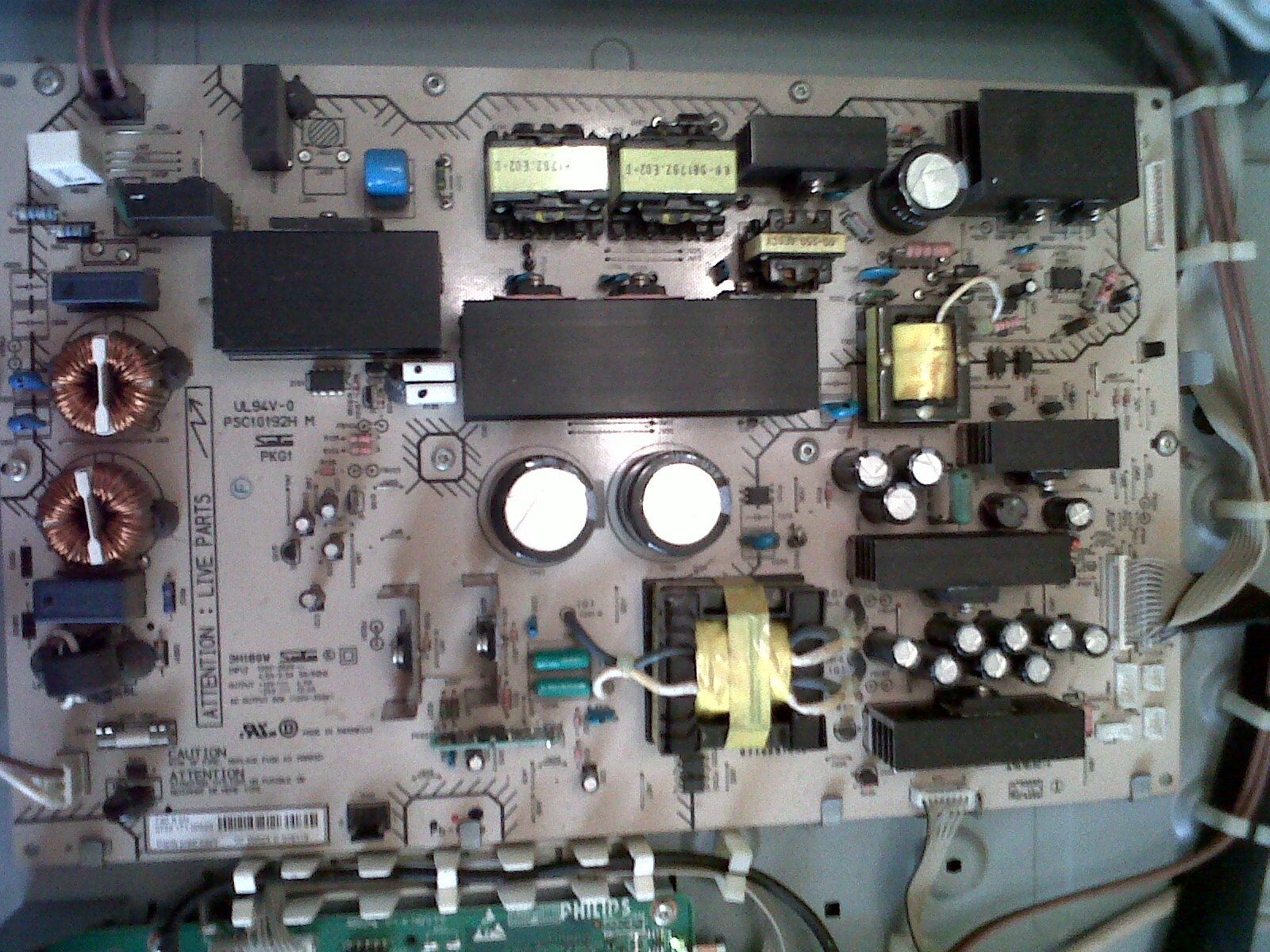

            Power Board:

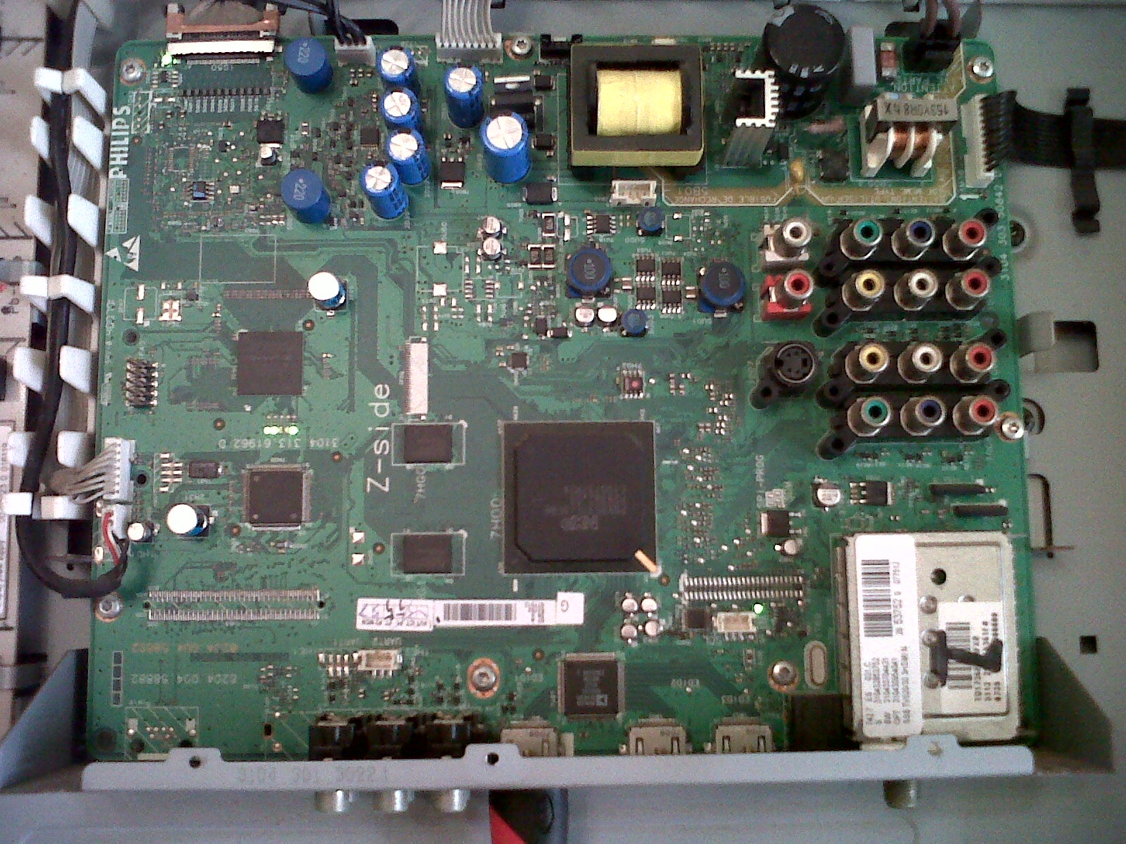

            With it all connected and on can you test the voltages on the connectors from the secondary side NOT the ones to the lights. Cant actually see a tagged ground screw so use the ground on the top left connector.(in your picture)
            If all the voltages are not present, on the MAIN Board bottom Left there is a red fuse. With the power OFF for 5 minutes can you check it. Meter on ohms 200 - should read the same as touching the probes together.
            Post result.
            If that is ok with it all switched on Meter on 600vDC CAREFULLY measure the voltage at the fuse.
            Also on that board a little way up between the ywo white connectors at the bottom there is a white rectangular component at 3004 and another that looks the same a little to the right - is there any marking on these.?

              On the secondary side connector I got the following readings
              BL-DIM - 0.0V
              PO - 0.0V
              BL-ON - 0.02 V
              GND - 0V
              NC - 0.0V
              PSON - 4.07 V
              5.2VSS - 5.08 V
              12V - could not contact with DMM.
              Both the Main Power supply fuse and the Red fuse on the SSB did check out for continuity, however I could not get a voltage reading on either w DMM setting on either 1000VDC or 200VDC.
              The small components on the SSB labelled 3004 and 3D3 were both marked with 100.

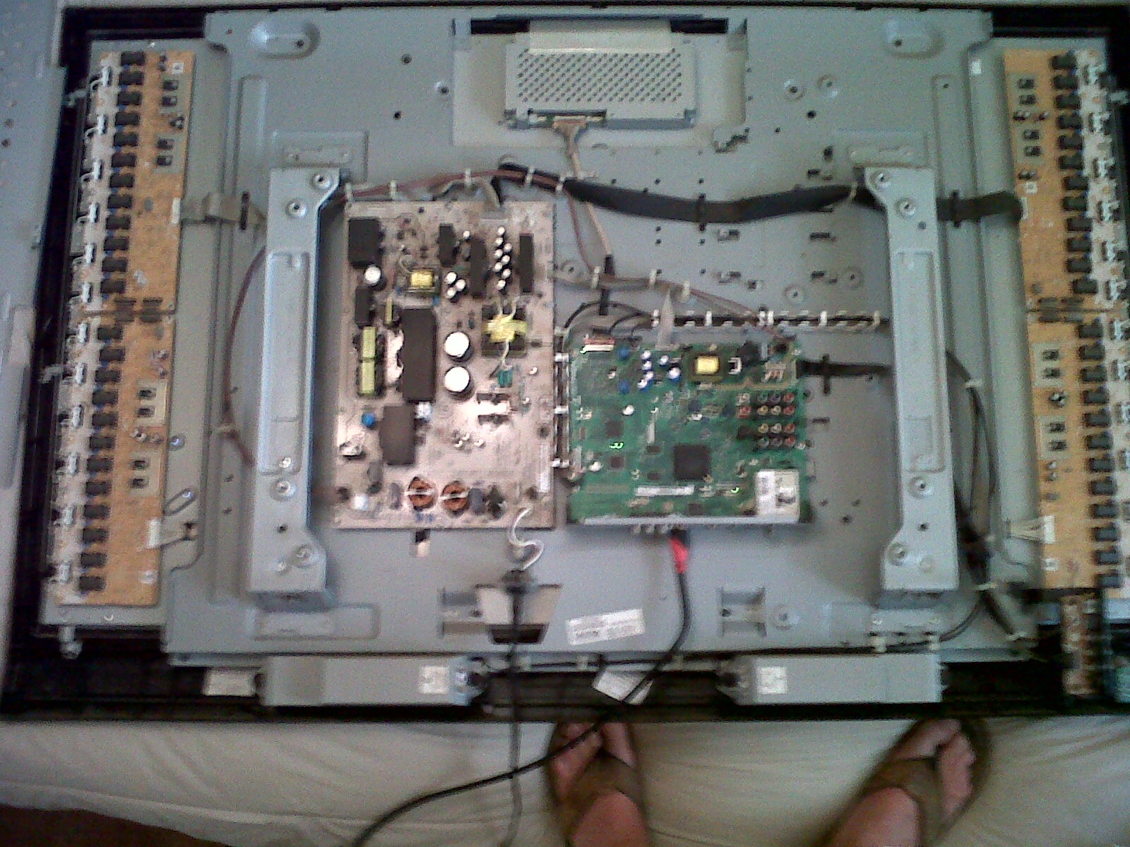

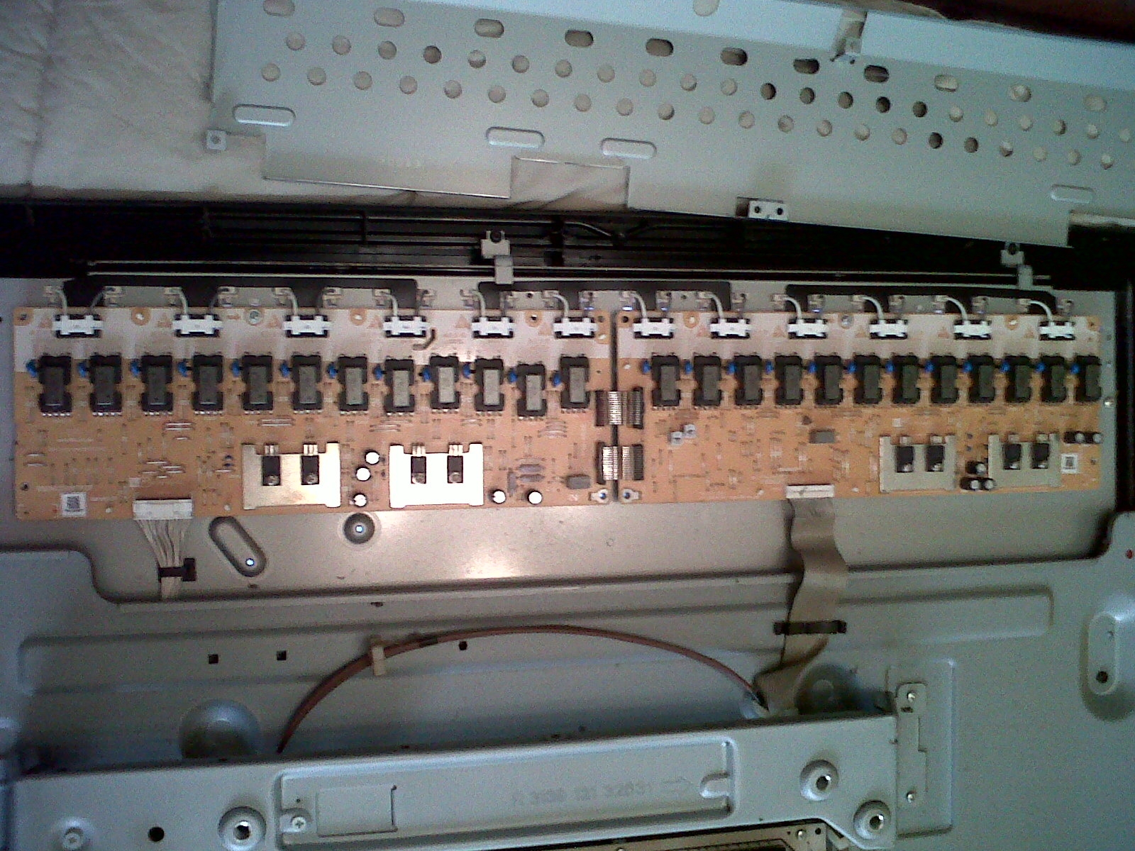

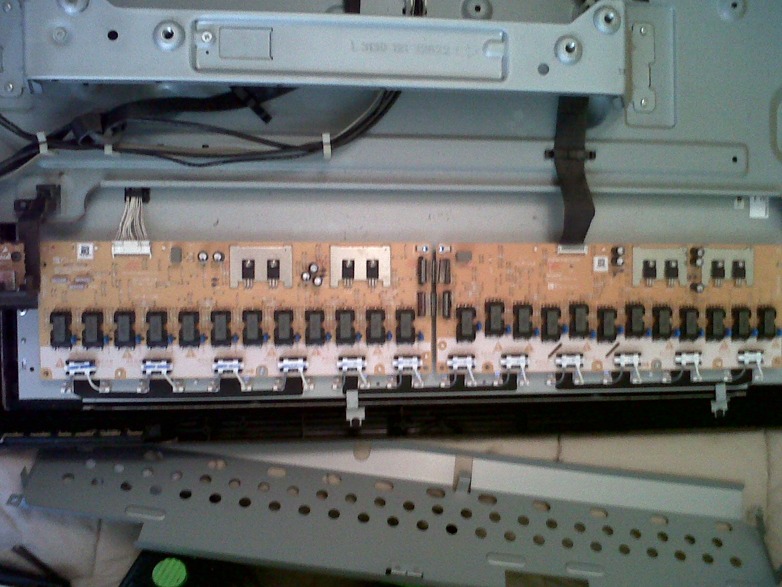

                            Neither of the manuals match the set I have. Mine has the inverter boards on either side of the chassis. However the wiring block diagram shows the inverters.

                                  It will be best then for you to post good clear pictures of the boards for us to see.
                                    Here is a picture of the boards.
                                      got the new ssb board, installed it, programmed the option no's. Got the same result as with the old board. I can see the menu and the back light is on, but when I try to do the setup assistant, the screen goes black, but with a flashlight I can see the images. What next. By the way I did not see the service manual that matches my tv.

                                        Just a follow-up post for anyone who needs the information. I purchased a DPS-168EP board for $60 and replaced it. It immediately fixed the problem.
                                        I have this same version of the 42PFL7422D/37 as this old post from last year. This is a TV without the ambilight with a build date of 2008. No master/slave inverter boards. Instead just the one DPS-168EP power board with two pairs of white wires going to jacks at the LCD panel edges. Symptoms were the same - sound but no video after turning the TV on (no light on the screen at all). Turning the TV on and off several times would eventually make it work.
                                        Just wanted to report that I replaced the DPS-168EP board (now $114 in December of 2012) and it did fix the problem. I can't see anything visibly burned on the old board. It looks like that large transformer is acting like a fluorescent ballast transformer for the cold cathode fluourecent tube(s) that light the LCD.
                                        Fluorescent ballasts arcing internally are a major failure item for building lighting with T8 and T12 tubes, so I imagine the same is true here. The ballast transformer is probably starting to short/arc internally. In TVs they often have shutdown circuits if something in the high voltage section starts pulling too much current. I'm guessing that when that transformer arcs on startup a shutdown circuit somewhere keeps the inverter off.
                                        The audio circuitry is on the video board. From the schematic in the manual for the chassis I see that video board has its own power supply fed directly from the AC power input, hence the sound but no picture symptom.
                                          There is not a board in my tv that resembles the DPS-168EP. Look at the picture on my previous post.
