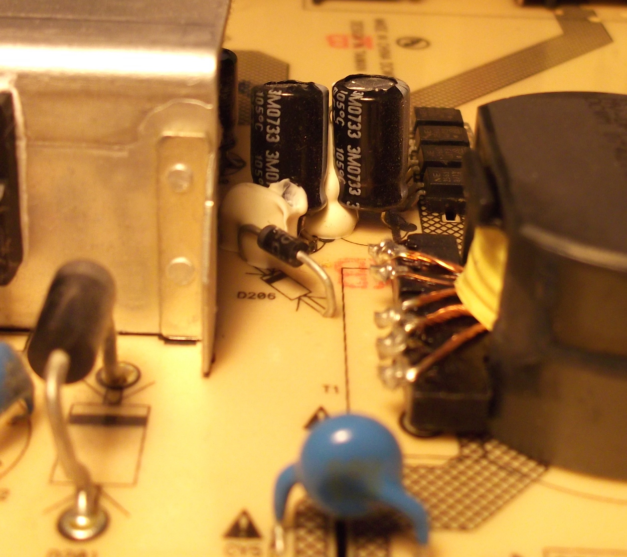

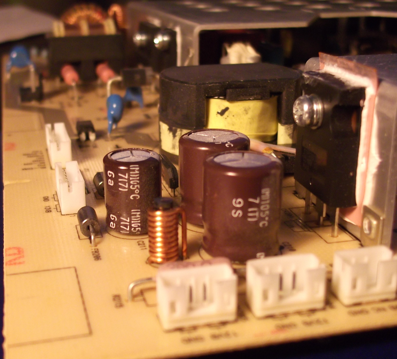

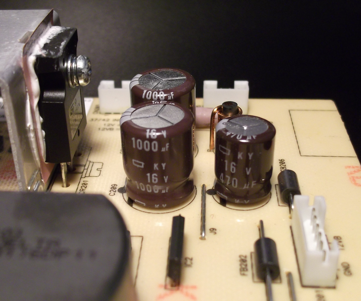

    retiredcaps: 1. I'll attached pics of the caps on the power supply.
    2a. The LED is Blue whenever it's powered up (blue is the only color I've ever seen on it). It comes on for a few seconds after plugging it in (standby warmup), then comes on and stays on when powered on either manually or by remote.
    b. There is sound.
    c. Backlights (ambilites) come on and respond as normal to video images (I think).
    d. When the video comes on after the long warmup, everything works as normal - menus, setup and settings
    f. Picture is good. (I normally run it off my laptop now, thru a USB to HDMI converter)
    3. Once warmed up it runs like a new TV and restarts quickly - haven't timed it, but will do that after reassembly.
    4. No inverter boards on this chassis (see chassis picture above)

                Ahh, I didn't notice that the overall pic and the power board pic is rotated 90 degrees. I see the inverter transformers on the power board now.
                The KY caps are normally a good United Chemi-con series.
                The symptoms are almost sound like classic high ESR caps. As the TV warms up, the cap's ESR drops and allows the circuit to work properly.
                Do you have an ESR tester?
