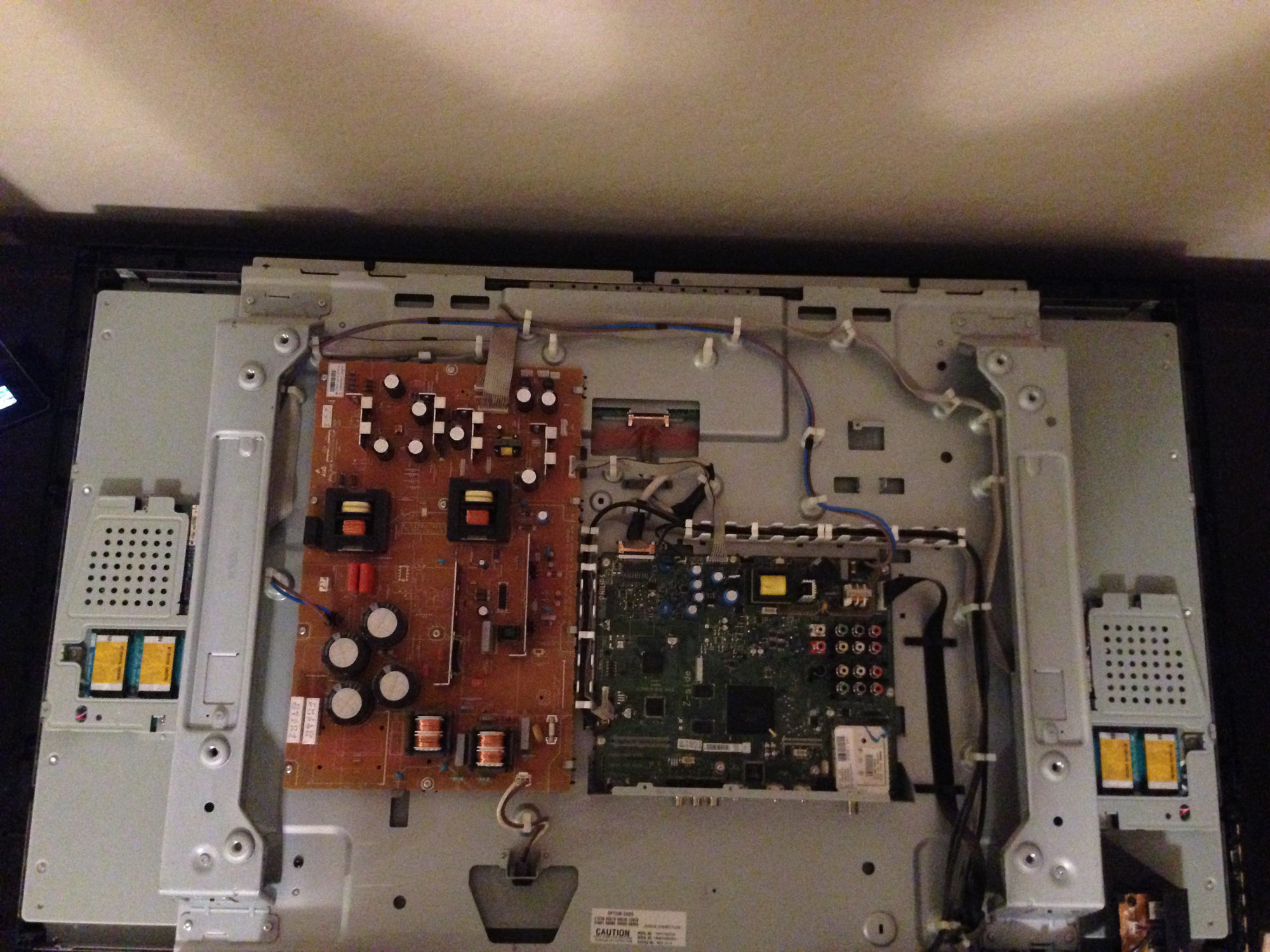

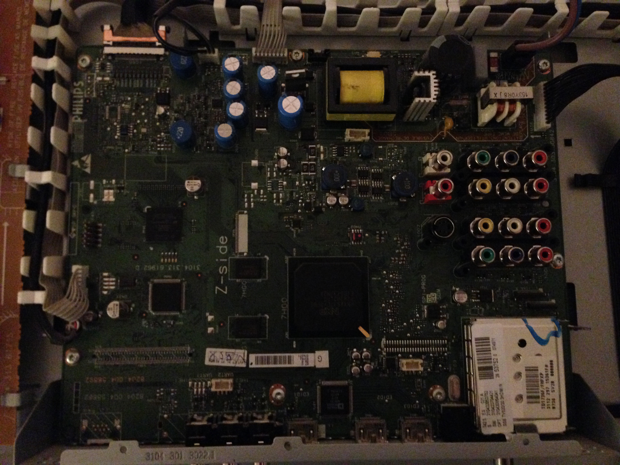

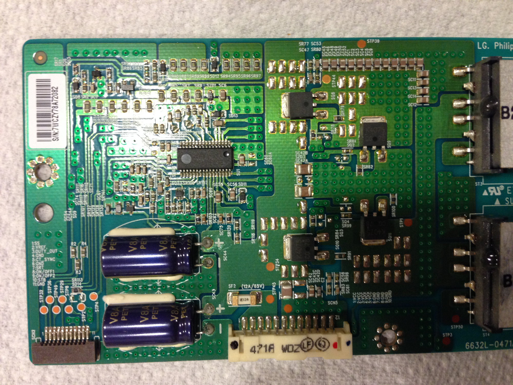

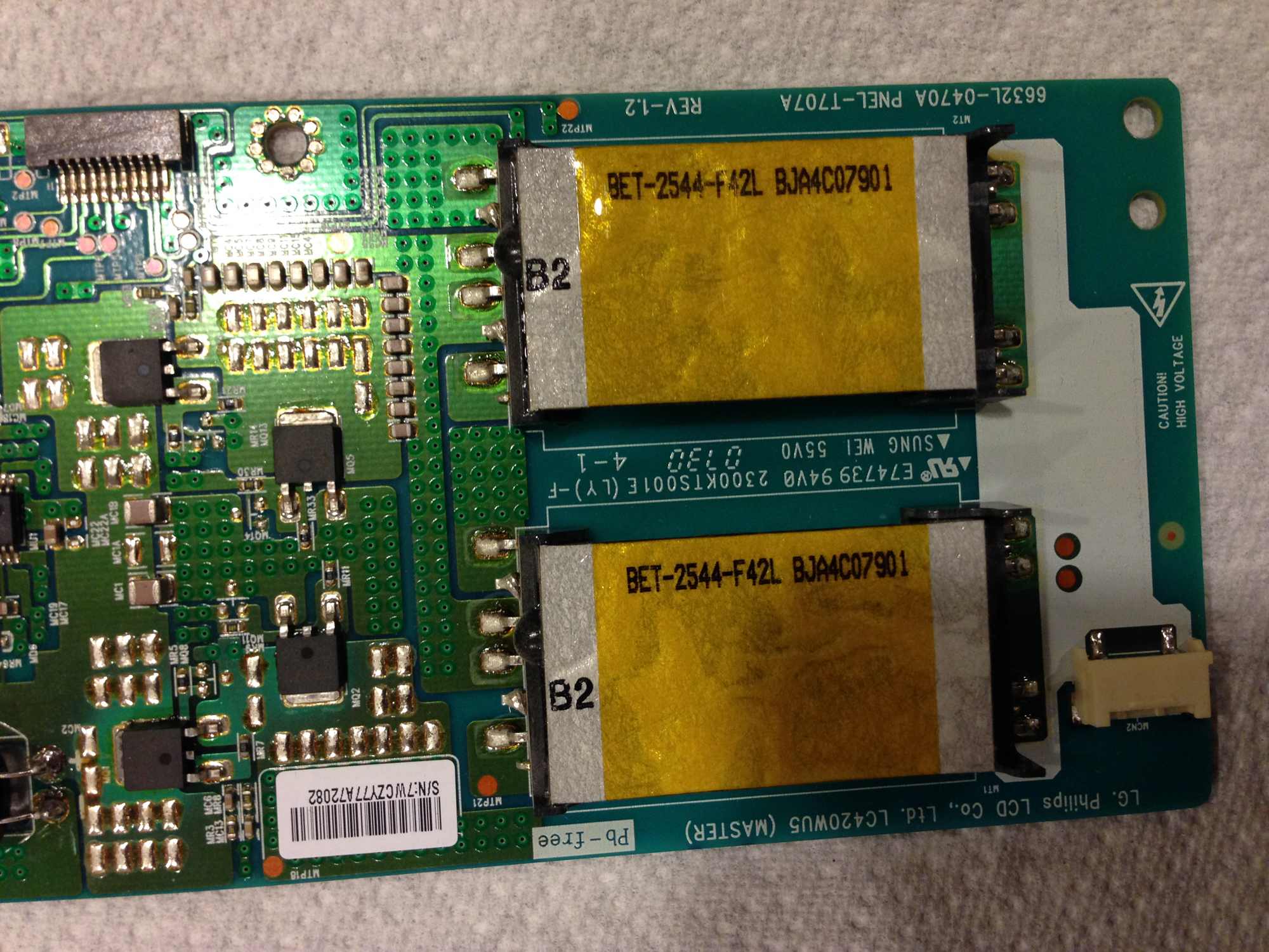

              This thread is great. I have a Philips 42PFL7422D TV as well and am having similar issues to others on this thread. I'm new to TV repair, though I have a little background electronics. I do not have any test gear so it's making this difficult.
              The main problem is that you turn the TV on, the blue power indicator light comes on and the screen flashes with the input bar "AV2" comes up and then the whole screen goes black after a couple seconds. I seem to be able to change the input on the TV, and I can hear audio, but the screen is totally black.
              I opened the TV up and saw that the Master Inverter board had a bulging cap. I've looked close at all the boards and can't seem to find anything else visibly wrong. I replaced the bad cap, which did not fix the problem. I went ahead and replaced the other cap on the master inverter and the two caps on the slave inverter board. Still has the same issue. I'm not really sure what to do next. I don't really want to buy a new set of inverter boards since I'm not totally sure if the issue lies there.
              Any help would be great. I'll attach some pictures. Please let me know if you need any further info. Thanks!

                I hate to say it but...without any test meter, that's the safest bet. Its a 75 percent chance that its an inverter problem. Id feel a lot better if you can prove it though. Borrow a meter maybe?

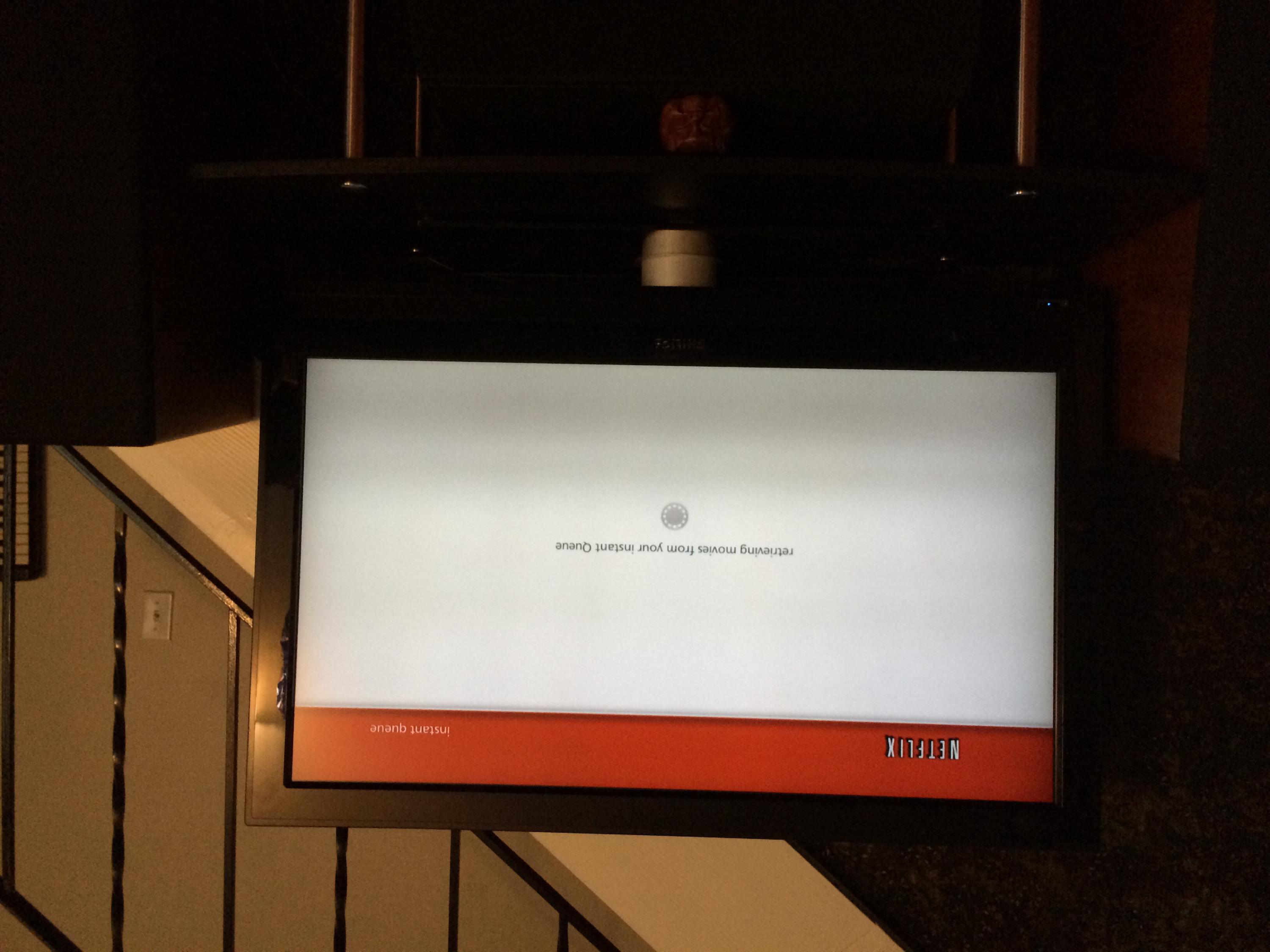

                          How bad is the line? Pictures
                            Re: 42PFL7422D/37 Service Manual Needed
                            I will see if it shows up in a picture, but it was a soft darkened line about an inch up from the bottom of the screen and about 1-2 inches wide. Let me try and get a picture.
                              Here is a picture.
                                The discoloration/line goes away after 15-20 minutes. ???
