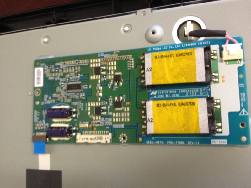

          What are the resistances across the four fets on each inverter board?

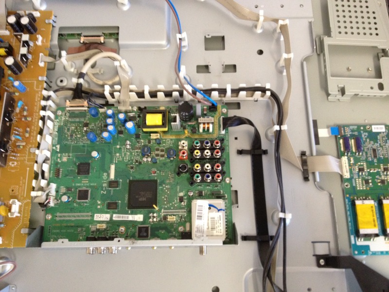

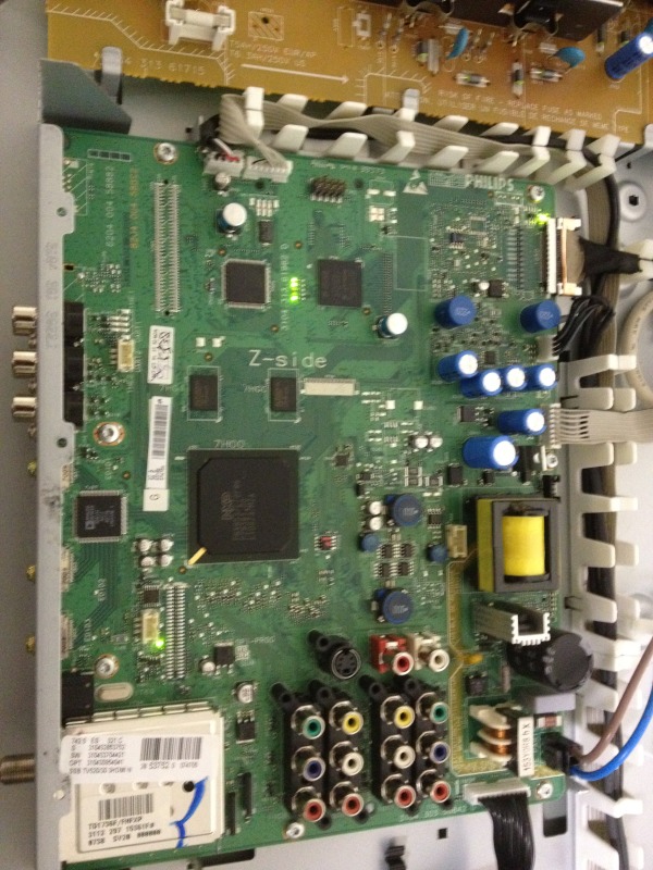

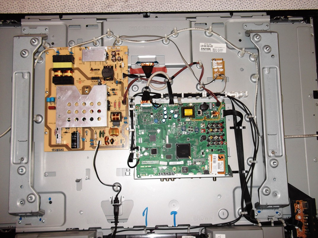

                      Thanks. My skill levels are dated, but I can usually take on a challenge like this successfully. My multimeter is an old analog - reliable, but maybe limited in setting options. I have the necessary soldering equipment and will pick up any supplies that seem necessary for this job. I do not have a scope or a capacitor tester - hopefully I won't need one.
                      I double checked the image with a flashlight on cold startup. Previously I thought there was no image, but in fact it is there, just not lit up.

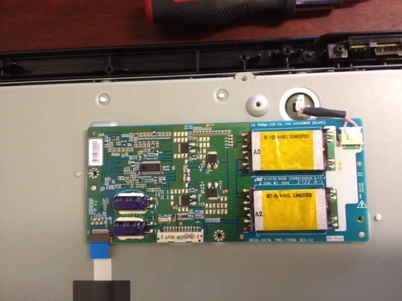

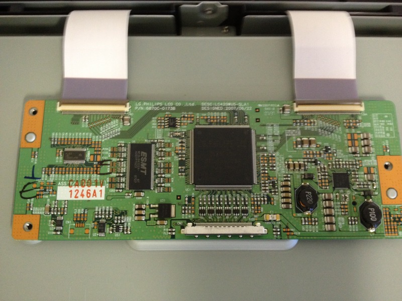

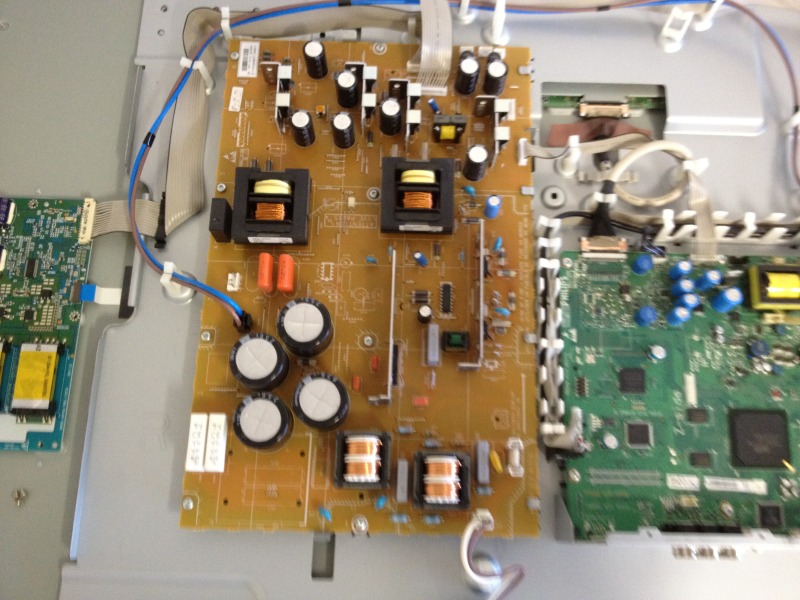

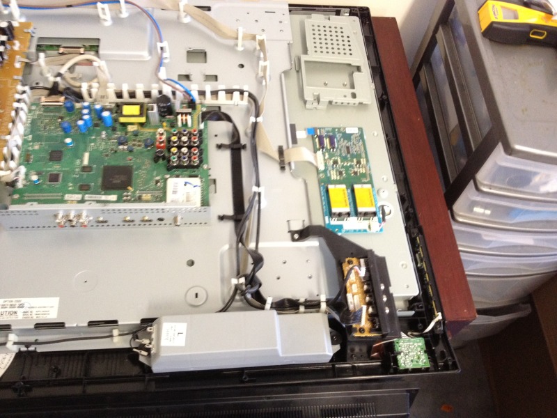

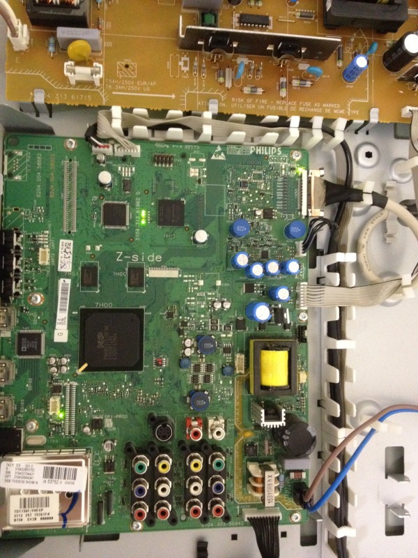

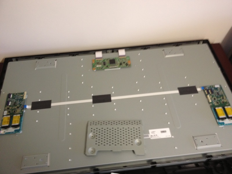

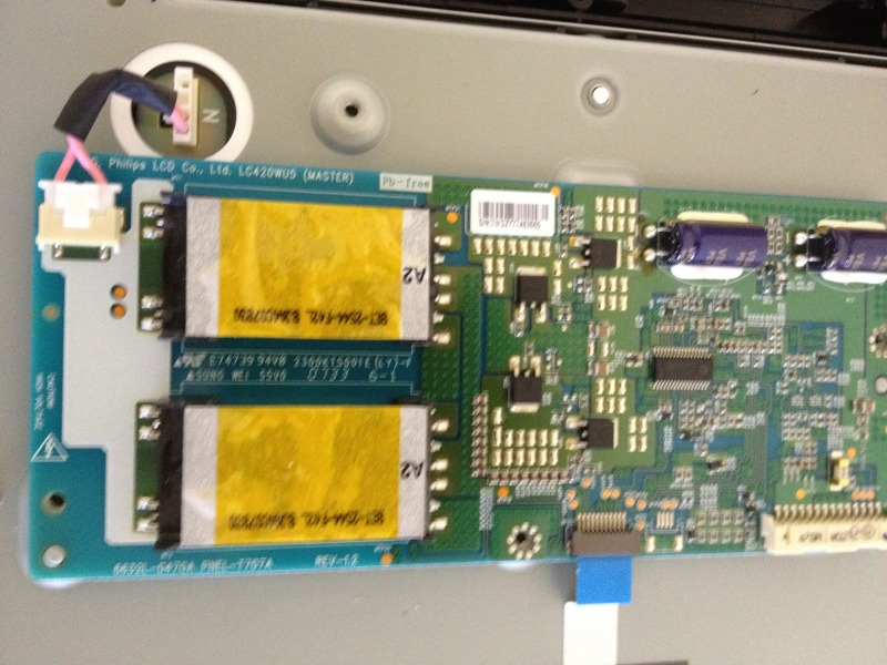

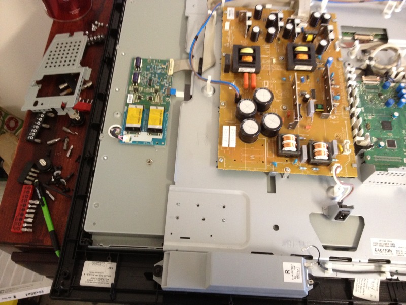

                      I've taken out the two boards and have attached pictures. The fuses test fine but now I probably need further direction if possible .

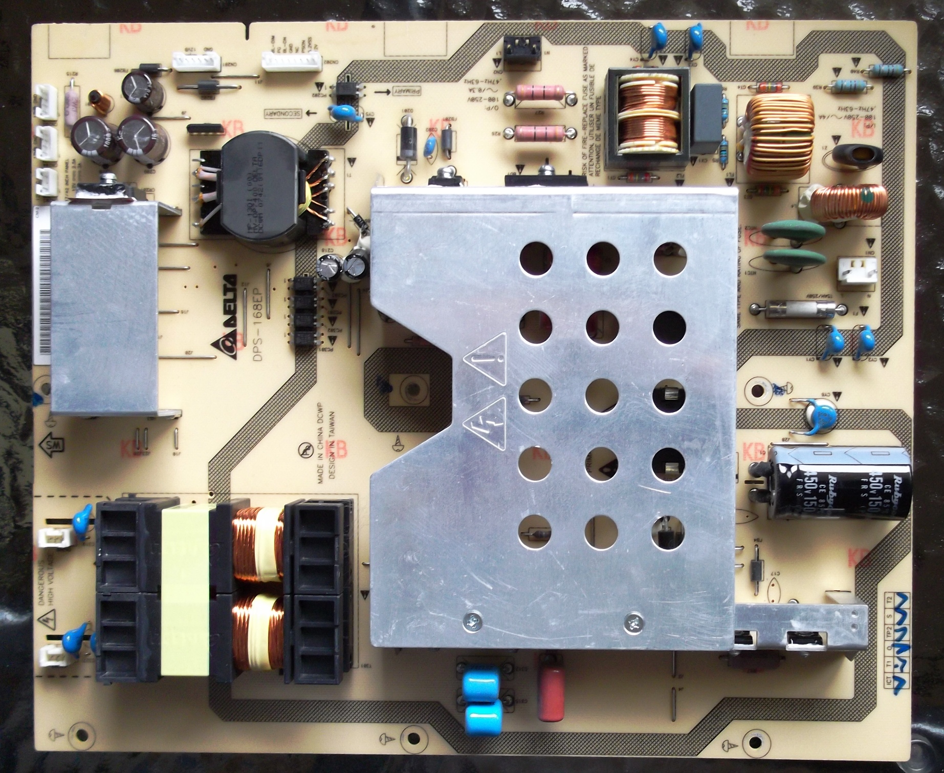

                        OK, you power board is a combination Power supply/Inverter board. Do you happen to have chassis number of this 42PFL7432D/37, Philips sometime will use the chassis number.
                        I will look for service manual for it, at least right now the 5VDC (it may use 12v) standby is working.
                        Can we see the closed up pictures of the connectors on the PWR/INV board, I can see some labeling on them.

                          Re: 42PFL7422D/37 Service Manual Needed

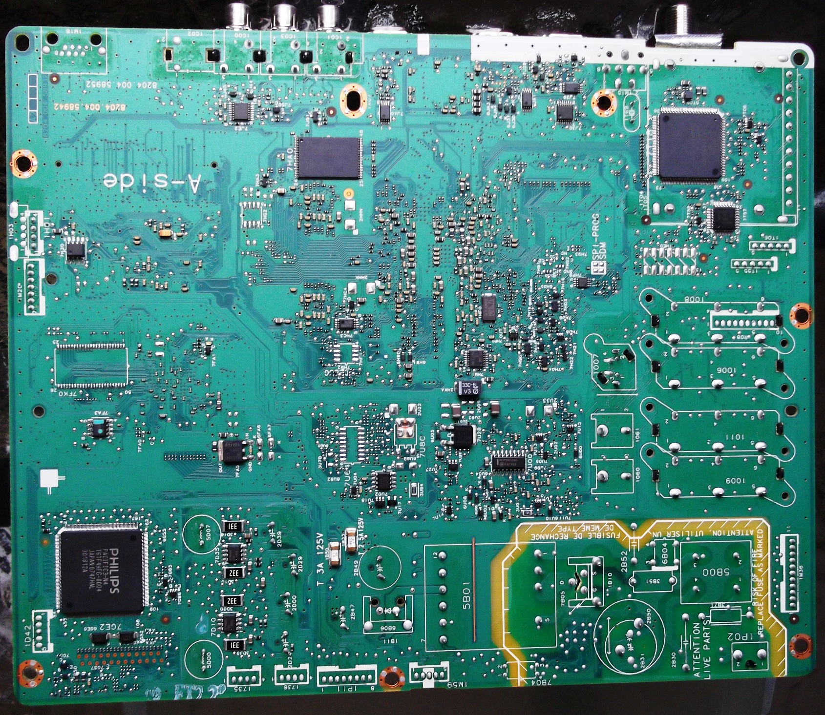

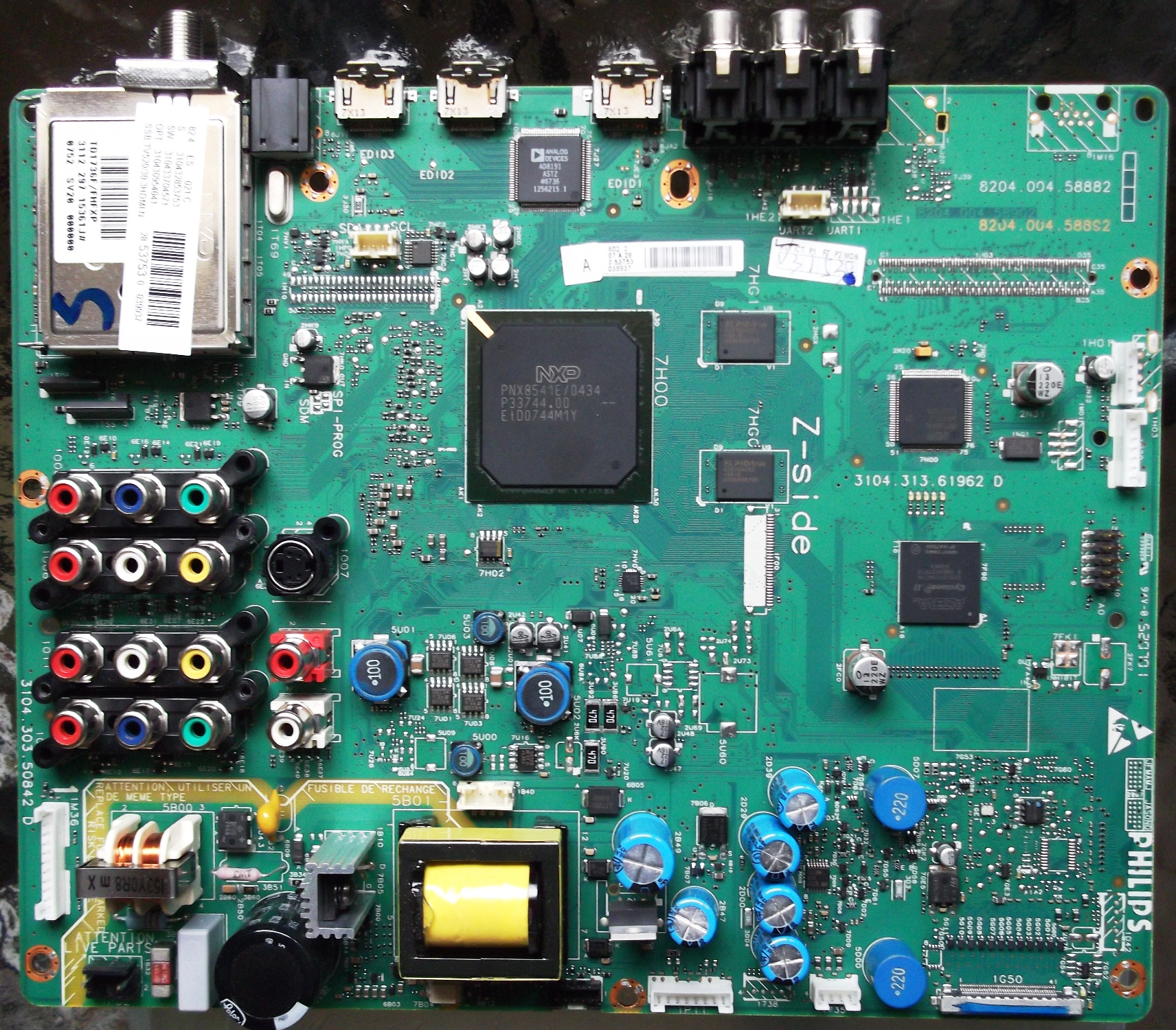

                          The pictures are excellent - thankyou- wish all looked this clear. On the main board are the blue caps Lelon brand -they seem to fail quite a lot and may cause the problem you have described, as when they warm up they work a bit better.
                          I think we might struggle to find a SM as it didnt turn up earlier in the thread. The main
                          board is used in a few sets Compatible models:
                          PHILIPS 47PFL5432D/37 PHILIPS 47PFL7422D/37
                          PHILIPS 47PFL7432D/37 PHILIPS 52PFL7422D/37
                          Board Part Number:
                          310430350842D 310431361962D
                          820400458882 820400458892
                          Manufacturer Part Number:
                          Philips 310432855232 Philips 310432853762 Philips 310432852301
                          I would start listing these lelon caps ready to order.
                          EDIT just noticed the BIG black cap on the main board is also a Lelon (lemon) Next time you have all the boards back together try heating this big cap with a hair dryer and see if it comes on quicker - you can try the same with the group of blue lelons as well. (allow to cool between the two tests.

                                4) Can we get pictures of the inverter board? Have you checked the caps on there?
