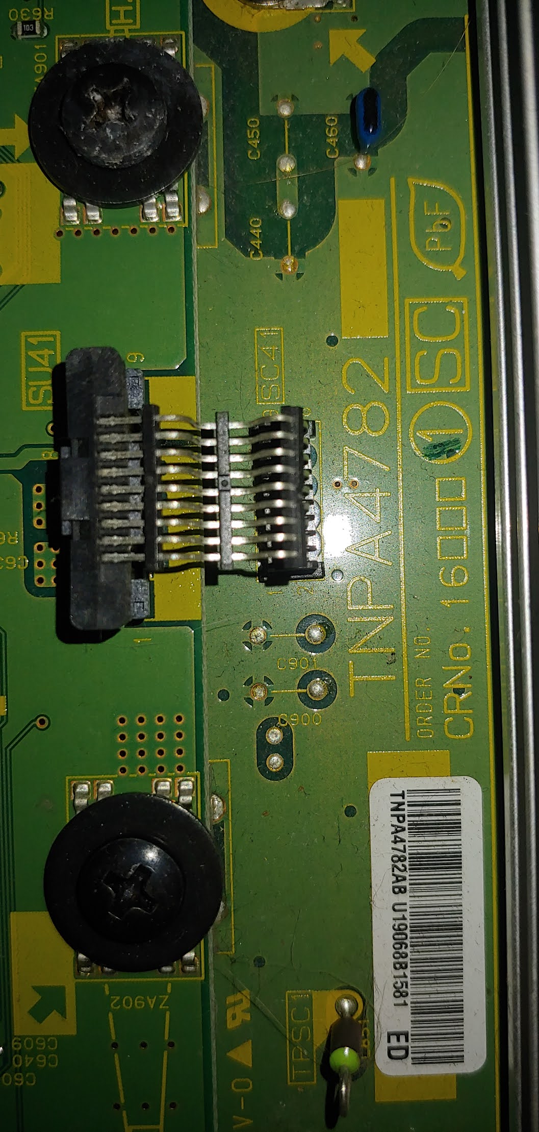

          Re: Panasonic TC-P50G10 DEAD
          Yep plot thickens look what I found on the sc board.
              Well it appears I can spend $200 on a used good sc board or spend like $70 on a repair kit for the sc board. I think I will just have to throw in trash if not economical to repair.
                  Reading a few threads people do fit the sc kits only to turn the tv on and board blows up again (missed one faulty part etc thats not in kit) maybe some boards are salvagable for re sale/spares so not a total loss.
                    Yep and that just confirms it every where on the interwebz you here of people replacing like $200 in boards to still not have it work well sorry but this one unfortunately is going in the e-waste bin.
                      Not totally e-waste, you can disconnect the SC board and test if everything else works, remove the cable from P-Board to SC and the flat from A-board to SC, it should come on with no image but green light, VSUS, Vda and VE on the SS board.
                      The A board has some value plus the power supply.
