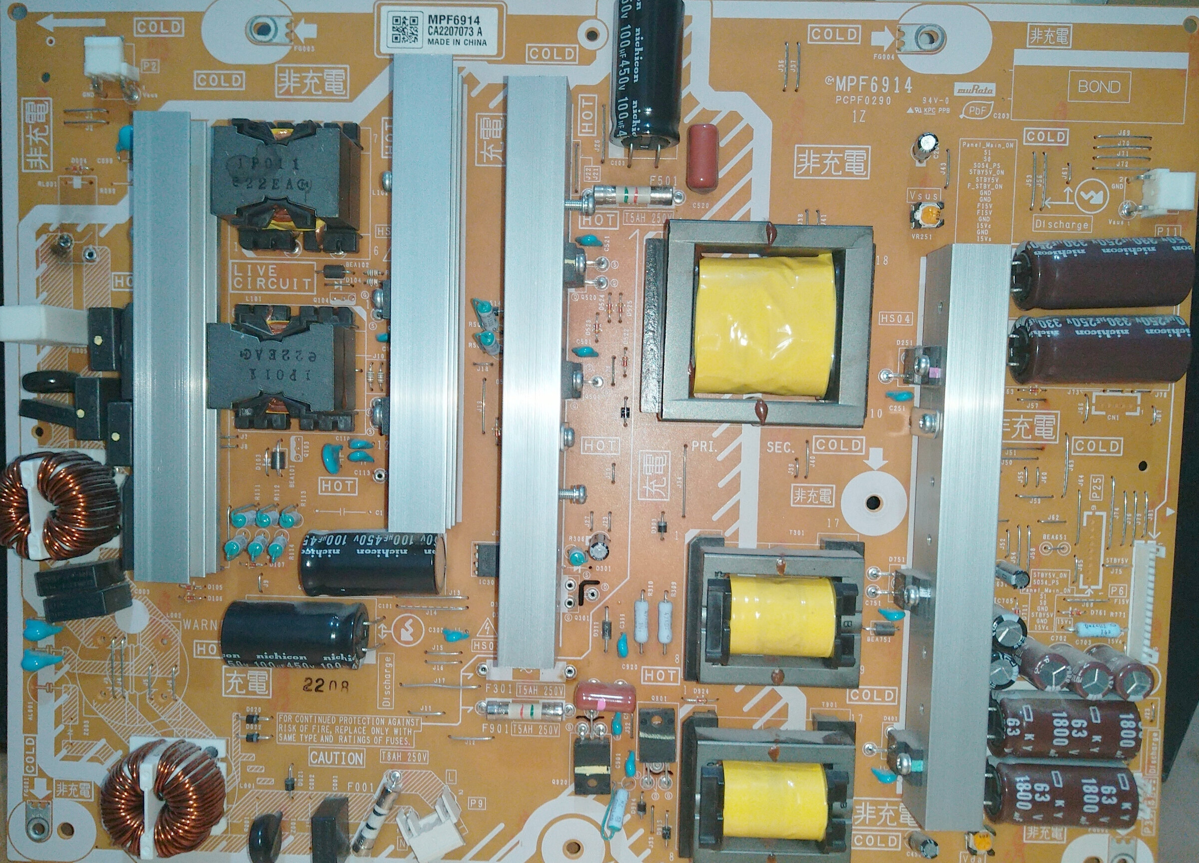

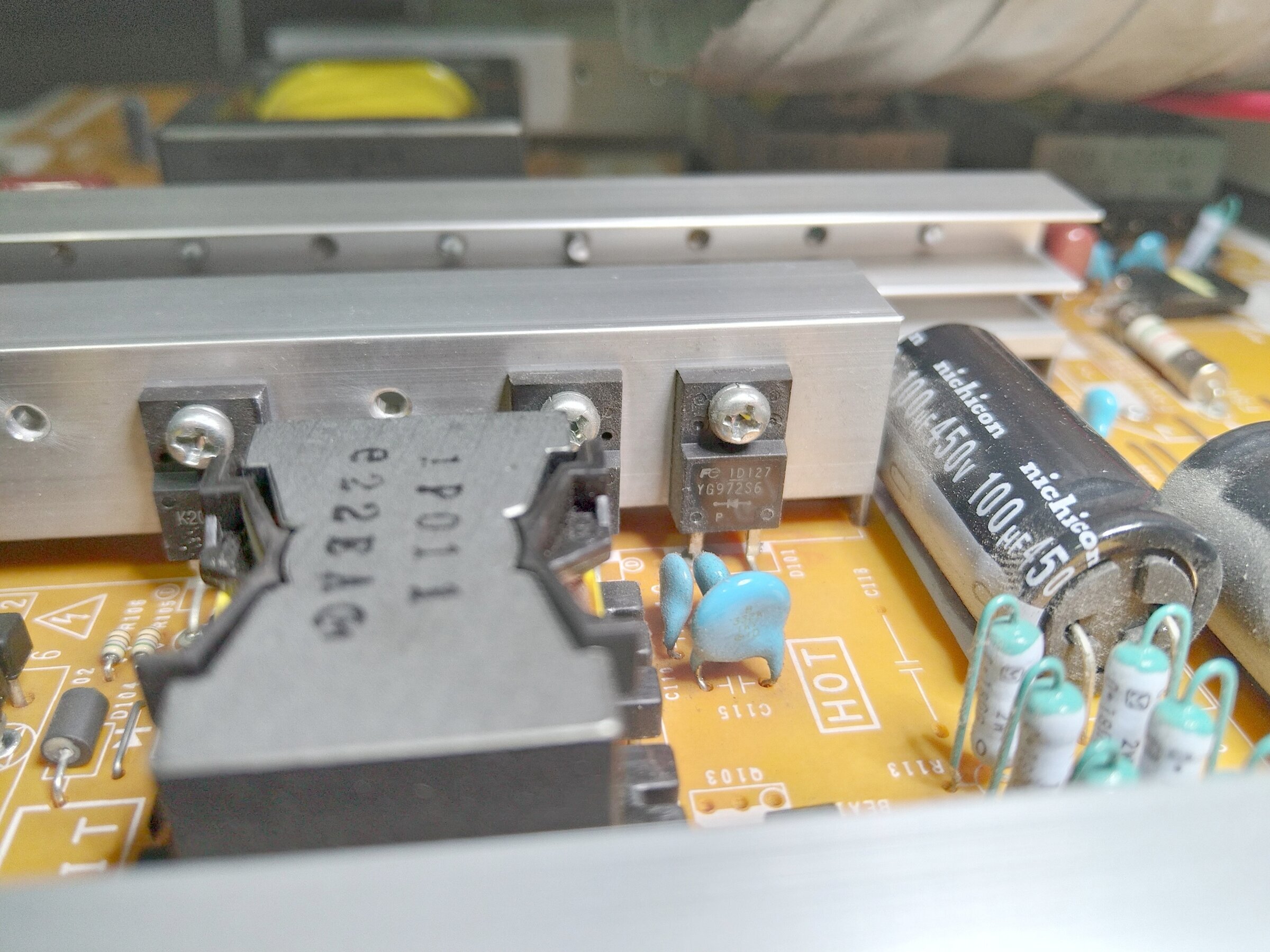

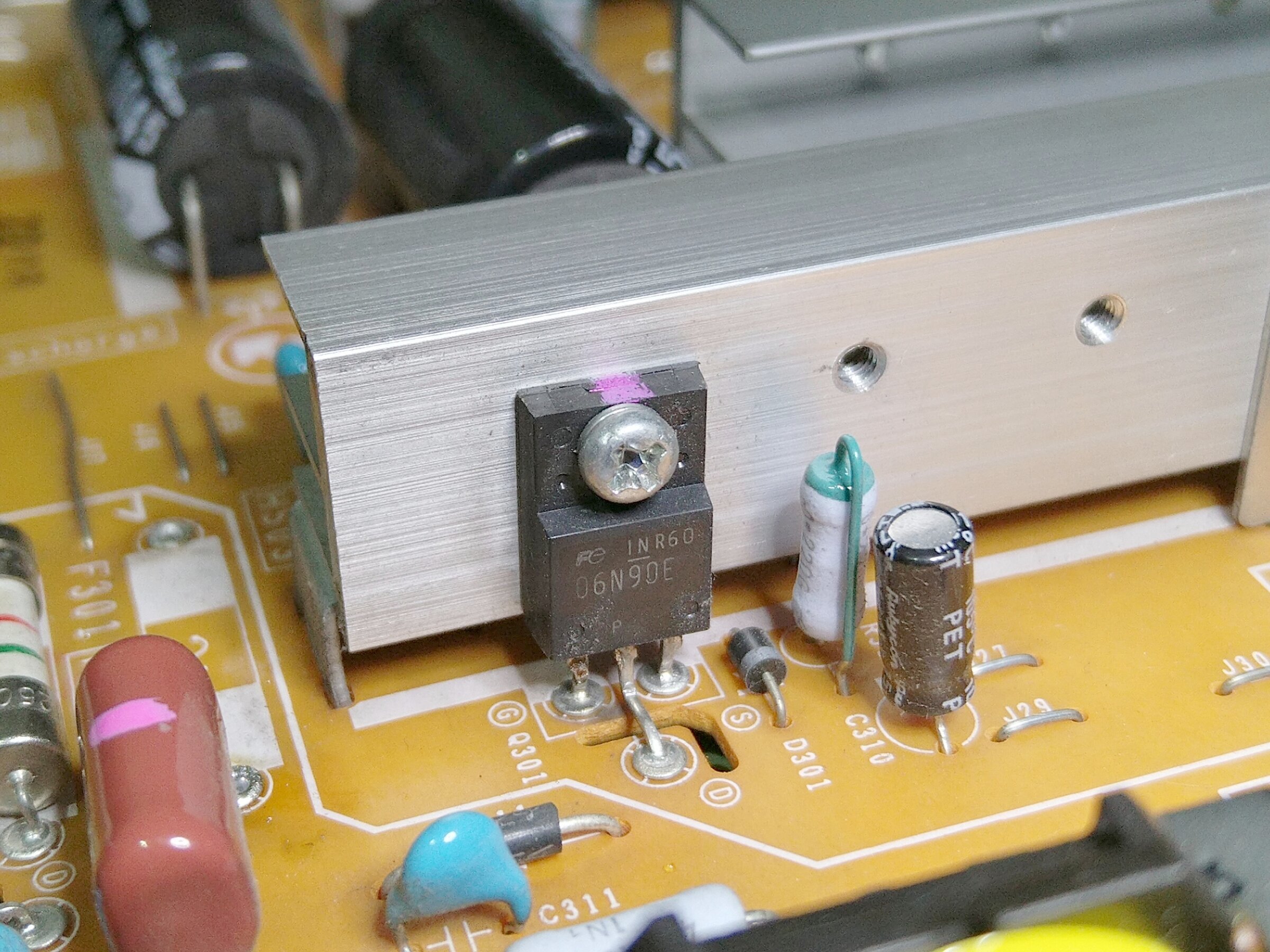

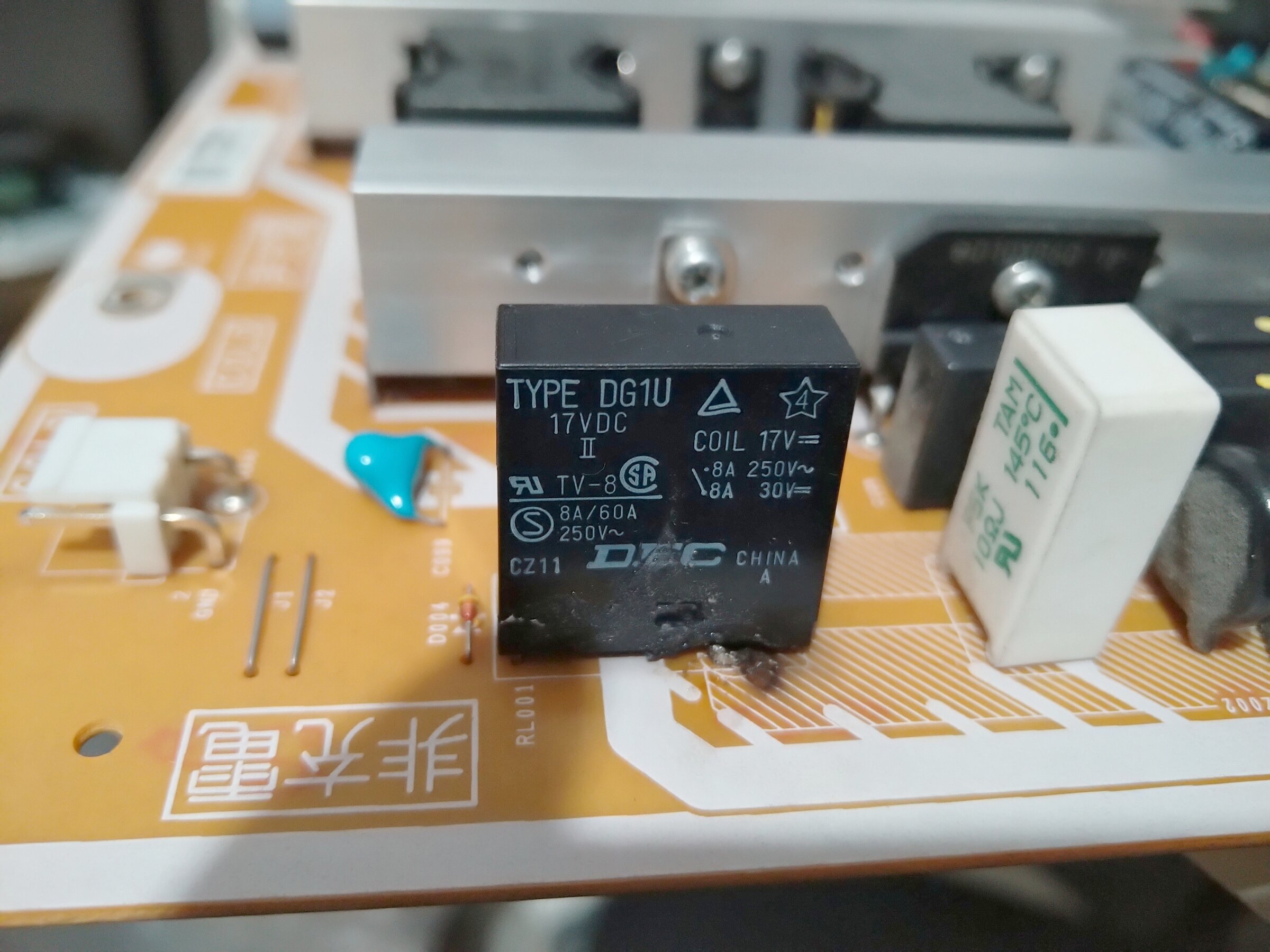

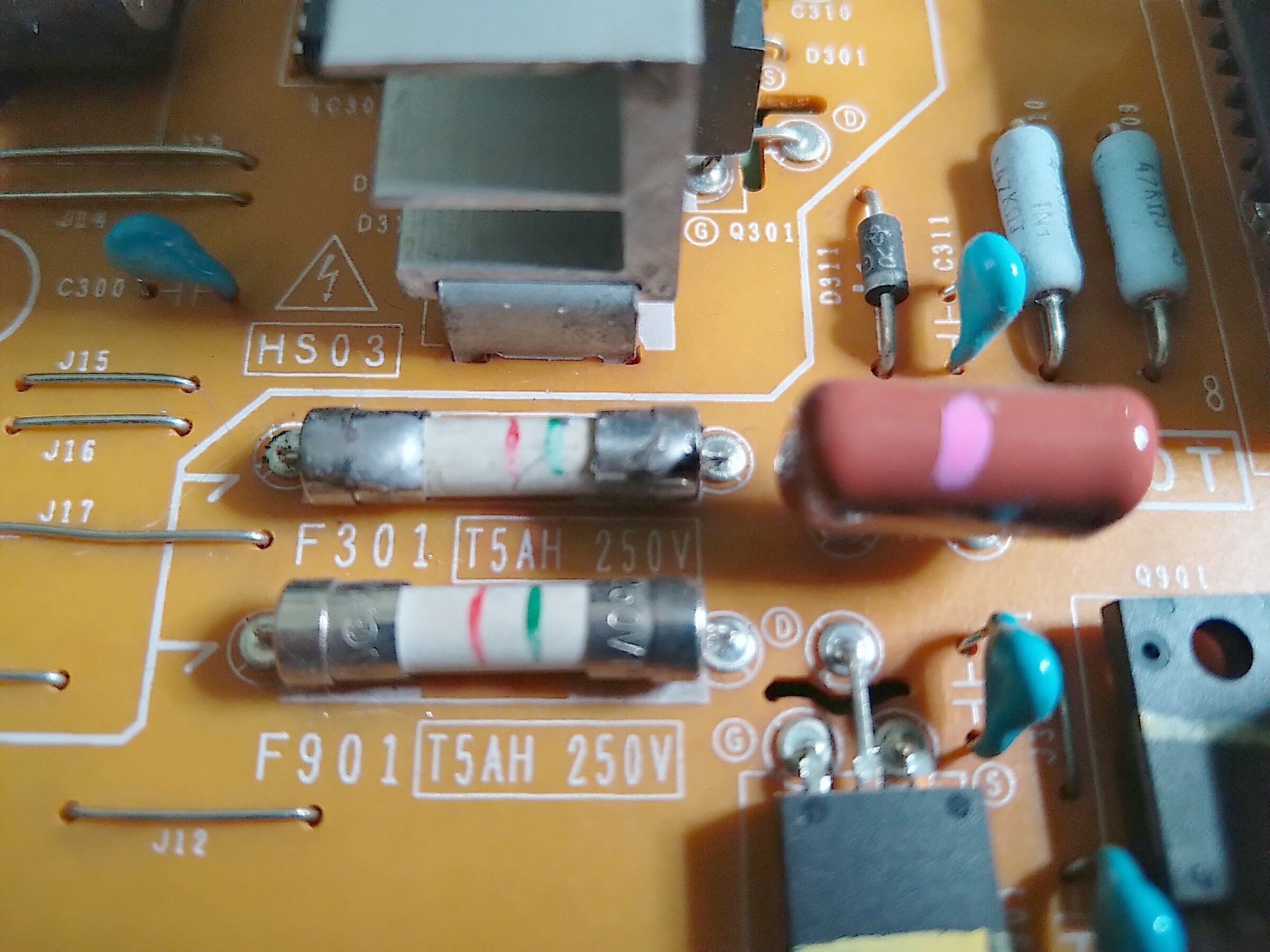

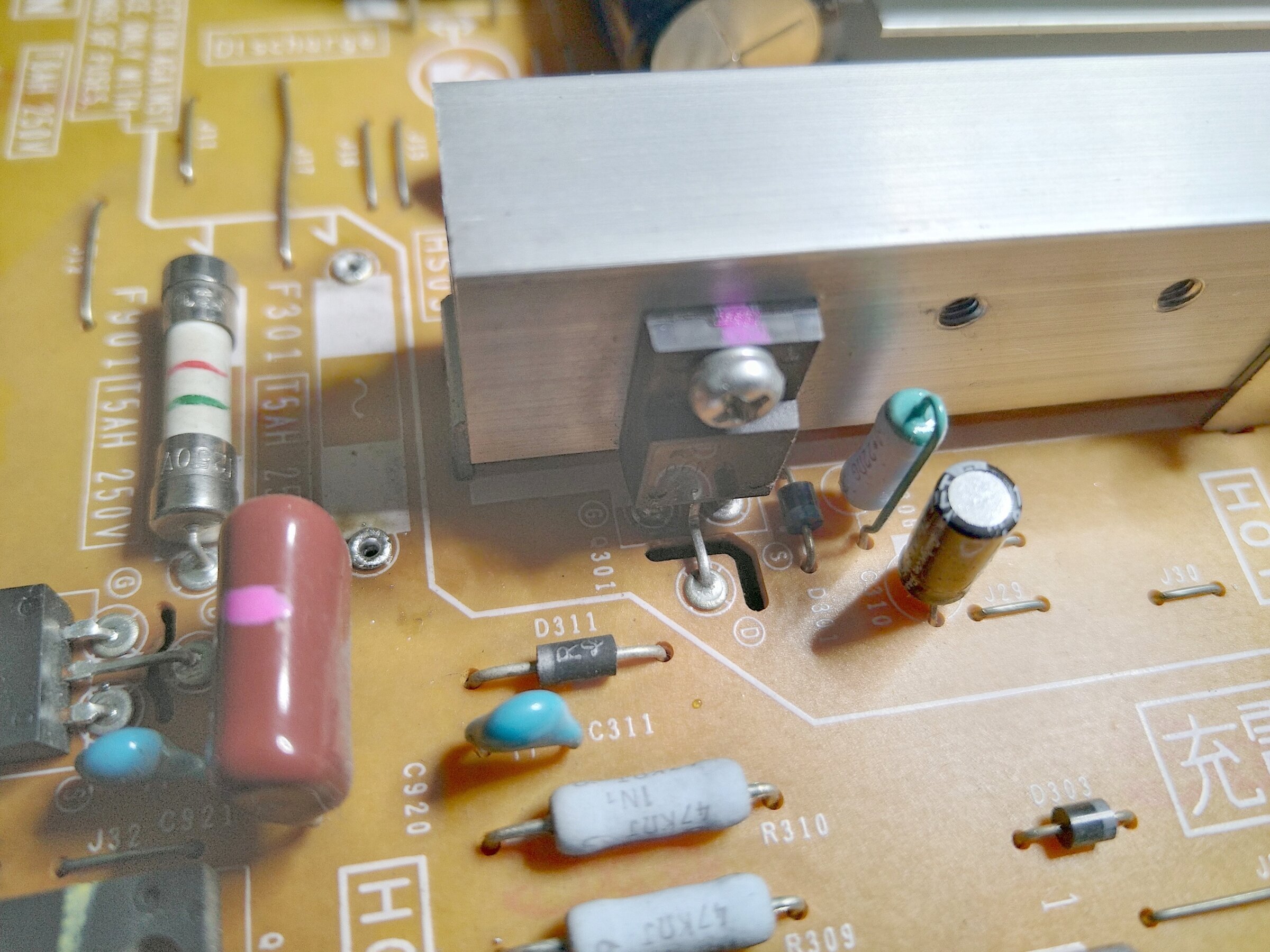

    Hello, got a ST50 plasma TV for repair. No signs of life, not even blink codes. Opened it up to check the power supply, type MPF6914. Apparent issues from visual detection and measuring for shorts:
    Diode type G972s6 - D101 with a short
    Mosfet 06N90E - Q301 shorted
    Fuse T5AH 250V - F103 blown
    Diode D301 shorted
    Relay DG1U-17VDC II - RL001 blown
    I have not found a circuit diagram. Maybe someone here already dealt with a similar issue? Thanks for tips where else to check 😀

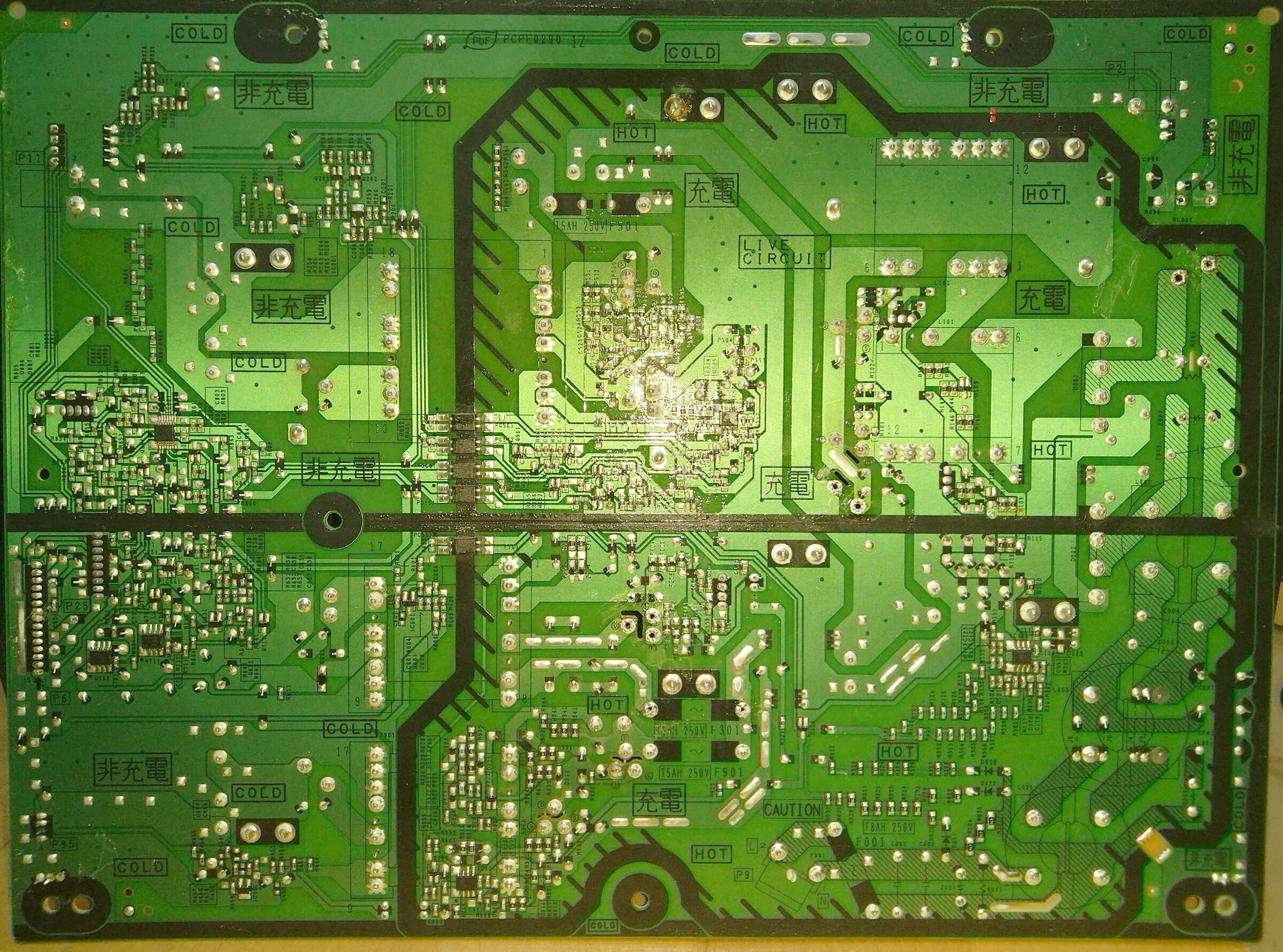

    Good picture of top and bottom of the board? Check preferably my sticky note on photos.. and maybe better to mark where the bad pieces are..
    • badcappo
      • Jun 2018
      • 20
      Parts in question and two pcb shots attached
      • badcappo
        • Jun 2018
        • 20
        Anyone with more info ?

          i wonder if you followed my.sticky note, because i'm unable to see photos on my cellphone..
