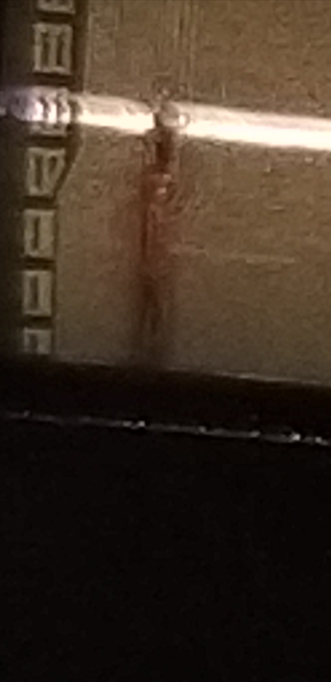

                        Re: LG 55UK6950PLB backlight but no picture
                        Found the fault! Burnt out on one of the tab bonds.
                        Not a very good photo, sorry but you get the idea.
                        So this ones toast! Shall strip down for parts.
                        Thanks for the help! Appreciate it!!!

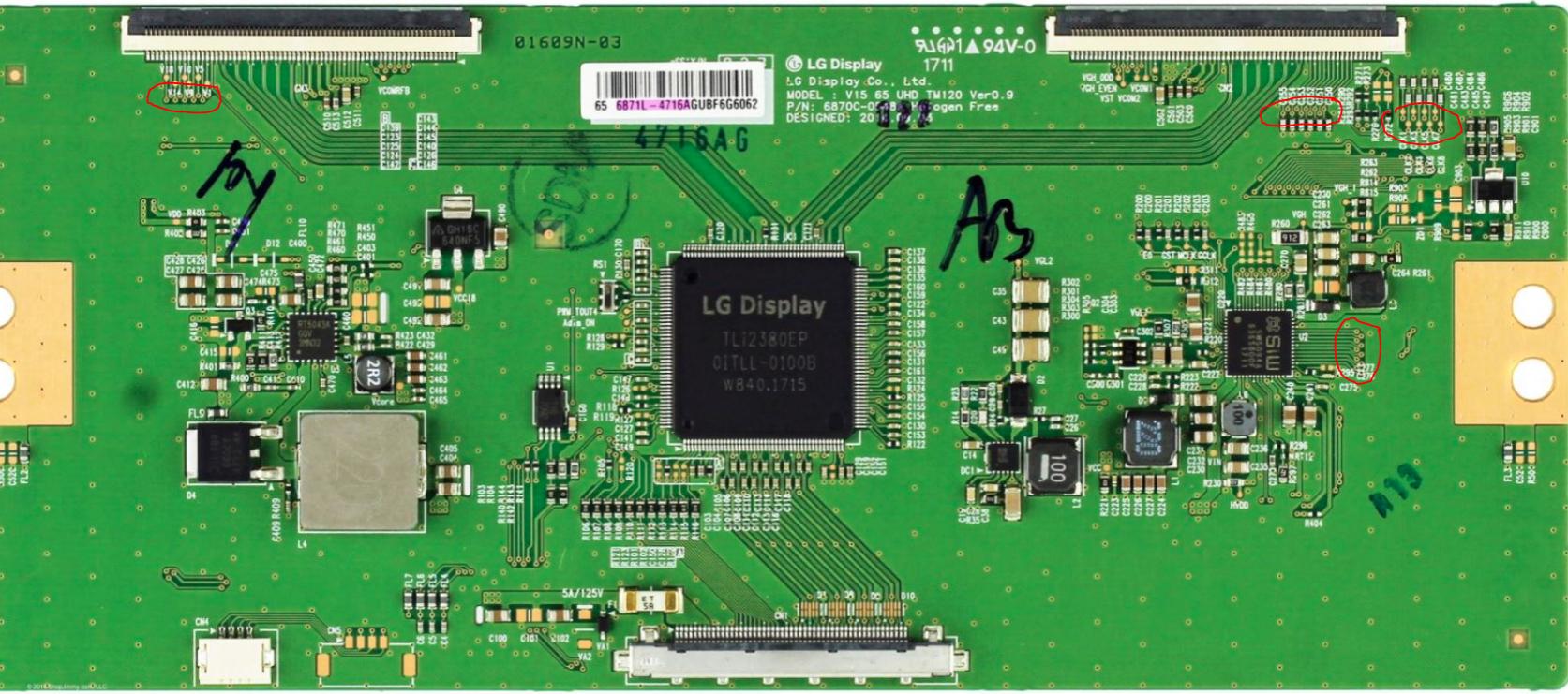

                                  tape cutoff method, video there and many more, youtube: https://www.youtube.com/watch?v=pfrRhw7-ZII

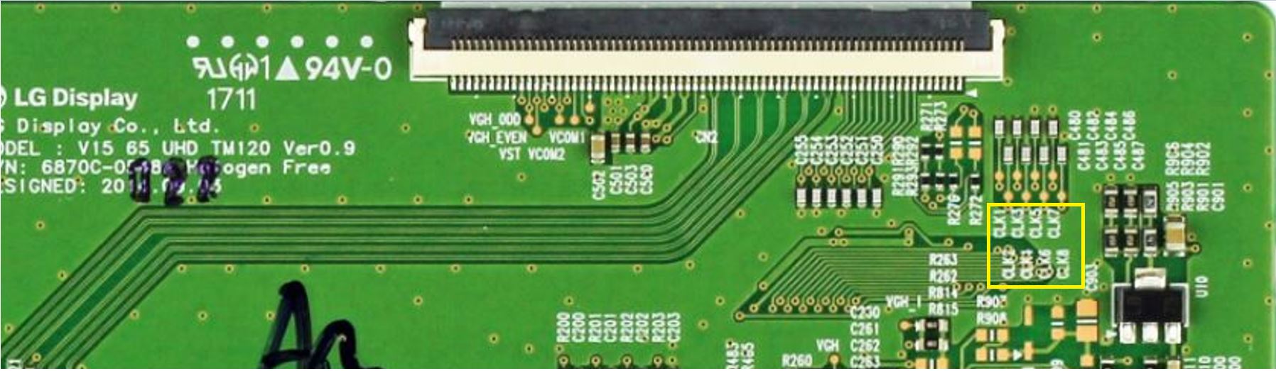

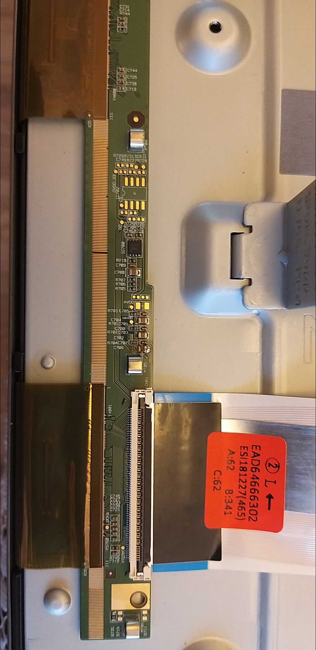

                                    This is my t-con
                                    I see CLK 1-8 on the top right of my t-con, but unlike his board, which shows the lines going to the ribbon area, in mine, I see no lines like his were.
                                    So how do I know which one's to tape?
                                    Thank you.
                                      Originally posted by viewerau
                                      thank you...
                                      This is my t-con
                                      i see clk 1-8 on the top right of my t-con, but unlike his board, which shows the lines going to the ribbon area, in mine, i see no lines like his were.
                                      So how do i know which one's to tape?
                                      Thank you.
                                      ckv
