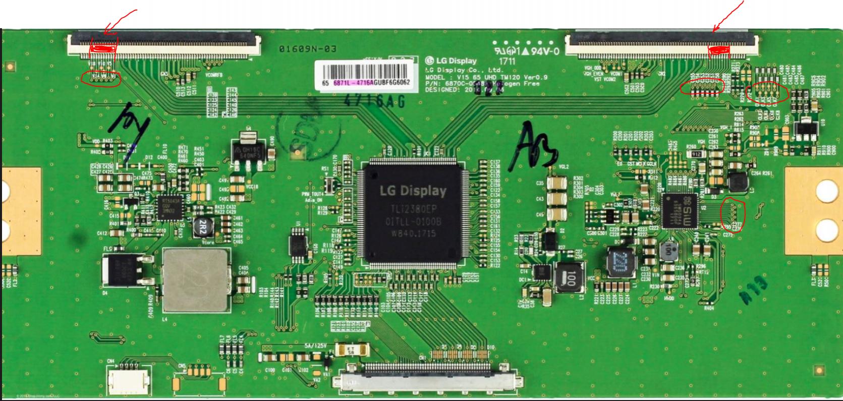

    Originally posted by viewerau
    Hi lotas.
    I am sorry, I do not understand your reply...my apology.
    These signals go to these contacts (on the left and right strips of the panel), if you know on which side the CLK signals are defective, then isolate that side with tape.

        Originally posted by William1967
        The panel has a problem, it's a common fault with these models and several other models from LG. The AVDD must be around 17v and is only present on one side when you disconnect one of the LVDS cables.
        Hi , Sorry for just jumping into this thread, but I have exactly the same problem, I'm going to post my own thread, but I am curious, did you mean that the panel is cattled if the AVDD is 17v on one side only ?
        When I have the left side LVDS connected I have 17v on the left side and 3.9v on the right side but I get 0v on both sides when both LVDS connected or just the right side LVDS.

                  Just an update on this post I had one of these come in no picture right side looking at the back of the TV AVDD is 17v left side is 7v on the left side I missed the first two traces out on the lvds connector then using a piece of paper about 3mm width blocked the faulty signal
