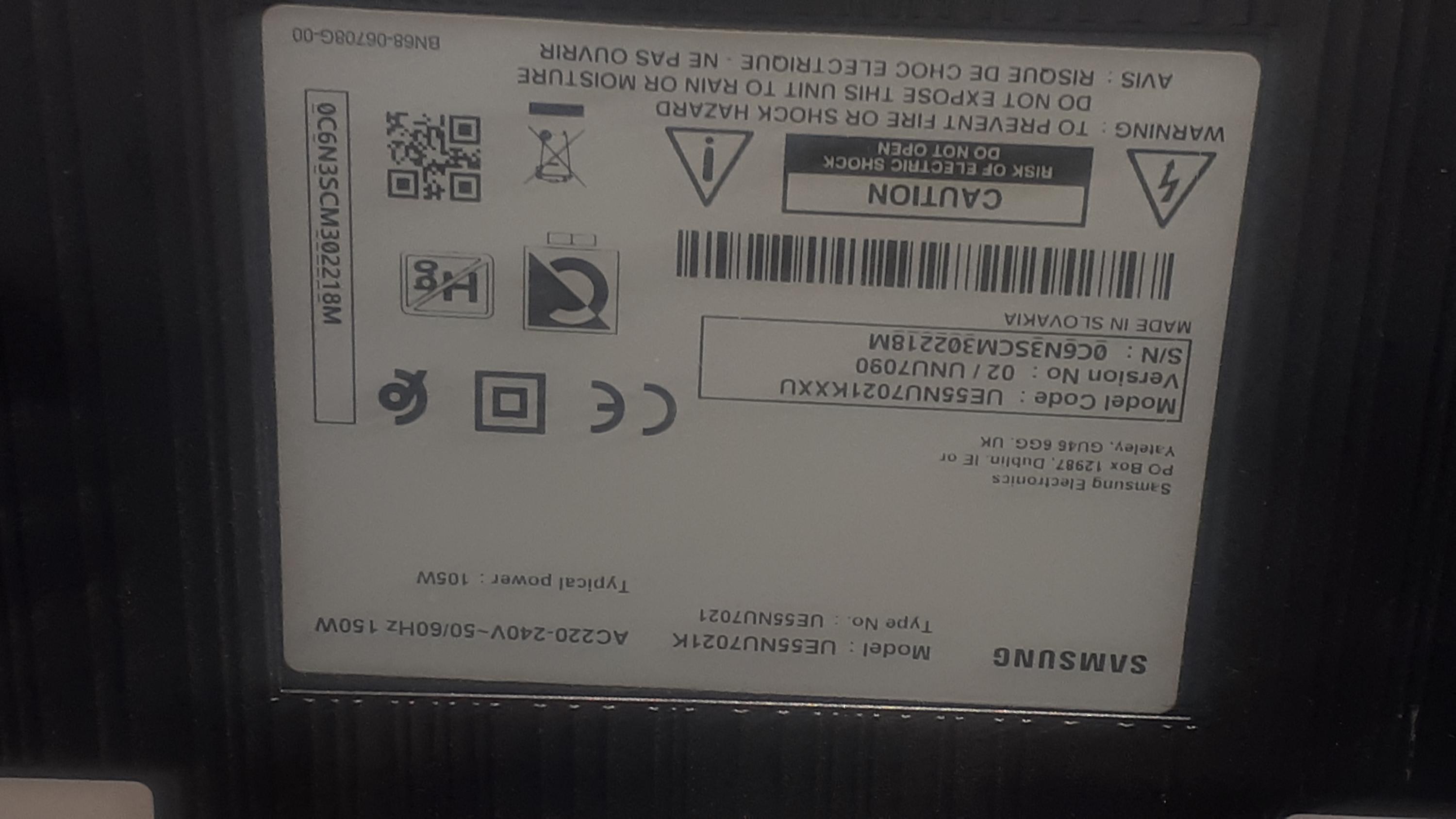

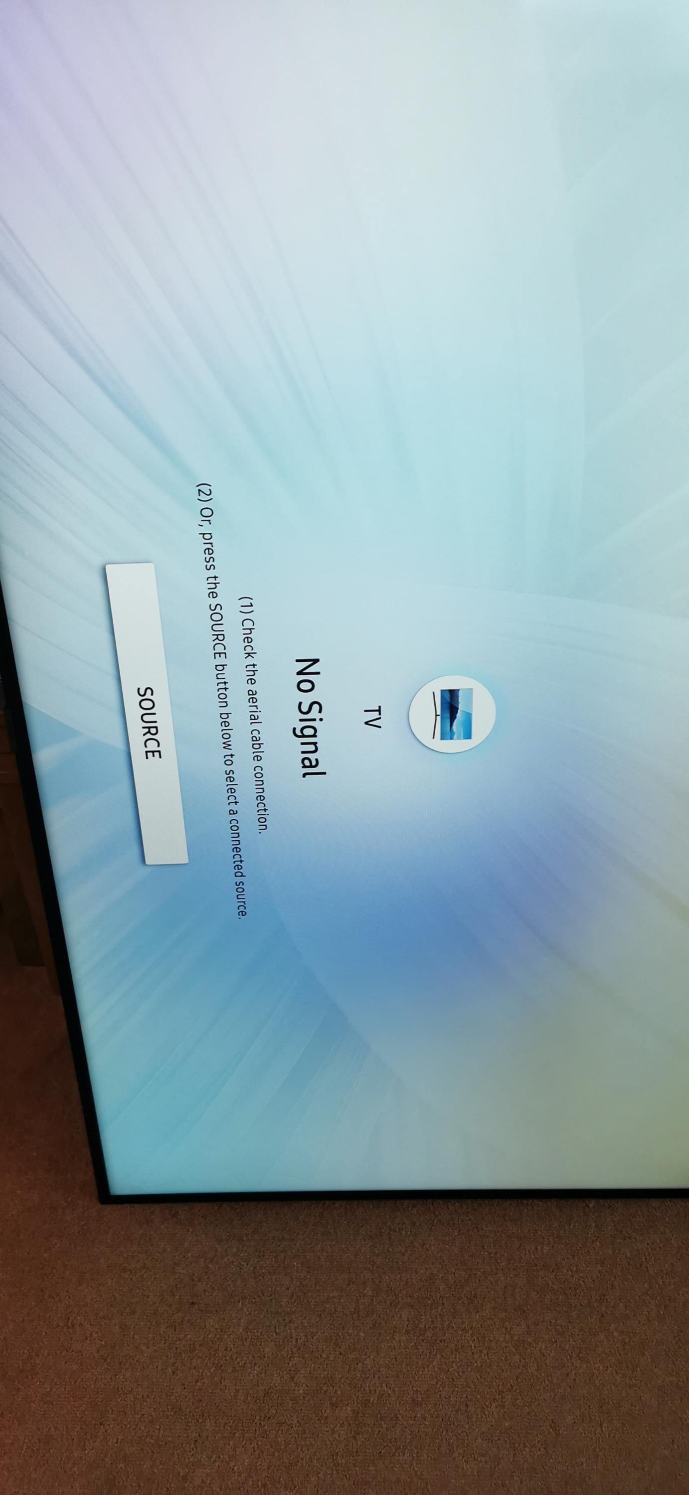

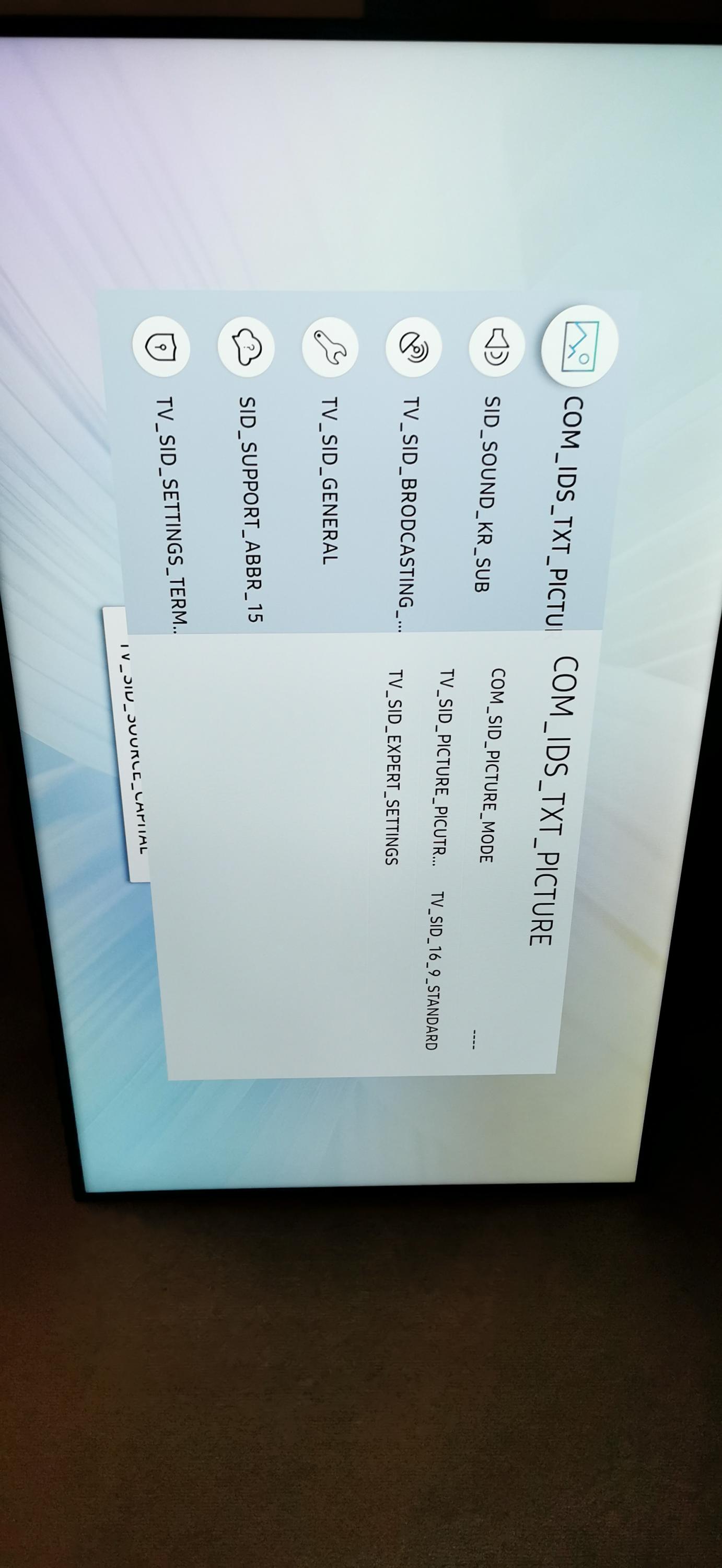

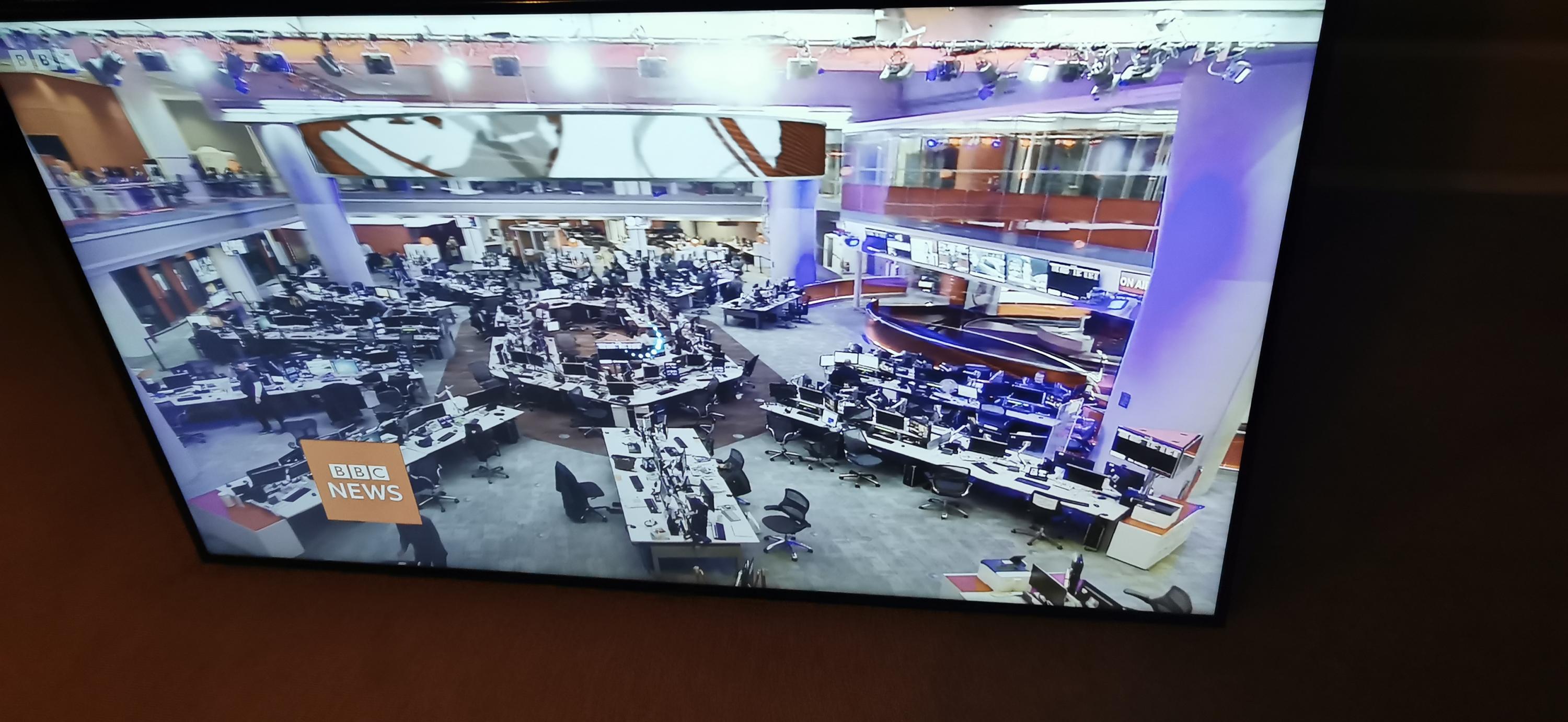

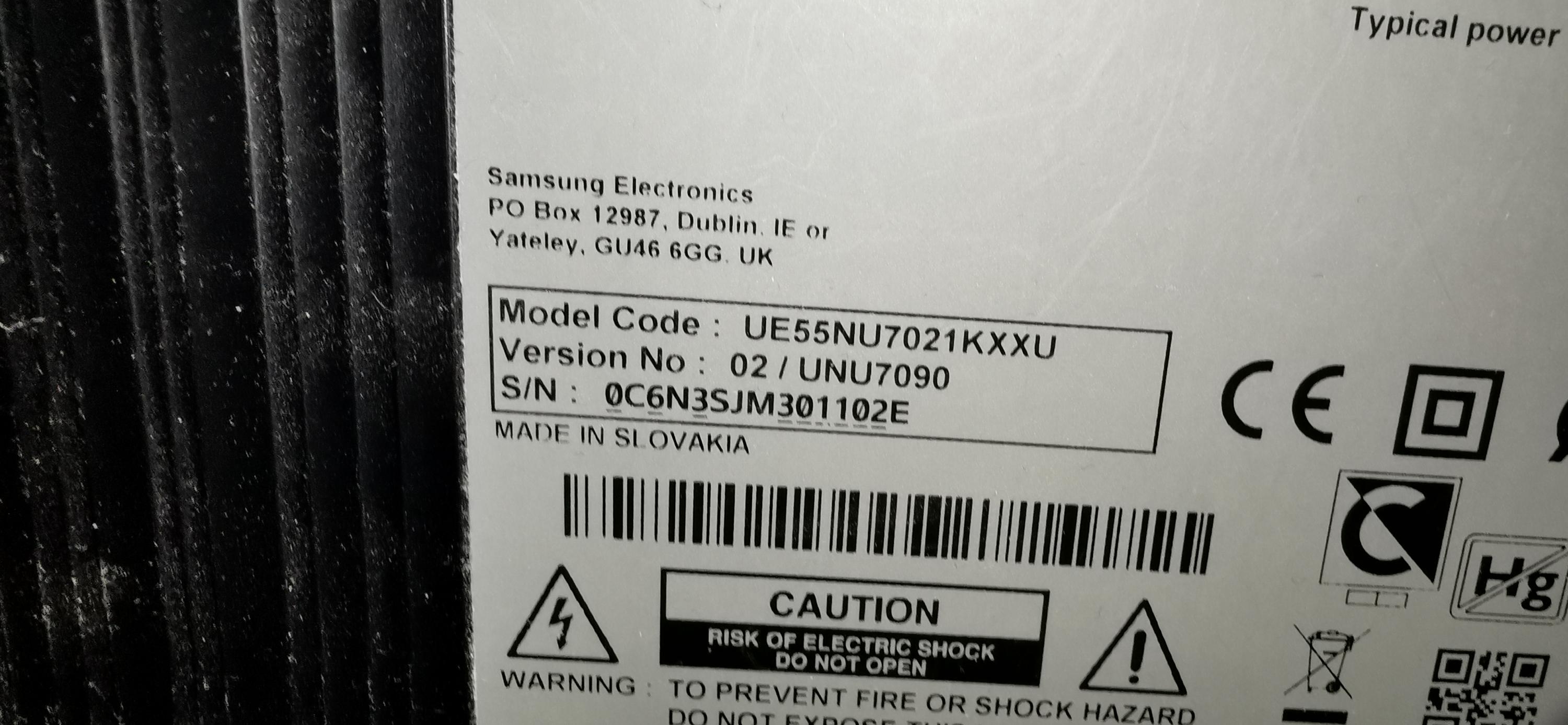

        Re: samsung ue55nu7021k backlights working but blank screen

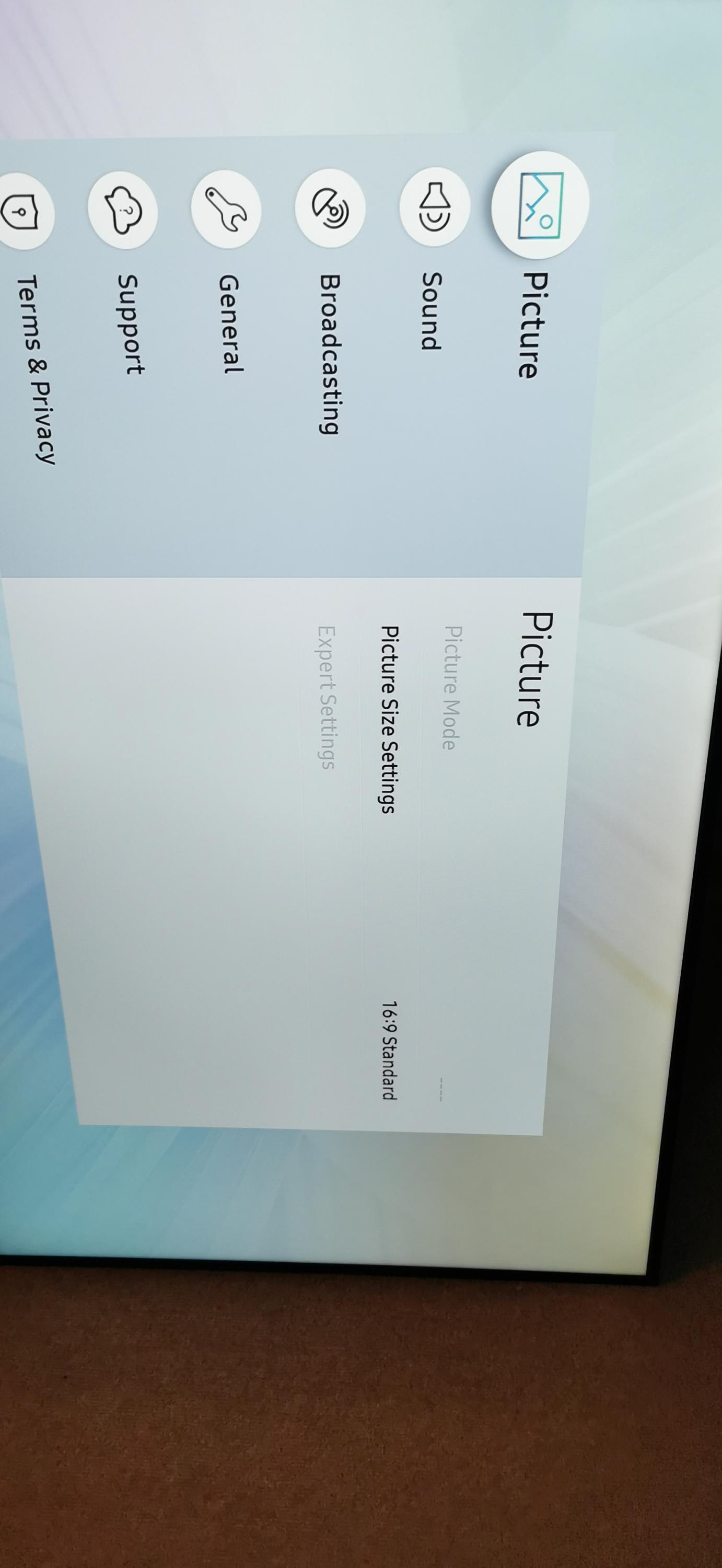

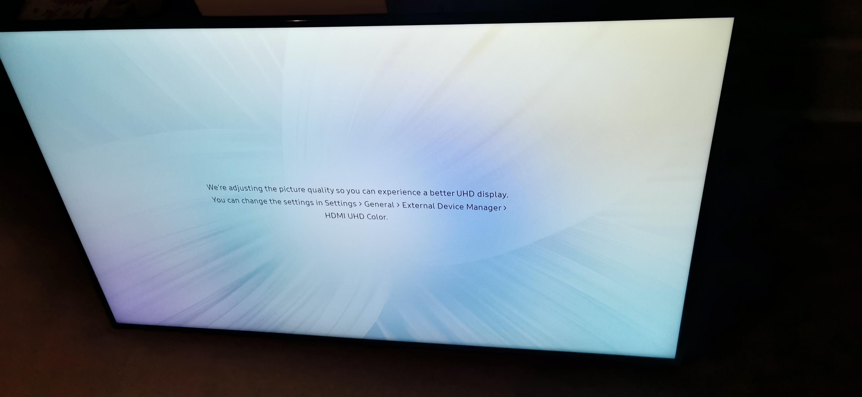

        Hi, wondering if anyone can help. I have the same model TV, Samsung UE55NU7021KXXXU. The TV was running fine but then all of a sudden started encountering problems. The sound would work, the remote wouldn't work! Now the TV turns on, although very slow boot up now but when it does it comes with the Samsung Logo then onto a screen showing No Signal. I try pressing Source on the remote but nothing happens. The home button also doesn't work, so I can not get any of the smart apps up. Also, everything is running very slowly.
        However, if I click the actual button at the bottom of the screen and bring up the menu, then I get goto source and manage to select one of the HDMI's and get a signal. However while the picture shows, i keep getting the turning circle (as per the attached photo of the BBC news - you can just see the turning circle in the middle of the screen) and it says it's adjusting the picture. Also there is no sound. Under the settings, the picture test shows fine but sound test fails to work. I should add that this is temperamental as well as sometimes also does not work (the button at bottom of screen)
        Any ideas on how to fix? I've added some photos of the screen and model to help.
        Also, some times when I boot, instead of the normal commands, I get coding on the titles (as per photo)

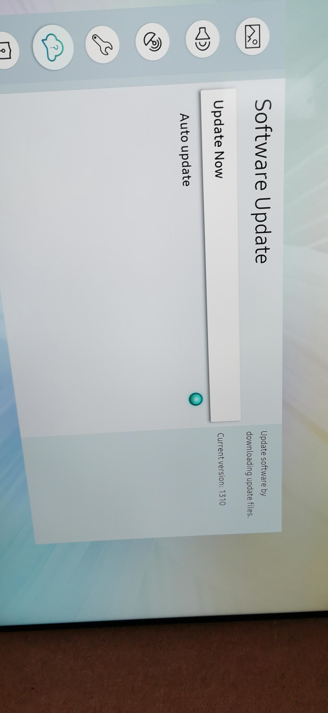

              Hi, thanks for your replies.
              So I don't believe temperature affects it as starting to go wrong in the same room its been in for the past 2 years!
              I try and do an update to the firmware but it just crashes and doesn't do anything and reverts back to the same screen.
              Sorry what do you mean by a faulty nand IC?

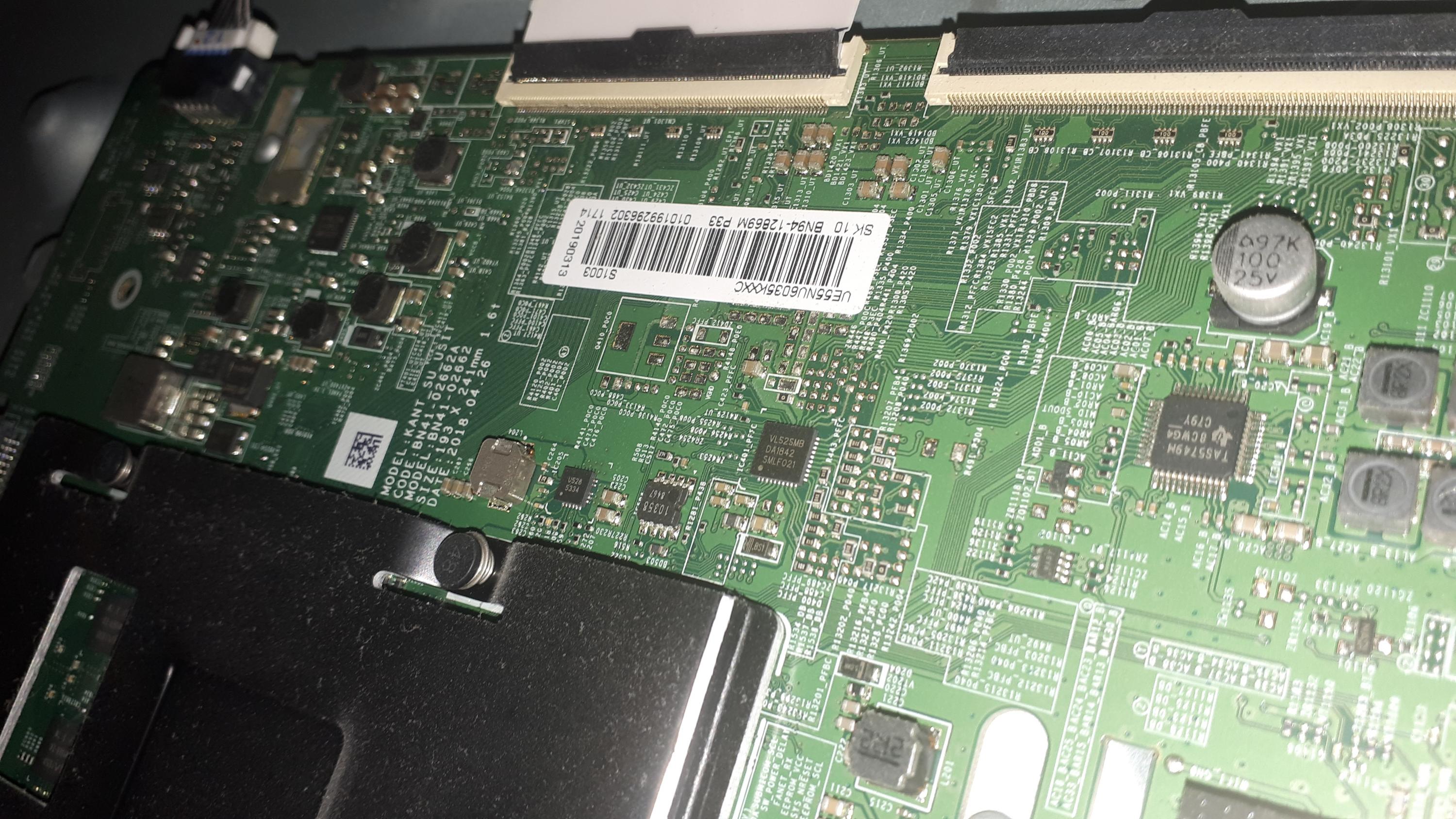

                  Nand ic or eeprom ic is the chip that stores the firmware etc on samsungs quite common they go faulty.
                  Have you got a good clear picture of the mainboard so that we can see all the numbers on it.
                              I have opened it yet but let me give this a go tonight and I'll get a clear picture. I'm guessing the mainboard will be the large board at back and not the one where the power goes to?

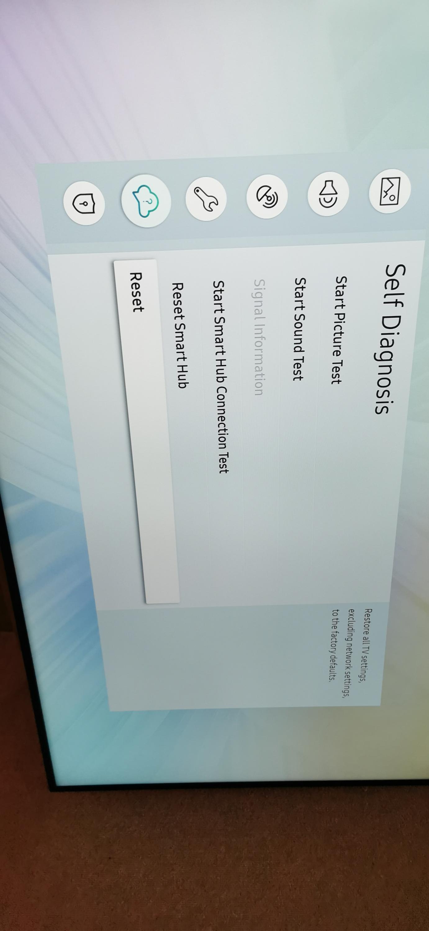

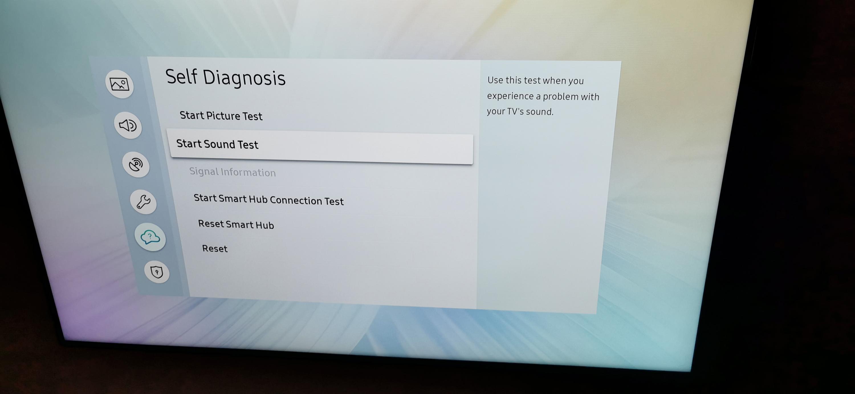

                                  So I've just tried another software update which is what I assume is a firmware update. I choose as per the photo and then it does something but returns to the main "No Signal" screen again. Checking the software version it's still what it was before.
                                  Also, some options don't seem to be available. Picture attached of some itmes greyed out!
                                    what is in the general menu?
                                      If you reset via the "factory reset" service menu, you will get the TV as if it were from a store.
                                      https://www.wikihow.com/Reset-a-Samsung-TV

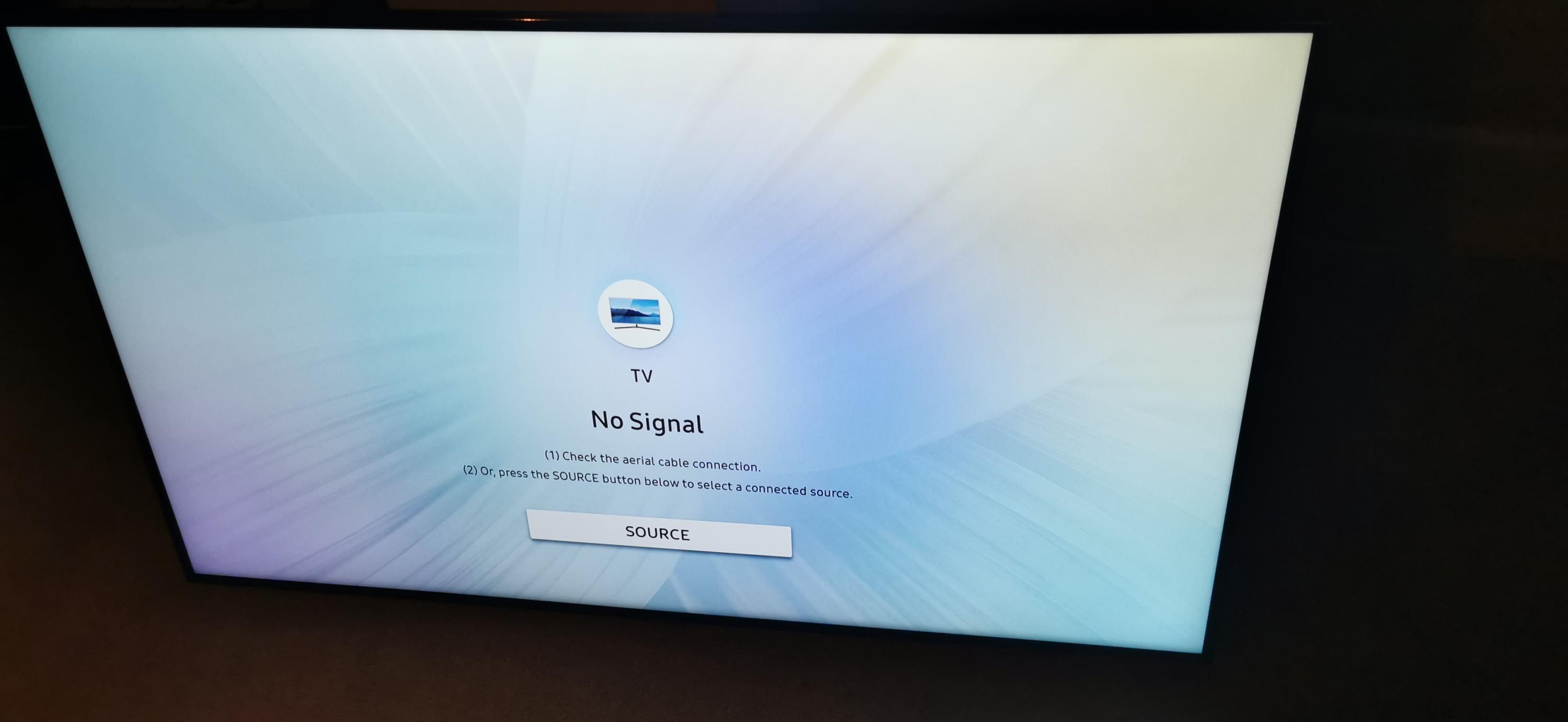

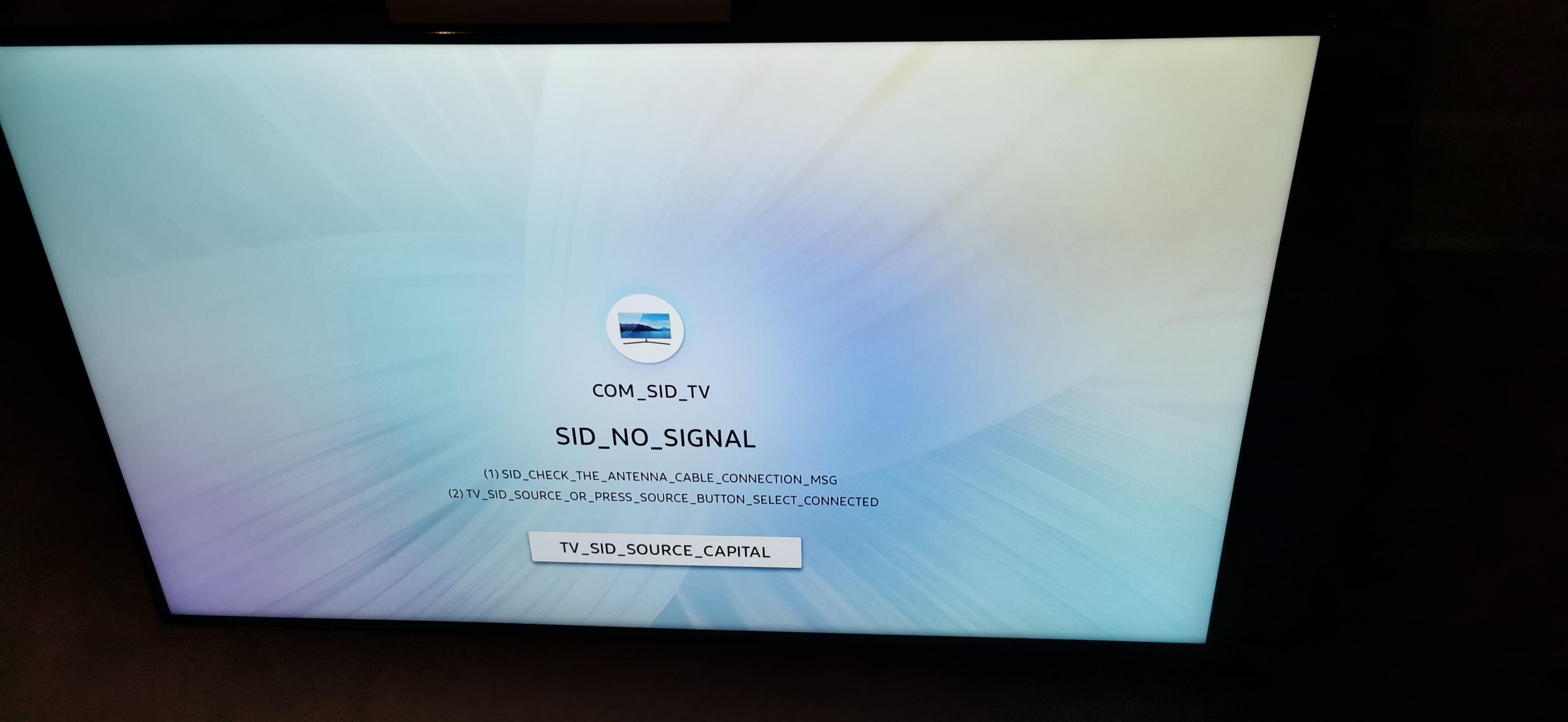

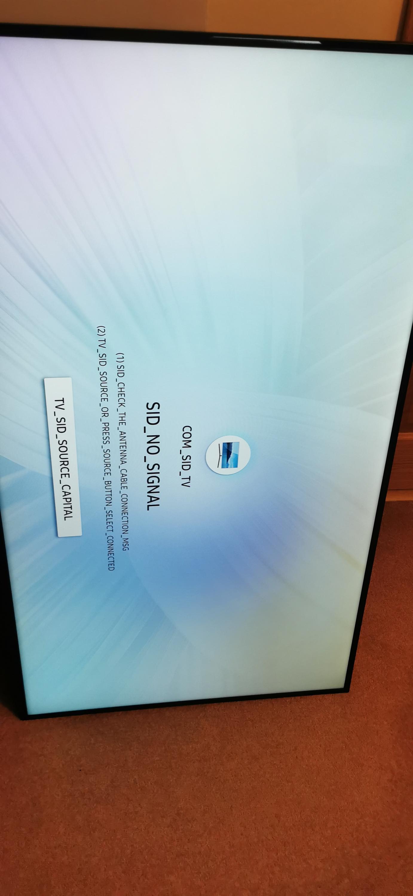

                                        Hi, so just started the tv again and the no signal page is not showing properly. Photo of this attached as well as a photo from before when this page was showing properly. I've also attached a photo of the main settings menu which too isn't showing properly. I'll later to see if it displays correctly.
                                        I'm guessing this doesn't help much?
