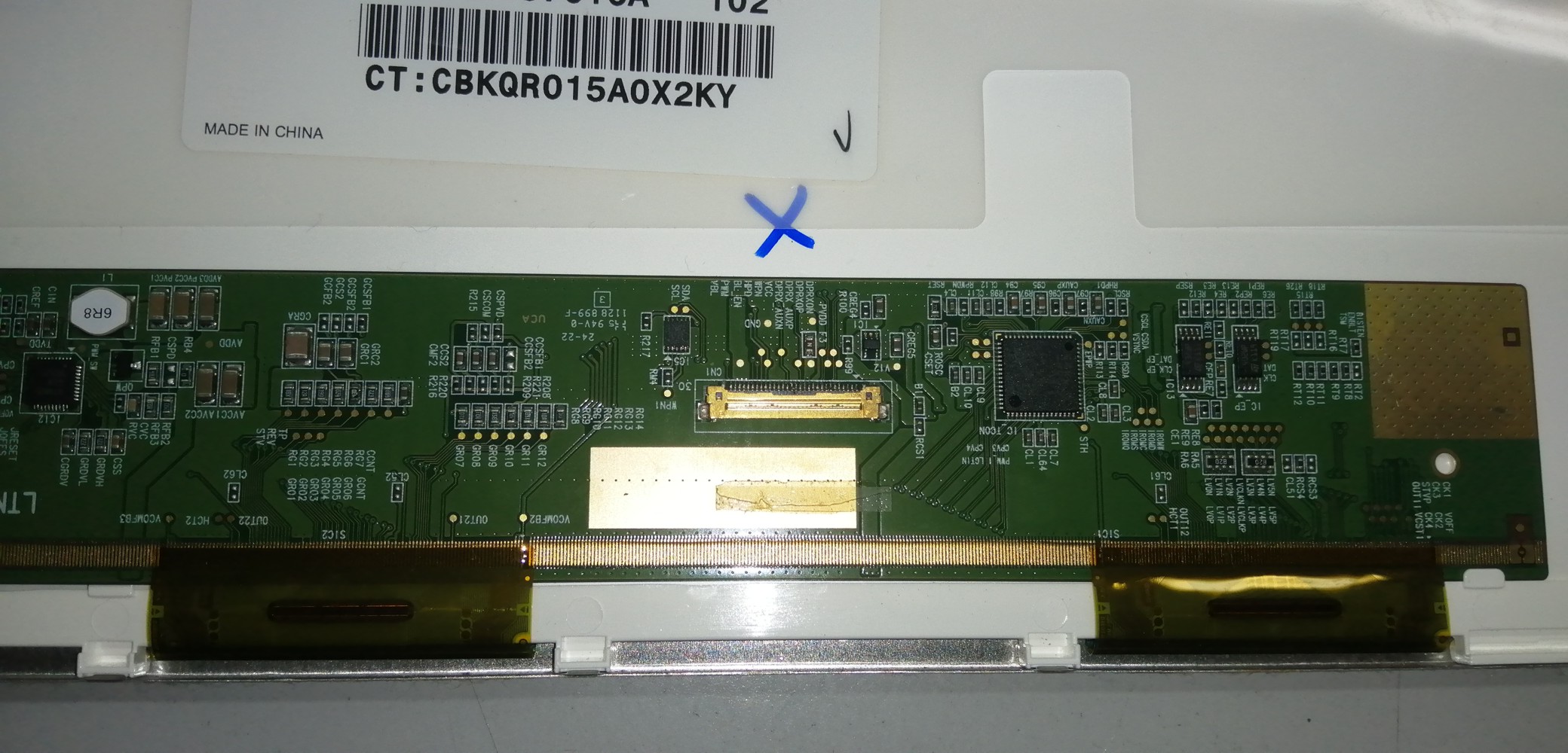

    Hi guys
    I'm trying to fix this laptop screen

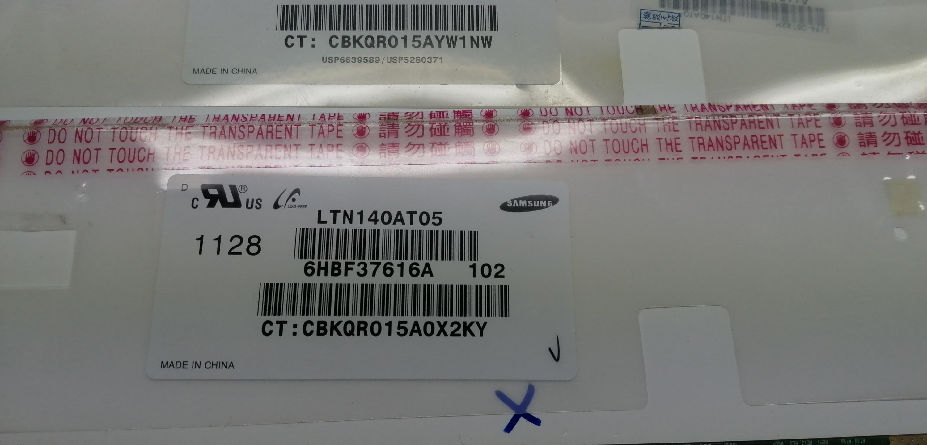

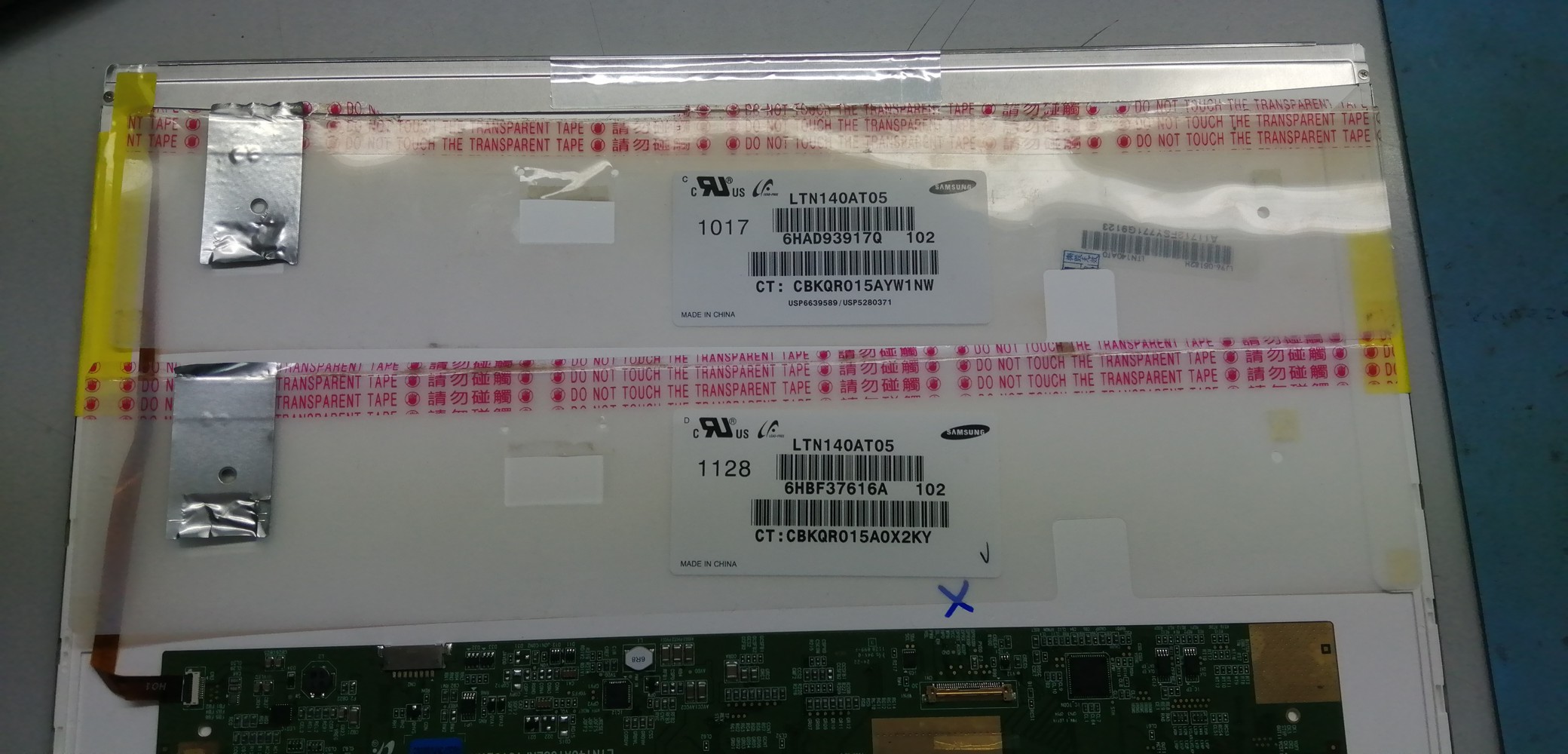

    Basically the owner is a computer shop and they brought it to me with two screens. They said the repair shop they use could not fix it, so I thought i would try to see if I am better than their current repairer!
    OK so I have the original screen which works but has lines across the bottom quarter of the screen
    I have the replacement screen, which they fitted and it worked. They then put the laptop on one side for a couple of weeks until they found a buyer. When they showed it to the buyer, the screen would not work - backlights OK but no image. An external VGA monitor works fine
    So I thought I would try to fix the screen with no image. I checked the voltages on all the test points on the TCON PCB. They are the same, or very close, on both screens
    I then booted into windows with the internal screen attached, using the external monitor as a second display. in both cases Windows knows the screen is there.
    So basically I can't see any difference between the the one with lines on the display and the one with no display.

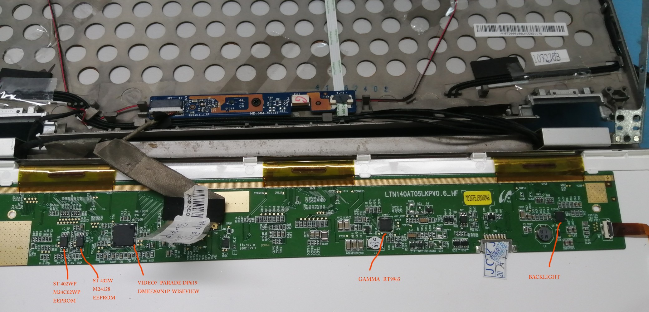

    I identified the main chips (Backlight PSU, Gamma, Image?, and a couple of eeproms - see pics. I could only find datasheets for the EEPOMS.
    I was thinking maybe the screen with no image would also not detect - but that is not the case. What do the EEproms do? Are they like a BIOS chip on a GPU for example? I'm now thinking of swapping the chip that I think handles the graphics (The parade Wise View chip) and maybe the EEproms to see if I can get the blank screen to work
    In fairness I don't have as much knowledge as I would like -
    Apart from the obvious voltage, PWM and BL_ON signals on the LVDS, there are also signals called DPRX_AUXN, DPRX_AUXP, DPRXOP and DPRXON. Any idea what these are? Is there a standard pin-out for LVDS or tutorial?
    What do the EEPROMS do? Is the data unique to each model of screen (like a motherboard BIOS) or unique to each individual screen (like a HDD eprom)?
    Any suggestions of anything else I could check, or should I just start swapping parts over?

    Looks like a Dell laptop ? The eeprom holds the Extended Display Identification Data (EDID), I'm guessing this wrong on the non display screen.

      Yeah that would make sense.
      it is a HP Elite laptop
      Given that it did work after the new screen was fitted, then put in storage for a few weeks and did not work when it came back out, what would cause the eeprom to fail?
      There are two EEPROMS, do I need to swap both or just one?-

                      I swapped the large QFN (Parade DP619) and both the Eeproms from the screen that had a picture but lines on it.
                      The result of this is that it made no difference. The backlight still comes on, there are some initial feint horizontal lines across the screen that fade away to an even grey after several seconds. Using an external VGA I can see that the laptop still detects both screens in display Properties.
                      I'm at a loss now to understand why it does not show a picture. I feel like I am missing something obvious - but what? Can anyone suggest what else I can test, just for the sake of sanity?

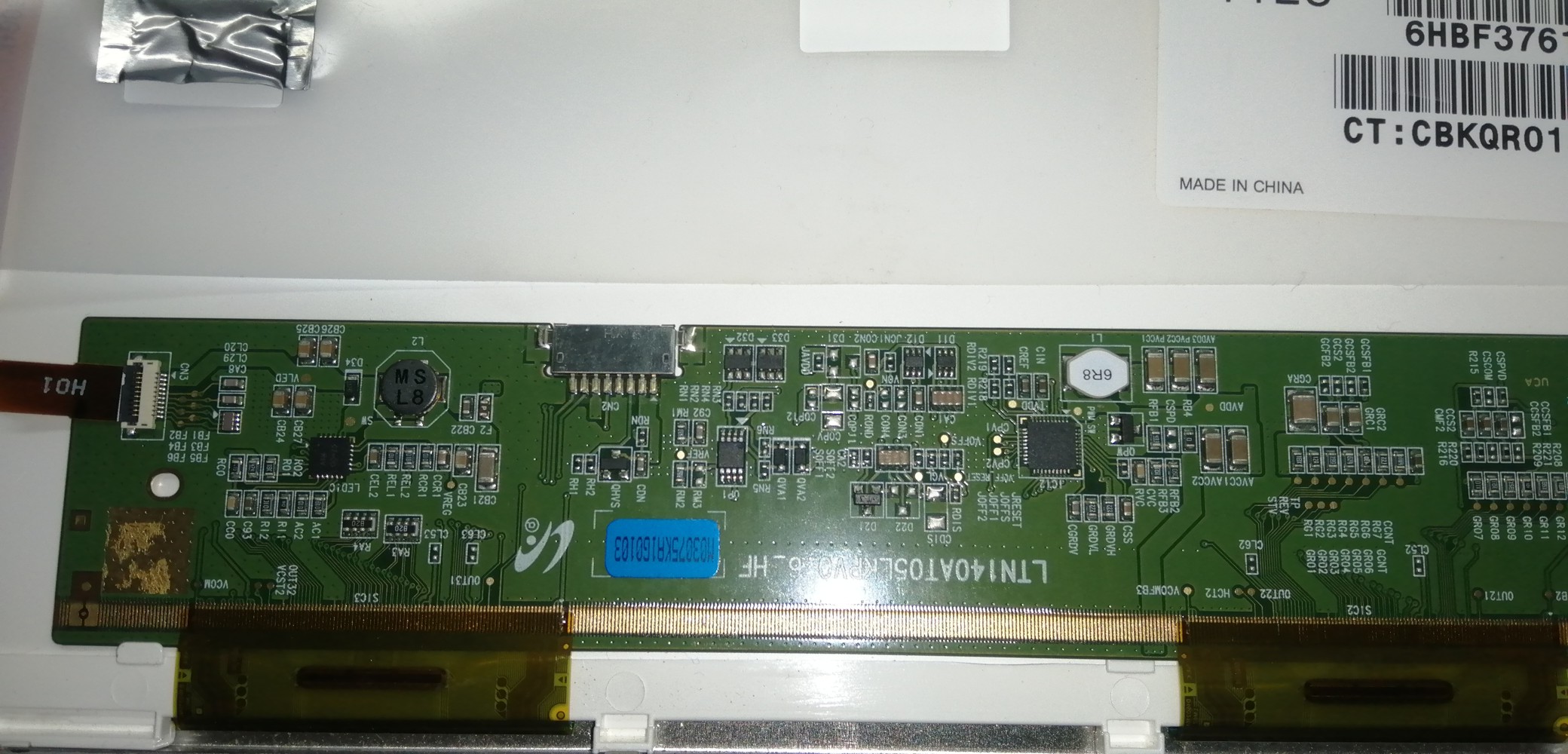

                          I am home now but I just looked at the photos I uploaded. There is a test point called VCOM so that will be the same on both panels as I measured all test points and compared them.
                          I can't see any test points for VGH/VGL,though I need to look a the actual boards to double check. So quite possibly I did not measure those.
                          I found this link that taught me a bit about these voltages and how they are generated.
                          https://pcbartists.com/design/power-...matic-tft-lcd/
                          I saw some voltages around -6.5V on several test points on both panels so that sounds like it could be VGL
                          Do I also need AVDD ,DVDD, VIH, VIL? Or is that for TFT panels only, which mine could be I guess.
                          I'm pretty sure all the Gamma voltages are there - they measured the same on both panels, and the test points are clearly marked. I just noticed there is a coil L1 near the RT9965 chip which I assumed generates Gamma, and I didn't check voltage there.
                          I failed to locate a datasheet for RT9965, but is it likely that this IC generates gamma and also generates VGH, VGL? There is another chip marked OP1 near here that I should look at, plus a few transistors. The other four 6 pin devices nearby are marked D11, D12, D32, D33 which I am assuming are diode arrays, and this kinda makes sense if OP1 is in a circuit similar to the example on in the above link ,rather than RT9965.

                                OK, there are test points at all the inputs from the FFC on the panel PCB, and they are reading the same voltage on both panels. Plus I also examined the socket on both and they look fine. Obviously the cable is OK as one of the panels works ( albeit with lines on the screen)

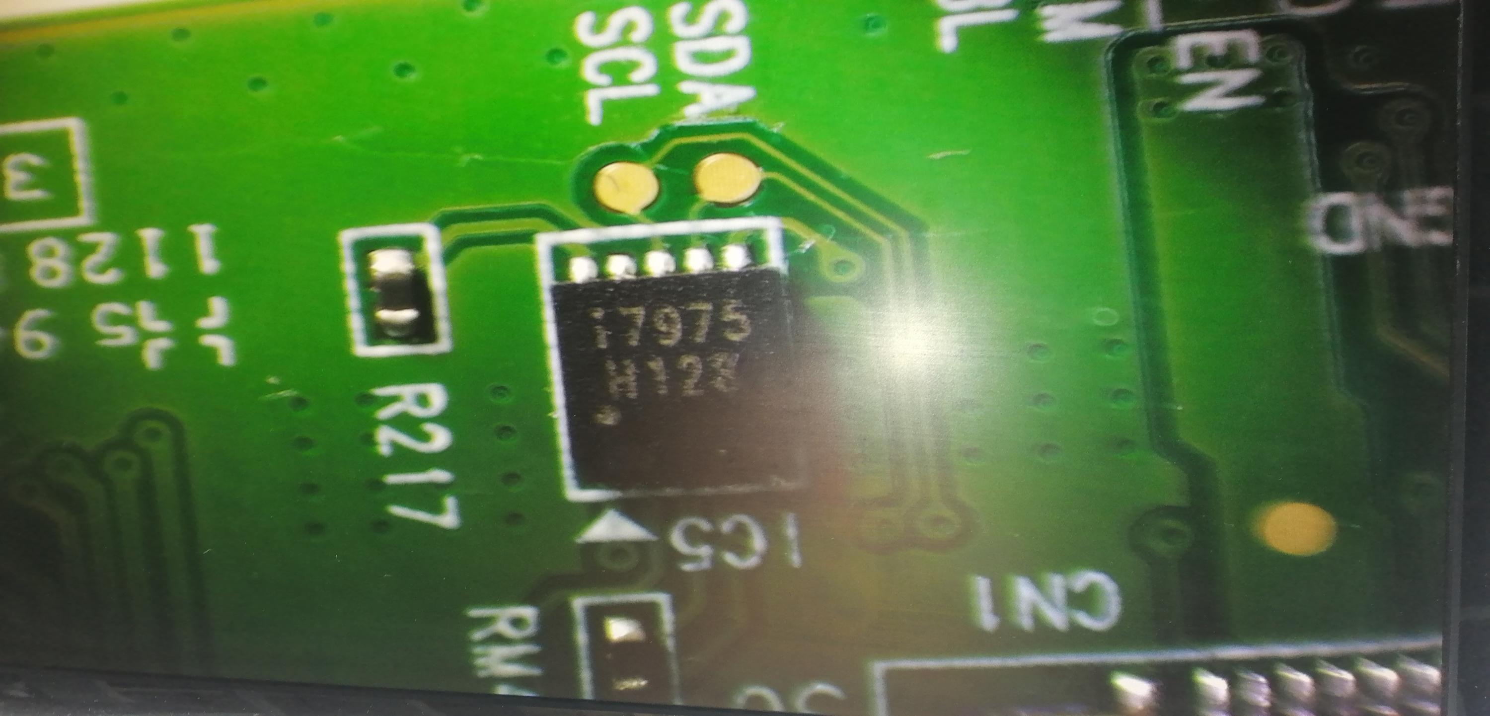

                                  Whats the part number on IC5
                                  • dicky96
                                    Sun Seeker
                                    • Mar 2017
                                    • 1825
                                    • Spain
                                    Re: HP Elitebook Screen blank - backlights but no image

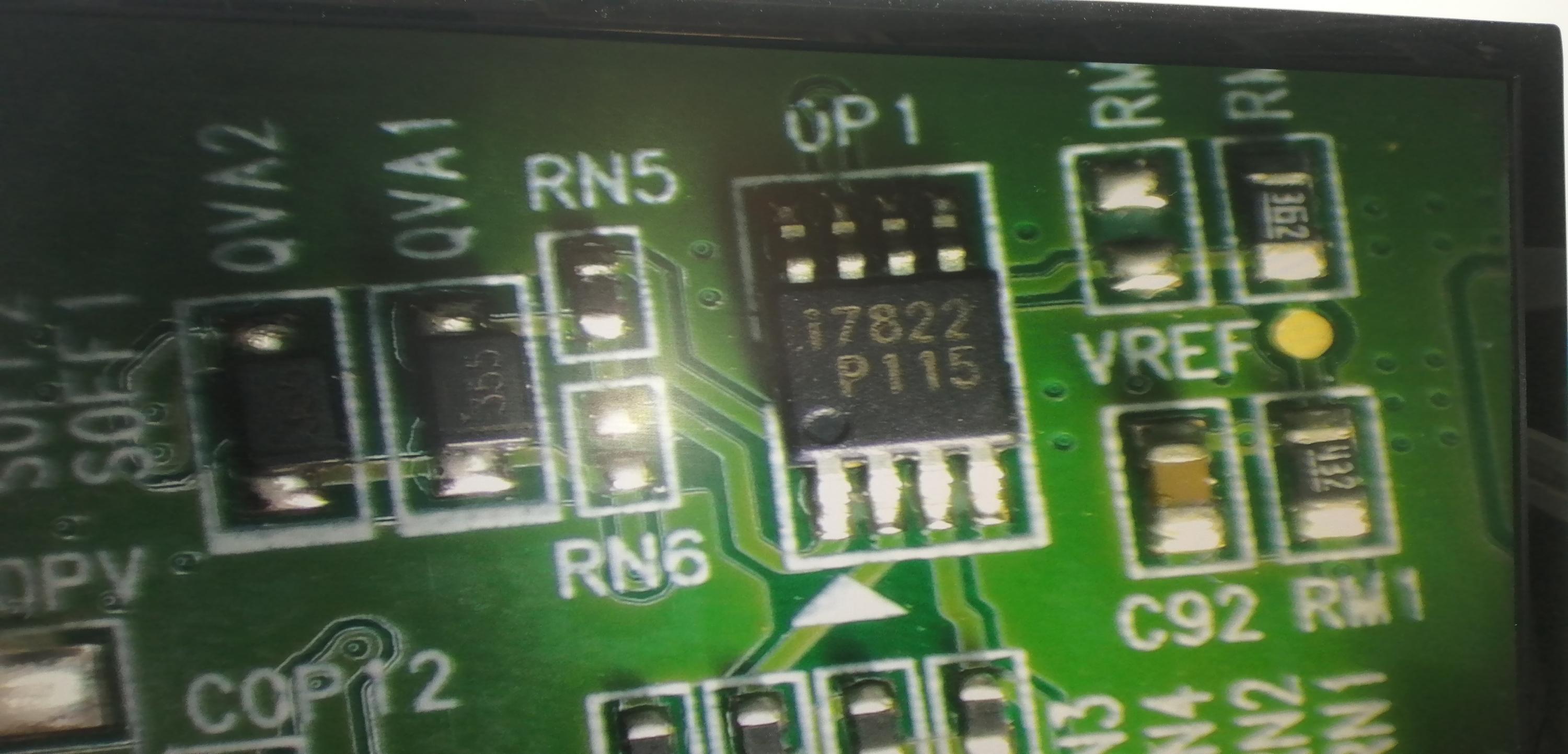

                                    Here is the chip IC5, and also the other one OP1
                                    I could not find a datasheet
                                    Follow me on YouTube
                                    Learn Electronics Repair
                                    https://www.youtube.com/channel/UCFX...R8UZ2vg/videos
                                      • 20977
                                      iML7975 and iML7822 ,theres no datasheets.From what ive read the 7975 is there to reduce screen flicker.
