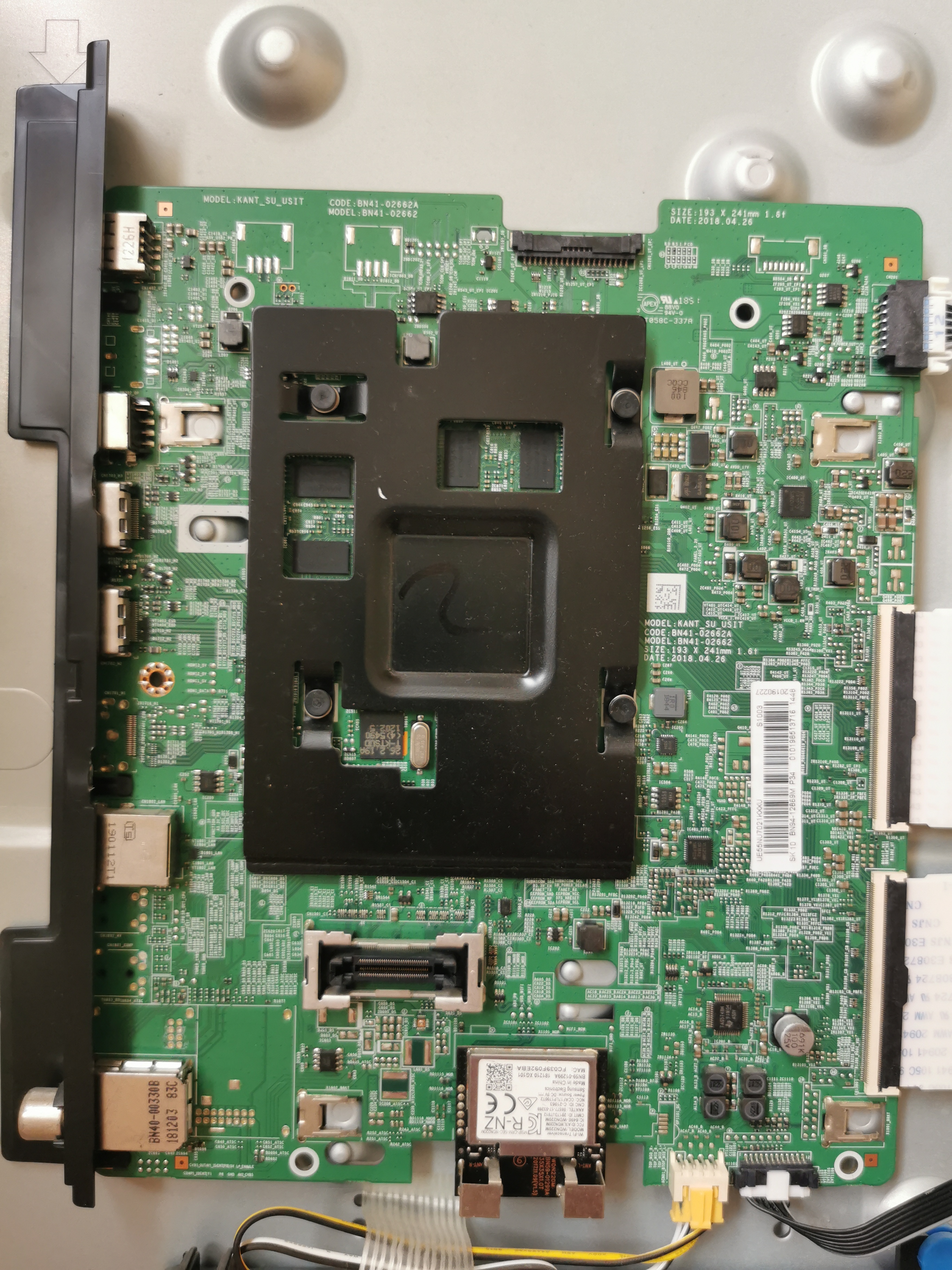

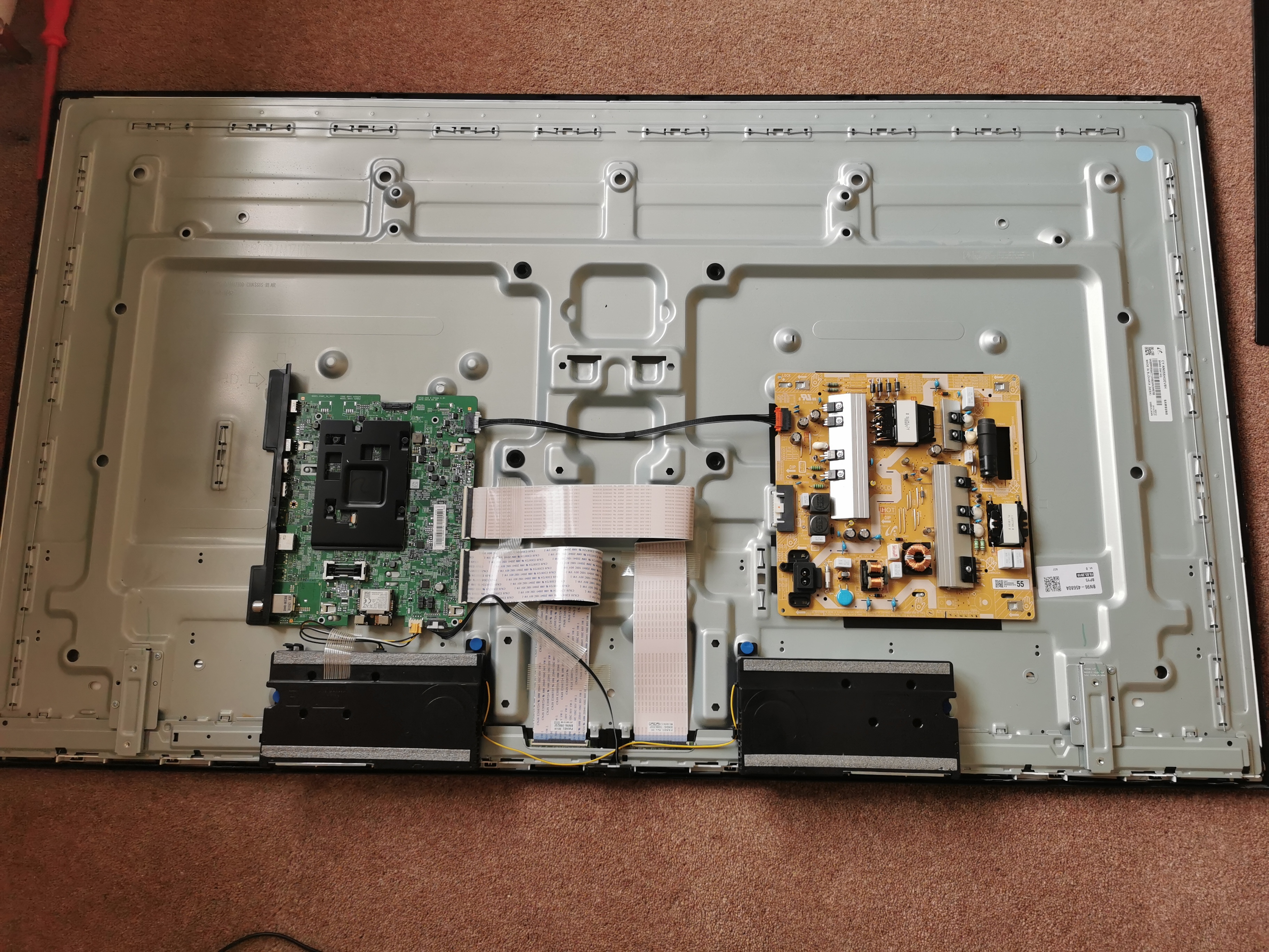

        Anyway, any videos or advise on how to change board? There doesn't appear to be any boards and don't want to try and force it off.
          Like that
          https://www.youtube.com/watch?v=Zl5eOQ-ASxY
          https://www.youtube.com/watch?v=uOr8rLj_rTk
          https://www.youtube.com/watch?v=w8lu5XAVHAI

              So the board arrived this morning! I replaced the old one and the TV is back up and working!
              Thank you both for your help on this, I had assumed my TV couldn't be repaired! Its fairly simple as well, as long as you get the right parts.
              Can I ask if it's possible to determine whats wrong with the old one, can you test the various components in some way?

                Thats great news the replacement board ixed the issue.
                Reagding ficing the other board my guess as it would not take the fimware/software update one of the ics is faulty so may not be cost effective for you trying to repair it if you have not got the replacement ics/hot air station, solder/flux etc etc .
