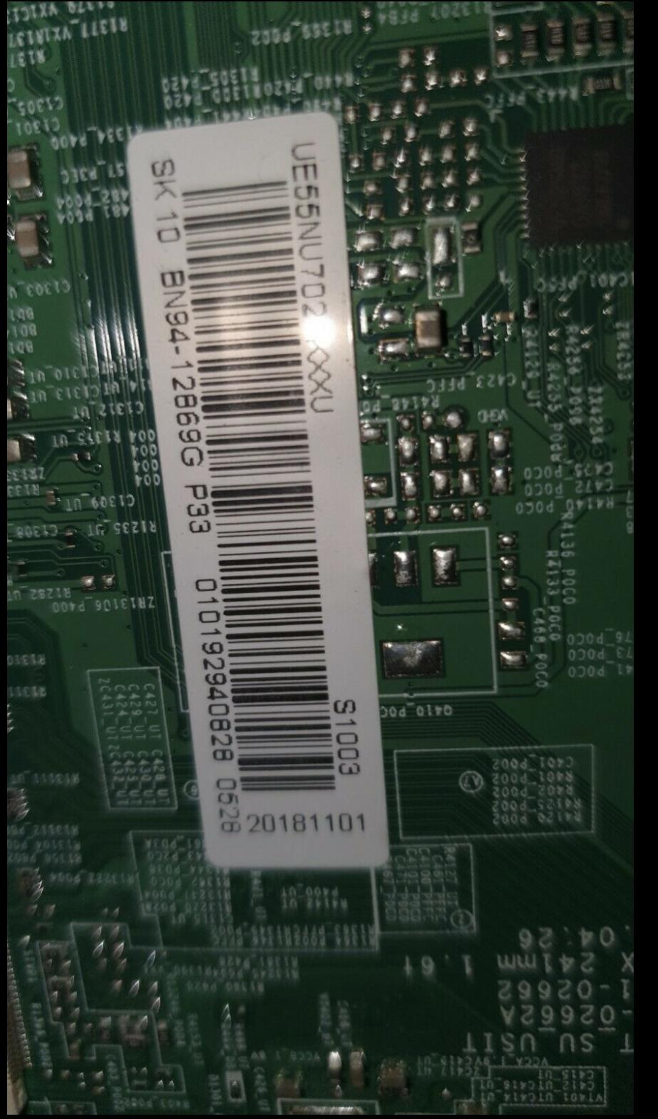

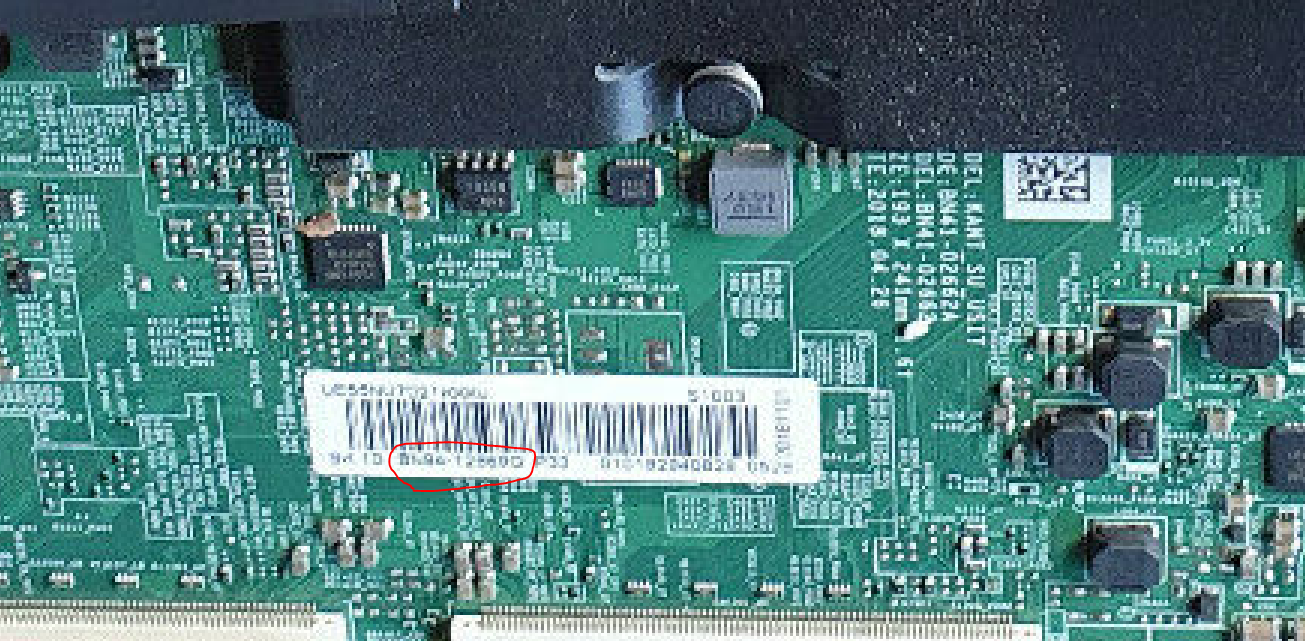

      Originally posted by lotas
      BOARD BN41-02662A is the PCB number.
      Great thanks for explaining that Lotas!

        Re: samsung ue55nu7021k backlights working but blank screen
        The number is not visible, and the matrix models are different.

          i wonder if this one would work as cheaper https://www.ebay.co.uk/itm/203577018...B&gclsrc=aw.ds
          This site is awesome! Irrespective of whether this works or not you have both been of great help.
          Vince - on this one they don't quote the BN94-12869M number and you can't see from the picture on the advert. However as you say the BN41-02662A matches which is printed on the board as well as BN95-05414Q on the sticker on metal surround.
          Lotas did say that the important one to match is the part number BN94-12869M corresponds?
            sorry missed that bit the other board looks the best option then

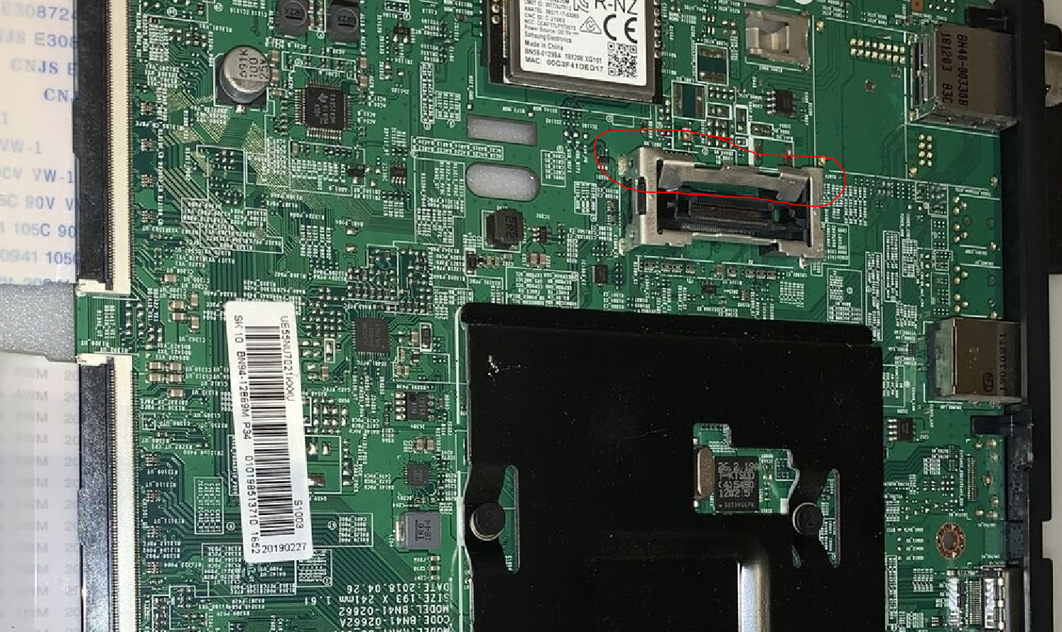

                    #89
                    this just gone on ebay
                    https://www.ebay.co.uk/itm/294652623...gAAOSwfYVhwOBJ
                    looks like rite one?
                                also this even cheaper does not mention lcd panel number though
                                https://www.ebay.co.uk/itm/334257416...4AAOSwLalhu5eY
                                Yes, they will come up for replacement, they have a corresponding part number, but it is cheaper for her to have a bent connector.
                                On the first link, he also has a 30-day warranty.
                                  Good spot on that connector i was on phone so didnt zoom in (see it now im on laptop) so yes ignore the second ebay link!
