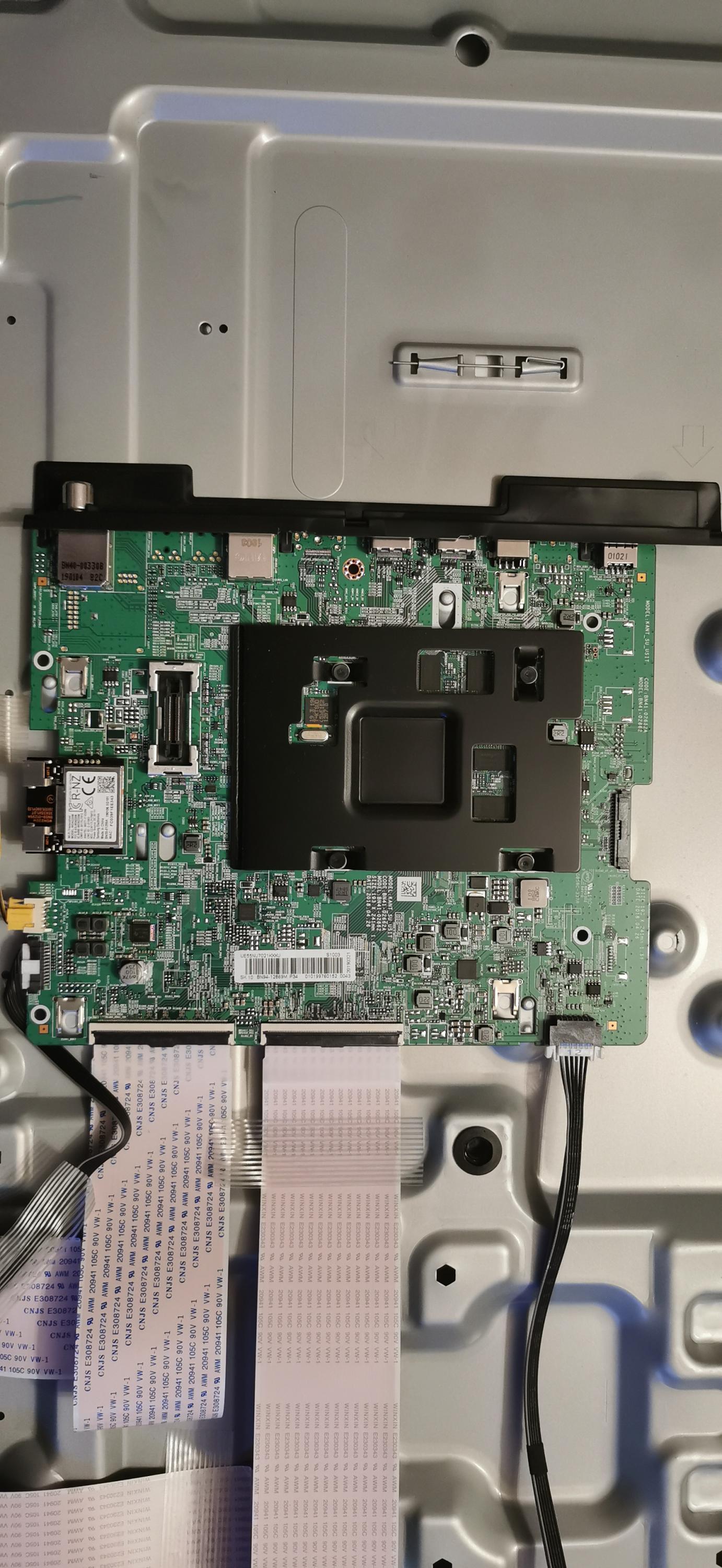

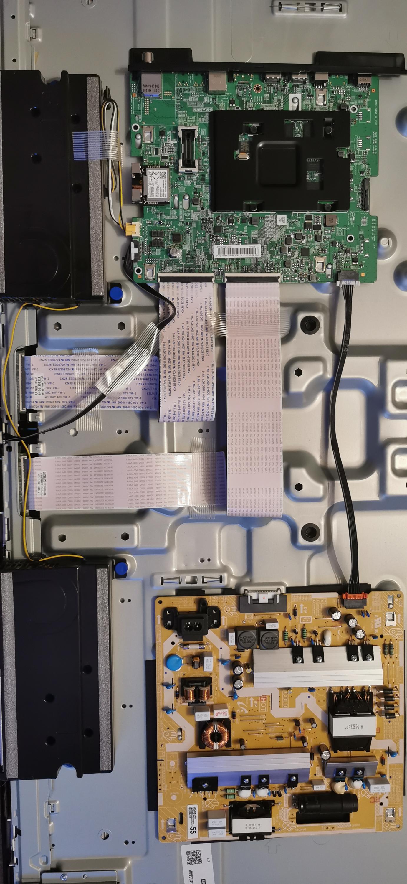

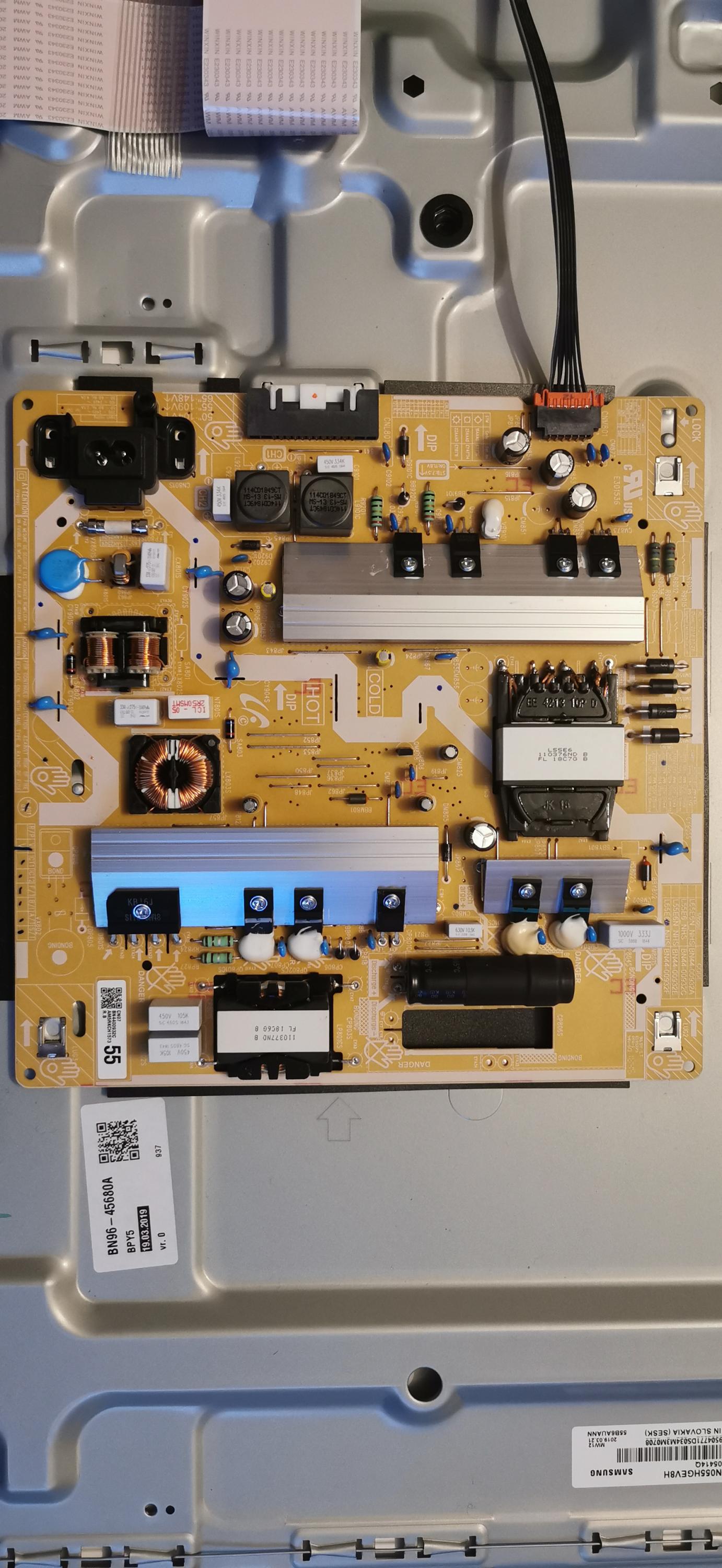

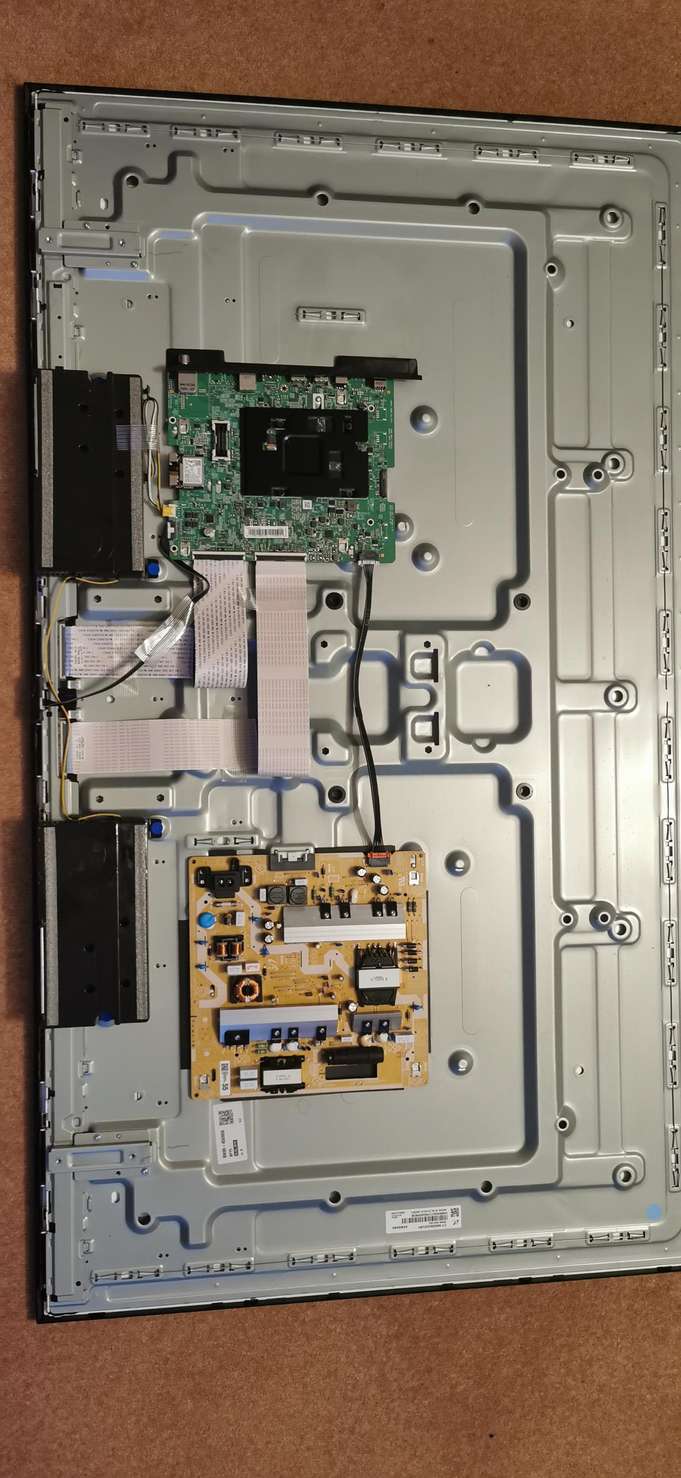

                                  #56
                                  Re: samsung ue55nu7021k backlights working but blank screen

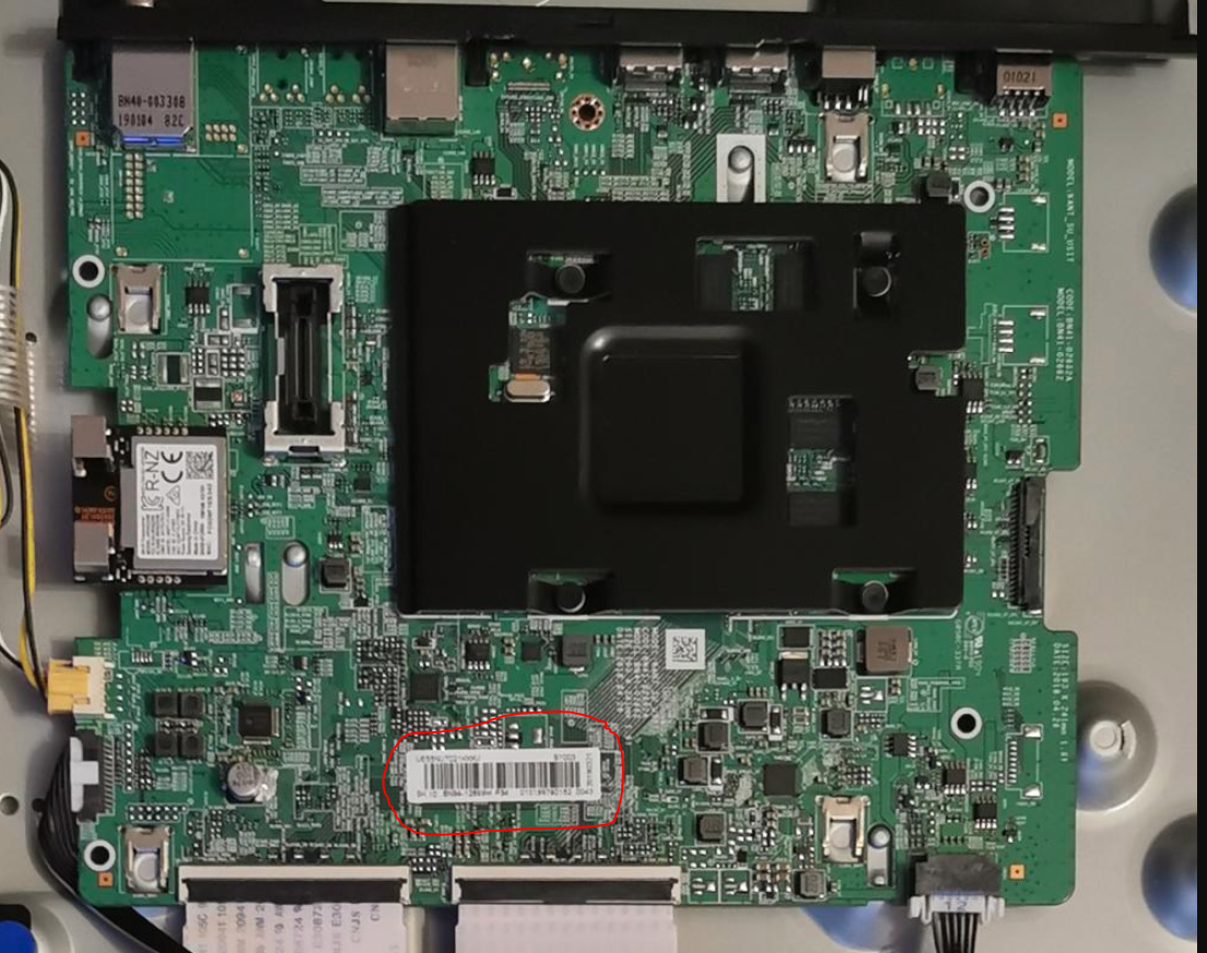

                                  so that went better than I expected! I have got the back off and photos attached of whats there. Any thoughts? Can get better photos if you need.

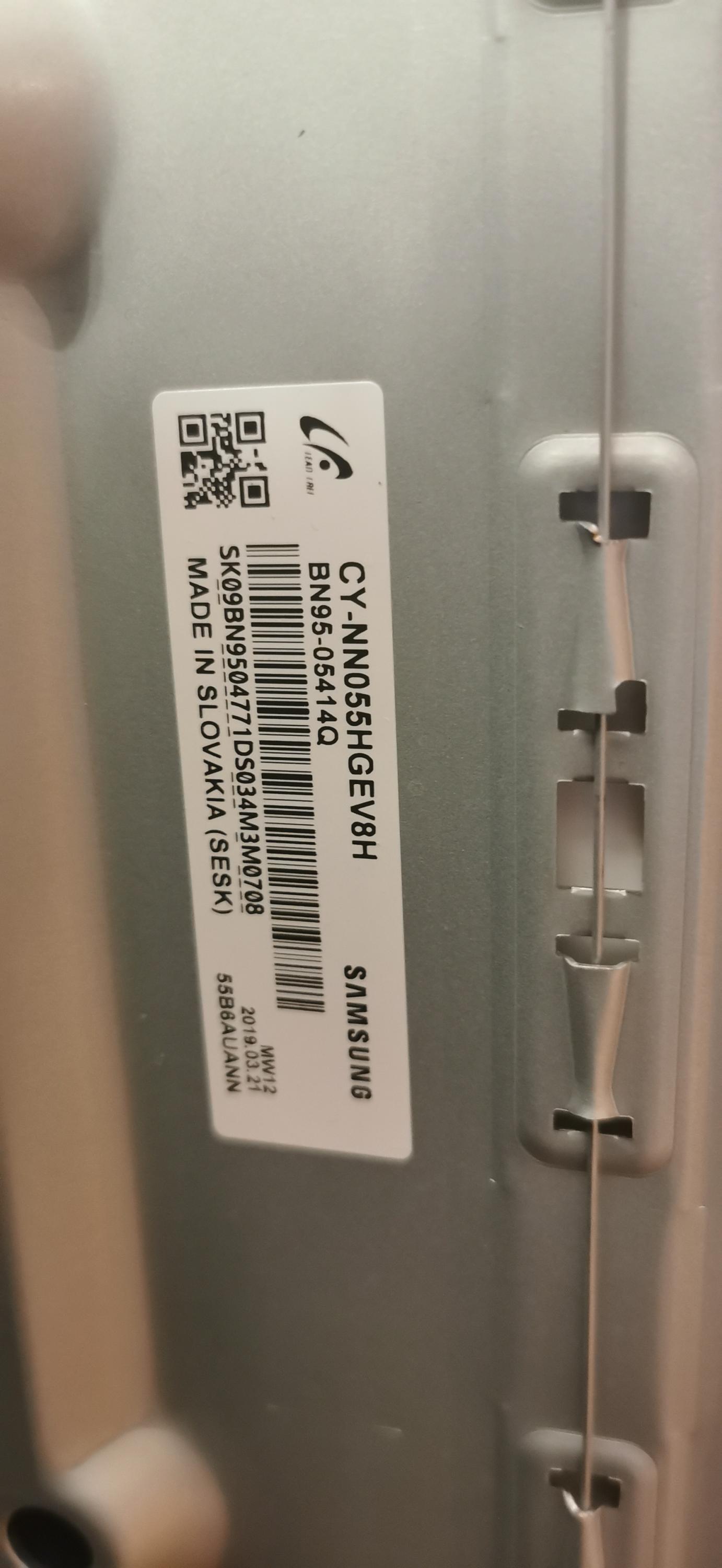

                                    #57
                                    on your first picture lower edge can you take a picture of the white sticker that says samsung on it so we can see what lcd panel number it uses thanks (on ebay the mainboards are averaging £35.00 so up too you if you want too take a risk replacing it)

                                      #58
                                      Ok I think I've attached the photo of what you mean. It says BN95-05414Q?
                                      Do you think the board will be faulty, would the picture come on then? The picture test does work but inputs don't work nor is there any sound?
                                      Also what board at the back do you think needs replacing?

                                        #59
                                        Mainboard

                                          #60
                                          Originally posted by lotas
                                          Mainboard
                                          yoda79
                                          can you take a clear picture of this white sticker too many thanks
