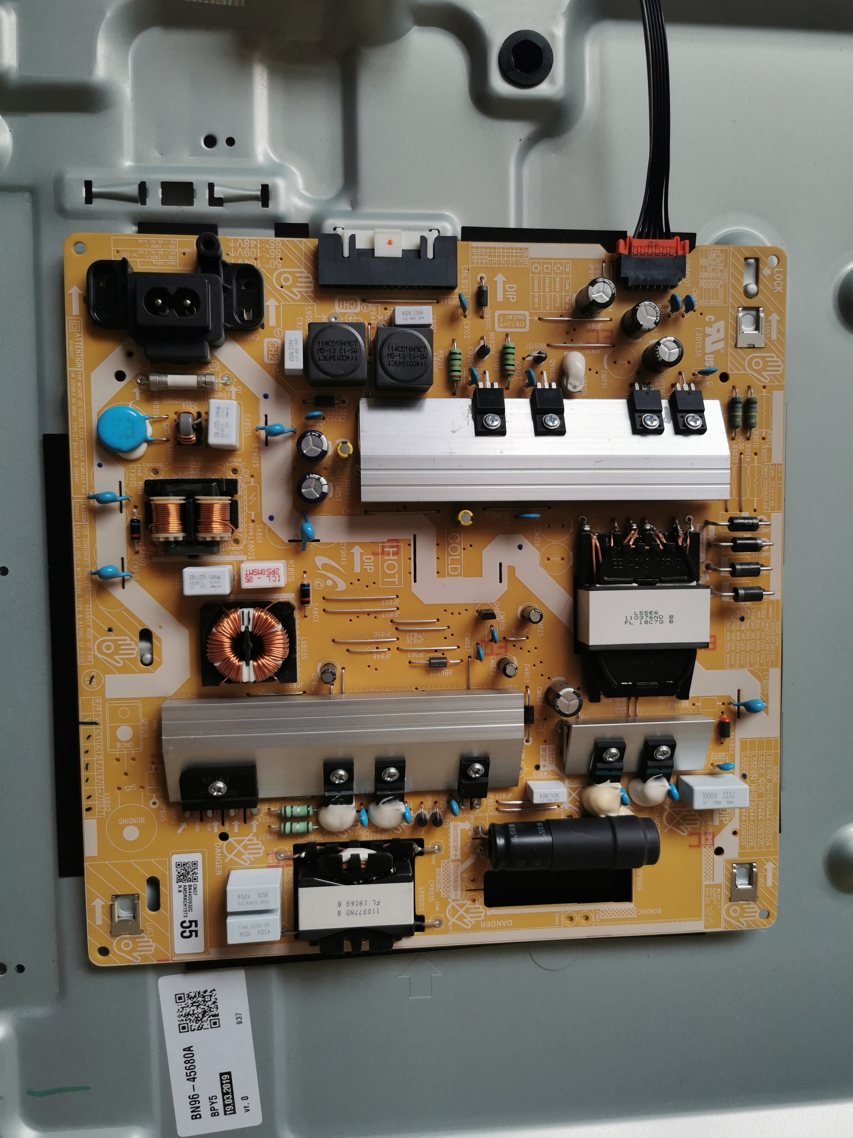

samsung ue55nu7021k backlights working but blank screen
  • Yoda79
    replied
    Good morning, sorry me again. Same tv, similar issue.
    Probably about a few weeks ago the TV seems to be locked up in a boot cycle. It turns on, no sound and then turns off and starts the whole cycle again. I've opened up the. back and can see the backlights turning on. Its funny though as when I disconnect the two straps connecting the left hard board (as you look on the back of the TV), the boot cycle stops and it does turn on and I can hear the boot up sound, however no video?
    Any thoughts, any help would be greatly appreciated.
    Leave a comment:
  • Yoda79
    replied
    Re: samsung ue55nu7021k backlights working but blank screen
    Originally posted by diif View Post
    Yes, we're not trying to melt the solder, just get some thermal expansion of the BGA.
    Cheers thanks, tried this but no luck. So probably not worth the hassle. Got my TV back on anyway so a win win!!
    Thank you to all.
    Leave a comment:
  • diif
    replied
    Re: samsung ue55nu7021k backlights working but blank screen
    Originally posted by Yoda79 View Post
    Do you mean just getting a hair dryer and using that to apply hot air?
    Yes, we're not trying to melt the solder, just get some thermal expansion of the BGA.
    Leave a comment:
  • Yoda79
    replied
    Re: samsung ue55nu7021k backlights working but blank screen
    Originally posted by diif View Post
    Did you try hot air on the main processor ?
    Do you mean just getting a hair dryer and using that to apply hot air?
    Leave a comment:
  • Yoda79
    replied
    Re: samsung ue55nu7021k backlights working but blank screen
    Originally posted by vinceroger69 View Post
    Thats great news the replacement board ixed the issue.
    Reagding ficing the other board my guess as it would not take the fimware/software update one of the ics is faulty so may not be cost effective for you trying to repair it if you have not got the replacement ics/hot air station, solder/flux etc etc .
    Fair point, probably trying to get too adventurous. You're right I don't have any of those items apart from the solder and flux.
    Leave a comment:
  • diif
    replied
    Re: samsung ue55nu7021k backlights working but blank screen
    Originally posted by Yoda79 View Post
    So the board arrived this morning! I replaced the old one and the TV is back up and working!
    Thank you both for your help on this, I had assumed my TV couldn't be repaired! Its fairly simple as well, as long as you get the right parts.
    Can I ask if it's possible to determine whats wrong with the old one, can you test the various components in some way?
    Did you try hot air on the main processor ?
    Leave a comment:
  • vinceroger69
    replied
    Re: samsung ue55nu7021k backlights working but blank screen
    Thats great news the replacement board ixed the issue.
    Reagding ficing the other board my guess as it would not take the fimware/software update one of the ics is faulty so may not be cost effective for you trying to repair it if you have not got the replacement ics/hot air station, solder/flux etc etc .
    Leave a comment:
  • Yoda79
    replied
    Re: samsung ue55nu7021k backlights working but blank screen
    So the board arrived this morning! I replaced the old one and the TV is back up and working!
    Thank you both for your help on this, I had assumed my TV couldn't be repaired! Its fairly simple as well, as long as you get the right parts.
    Can I ask if it's possible to determine whats wrong with the old one, can you test the various components in some way?
    Leave a comment:
  • Yoda79
    replied
    Re: samsung ue55nu7021k backlights working but blank screen
    Legend Lotas, cheers
    Leave a comment:
  • lotas
    replied
    Re: samsung ue55nu7021k backlights working but blank screen
    Originally posted by Yoda79 View Post
    Lets hope so!
    Anyway, any videos or advise on how to change board? There doesn't appear to be any boards and don't want to try and force it off.
    Like that
    https://www.youtube.com/watch?v=Zl5eOQ-ASxY
    https://www.youtube.com/watch?v=uOr8rLj_rTk
    https://www.youtube.com/watch?v=w8lu5XAVHAI
    Leave a comment:
  • Yoda79
    replied
    Re: samsung ue55nu7021k backlights working but blank screen
    Originally posted by vinceroger69 View Post
    might come sooner as royal mail first class singed for, fingers crossed tv works fine after fittment
    Lets hope so!
    Anyway, any videos or advise on how to change board? There doesn't appear to be any boards and don't want to try and force it off.
    Leave a comment:
  • vinceroger69
    replied
    Re: samsung ue55nu7021k backlights working but blank screen
    Originally posted by Yoda79 View Post
    Great thank you, ordered! Due on the 6th Jan, will be back on here then, wish me luck!
    might come sooner as royal mail first class singed for, fingers crossed tv works fine after fittment
    Leave a comment:
  • Yoda79
    replied
    Re: samsung ue55nu7021k backlights working but blank screen
    Originally posted by lotas View Post
    Great thank you, ordered! Due on the 6th Jan, will be back on here then, wish me luck!
    Leave a comment:
  • lotas
    replied
    Re: samsung ue55nu7021k backlights working but blank screen
    Originally posted by Yoda79 View Post
    Sorry I'm not sure but the link I posted doesn't work but apologies for asking but am I right to order the first link shown by Vince in post 89.
    Yes, right on the first link: https://www.ebay.co.uk/itm/294652623...gAAOSwfYVhwOBJ
    Leave a comment:
  • Yoda79
    replied
    Re: samsung ue55nu7021k backlights working but blank screen
    Also, how can I get email notifications when someone posts in the thread?
    Leave a comment:
  • Yoda79
    replied
    Re: samsung ue55nu7021k backlights working but blank screen
    Sorry I'm not sure but the link I posted doesn't work but apologies for asking but am I right to order the first link shown by Vince in post 89.
    Leave a comment:
  • Yoda79
    replied
    Re: samsung ue55nu7021k backlights working but blank screen
    ok, just caught up. I'm going for the first link vince suggested:
    https://www.ebay.co.uk/itm/294652623...gAAOSwfYVhwOBJ
    Correct?
    Thank you all!!!
    Leave a comment:
  • vinceroger69
    replied
    Re: samsung ue55nu7021k backlights working but blank screen
    Originally posted by lotas View Post
    Yes, they will come up for replacement, they have a corresponding part number, but it is cheaper for her to have a bent connector.
    On the first link, he also has a 30-day warranty.
    Good spot on that connector i was on phone so didnt zoom in (see it now im on laptop) so yes ignore the second ebay link!
    Leave a comment:
  • lotas
    replied
    Re: samsung ue55nu7021k backlights working but blank screen
    Originally posted by vinceroger69 View Post
    this just gone on ebay
    https://www.ebay.co.uk/itm/294652623...gAAOSwfYVhwOBJ
    looks like rite one?
    also this even cheaper does not mention lcd panel number though
    https://www.ebay.co.uk/itm/334257416...4AAOSwLalhu5eY
    Yes, they will come up for replacement, they have a corresponding part number, but it is cheaper for her to have a bent connector.
    On the first link, he also has a 30-day warranty.
    Leave a comment:
  • angelos
    replied
    Re: samsung ue55nu7021k backlights working but blank screen
    Its the Smart TV motherboards. They are all very expensive.
    Leave a comment:
