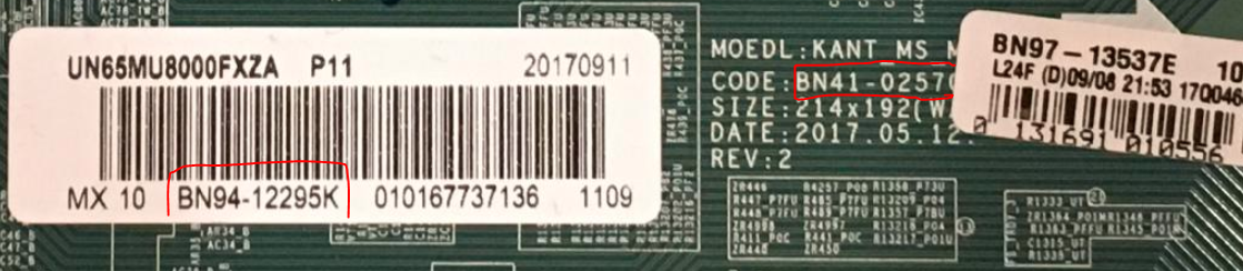

      Re: samsung ue55nu7021k backlights working but blank screen
      Originally posted by Yoda79
      Ok I think I've attached the photo of what you mean. It says BN95-05414Q?
      Do you think the board will be faulty, would the picture come on then? The picture test does work but inputs don't work nor is there any sound?
      Also what board at the back do you think needs replacing?
      inputs and sound all go through the mainbord as you cant update it either the next step is too try a replacement in my opinion unless more experienced members can advise us better.

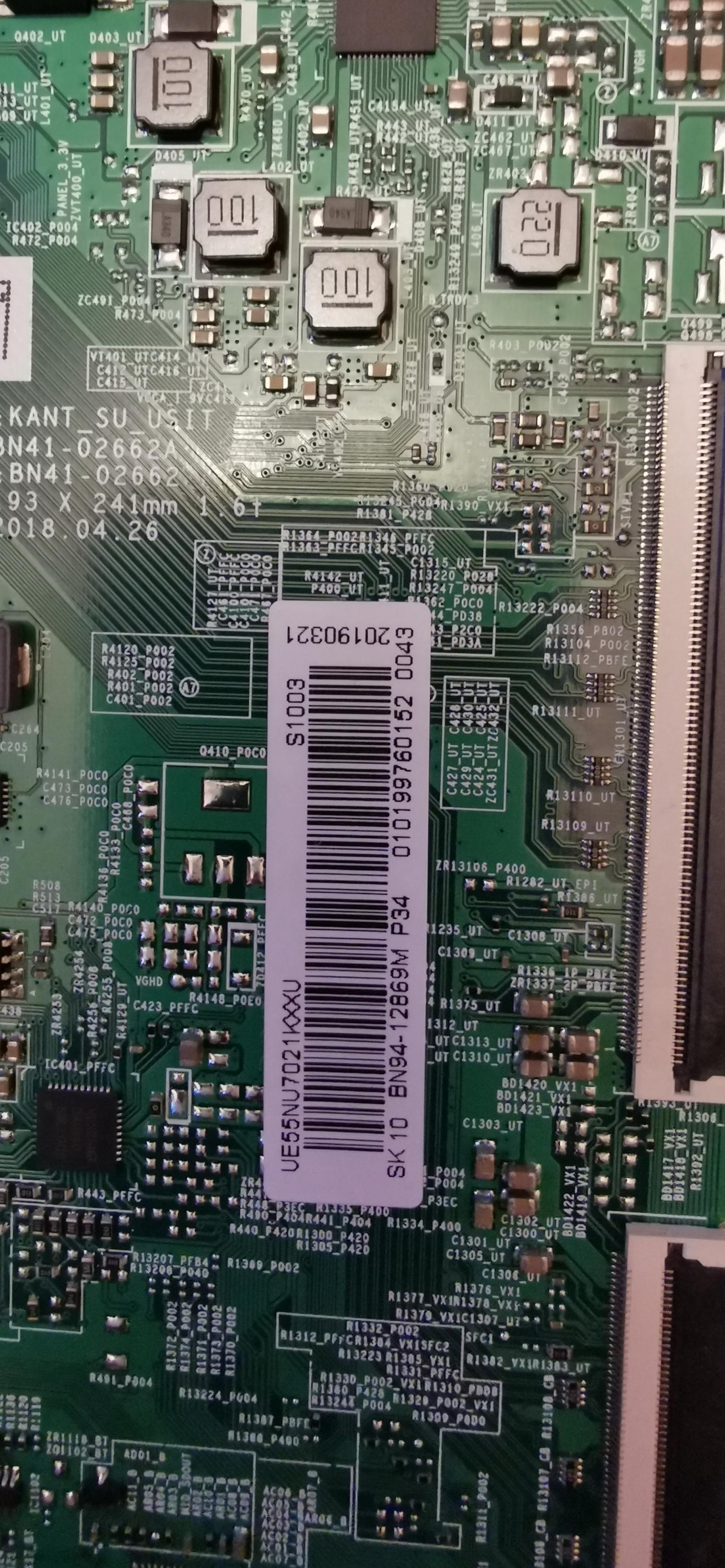

        #63
        Lotas when ordering a replacement main board which numbers do we use? im still learning myself i usually use the bn number (model bn41-02262) plus the cy-nn055hgev8h lcd panel number is this correct?
        If you order the mainboard for a specific Samsung model, then you need to use the number
        "BN94-XXXXXX"

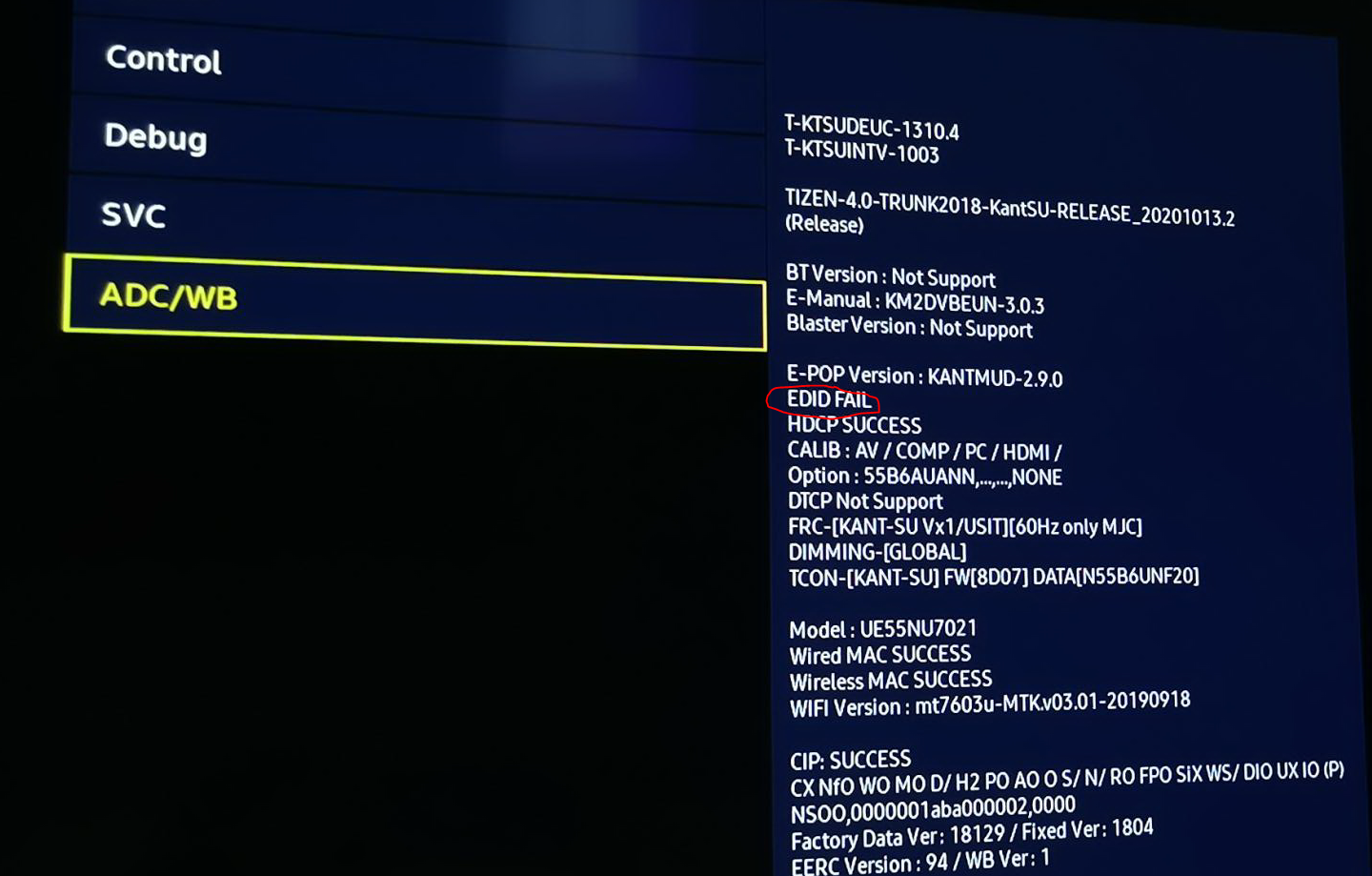

              #66
              If his inputs do not work and there is no sound, then most likely the HDMI inputs are disabled (something was connected to "hot").

                #67
                yoda79
                can you take a clear picture of this white sticker too many thanks
                Ok so this is on the mainboard ( the green one), does this help?
                The number is BN94-12869M

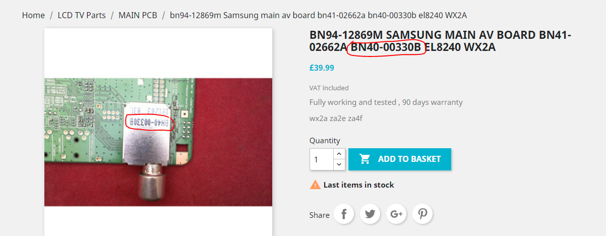

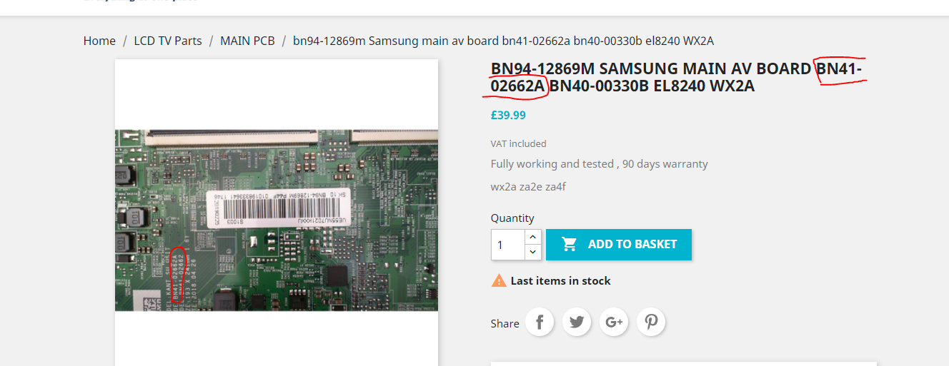

                  #68
                  The only place i can find with that exact board is out of stock so maybe a common issue https://www.tvparts.co.uk/lcd-tv-spa...7021kxxu-ver02
                  Would this be the same one as well?
                  https://www.electromix.co.uk/main-pc...8240-wx2a.html
                  • Yoda79

                    #69

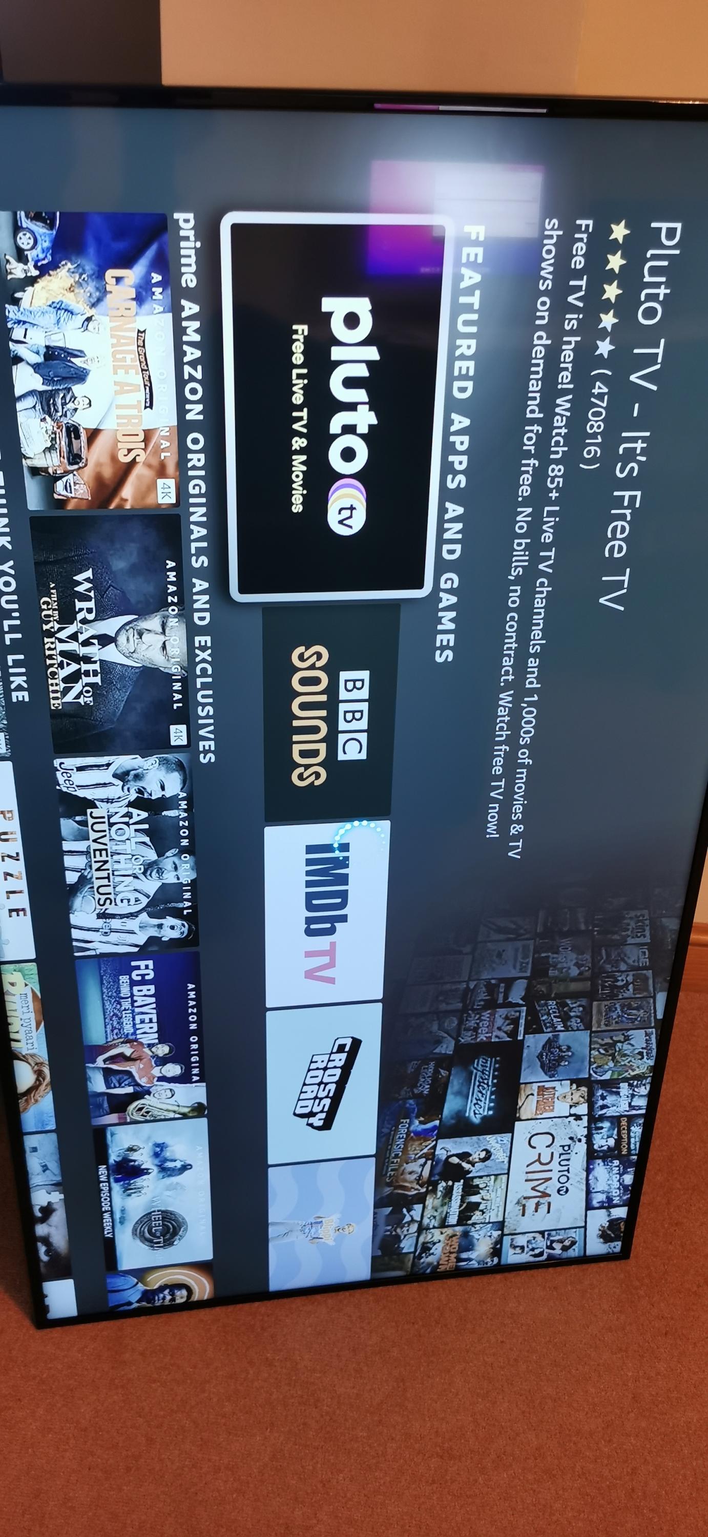

                    So on odd occasions I could get inputs to works, could only switch via the buttons on the tv itself but whilst i got picture, got no sound.
                    Sorry can I ask what you mean connected too HOT?

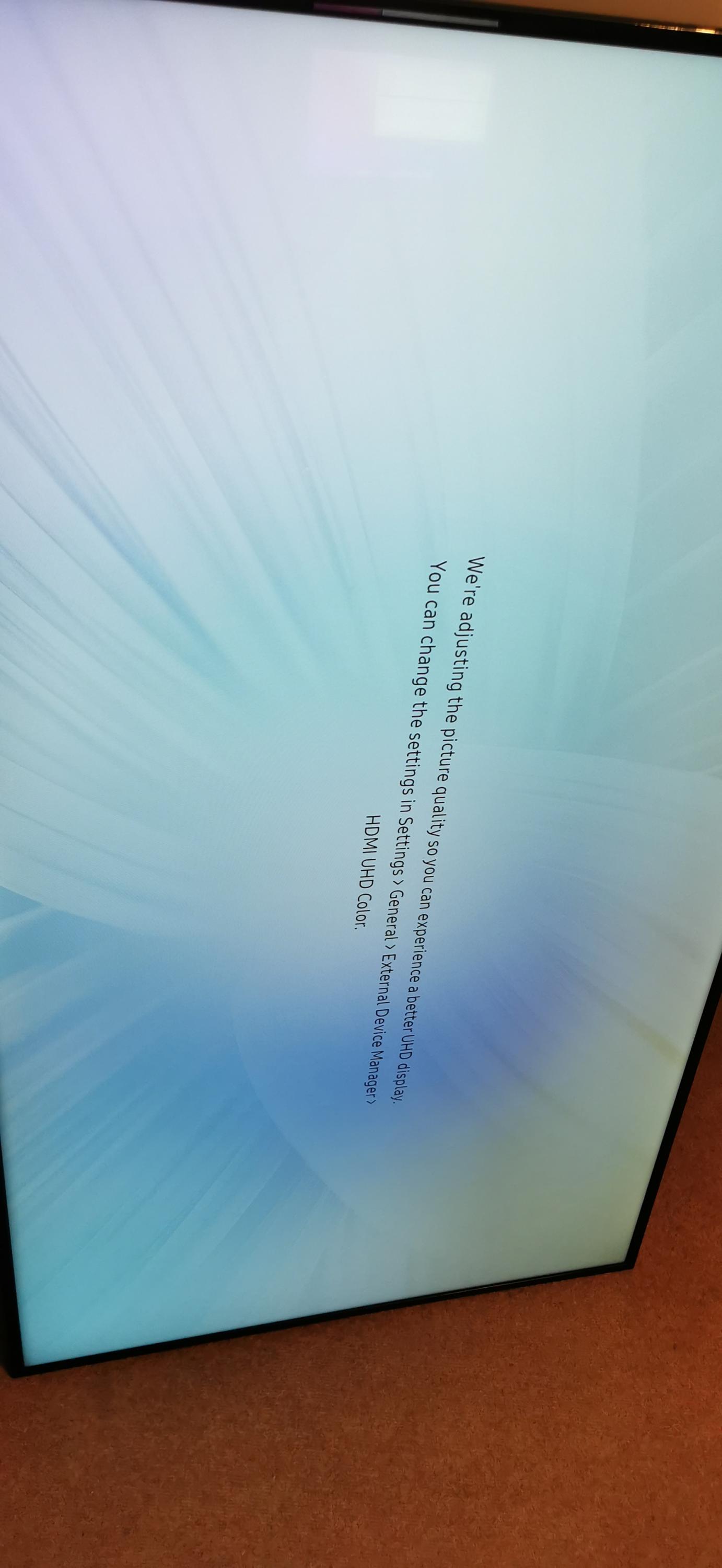

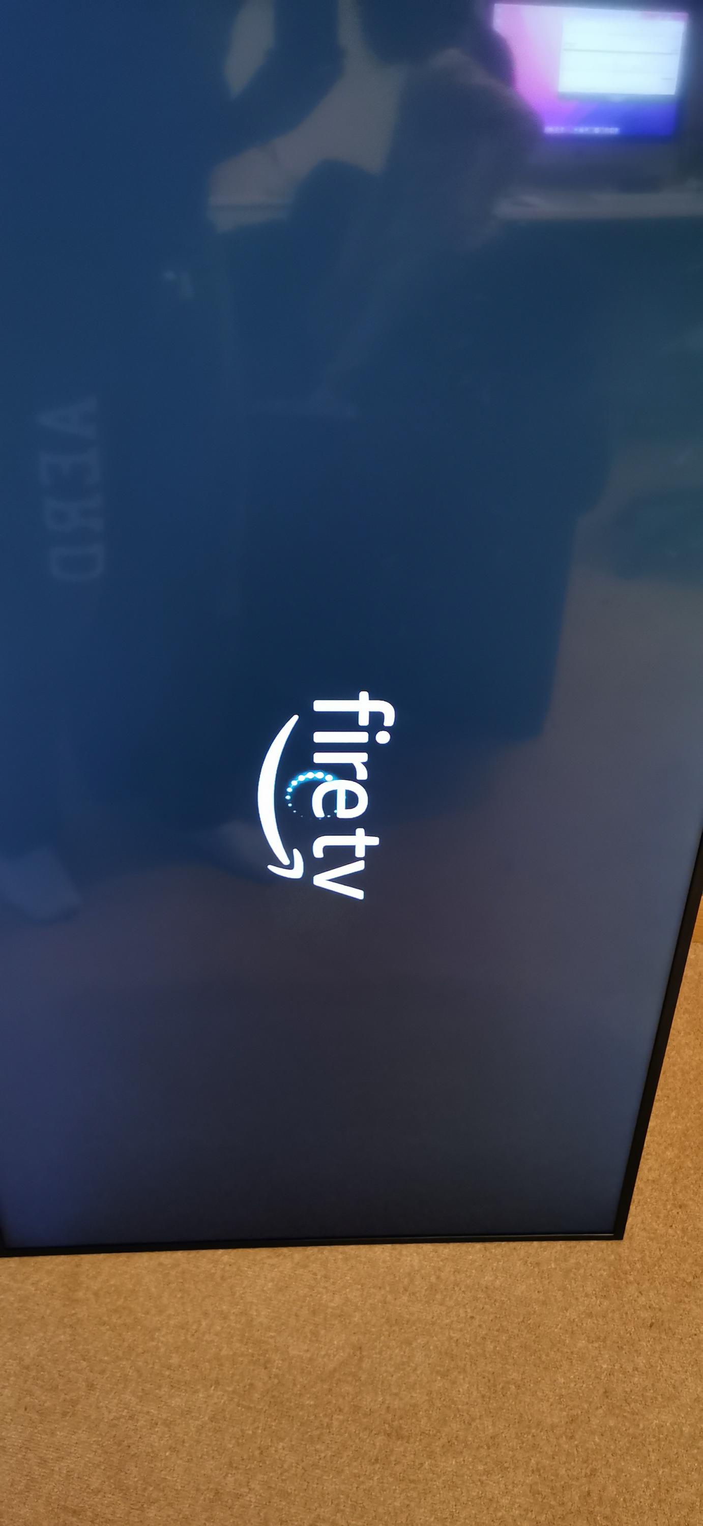

                      #70
                      So just checked this once again and managed to get the fire stick on the HDMI port displaying. Although the round circle suggesting its thinking keep constantly coming as well as the message as per the photos. I've also uploaded a video (zip file) to show how its constantly cycling between the screen, then get the thinking circle and then the message after-which your back to the display from the input.

                        #71
                        yes if it was me i would take a chance on buying it (but only you can make the decision buying it as may not solve the fault) i have just seen your post lower down good you managed too get it showing a picture again not sure whats causing that error message.

                            #73
                            HDMI may also fail with EDID (Extended Display Identification Data) corruption.

                              #74
                              Yes it is.

                                    #77
                                    Hi all, just looking at that board I found. It has several numbers on it. The first number matches the sticker on the one within the tv on the green board (BN94-12869M) but the others on the product description do not?
                                    It lists BN41-02662A BN40-00330B EL8240 WX2A, I can't find these on my TV. Is that a problem or is this the right one for my TV?
                                    I know its a risk but for £45, I might as well give it a go.

                                      #78
                                      3rd picture in post 56 i can see printed code BN41-02662A so yes should work ok in my opinion

                                        #79
                                        BN40-00330B -TUNER
                                        The most important thing for you is that the part number BN94-12869M would correspond.
                                        • lotas
                                          • Jan 2016
                                          • 4746
                                          • Russia
                                          #80
                                          BOARD BN41-02662A is the PCB number.
