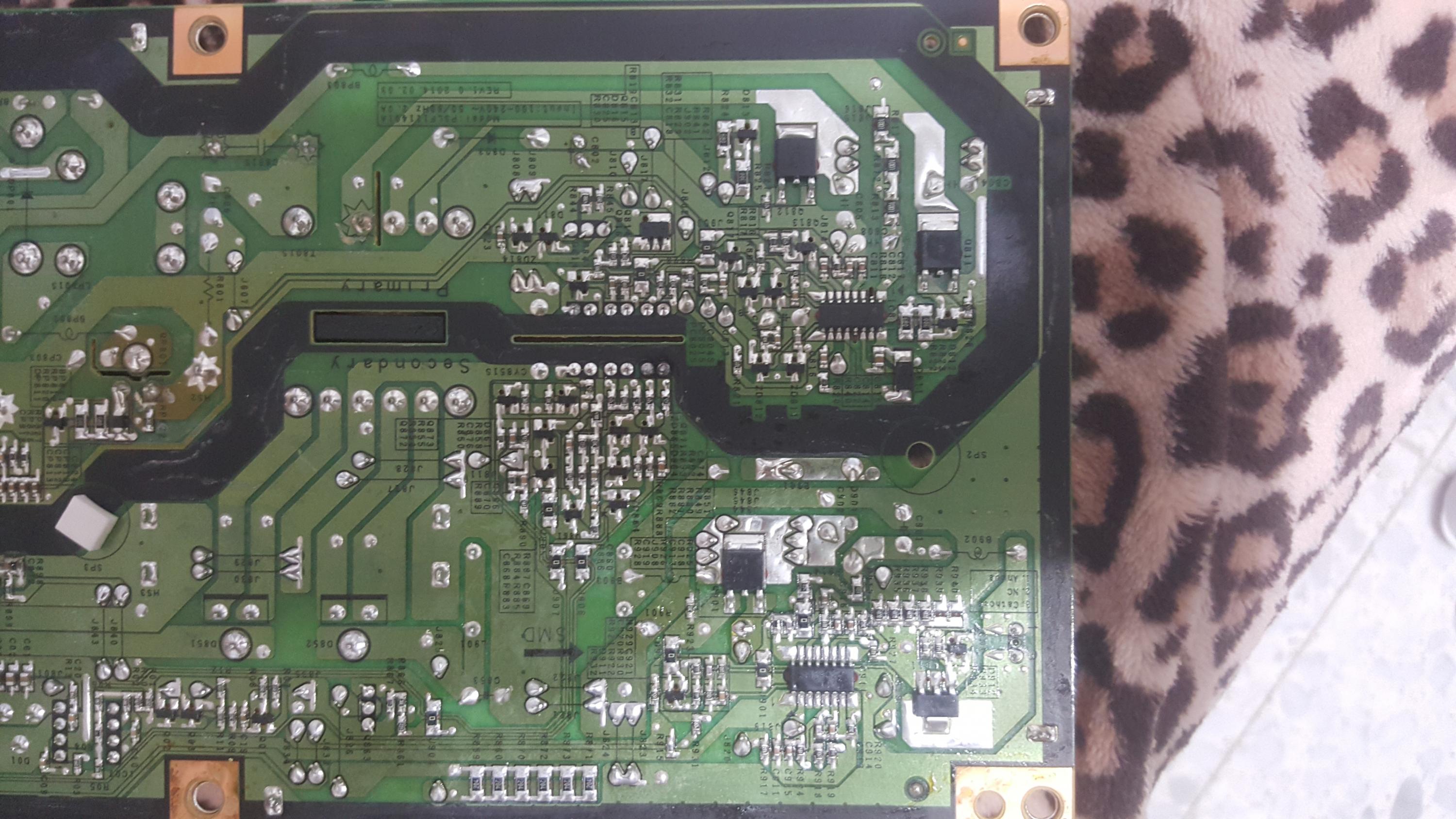

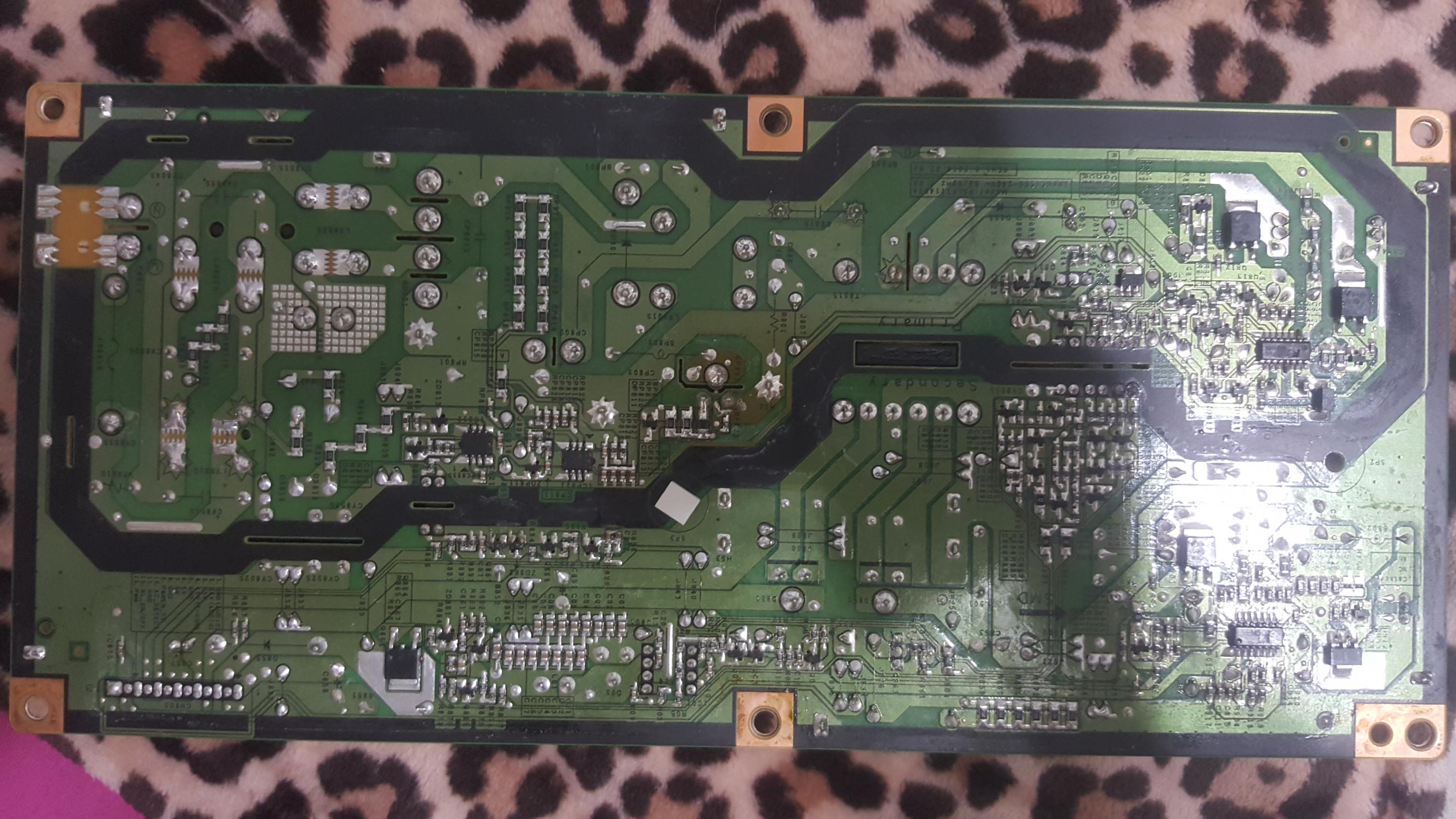

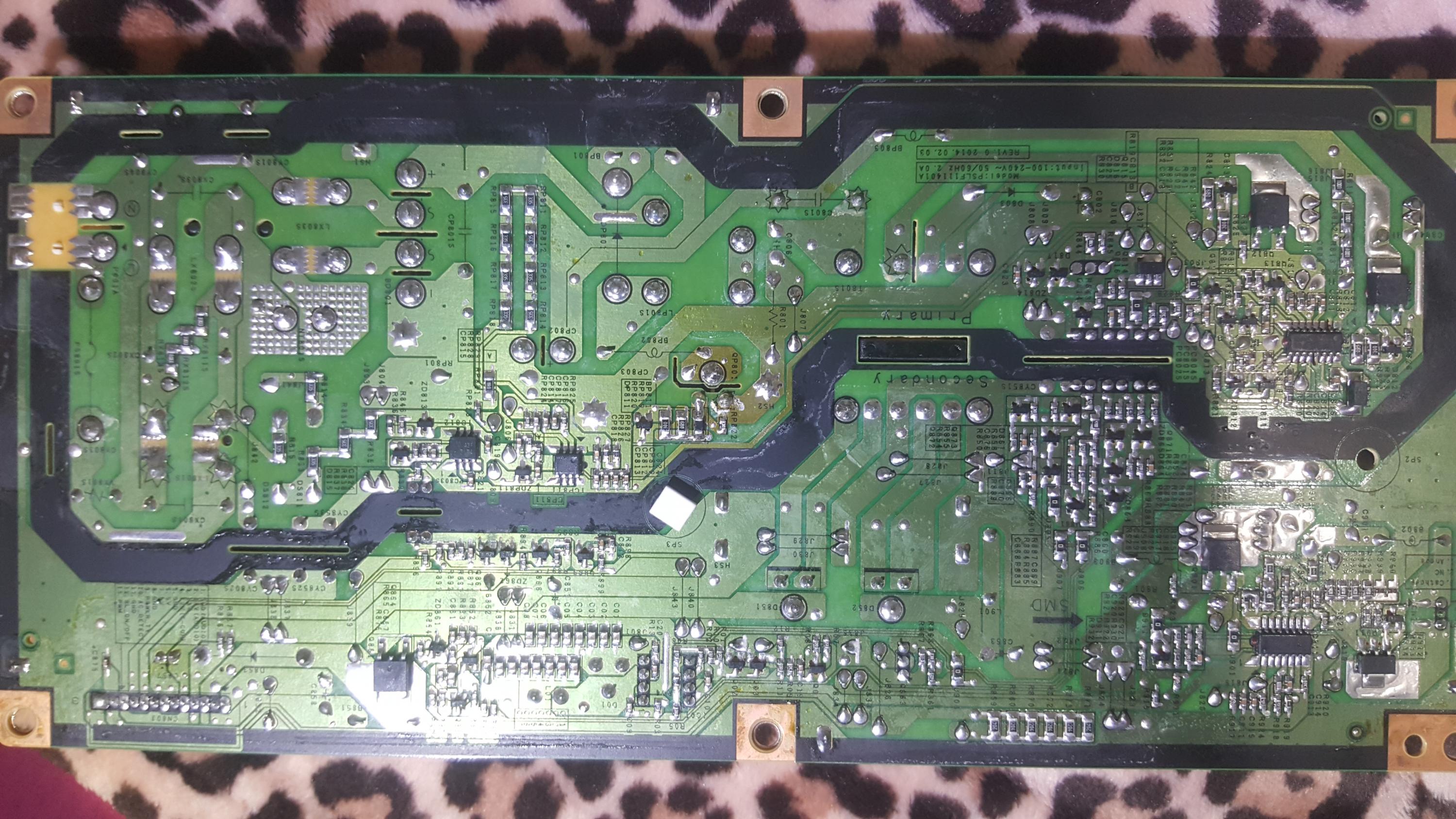

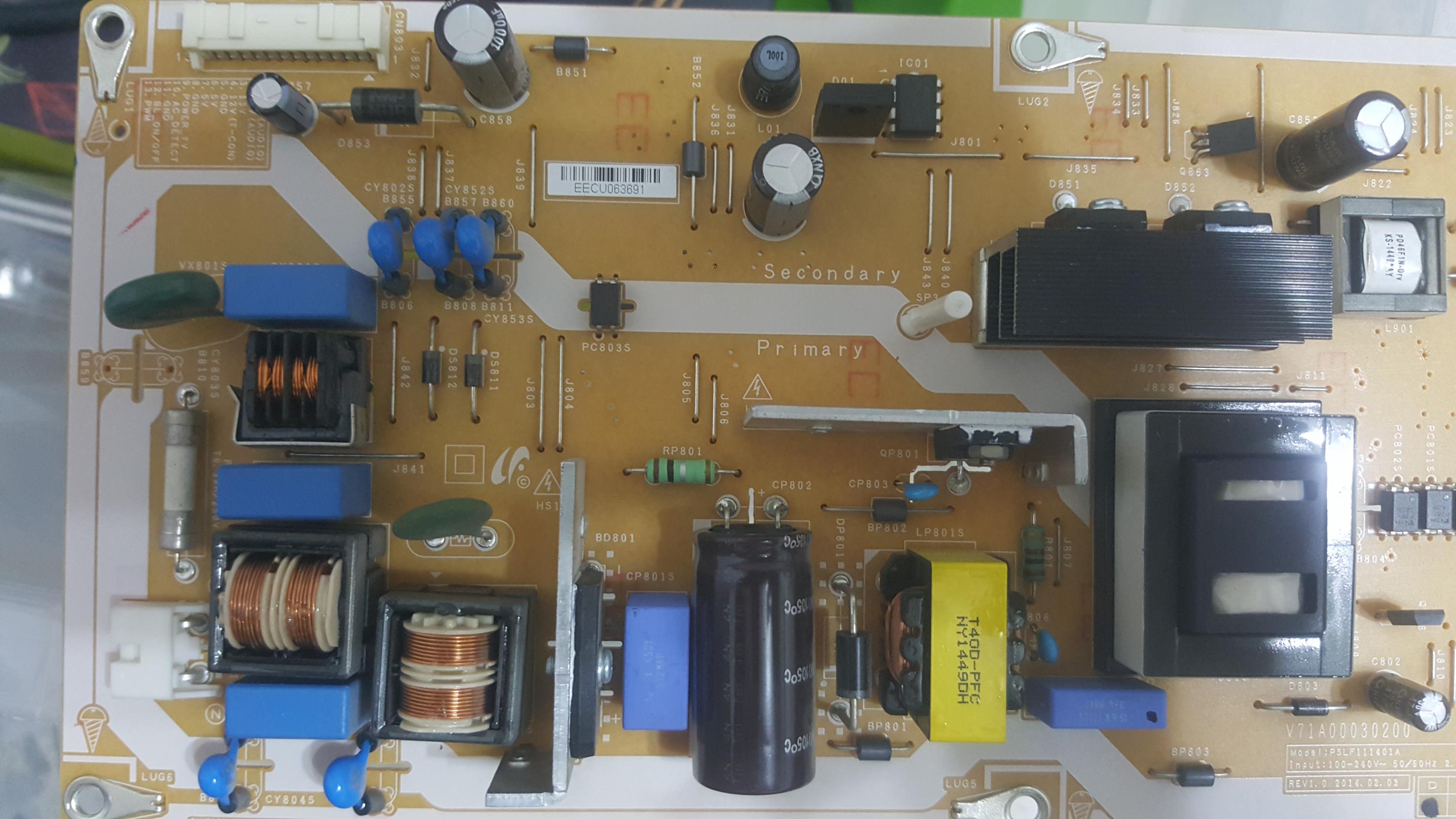

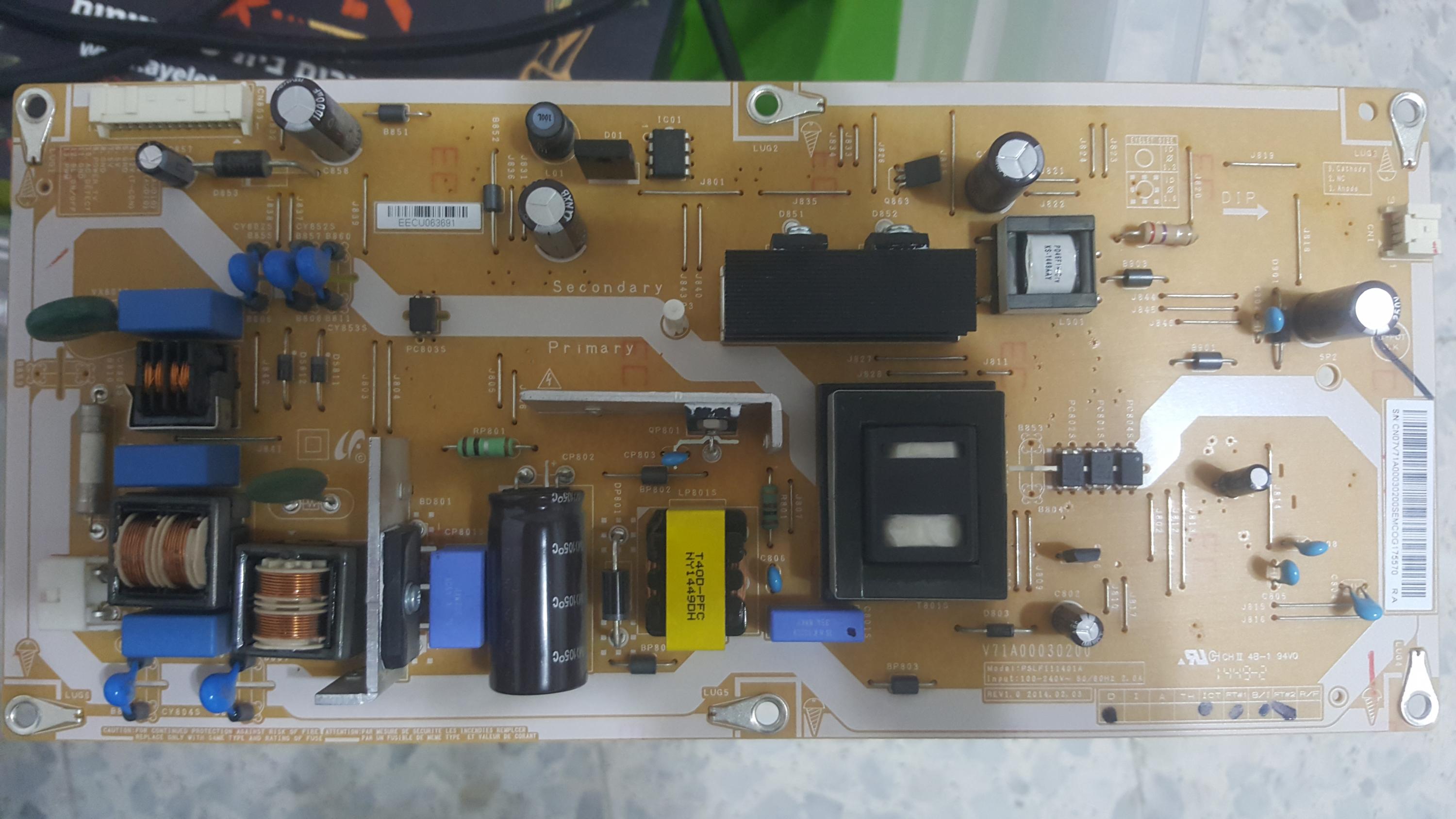

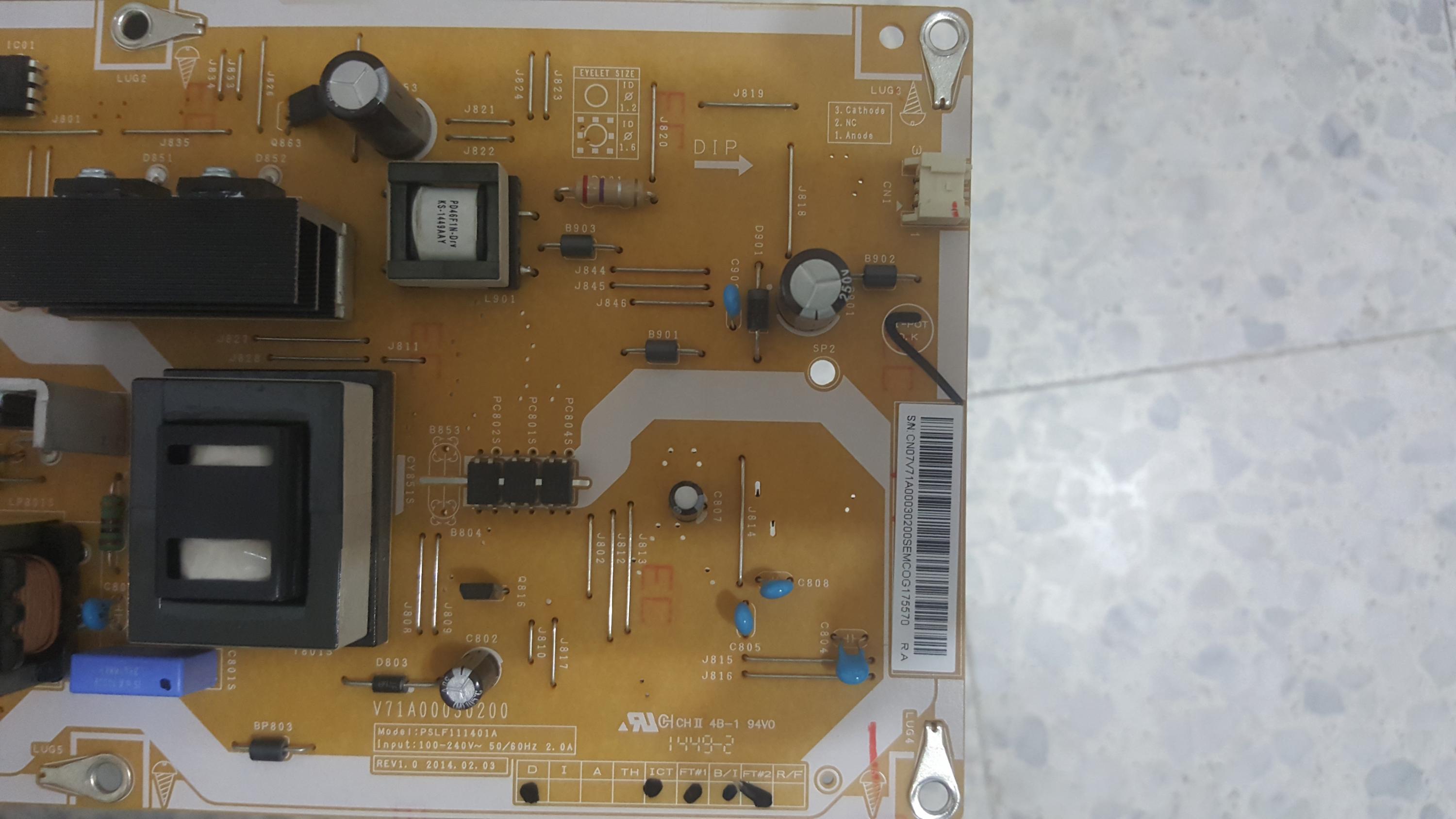

    I have a Toshiba LED tv model number 40L2400VQ.
    I don't receive the correct voltage at the output to the LEDs.
    I disassembled the front panel and checked all leds and they are fine. Then I checked the voltage to the leds on the power board and it flactuate in milivolts.
    Tested all caps with esr meter and they are fine.
    The diodes are fine and the resistors too.
    Where should I concentrate on?
    Thanks in advance.

      Check the output transistor on the bottom of the board for shorts ,also you should be getting voltage at 2 rectifying diodes after the transformer on secondary side no matter if the led driver is working, if everything else fine then its the pwm ic is probably bad.
