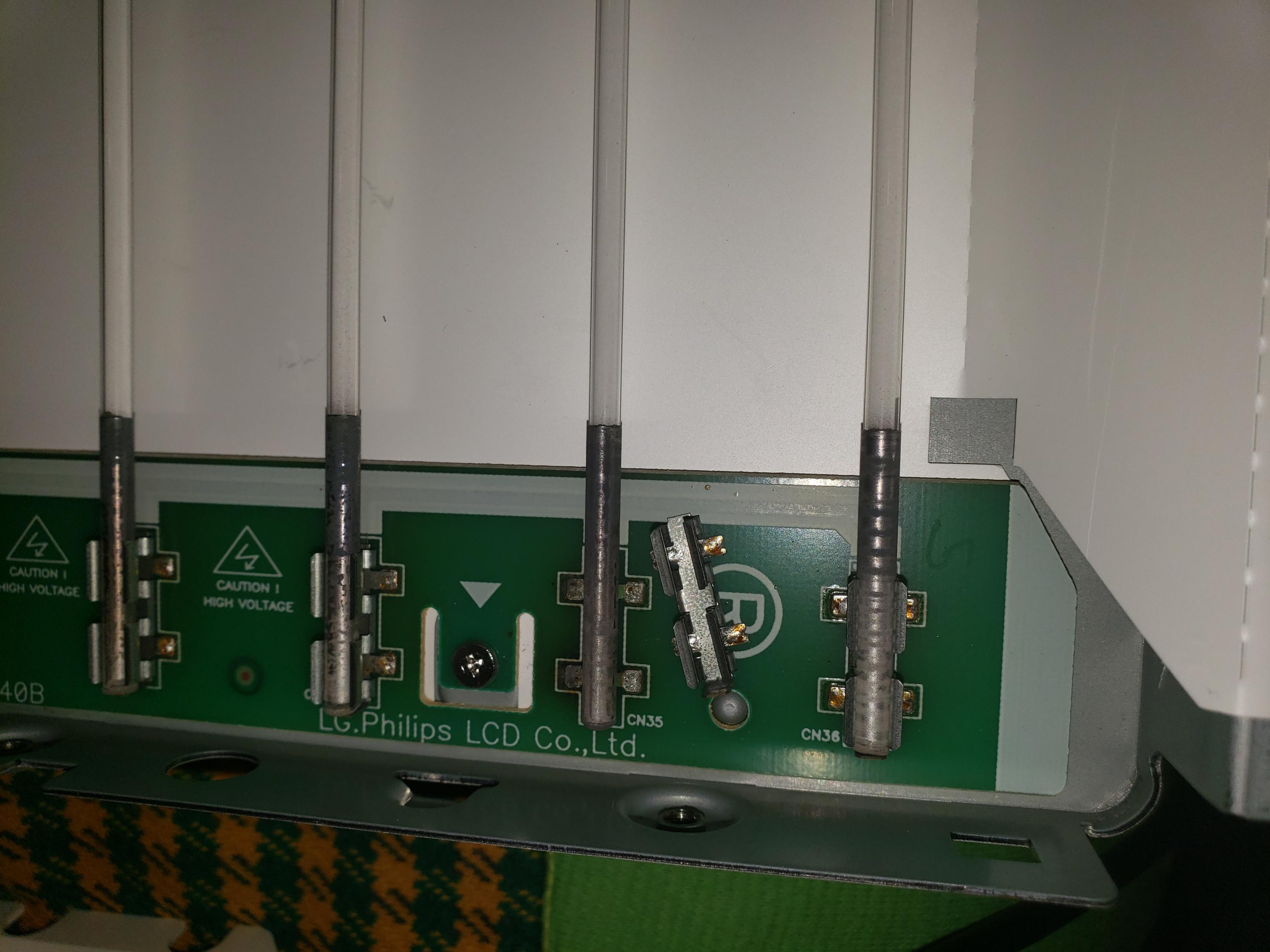

    Hi folks,
    I'm suspecting the actual CCFL or EFL being bad, just not sure how to test, but would like to confirm.
    TV clicks upon plugging in AC. When I press the PWR ON button, clicks again.
    LED on the Main board comes on green (Assuming some diagnostics), Blue LED on the TCON comes on also when I turn the TV on, but turns off about 30 seconds later.
    3V3 ST is on (3.26 V)
    Standy 3.3 V (off) when I press power button goes to 0.16 V
    12Vssb is 11.75 V (on), 0.18 V (0ff)
    +12Voud is 13.8V (on) ~ 0V off
    -12Voud is -12.4 V (On) ~0V off
    INV-on is 3.00 V (on), 0.115 (off)
    Seems that it's in order from voltages standpoint. No bulging caps
    I don't have a high voltage source to test the CCFL / EFL

                  • R_J
                    • Jun 2012
                    • 9535
                    Re: Philips 42" TV 42PFL3603D/F7 clicks but No LCD Backlight
                    Have you checked the inverter distribution board, I don't see it in your picture, follow the high voltage cables from the power supply inverter to the inverter boards

                      • jason123
                        • Oct 2015
                        • 1060
                        One ccfl completely disconnected. Let's see if that does it

                          • R_J
                            • Jun 2012
                            • 9535
                            Do they try to light? How are all the other connections to the lamps?
                            • jason123
                              • Oct 2015
                              • 1060
                              I went through all and solder them all. They don't try to light up at all
