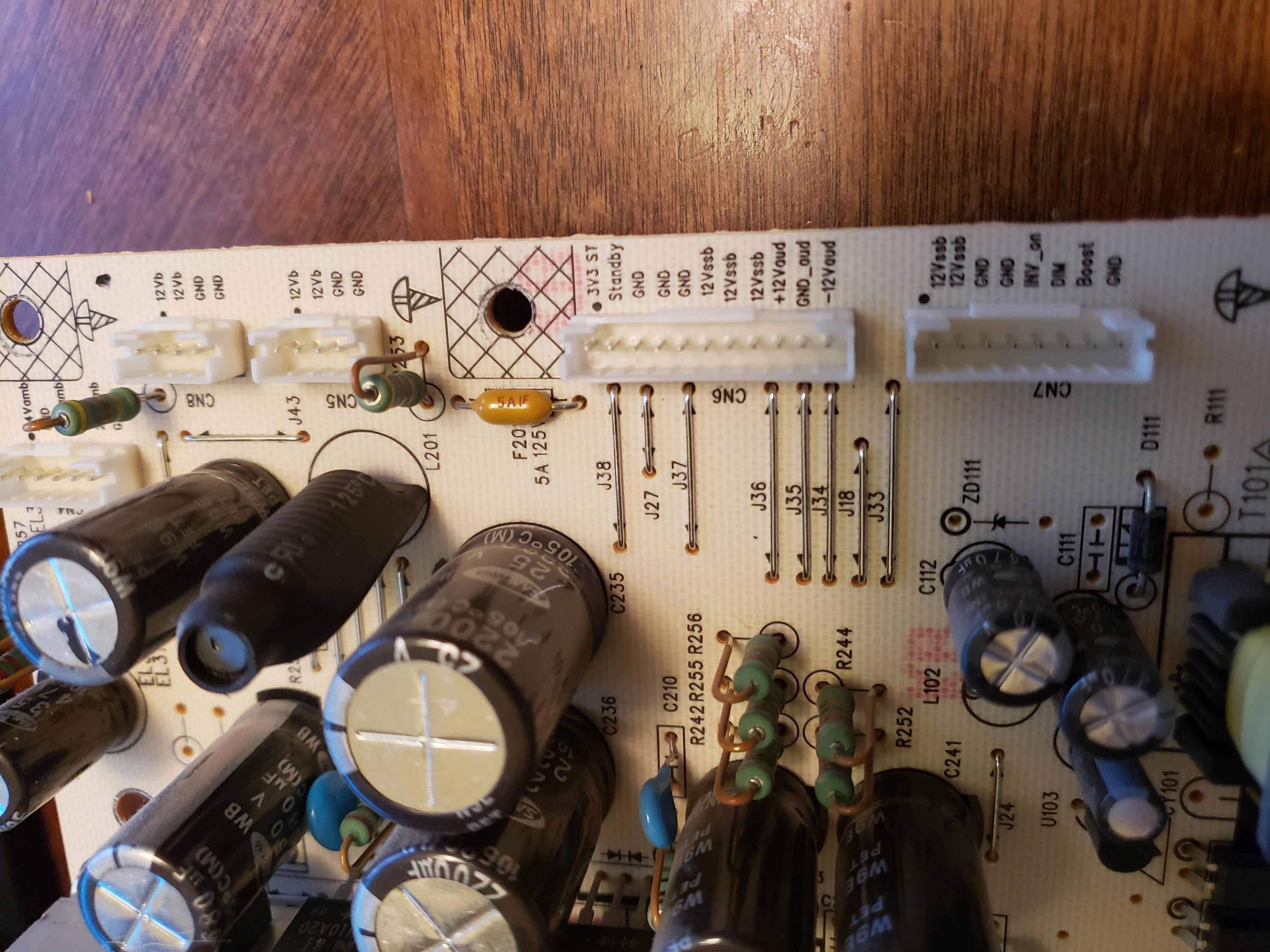

    Hi folks,
    I'm suspecting the actual CCFL or EFL being bad, just not sure how to test, but would like to confirm.
    TV clicks upon plugging in AC. When I press the PWR ON button, clicks again.
    LED on the Main board comes on green (Assuming some diagnostics), Blue LED on the TCON comes on also when I turn the TV on, but turns off about 30 seconds later.
    3V3 ST is on (3.26 V)
    Standy 3.3 V (off) when I press power button goes to 0.16 V
    12Vssb is 11.75 V (on), 0.18 V (0ff)
    +12Voud is 13.8V (on) ~ 0V off
    -12Voud is -12.4 V (On) ~0V off
    INV-on is 3.00 V (on), 0.115 (off)
    Seems that it's in order from voltages standpoint. No bulging caps
    I don't have a high voltage source to test the CCFL / EFL

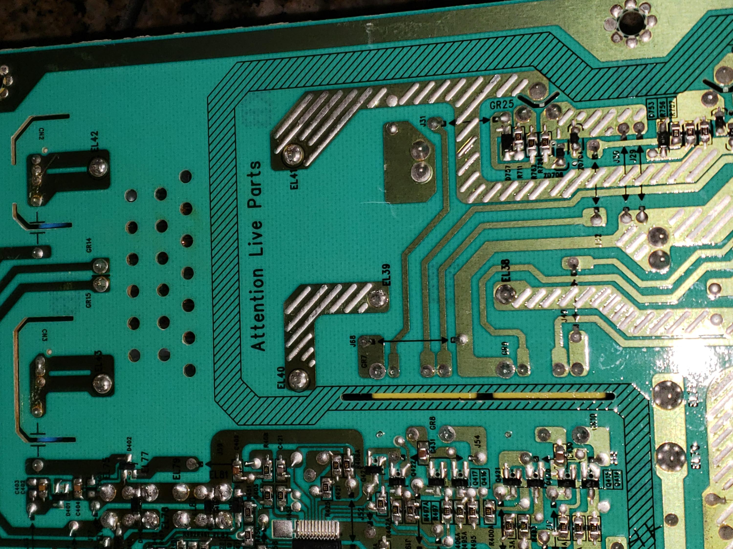

              Look under the inverter transformer for bad solder joints, these are notorious for them.
              Touch them all up while you have the power supply out.
                  Looks fairly clean. Touched up the solder.. no change

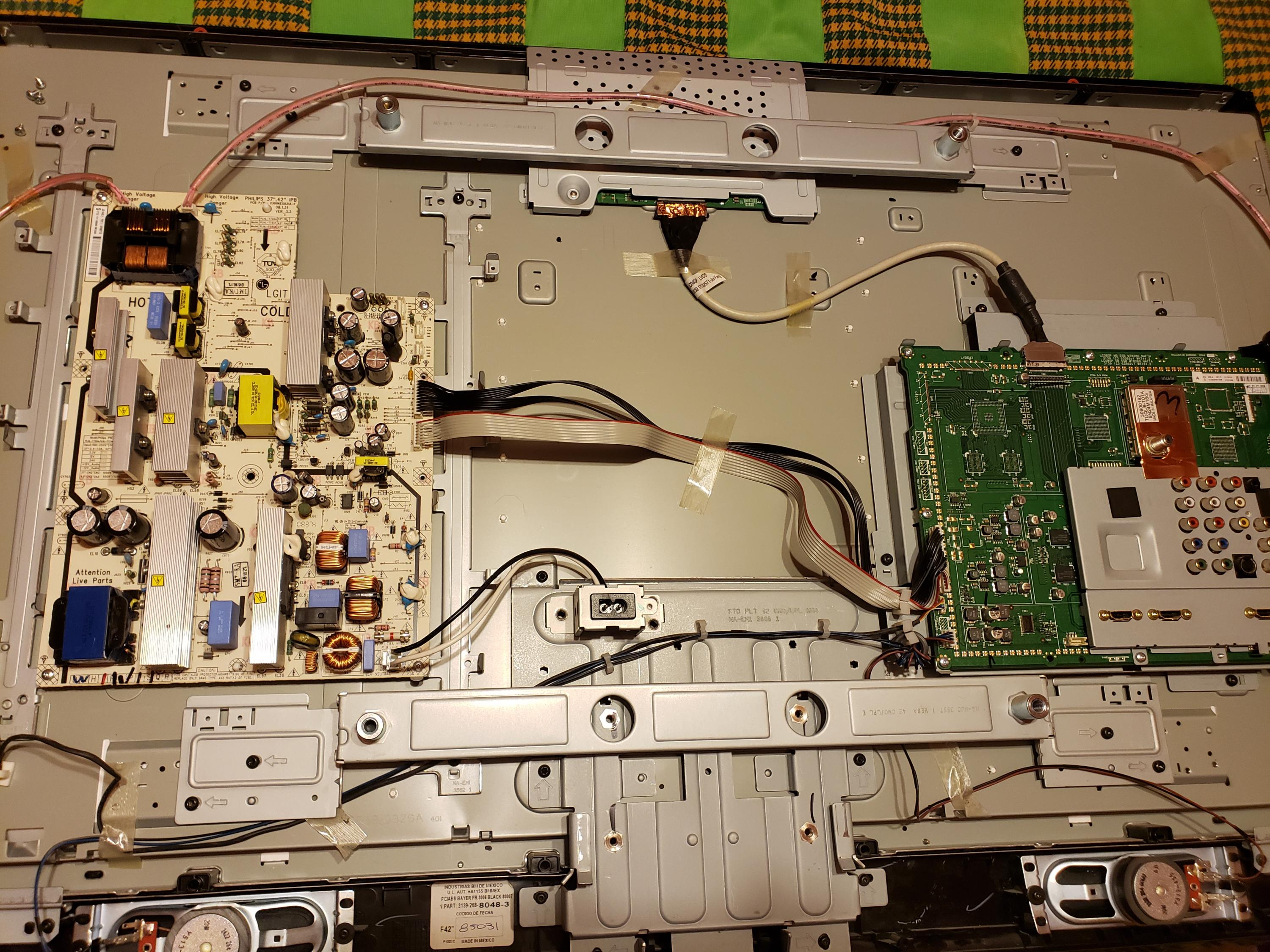

                    Have you checked the inverter distribution board, I don't see it in your picture, follow the high voltage cables from the power supply inverter to the inverter boards
                    • jason123
                      • Oct 2015
                      • 1069
                      Re: Philips 42" TV 42PFL3603D/F7 clicks but No LCD Backlight
                      I am assuming these distribution boards are inside the panel...haven't opened it yet

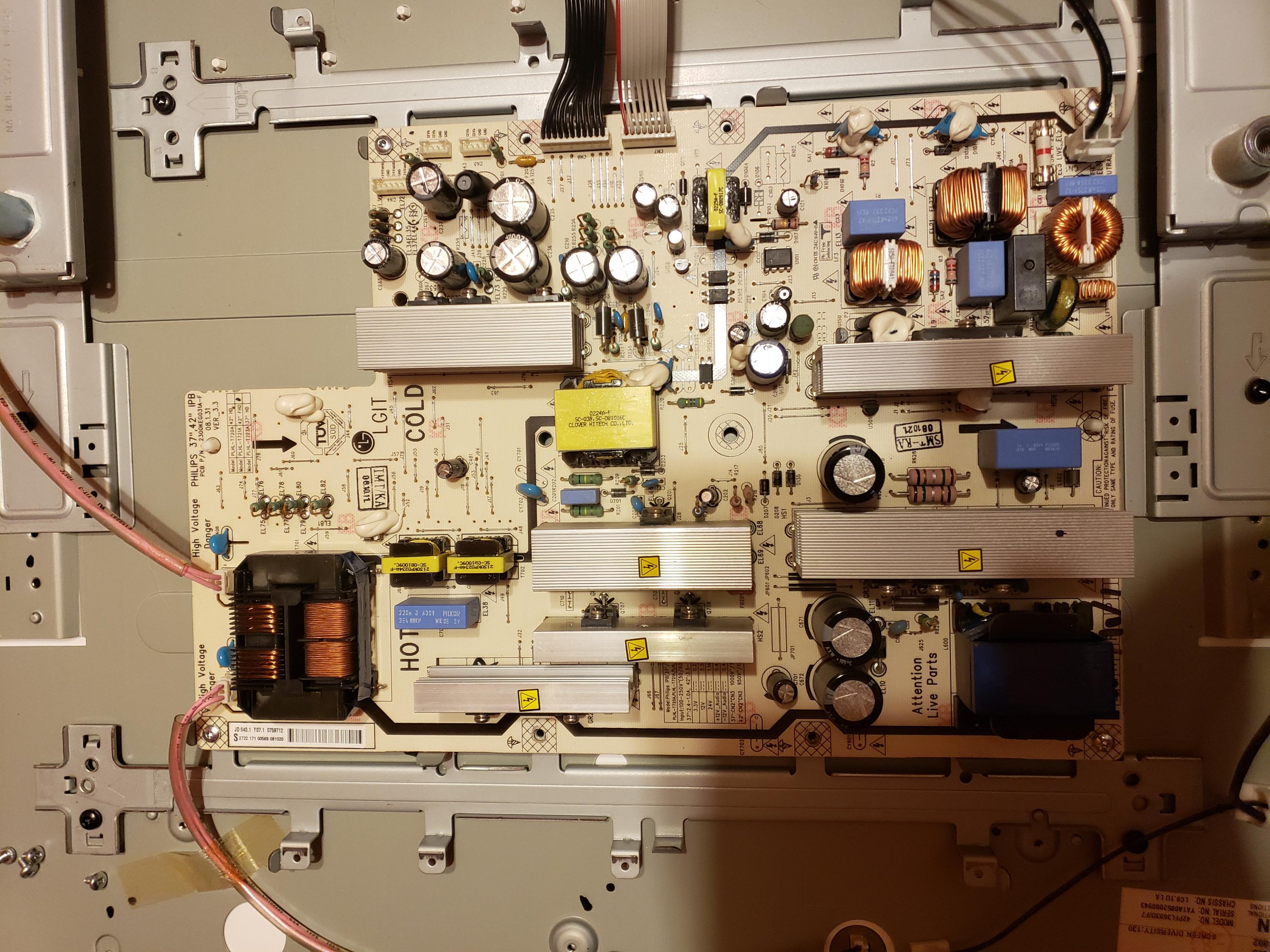

                                  Do you have the BL_ON_OFF voltage on CN7, pin-5? Check the voltages for U401, pin 20 should be +12v; pin 21/22 +5v
                                      Did you check the fuse on the inverter board?
