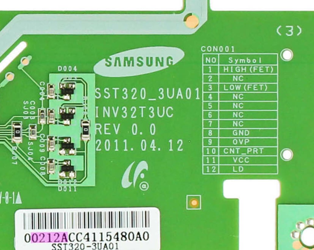

                  What voltages do you have at CON001 on the inverter board?
                  Pin 9 OVP =
                  Pin 10 CNT_PRT =
                  Pin 11 VCC =
                  Pin 12 LD =
                  And also CN802

                    The voltage across CP803s is 166v SB and 393v when the set is on. Voltages at CON001 on the inverter board when on are: pin 9- 0 volts, pin 10-8.4volts, pin 11-12.7volts, pin 12-0volts.

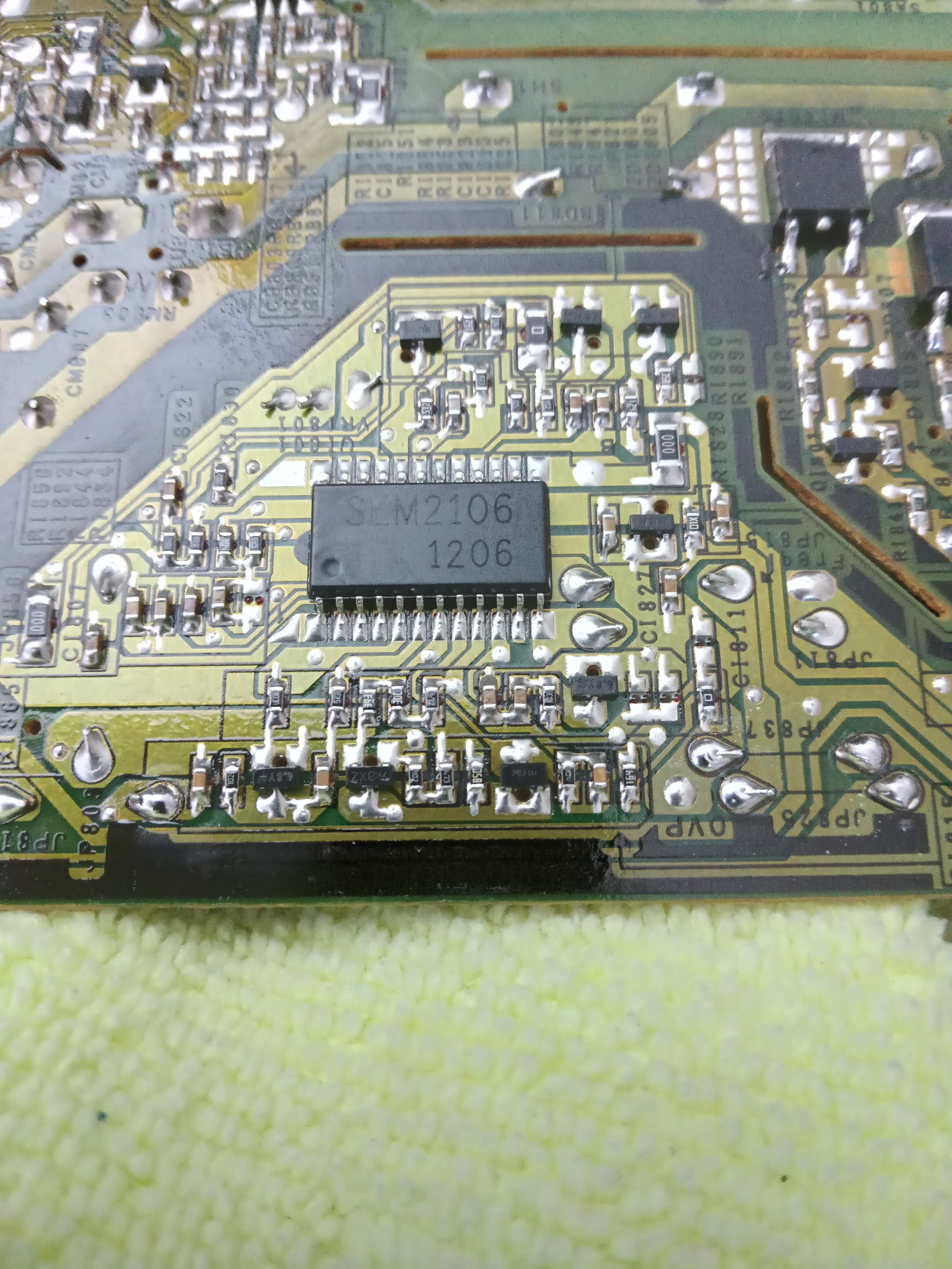

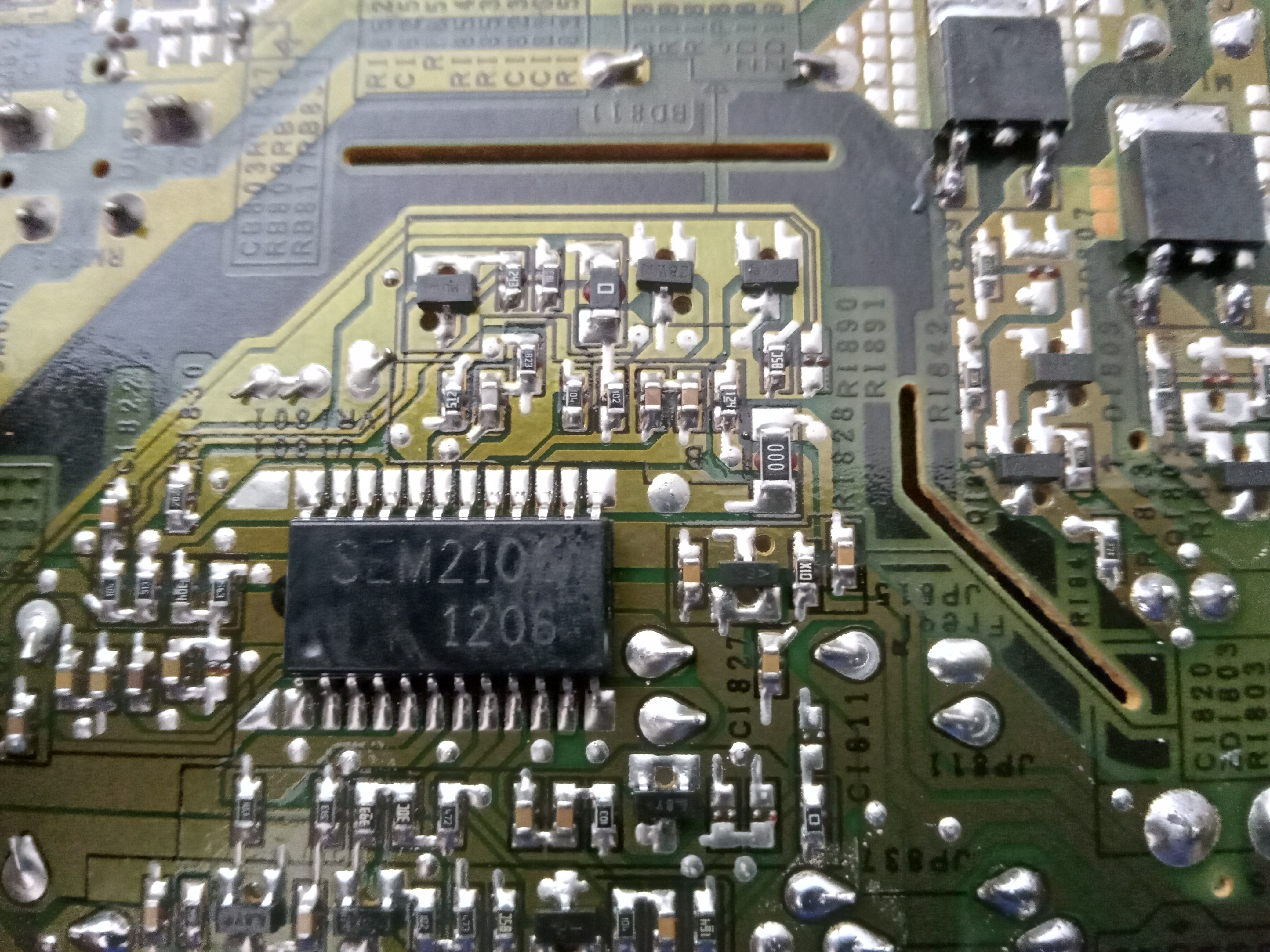

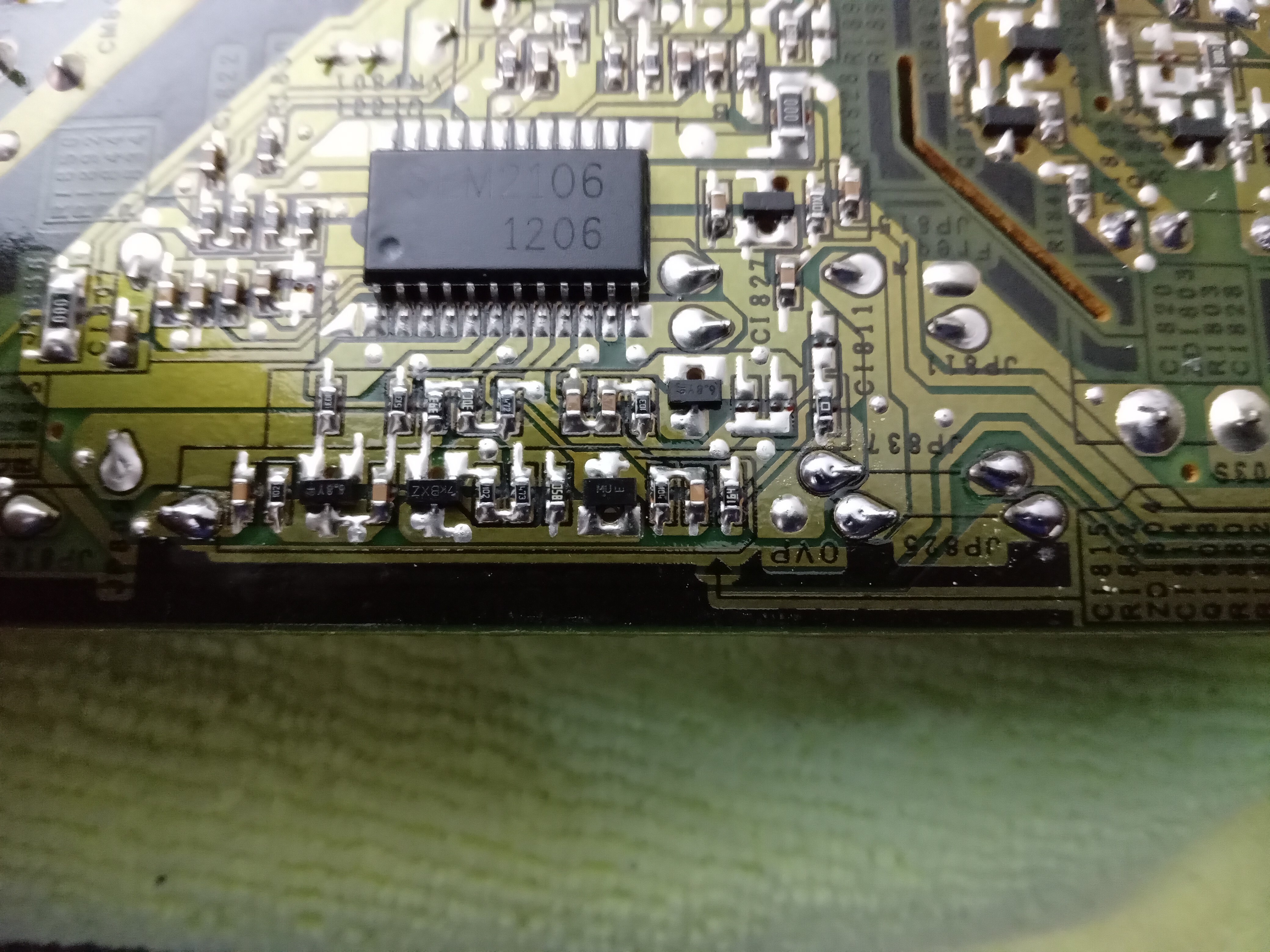

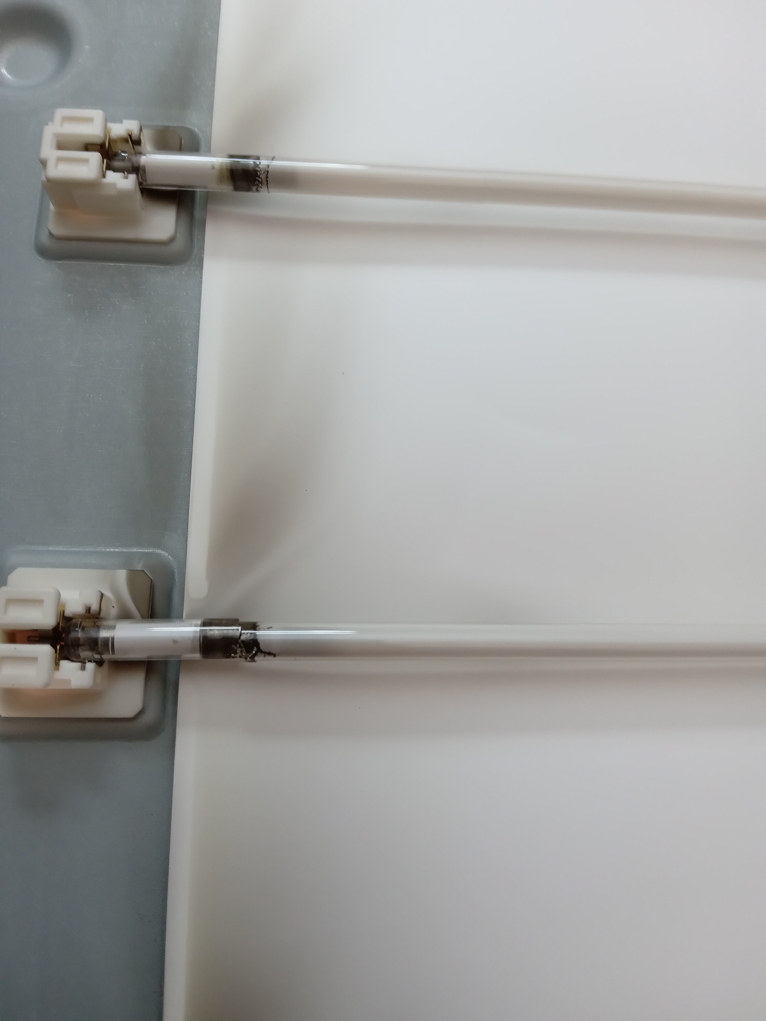

                            I have the same exact TV with the same exact problem.

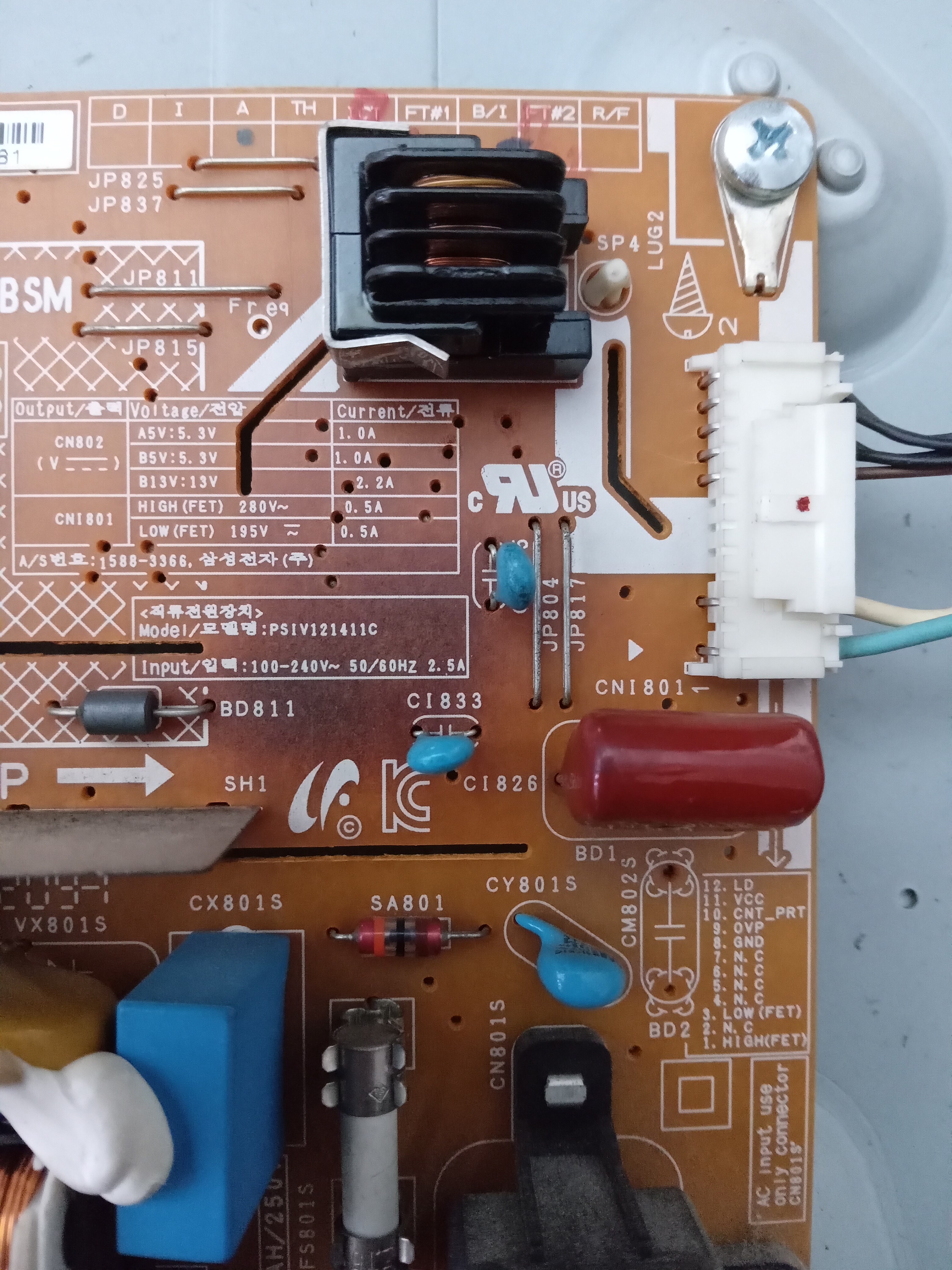

                            My readings on connector CN1801 are as follows - LD - 0volts / Vcc - 12.6v / CNT_PRT - 8.4v / OVP - 1.8v
                            Readings Taken with TV on.
                            The other pins with Low (fet) and high (fet) i'm not sure how to measure those?
                            at turn on High reads about upwards of 140v AC then dies off to around 19v AC
                            Low starts at 19v AC goes up to just 20v AC and drops back to 19v AC - i get no readings using the DC scale.
                            i tried another inverter board same problem, could it be power supply related or maybe i have a light failure/issue as well?
                            Any ideas help is appreciated.​
                            • TVAddict
                              • Jan 2022
                              • 70
                              • Caribbean
                              Forgot to ask, if it is some light issue as this thread is mostly suggesting, is there a way one could force the lights to stay on?

                                  Unhook all connectors from the powerboard, plug the power cord into powerboard, plug into power, check voltage on all the pins of CN802 connector, meter set to vdc, neg. probe on chassis ground, pos. probe on each pin, take care to only touch one pin at a time, report results. If you don't have an auto ranging meter, set meter to 20 vdc.

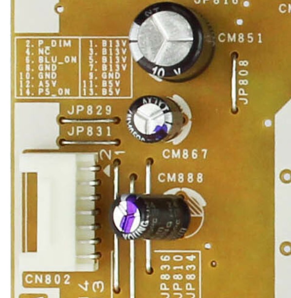

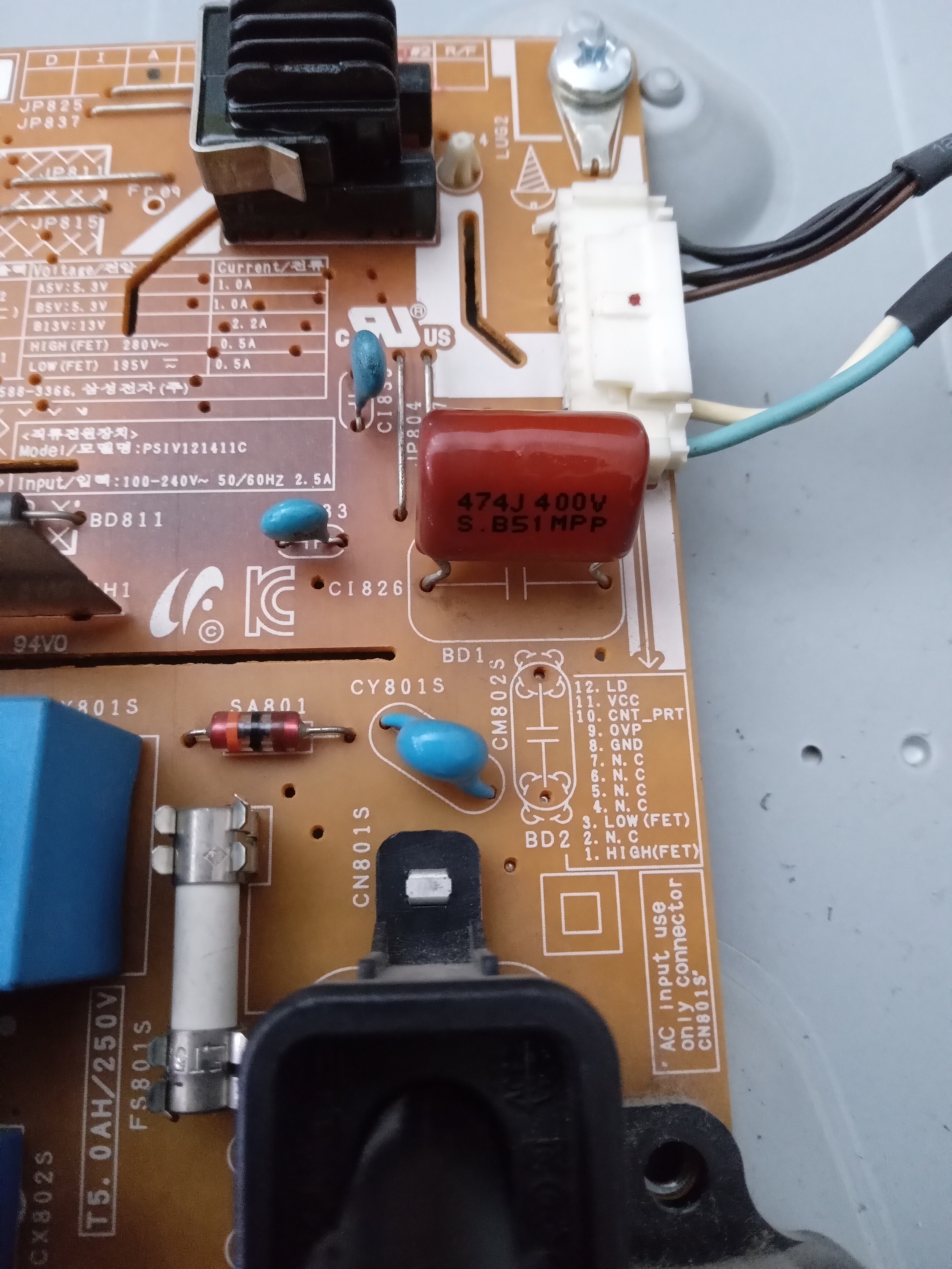

                                  i did measure voltages at CN802 but with ALL connectors hooked up and TV on - pins 1 - 7 = 12.6v pin 11 and 13 = 5.6v pin2 = 0.76v pin12 = 5.2v pin14 = 3.5v pin6 = 5.1v - but all voltages were steady, tv remains on with sound just the light cuts off after a few seconds of the tv turning on. Also voltage at the main cap is steady at 394v
                                  But i'll try what you suggested and see what readings i get...
                                  • TVAddict
                                    • Jan 2022
                                    • 70
                                    • Caribbean
                                    with all connectors off readings on CN802 are :
                                    pins 1 - 7 = 13v
                                    11,13 = 5.2v
                                    14 = 3.3v
                                    12 = 5.2v
                                    2+6 = 0v
                                    Tried the light test in post#4 - the light flashed for a second and turned off
                                    Tried leaving the OPV pin disconnected = same problem
                                    tested the 474j cap it read 460, i figure that's still workable..?

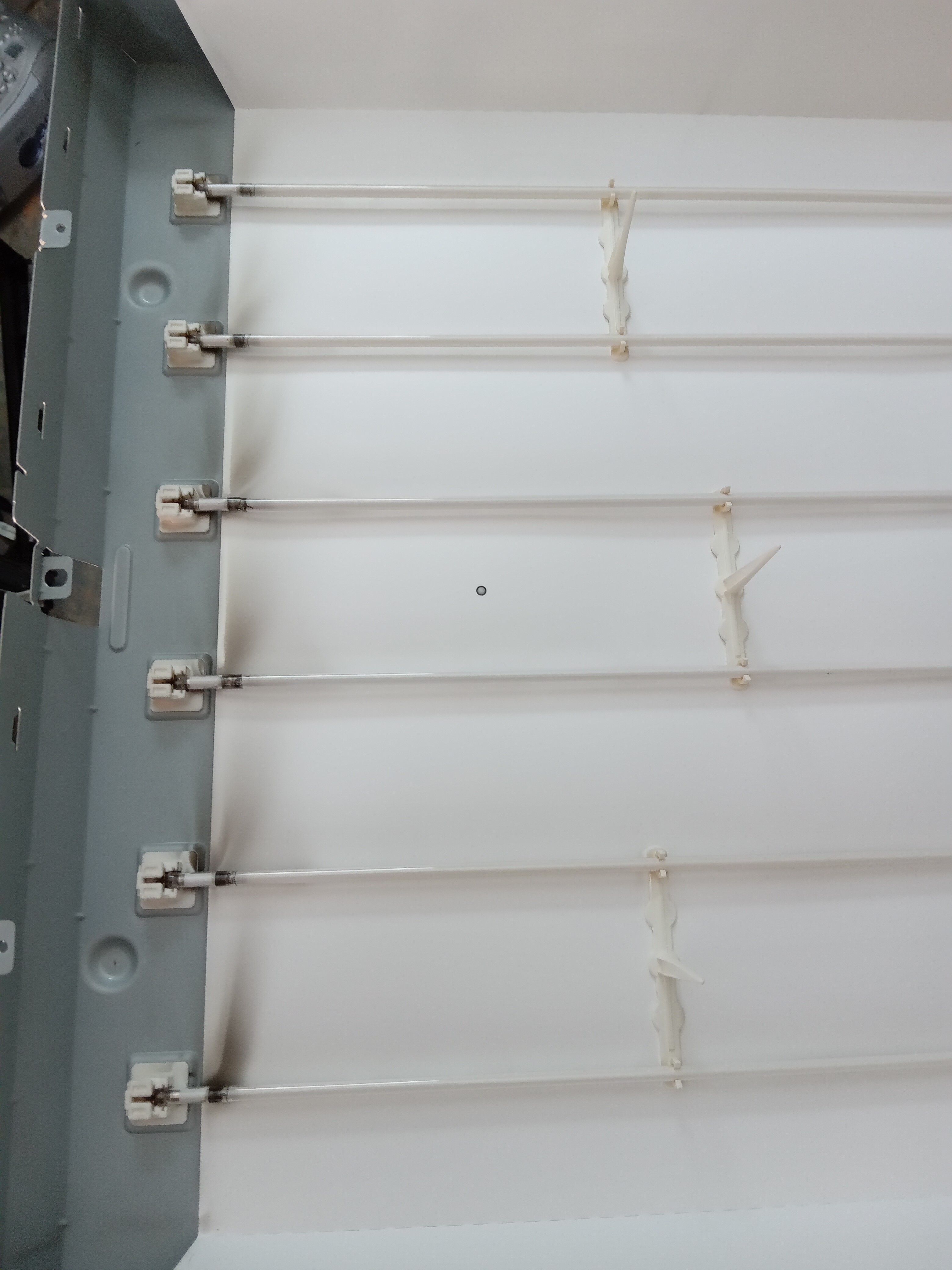

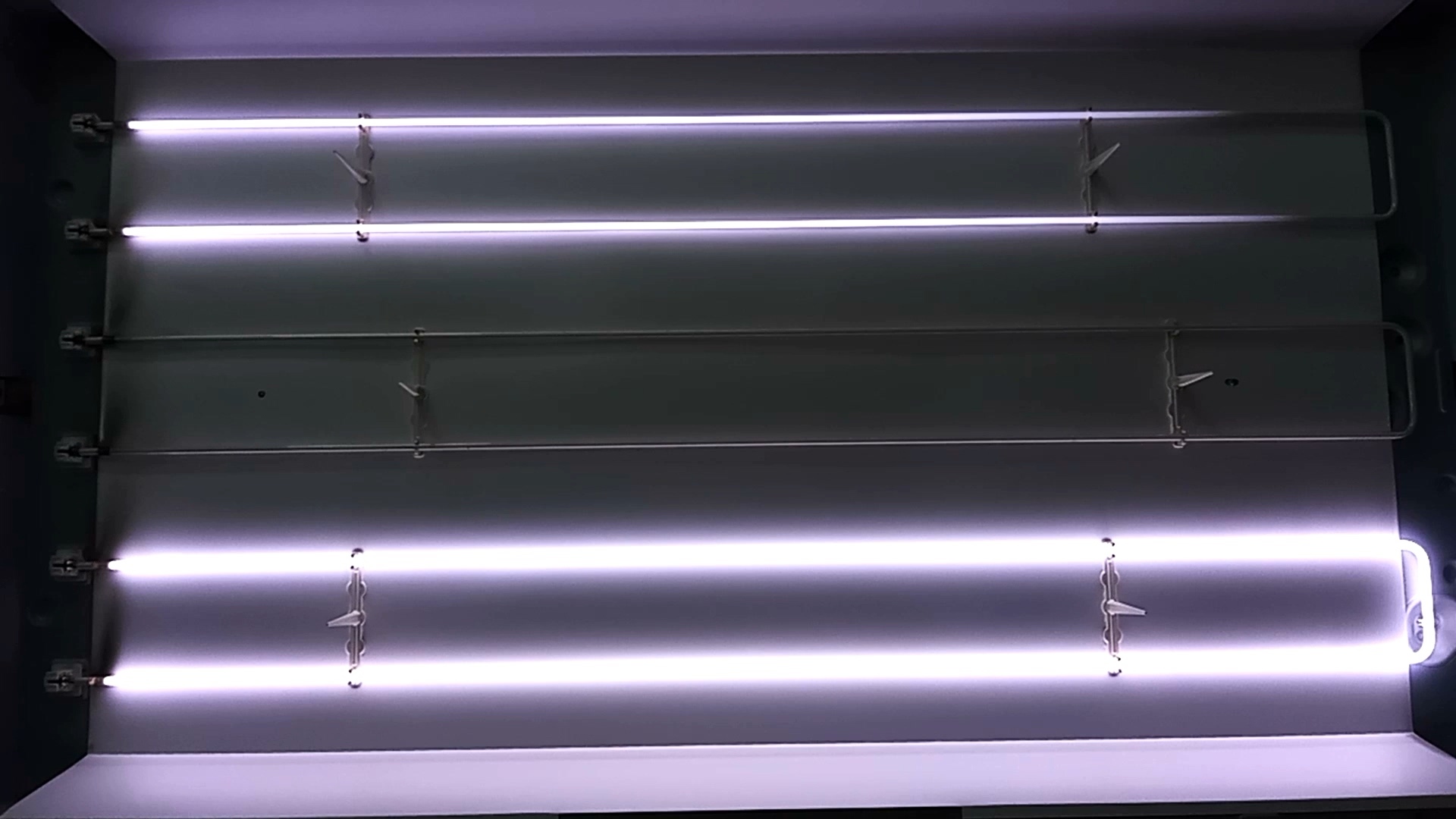

                                      hey guys i decided to take the TV apart and have a look at the lights, turns out it is the problem as suspected, as you will see in the pictures, one of them ( the middle light ) is literally busted, so that's it for me, it's the garbage for this tv, thanks to this thread and everyone for your help..
