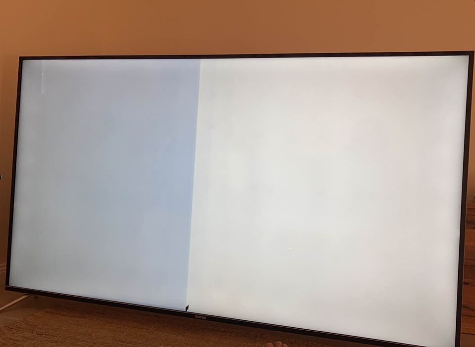

    N75UX17A-AU T-COn board issue?
    would I be right in thinking this may be a tcon board issue?
    Its a Soniq N75UX17A
    All I have is this picture and the guy said that he bought it yesterday but something must have happened in transit.
    Not sure if thats screen damage in the middle bottom or not?

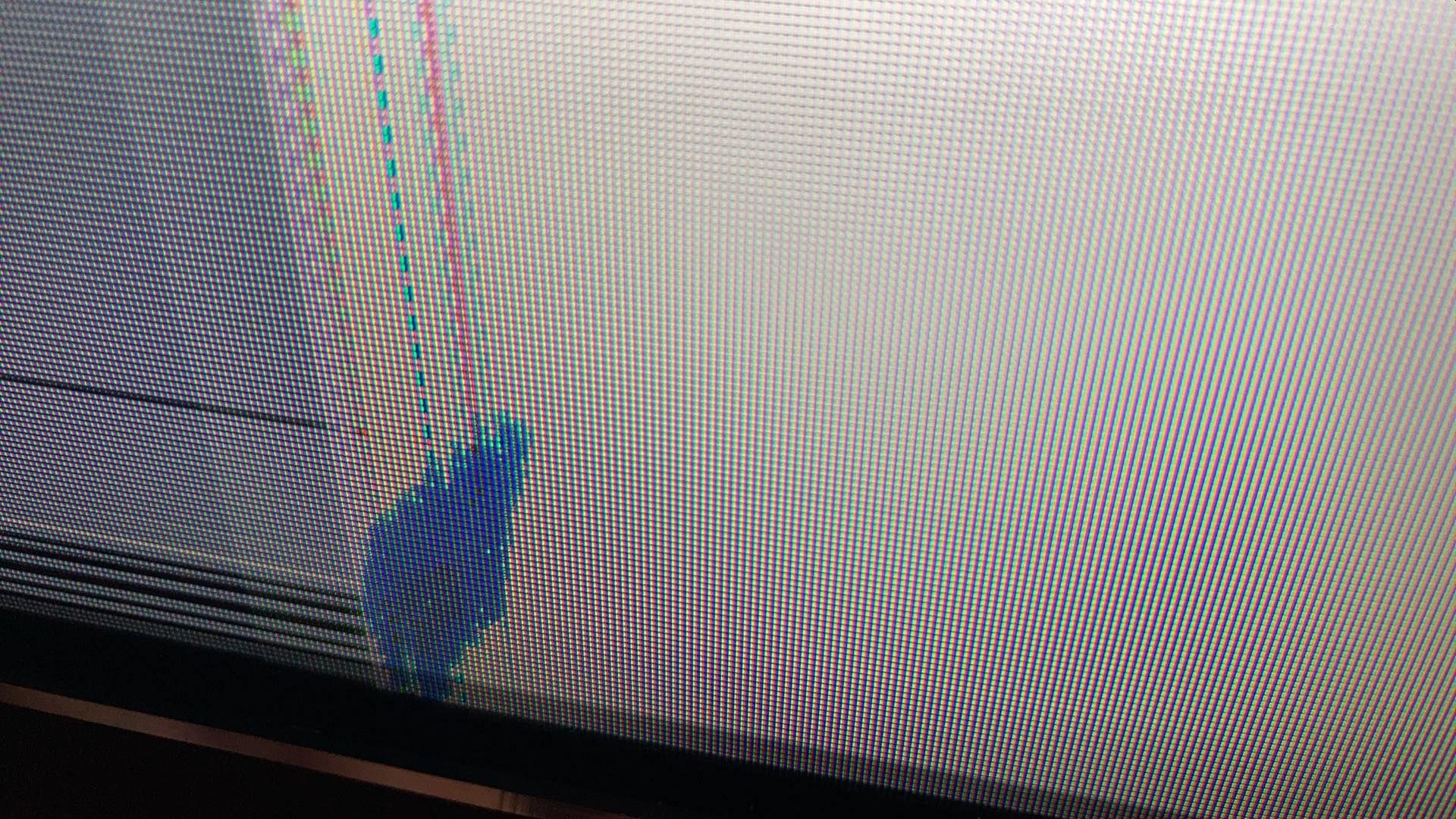

    update.
    got a close up photo of the mark in the middle bottom of the screen.
    Looks like panel damage to me. I have told him it is unfixable and only good for parts unfortunately
    I have included the photo. what do you think?

    Re: N75UX17A-AU T-COn board issue?
    Obvious panel damage.
