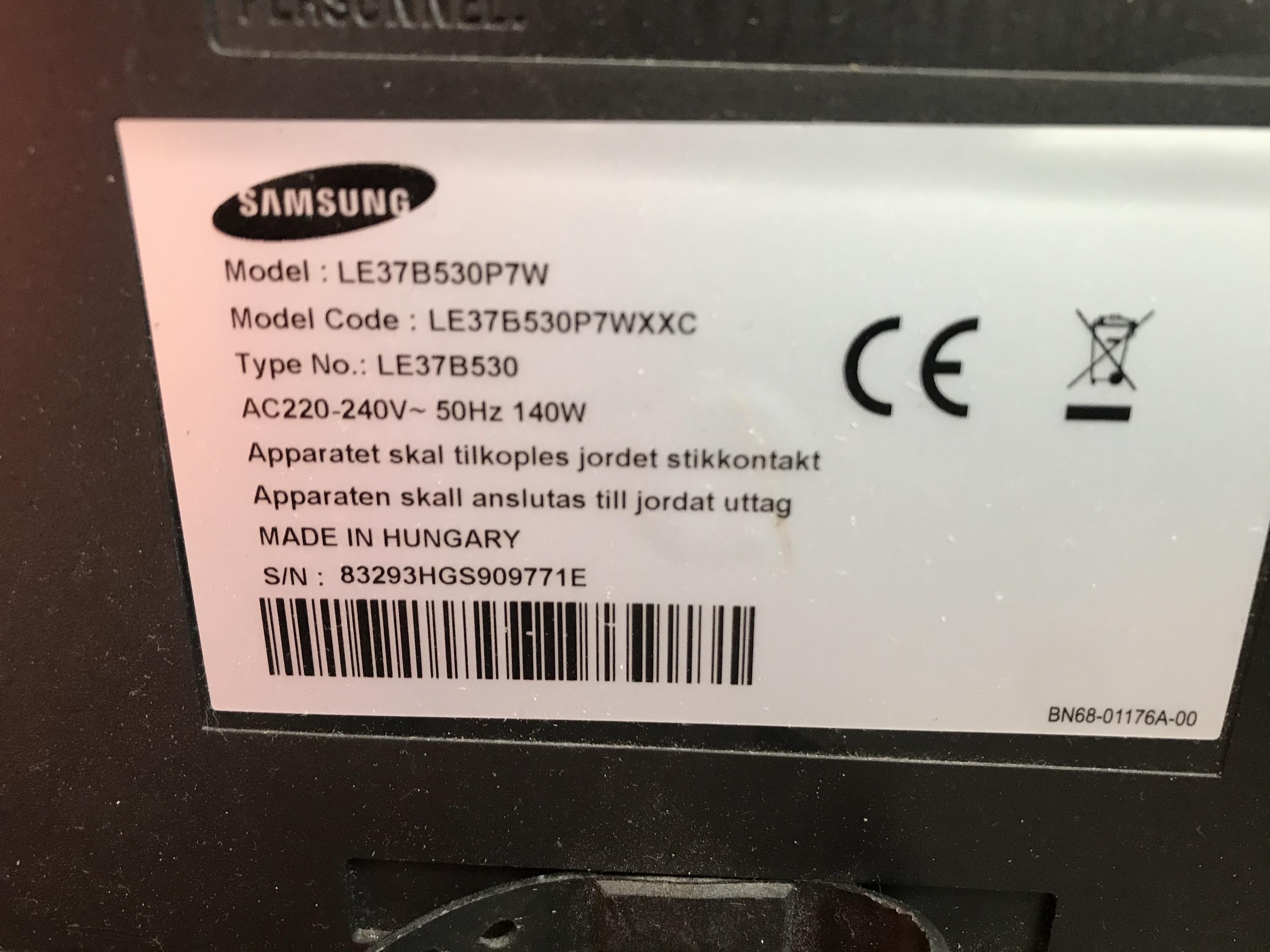

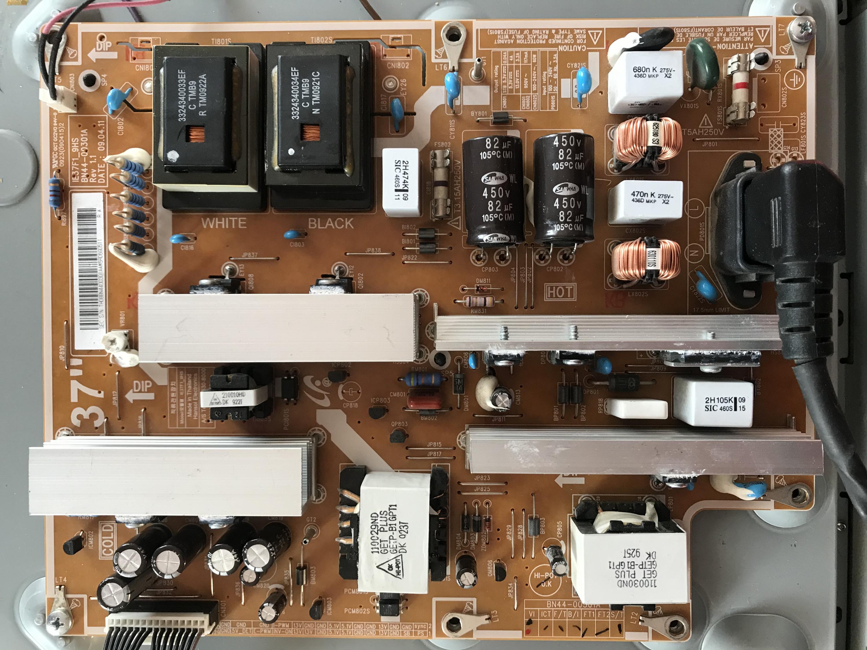

                        Hi, i posted a picture off power supply and the exact model
                          Re: LE37B530 Backlight Blinking

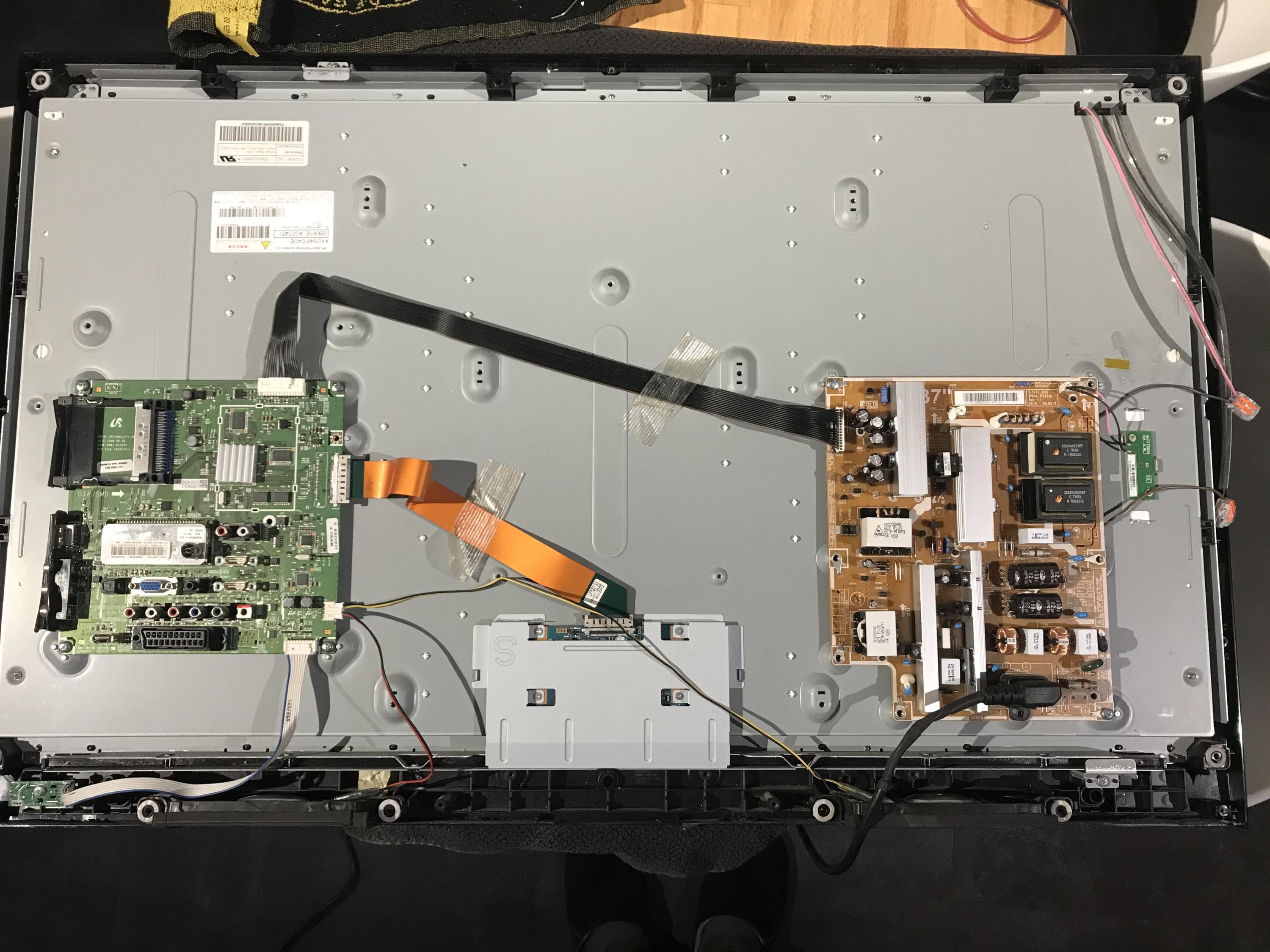

                          Can we see the whole backside of the TV showing all the boards?
                          • alepol
                            • Mar 2020
                            • 8
                            • france
                              Where are those two set of high Voltage wires (Pink and Black, Brown and Black) with connector go to, they are on the right side of your picture?
                              Any one work on this TV before you?
                              What happen to the two High Voltage connectors (CNI801/802) in the inverter section?
                              • alepol
                                • Mar 2020
                                • 8
                                • france
                                Yes of course i solded directy brown and black cable to the main bord and connector to the black and ping cable to the backlight, so i m sure the connection is good.
