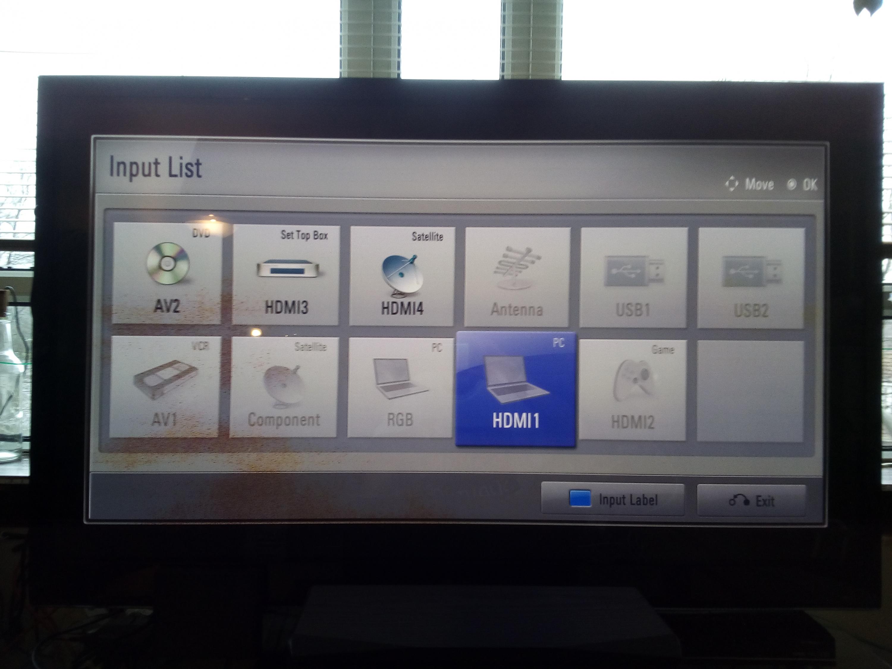

Common LG TV Issue - Antenna Grayed Out
  • Lydia
    • Oct 2019
    • 19
    • United Kingdom
    I have been trying to sort this one for ages - i finally removed the main board from the tv today 50LGPK590 and opened up the tuner and re-soldered the main coax connection input but still no joy.
    I was talking with a computer engineer at work and he tells me that a lot of LG plasmas have this problem and it might be due to the firmware and as it wont be updated there is nothing you can do?
    I find this quite interesting - how would the firmware which hasnt been updated suddenly stop the tv from detecting it has an aerial connected and gray out the Antenna option in the menu - is this something to do with freeview frequency changes?
    Thank you in advance

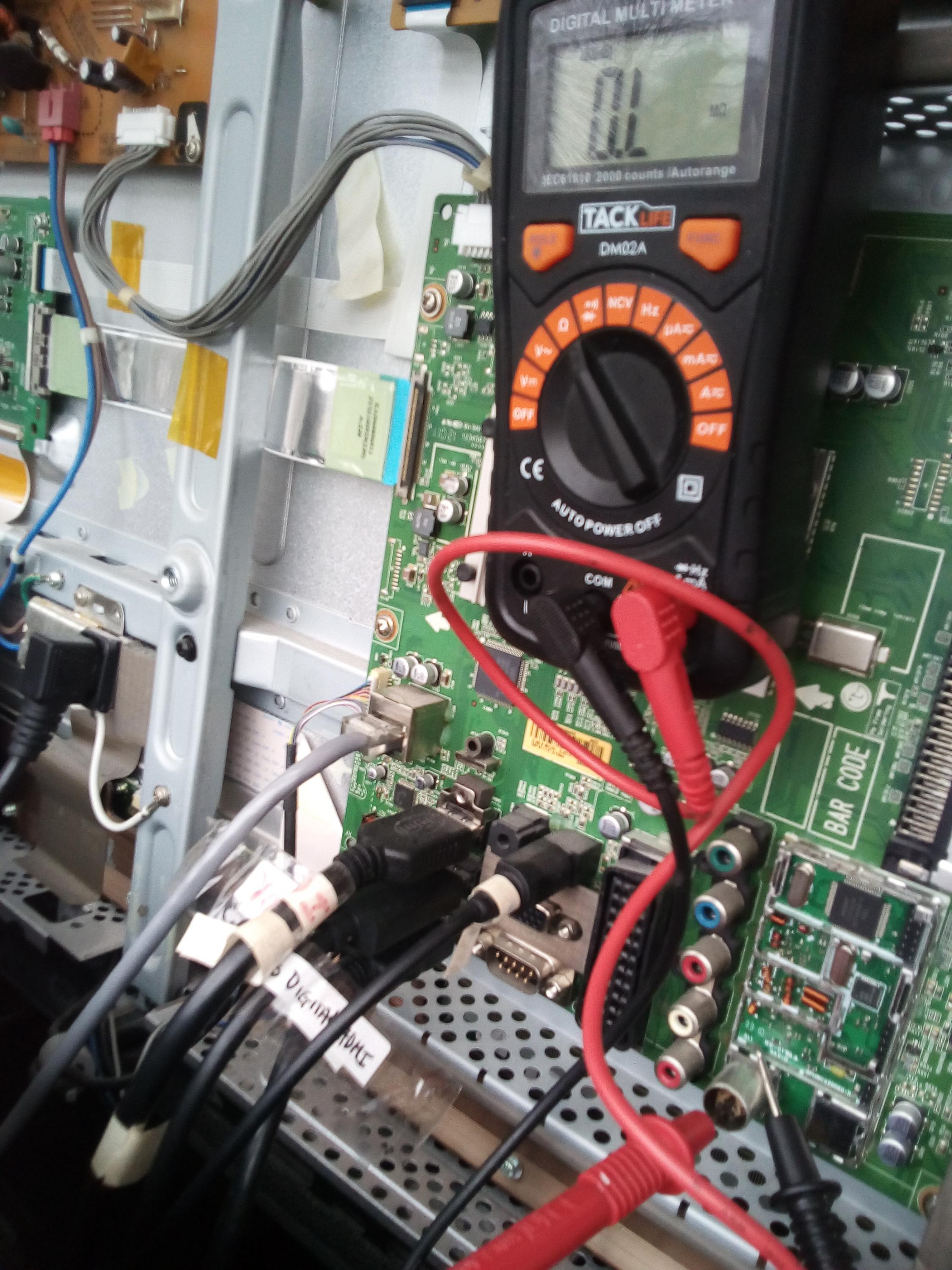

        OK... with the tv unplugged, get a meter and measure the resistance on the input connector (coax input).... what do you get?

          Or do you mean measure the resistance between centre core and outer can (earth) to check if its shorted?

            The r.f. input is going to check like a short because there is likely an input transformer. The problem could be in the service setup.
            When you say the "antenna" is greyed out do you mean the Dish icon under setup? or do you mean in the INPUT list?
            Could it be "blocked" as in external input blocking

              I don't know what it will read... you tell us what you get. "obvious issues" may show (totally open or otherwise). Further post a picture of the screen that show what you are referring to in the menu so we (who don't have / haven't seen your set) can understand what you are referring to. Potentially, show a screen just before that screen to provide the forum with a bit of the menu path.

                I rechecked a number of R.F. inputs and most checked shorted, except a newer Toshiba, Its R.F. input checked open (even on 20meg scale).
                This is between the center pin and outer threads.

                    Yes it is the input screen - Aerial icon greyed out and you cannot select it.
                    However you can go into the setup screen and do an auto tuning which ends up with a screen saying Not Programmed.

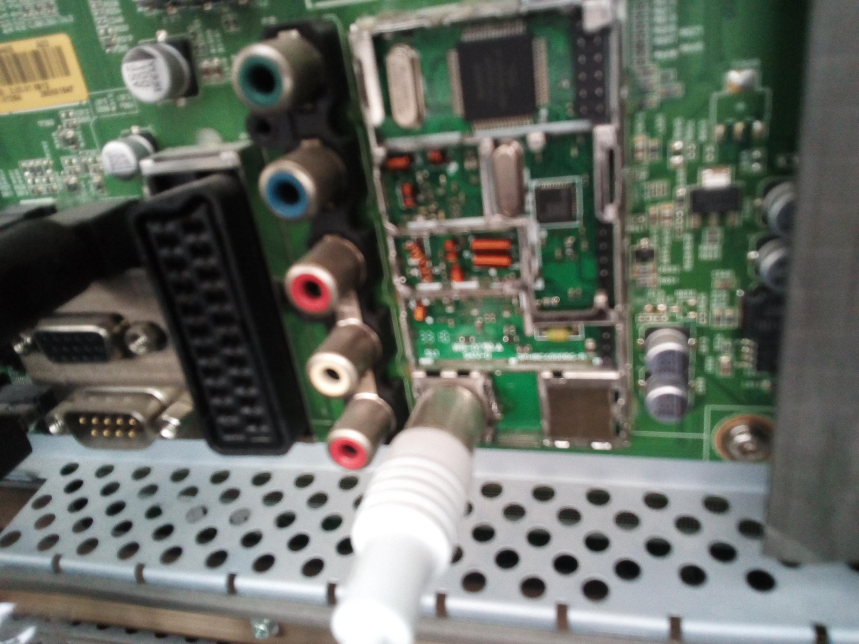

                    Checked the resistance its open - here are a few photos.
                    I already soldered the centre connector because I saw a really talented guy called MrReeceyburger123 on youtube fix his that way.
                    I have fixed the tv already perhaps i should add this - the power board failed requiring replacing the common resistor fault.
                    Then i got the red haze of doom so i bought a new Ysus board and that fixed it but it has started to go red haze again after a few months use on power up (you can actually see it on picture 3) but it usually disappears after a few minutes - tested all the caps on the ysus as i thought this might be the issue but they are all good.
                    I doubt any of that would cause this issue though!

                      So you had this problem before you soldered the center conductor? Did you remove the tuner module from the main board to do this?
                      Your first picture is too blurry to make out anything.
                      If the tuner can't find any channels during a scan, the "antenna" likely won't show up as an input.

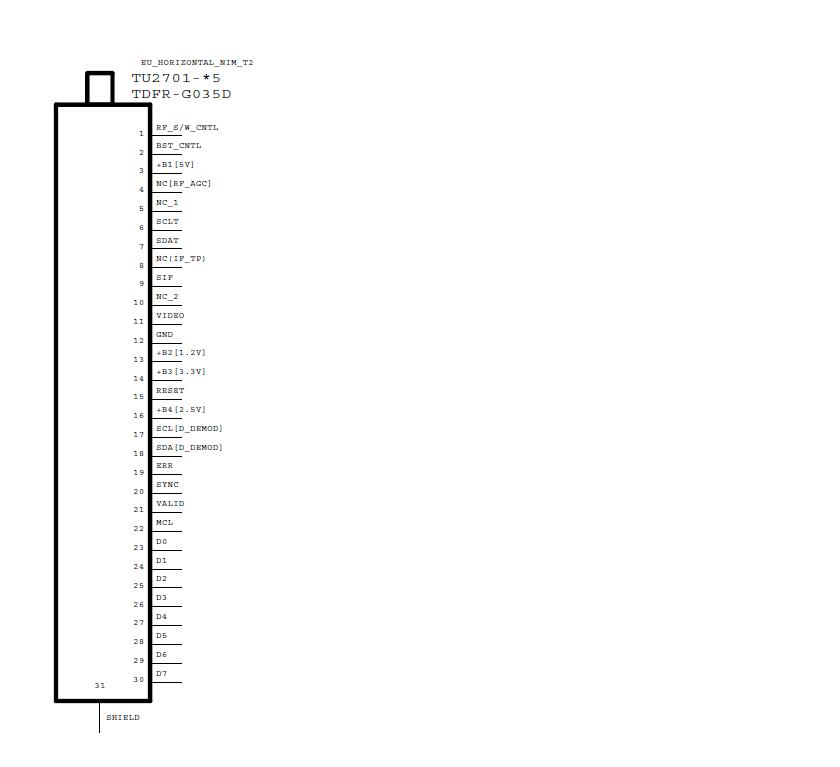

                      There might be voltage values marked for the tuner module pins on the board next to the module.
                      If this is the correct tuner number, this might help

                        It is likely that seeing the "open" on the coax input is NOT good. Look closely at the connector. See if you can locate the trace on the board that is connected to the center conductor of the connector. Place the probe as you have shown on the center conductor of the connector and the other at the trace.... you should see a "short" / continuity. Go from there. One note, you may need to use a coax cable (a known good one) to properly access the center conductor / pin as the connector connnection internally may not actually be available to your probe easily / readily and hence might be the reason that you are seeing the open (ie. poor access).

                          The tuner module is not removeable it is hard soldered to the board i did take the rf protection metal top off though to see if there were any tell tale burn or damage signs

                            my "explanation" wasn't very good. Basically, as part of electrical testing, you try to confirm as much about the electrical path as you can (especially with out an available schematic to follow). Your initial test only tells you that there is NO path between the center conductor to the "sheath" pin that you touched with the other probe. BUT that is trying to test the "entire path" all the way back to the tuner and "back again" to the sheath. However, you don't actually know that your probe is contacting the middle of the connector properly. You can check this by doing the same test as you did but instead touch the other probe to the exposed pin. This will tell you if you have a connection from the center pin of the connector (where the coax cable goes in) to the exposed / soldered external pin. Go from there. Further you can do your same test "looking" towards the tuner by putting the probe on the external pin (that is supposed to be the center) and the other one you used for the shealth / ground. This measurement should "see" what is in the board / tuner and should measure something.
