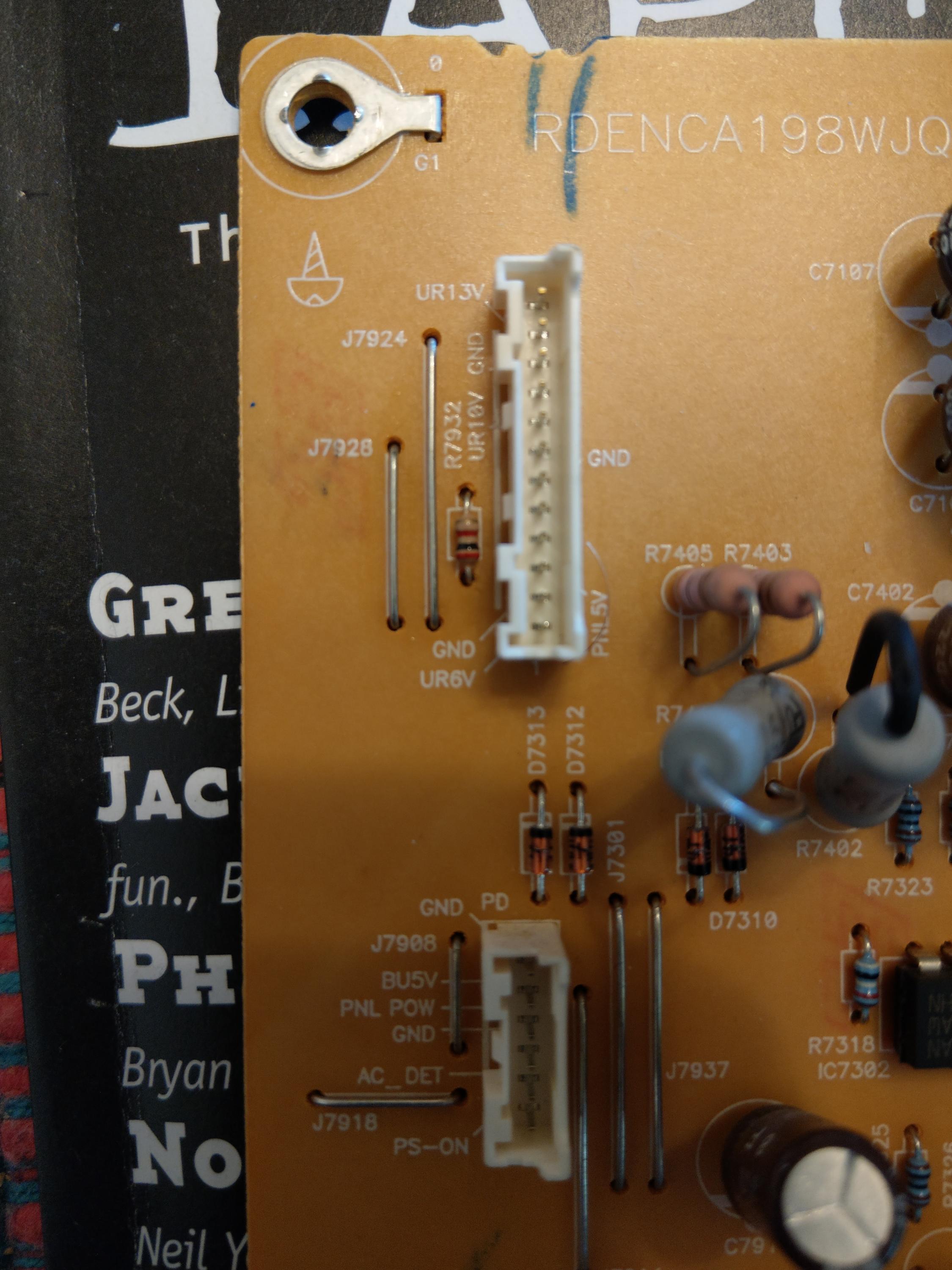

    sharp lc32d42u power supply - DPS-178APA
    last 2 times I had an issue with this supply, it was a 5wt zener in the stand by circuit.
    That zener tests good and the 5vt stand by (bu) supply tests good.
    Any idea what I could check next?
    It's a cheap enough supply on the "pulled" market place, but I might just be inheriting someone elses future problem.
    https://flic.kr/s/aHsmKXfqpn

      Re: sharp lc32d42u power supply - DPS-178APA
      that is a link to snaps of the plugs in case res isn't high enough.
      the 2nd pic with 2 plugs; plugs are shown out just so I could get a clear pic. The plugs were in when tested.
      bottom plug of 2nd pict.
      Pin3 to ground stayed at 0v off and on.
      Pin2 stayed at 5v off and on.
      the 1st pic is the only other plug on the powerboard.
      Thanks for your help, nomoresonys.
          lemme clarify
          top to bottom
          p1 - gnd
          p2 - bu5v
          p3 - pnl power
          p4 - gnd
          p5 - AC detect
          p6 - PS on
          I'll go back and check the others.

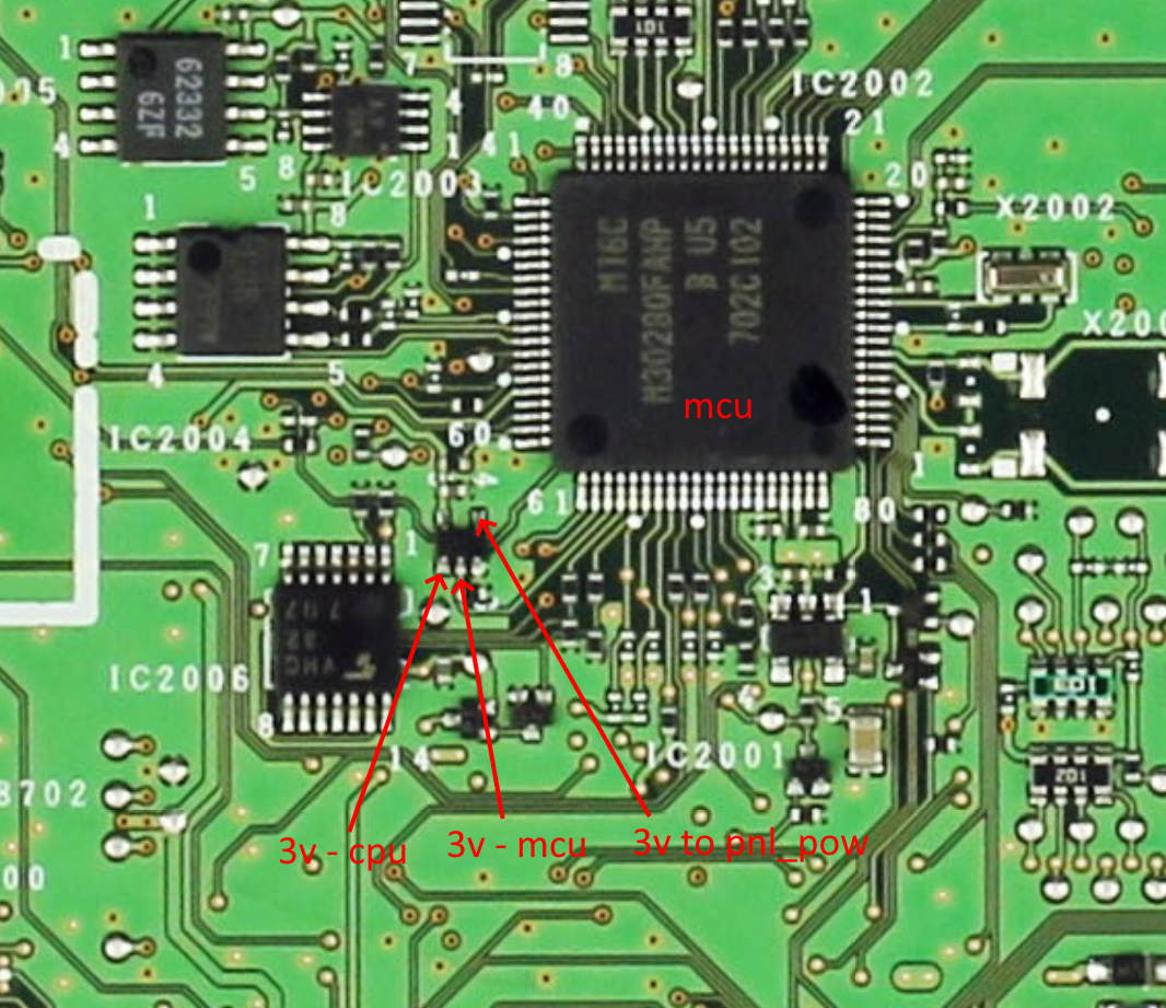

                  • will62
                    • Dec 2016
                    • 229
                    • usa
                    The pnl_pow voltage comes from IC2007 (AND gate). It requires ~3v from both the cpu and mcu to send the pnl_pow voltage. See pages 72 and 102 in the SM.

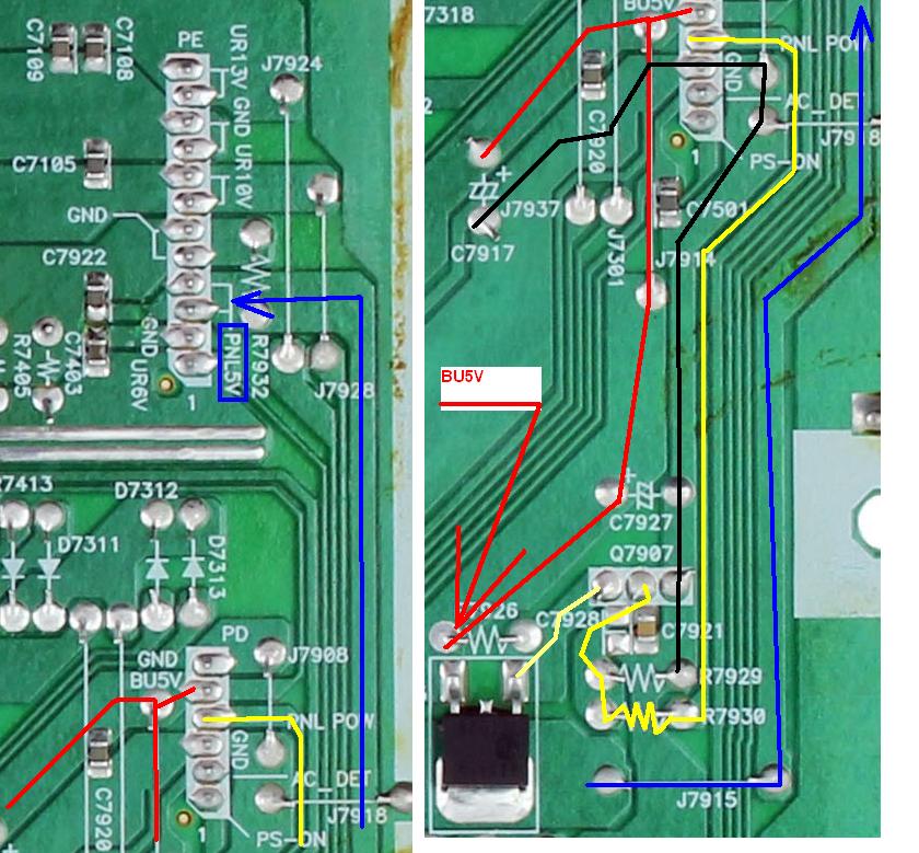

                      Originally posted by metropical
                      I think that P4 PNL_POW is a return voltage, not a source from the PS.
                      But what am I looking for and where.?
                      My time with board level stuff was on recording studio gear 30 years ago.
                      Not so familiar with this.
                      PNL_POW is the "control voltage for the panel 5v" All it does is switch the PNL5V ON or OFF that's it, nothing else
                      A high or low logic (3.3v - 0v) on the PNL_POW pin turns Q7907 on or off which tells Q7905 to connect the BU5V to the PNL5V
                      You have confirmed that PNL_POW is changing from 3.3v to 0v, all you need to do is check plug PE pins 3or4 (or use J7915) PNL5V and see if it changes from 0 to 5v when PNL_POW changes.

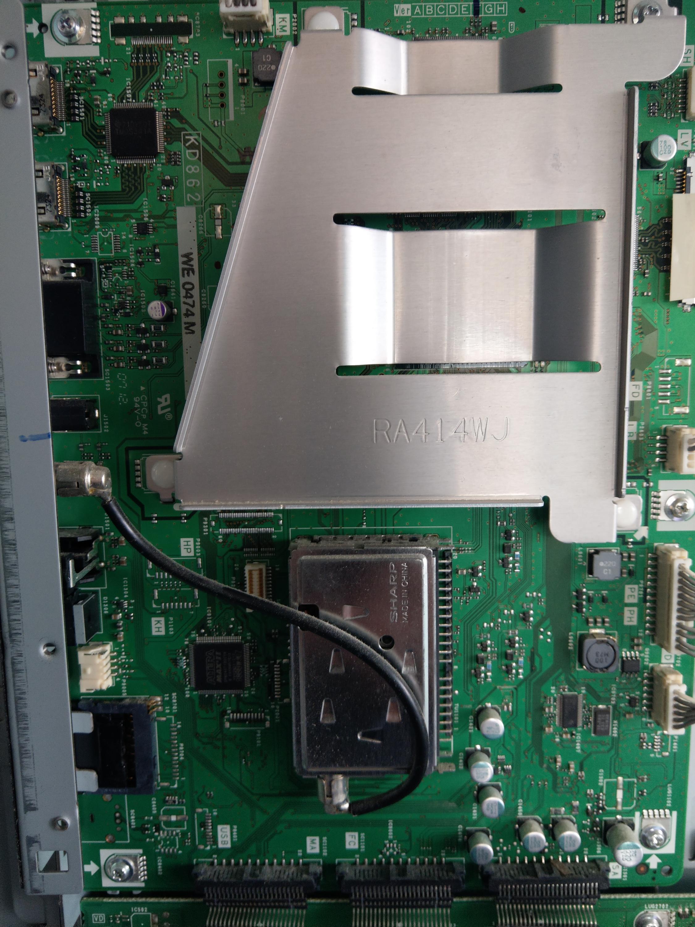

                      • metropical
                        • Jan 2017
                        • 42
                        I know this is odd, but I think I may have a different board. I don't see IC2007 on the actual board, despite what the SM shows.
                        Unless it under this heat sink, pic attached.
                        But still, when I swapped the PS, the tv worked.
                        So I don't understand why I'd be looking outside the PS.

                                    • R_J
                                      • Jun 2012
                                      • 9549
                                      yes, Pin 4 on plug PD. aka PNL_POW 3.3v. I have 0v on this supply.
                                      That is because it is NOT A SUPPLY, please re-read post 11
                                      Here: Red is the BU5V volts, Blue is the panel power 5 VOLT OUTPUT, Yellow is the PNL_POW Control line.
