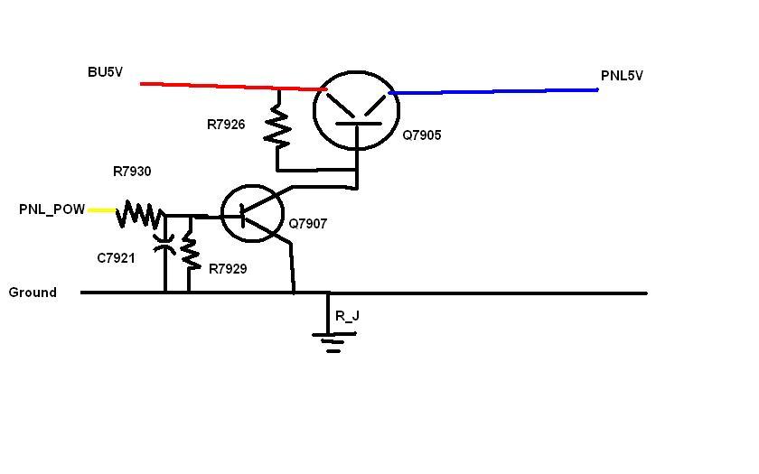

              Do you have UR13v PE, pins 11,12 and UR10v 8,7 ?
              If the PNL_POW signal is being killed, there are only 2 components that will do that, either C7921 or Q7907 are shorted to ground
              Best I can do with paint, but this is the circuit

                I have UR13v PE, pins 11,12 showing 12v.
                UR10v pins 8,7 is good.
                Funny, my SM doesn't even list Q7907 or C7921. But I did find Q7907 on the PCB.
                Ah, I see, my book doesn't have the PS parts list .... near as I can tell
                Can it be checked in circuit or only lifted?

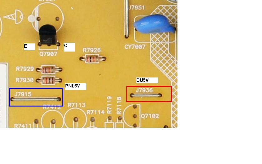

                  Re: sharp lc32d42u power supply - DPS-178APA
                  The service manual does not have the power supply schematic.
                  Even If you don't have the panel 5 volts, the tv should work, you just won't have an image because all that would be missing is the +5 volts for the tcon and the panel. (SM page 49)
                  Post #19 has pictures of this part of the circuit board
                  Since you have BU5V, UR13 & UR10V I would say your power supply board is working properly.

                    #29
                    Thanks very. R_J.
                    I do hear noise from the speakers.
                    So change out both C7921 & Q7907? If I can find C7921.
                    Is it a small or large cap?

                      #30
                      Originally posted by metropical
                      Thanks very. R_J.
                      All you need to do is lift one end of R7930, If THEN the voltage on PD,pin4 comes up, you might have a shorted component but I doubt that is the issue.
                          I see now that C7921 is a surface mount on the under side of the board.

                            Even if the cap was shorted, the voltage drop across R7930 should not totaly kill the 3.3volt pnl pow control signal
                                        I'll have to find me some better gator clips. It's pretty tiny on that Q.
                                        But, unplug PE on the power supply and with the tv on, check the voltage on J7915. It is 0 volts.
                                          Use a piece of wire to connect the emitter to collector, There is only about 5 volts at those points, or take a piece of wire from ground to the Q7907 collector, that will also turn on Q7926
