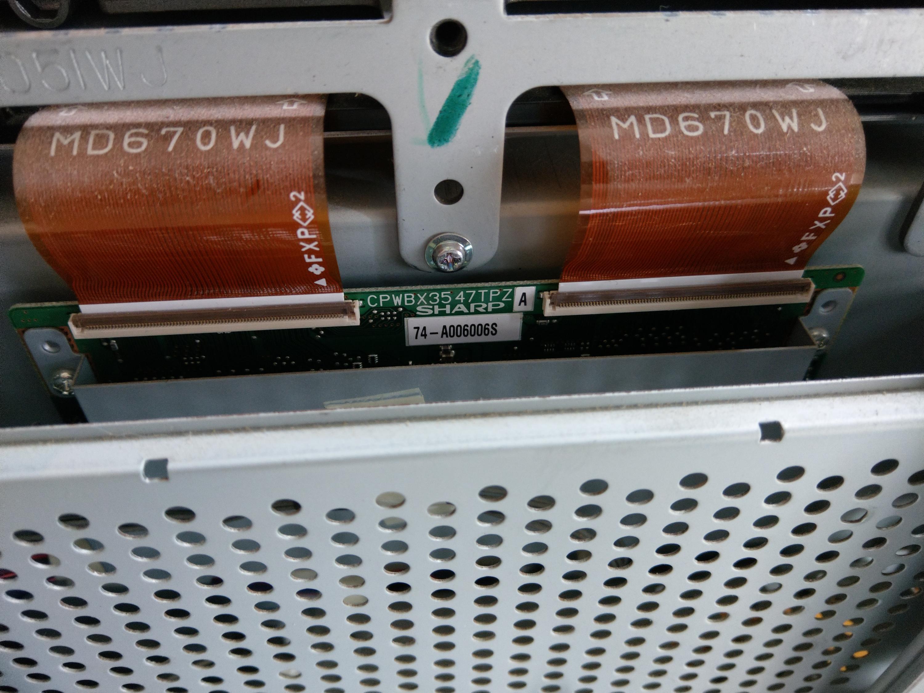

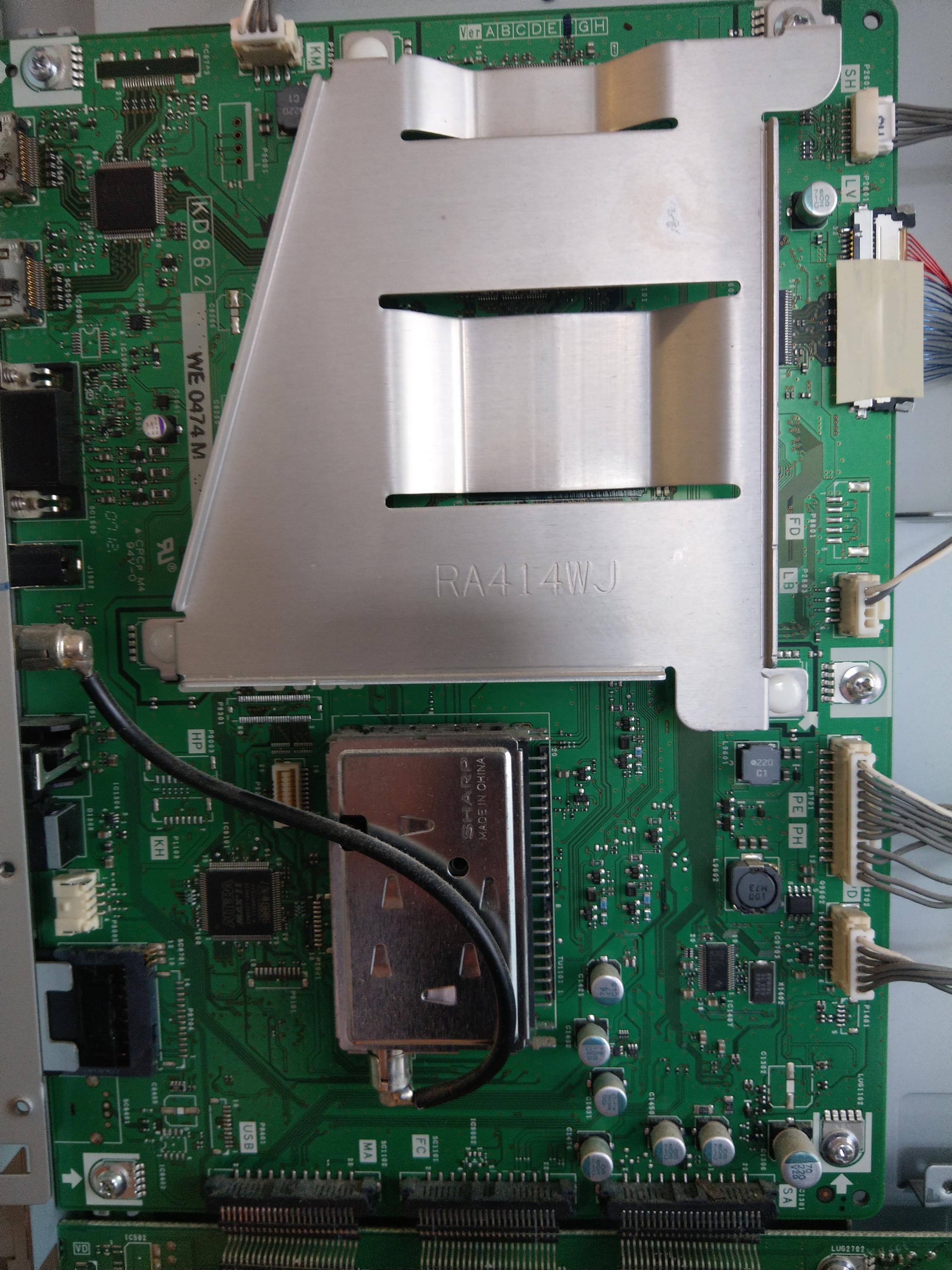

      • metropical
        • Jan 2017
        • 42
        #43
        Re: sharp lc32d42u power supply - DPS-178APA
        which is the LDVS cable? The 2 ribbons at the top of the board or those at the bottom behind the cage.?
        Also, not familiar with those connectors. How do they separate?
        • R_J
          • Jun 2012
          • 9624
          #44
          The lvds cable is the one between the main board and the t-con board, it must be behind shield, It is the wide 30 pin, You can also just unplug it from the main board.
          • metropical
            • Jan 2017
            • 42
            #45
            both sides behind the cage.
            Ov.

              • R_J
                • Jun 2012
                • 9624
                #47
                Ov.
                Remove the shield to gain access to the t-con board.

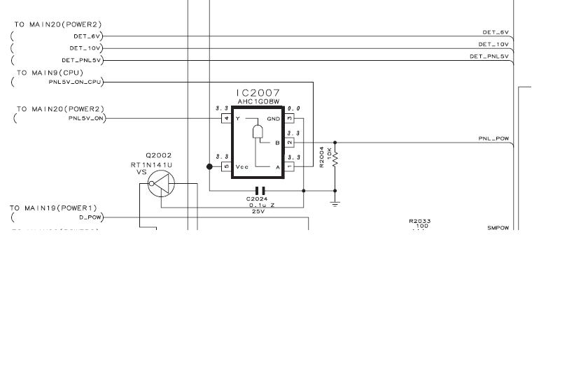

                  • R_J
                    • Jun 2012
                    • 9624
                    #49
                    zero volts on J7915 with plug PE restored and the lvds unplugged.
                    That eliminates the t-con/panel, killing the voltage. Look for IC2007 on the main board, this is the ic that controls the PNL5V_ON, I was going to say post the voltages of the 5 pins, but it seems to be a bga chip.
                    So check the voltage on R2004 and C2024

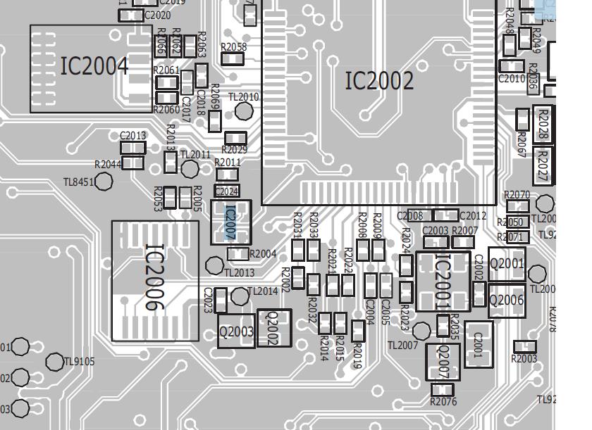

                    • metropical
                      • Jan 2017
                      • 42
                      #50
                      IC2007, R2004 and C2024 seem to be on the B-side (trace).
                      Are there test points on top I can access?
                      • R_J
                        • Jun 2012
                        • 9624
                        #51
                        If you look at the service manual, it has board views, you would need to follow the trace and see where it appears on the other side.
                        • metropical
                          • Jan 2017
                          • 42
                          #52
                          trying to figure out the location.
                          Is there any indication in the SM pcb drawings that would indicate this heat sink. The ref point might help localize the chip.
                          Or remove it that I might have a look at whats hidden.
                          • R_J
                            • Jun 2012
                            • 9624
                            #53
                            IC2007 pin1 is the PNL5V_ON_CPU and connects to [Y23] under the CPU.
                            IC2007 pin2 is the PNL_POW and connects to pin 63 of IC2002
                            Pins 1 AND 2 need to be high (3.3v) to get the PNL5V_ON (IC2007 pin4) to be high which turns on the panel power on the power supply.
                            Since the pins are hard to access I don't know how to check their voltages.
