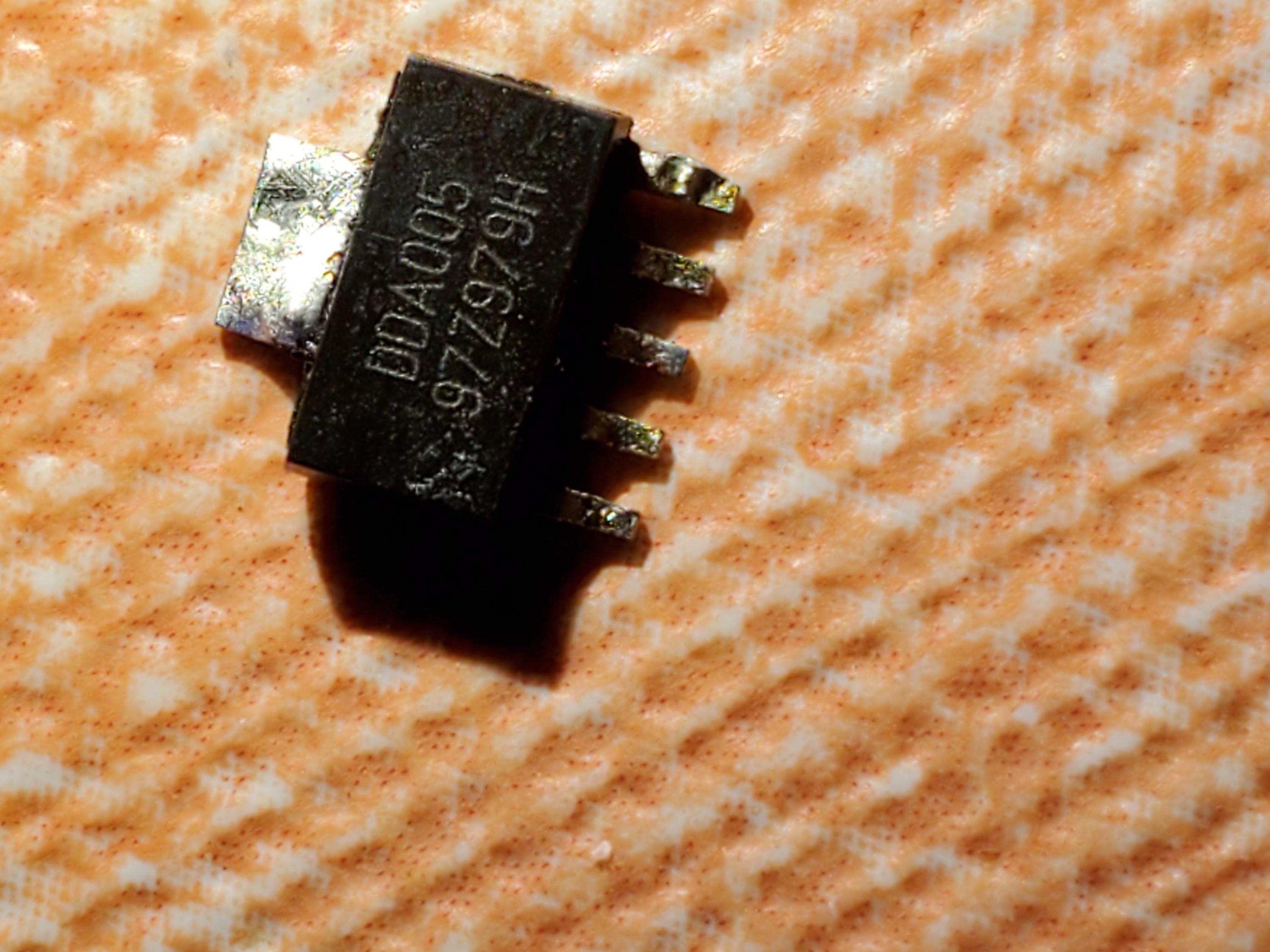

            I try to buy the regulator. I couldn't find this ic. I have attached the picture.
            • R_J
              • Jun 2012
              • 9535
              #146
              Re: when i turn on, Philliips TV is not on
              You can order them from China. They seem to be a custom part number but are likely made by Texas Instruments, and might be a TPS7A4501DCQR or TL1963ADCQR I have not tried any of these substitutes.

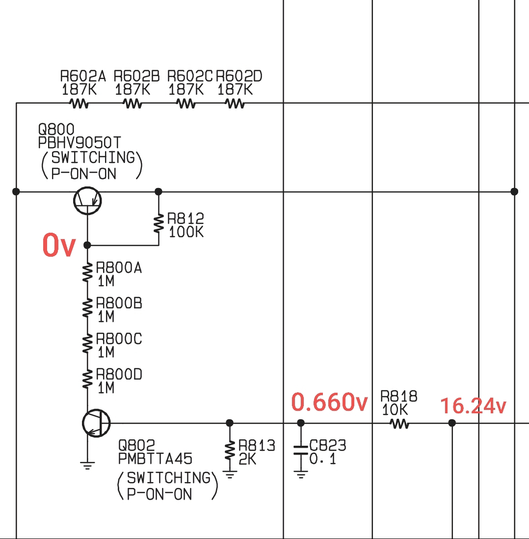

                    #149
                    IC801 pin12 = 16.18v
                    IC601 pin12 = 16.24v
                    Q802 =0.659v
                    Q800 = 0v
                    I will replace R818 and see
                    • R_J
                      • Jun 2012
                      • 9535
                      #150
                      What is the point of replacing R818? Why do you think they have the regulator ic in this circuit?

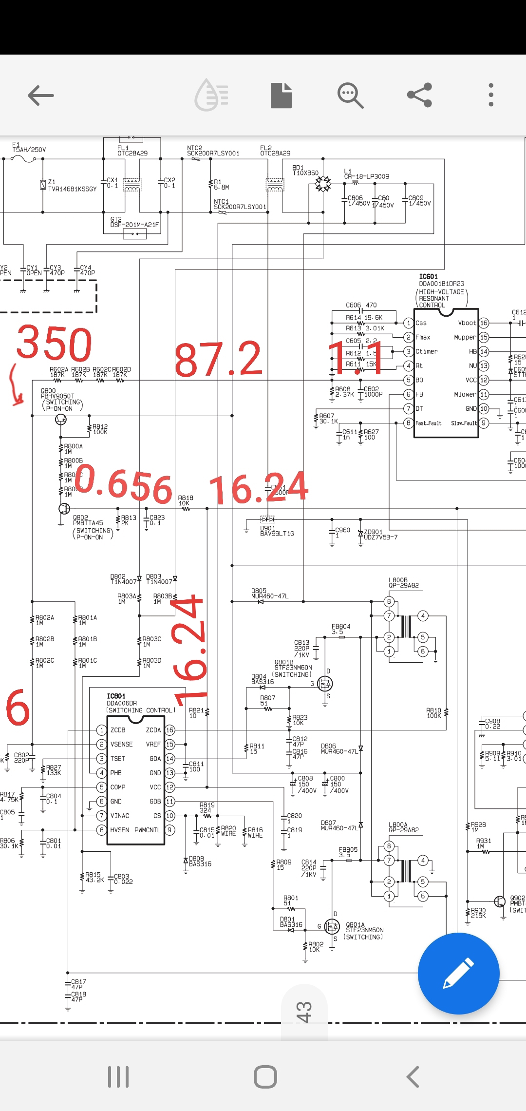

                                      No I do not have PANEL+24V and P-ON+12V at the connector.
                                      I have attached the picture of voltage now.

                                          #160
                                          The only voltage that points to a line is the 350v, That tells be that the pfc circuit and IC801 is working. The 16.24 seems to be the vcc supply, so that is correct. Is the 1.1 volts for pin 4 or pin5 of IC601?
                                          I have no idea where you measured the 87.2
                                          Looks like the IC601 circuit is not working, check the resistance of R618(15Ω), R617(51Ω) and R620(51Ω) and [R52 1](15Ω) If they are ok. Check the voltage on pins 11,14 & 15, Also is there any voltage on D601 cathode?
                                          I looked closer at the connections on T601, The connections on pins 1 & 2 don't look that good, Remove the old solder, clean up the trace and rivet and resolder them
