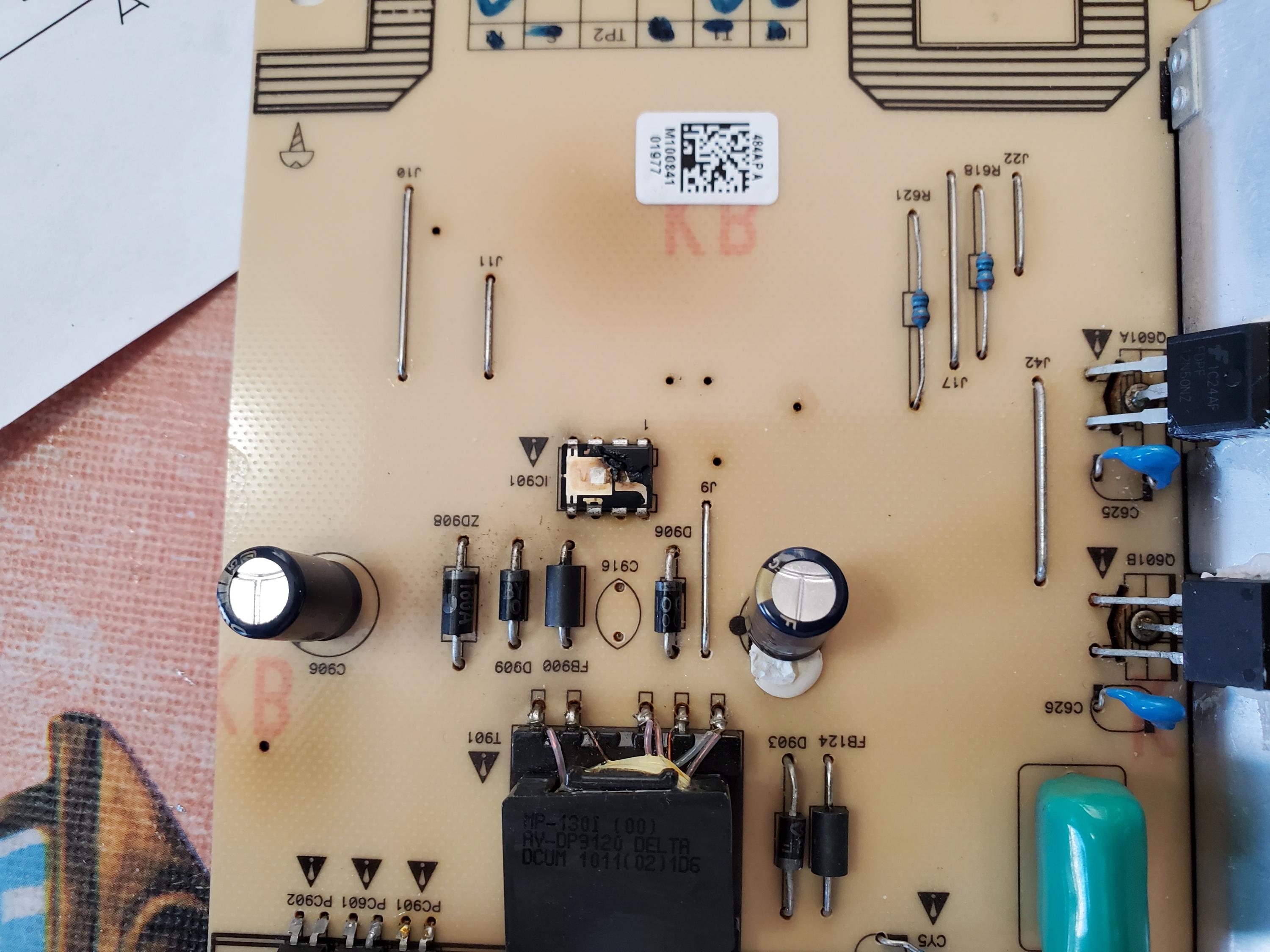

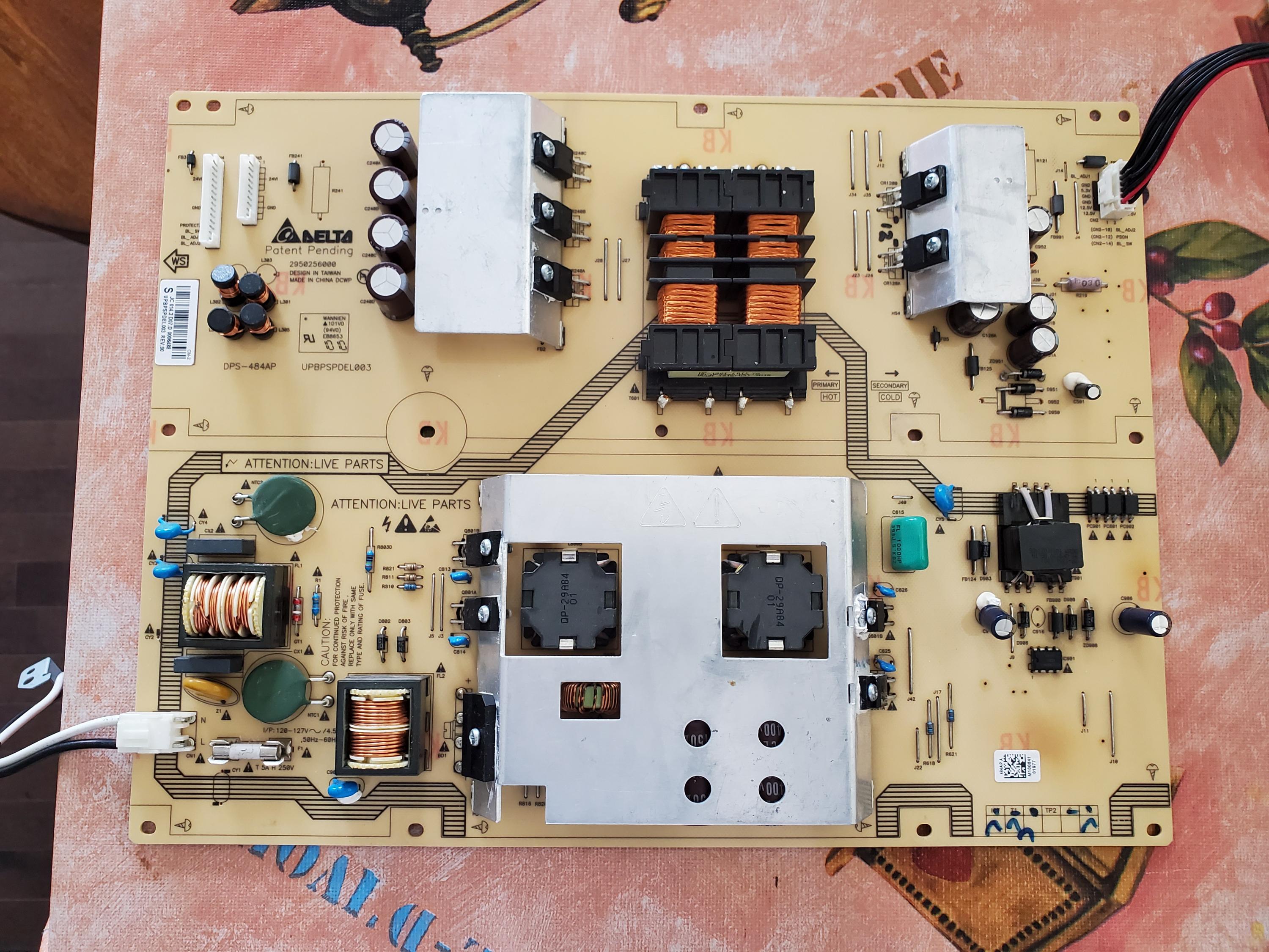

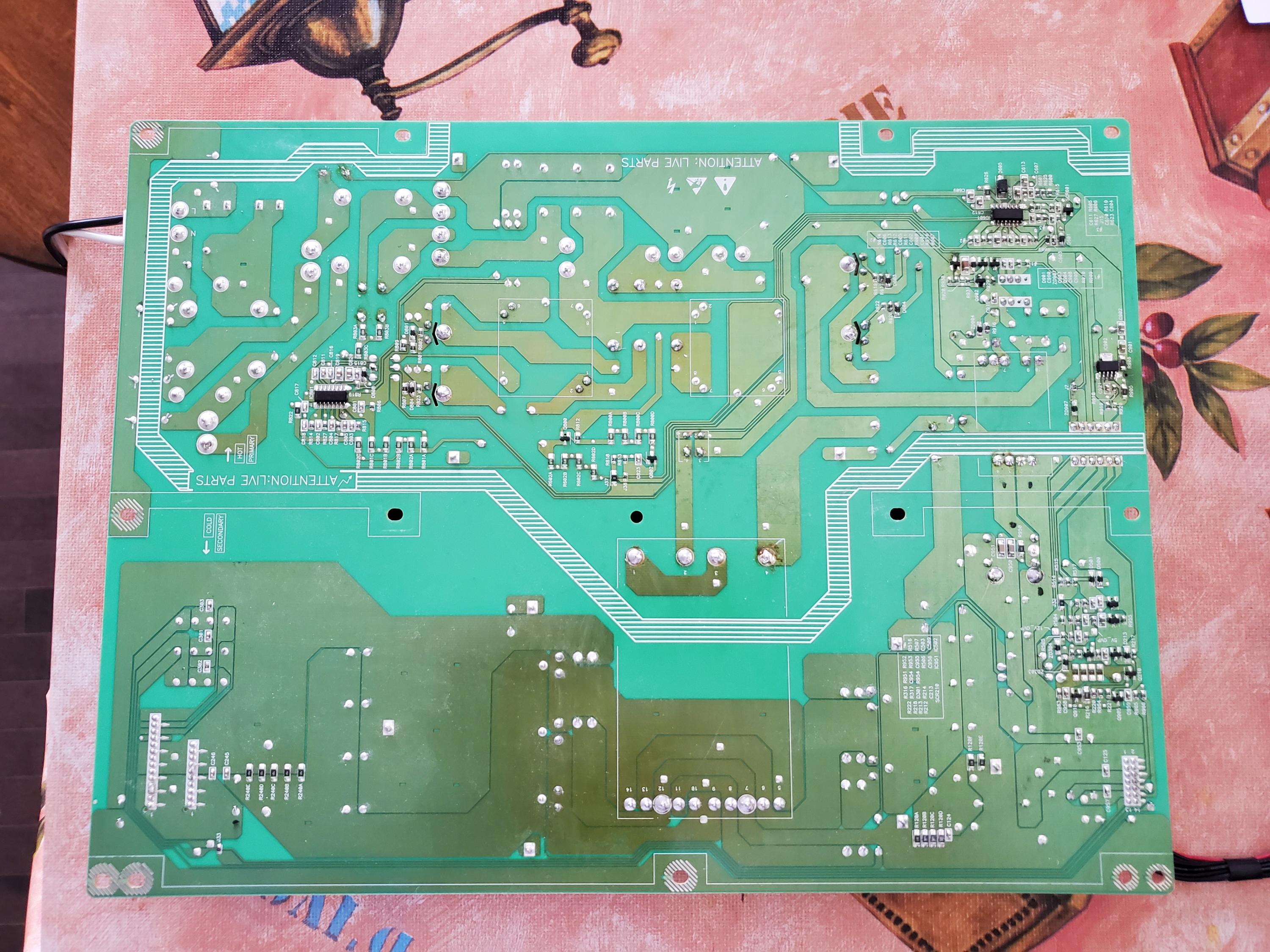

    Hi all, my TV is Phillips 55PFL5505D/F7. when i powered up nothing happened. standby light not on. I opened the cover and try to measure voltage. I do not have 5Vdc, 3.3v at the connector 2.
    IC902 (I replaced new one still same voltage)
    pin1 --> 0.025v
    pin2 --> 0.485v
    pin3 --> 0v
    pin4 --> 0v
    pin5 --> 0v
    IC901 (I replaced new one still same voltage)
    pin1 --> 0v to 1.2v (changing, not stable)
    pin2 --> 4.96v
    pin3 --> 0v
    pin4 --> 169.7v
    pin5 -->169.7v
    pin6 -->0v
    pin7 -->10v to 16v (changing, not stable,) {when i remove the C912, it become stable 13V, i replace new cap and still changing)
    pin8 -->0v

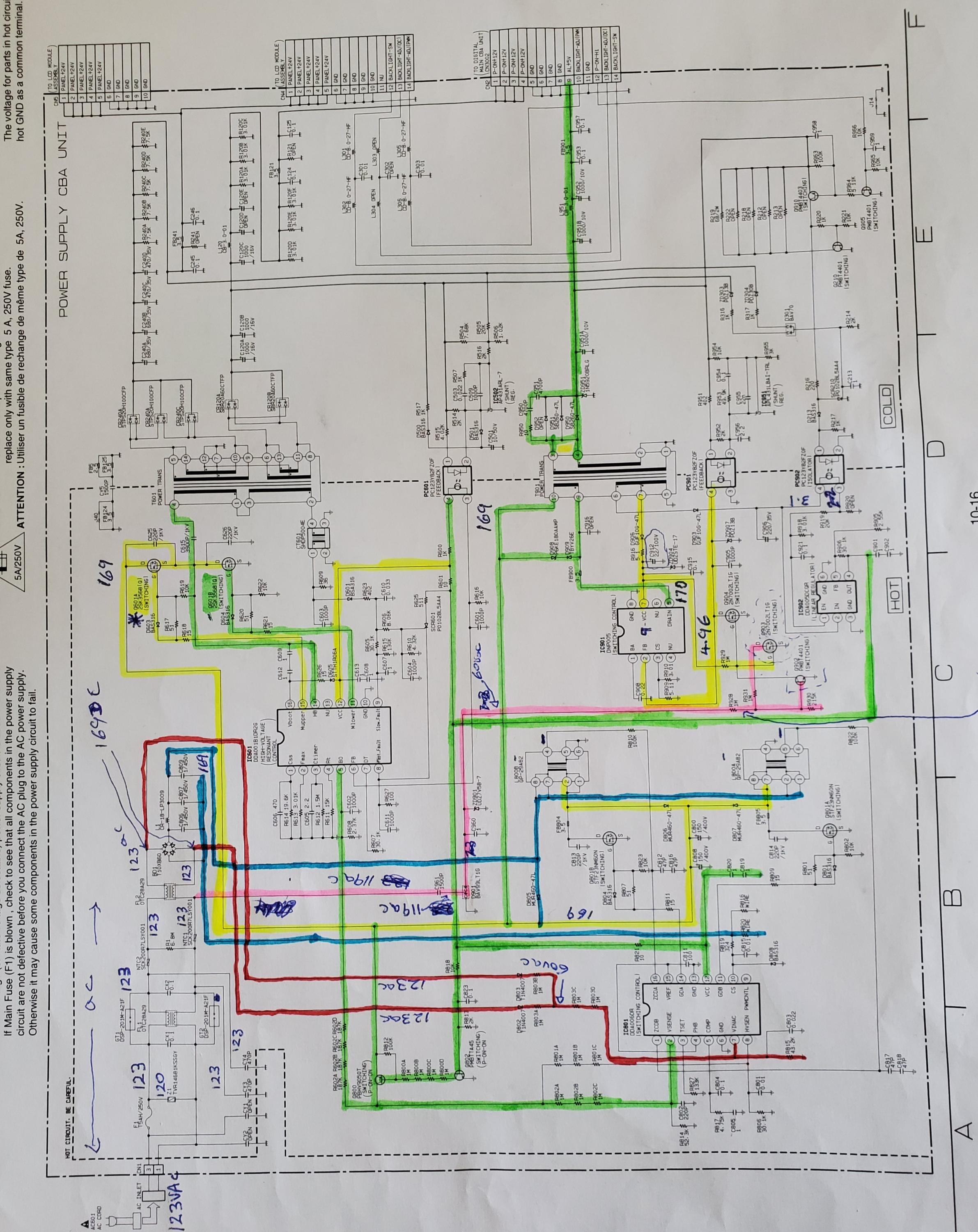

        On ic901, pin 7 (vcc) is changing because the ic is trying to start but is being shut down. It will only rise to 17 volts due to the zener diode ZD904.
        Do you get any voltage at all on C951a ? If it is 0 volts, check the diodes D950~952 and also ZD951, it could be shorted killing the 5 volts.
        I see there is also 3.1 volts on D903/C906, this also indicates the secondary's are trying to produce some voltage.
        so you should see some voltage on C951a
        If the original ic was bad, check the two resistors R909,R910 off pin3,

                    Thank you neilc6, R_J and digitalpc for helping me to solve my problem.
                    I have replaced D951, D950, ZD951 and the the IC901 since I blown up.
                    As per digitalpc I applied and I found C952 gets hot. I have replaced it.
                    Now the voltage at the IC901
                    Before solder all pin
                    Pin1--ใ€‹0v
                    Pin2--ใ€‹3.969
                    Pin3--ใ€‹0.741
                    Pin4--ใ€‹168.5
                    Pin5--ใ€‹168 (soldered)
                    Pin6--ใ€‹0
                    Pin7--ใ€‹8.75
                    Pin8--ใ€‹0 (soldered)
                    After soldered all pin
                    Pin1--ใ€‹0v
                    Pin2--ใ€‹2.86
                    Pin3--ใ€‹0.741
                    Pin4--ใ€‹166.5
                    Pin5--ใ€‹166
                    Pin6--ใ€‹0
                    Pin7--ใ€‹14.94 (now stable)
                    Pin8--ใ€‹0
                    C951a = 0.120v
                    I don't have 3.1v now
                    • R_J
                      • Jun 2012
                      • 9535
                      Re: when i turn on, Philliips TV is not on
                      Then the ic is not operating, When you blew up the ic you must have damaged more components.
                      Check R909/R910, D906, R916, ZD904 Check the transformer winding between pins 5,6 & 7, (should not be open)
                      Did you replace ic901 with a DNP005? where did you get it?

                                      • R_J
                                        • Jun 2012
                                        • 9535
                                        Why are you looking at that circuit? you need to fix the standby circuit first. Look at the schematic...there are two resistors across D604 and D603... R617 (51ฮฉ) and R620 (51ฮฉ)
