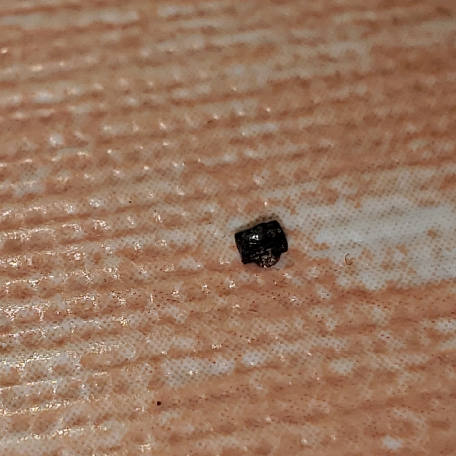

        I think it's broken. I cannot see any other mark on it.

              When I lift the zener diode and I have 6.4v at C951A

                So this ZD904 zener WAS bad, Check what voltage you have across C912.
                Also while you are at it, check the voltage across C906
                C951A has ZD951, a 6.2 volt zener across it.

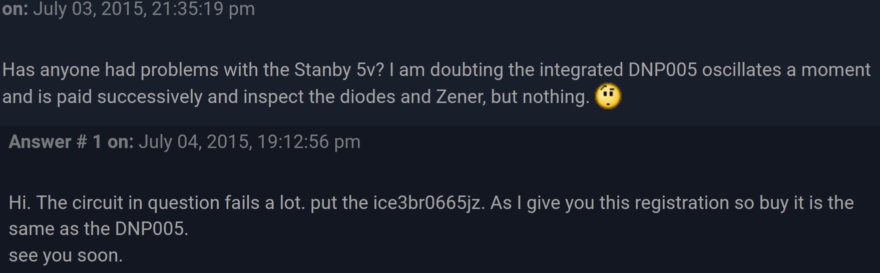

                  On another site, someone was commenting on the high failure rate of the DNP005, and recommended that it be replaced with a ICE3BR0665JZ. That ic has a VCC range of 10.5-25v.
                  • R_J
                    • Jun 2012
                    • 9535
                    #109
                    Re: when i turn on, Philliips TV is not on
                    I doubt they fail any more frequent than any other standby pwm, the infineon icexxx fail often as well.
                    But did they actually install this ic in the board and check that it worked properly? Did anyone confirm that the DNP005 operates at 65khz vs 100khz?
                    Most of the Infineon icexbrxxx ic's have a max vcc of around 25v thats why I suggested the 20v zener.

                      #110
                      That, I don't know. The one asking about the DNP005, did not come back and say there was a problem. It was a pretty rough translation from Spanish, but understandable. BTW, not recommending that the OP go away from the DNP005, just adding that it may have a max VCC of 25v. As you said, a 20v zener is probably OK.
