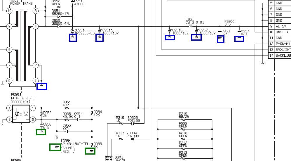

              #126
              Re: when i turn on, Philliips TV is not on
              Originally posted by Nish
              IC951 all 3 pin has 6.60v. But cathode is GND.
              I check both end of cap is 6.60v
              Using ground of C951A
              Install a TEMPORARY jumper wire in J14, as the power supply board does NOT connect the negative side of C951A/B to the negative of IC951. WITHOUT this connection, the power supply standby 5 volts has no reference.
              I suspect that the two points only get connected whn the main board is connected, something only Philips would do.
              The grounds I marked in Blue, DO NOT connect to the grounds I marked in Green, this is why the supply has no reference and why the output is too high. Installing the J14 jumper should result in a stable +5 volts.

                #127
                Originally posted by R_J
                You needed to replace PC901 NOT pc902 I only suggested exchanging them if you did not HAVE ONE.
                Sorry I miss type. I replaced PC901. By the way I will replace c954. But value is 0.1, is that uF or nF?

                          #132
                          I install jumper at J14. The C951A ground and IC951 ground are connected together. Now I have IC901 cathode is 6.60v and ref is 1.4v. PC901 still pin 1 and 2 are 6.20v.
                          I checked around IC951
                          R955 = 1.4v
                          C955 = 1.4v (which is connected to ref of IC901)
                          C954 = 1.4v (which is connected to ref of IC901)
                          ZD907 = -5v

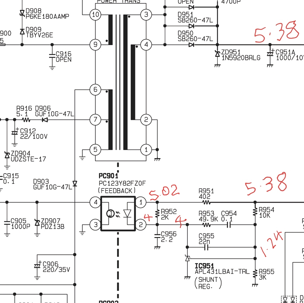

                                      I have replaced R954. Now the voltage attached images.
                                      Across ZD907 = -3.0v
                                      Across C906 = 16.20 solid
                                      Across C912 = 11.21 solid
                                      Across C951A =5.38

                                        #139
                                        That looks like it is working ok. Now check the voltage across C906 to see what it reads. To turn on the rest of the power supply you would need to connect P-ON-N1 to AL+5V
