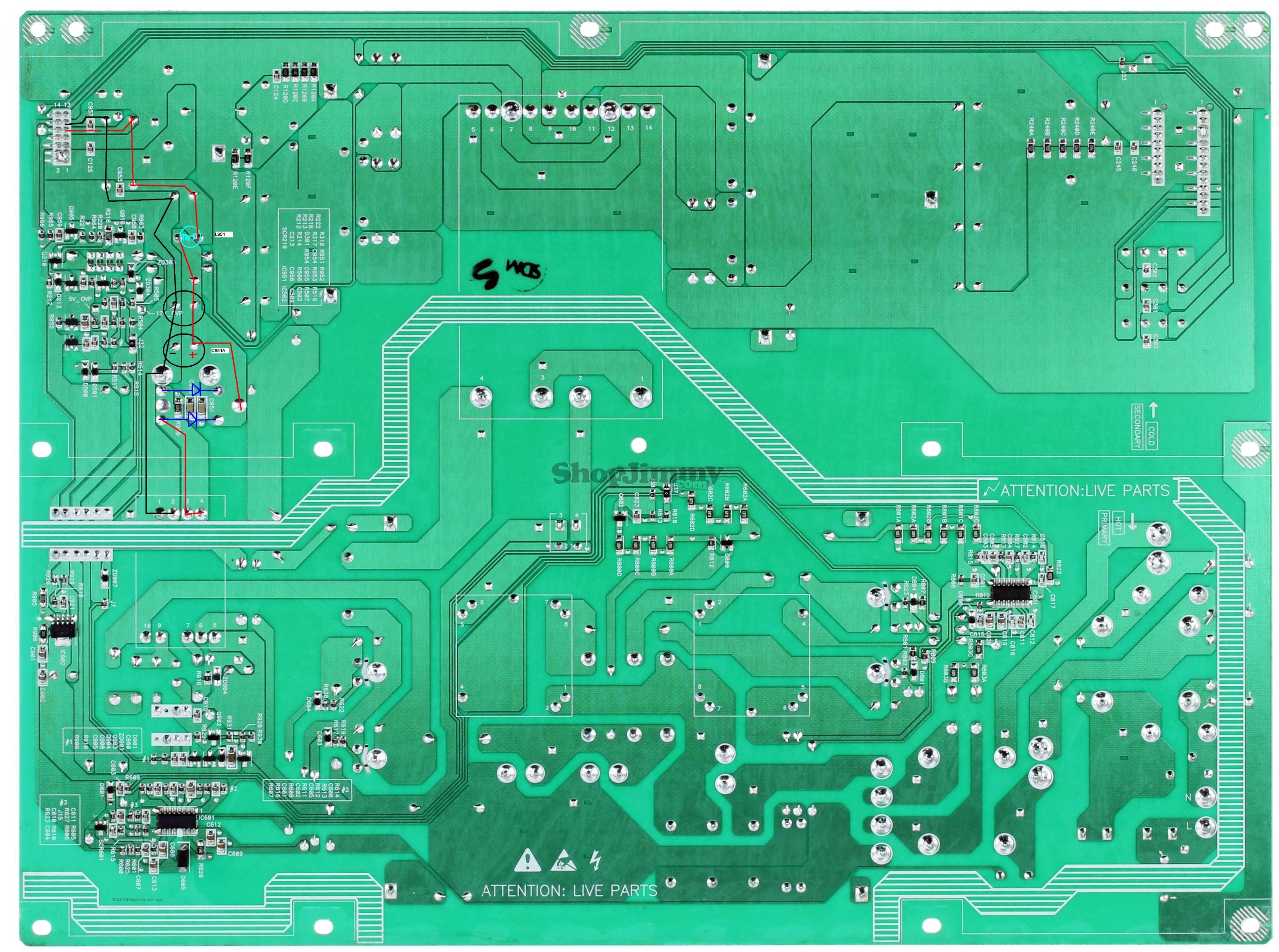

when i turn on, Philliips TV is not on

            Re: when i turn on, Philliips TV is not on
            IC 901 pin7 =14.91
            C915 = 14.91
            ZD904 = 14.91
            C912 = 14.92
            R916 = 14.92
            D906 cathode = 14.92
            D906 anode and T901 pin 7 = 0
            Q904 (G), Q903 (G) and Q902 = 0.1
            PC901 pin4 = 2.83
            ZD907= 2.83
            C905= 2.84
            Q904(pin D)= 2.84

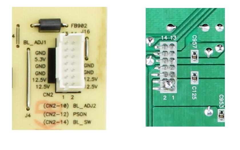

                      Thanks but before I do this step I measure the connector 2 (CN2). This is the reading I got.
                      CN2
                      Pin1 --》4.48
                      Pin2 --》4.48
                      Pin3 --》4.48
                      Pin4 --》4.48
                      Pin5 --》4.48
                      Pin6 --》4.48
                      Pin7 --》4.48
                      Pin8 --》4.48
                      Pin9 --》4.48
                      Pin10 --》0
                      Pin11 --》0
                      Pin12 --》4.46
                      Pin13 --》0
                      Pin14 --》0
                      Is this normal?

                        What do YOU think? Pins 5,6,7,8 are GROUND. what are you using for your meter ground? Or you must be counting the pins wrong.

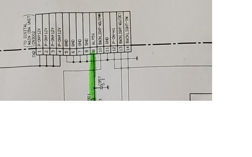

                            The schematic does'nt match the board. That supply seems to be using CN2 pin 11 for ground, and pin 9 is the AL+5v positive.
                            The +12.5 volts uses pins 1,2,3,4 for positive and pins 5,6,7,8 for ground

                                • 124
                                #35
                                I do not know which schematic you are talking about. The one I attached match.
                                  Then explain how you measure 4.48 volts on all the pins 1~9 (even ground) and yet pin 11 which according to the schematic is also ground, you measured 0 volts?
                                  Have a look at the bottom of the board and trace the grounds. C951 (negative) connects to pin 11, not pins 5,6,7,8

                                          #40
                                          LOOK AT THE BOTTOM OF YOUR BOARD. There is no connection to GROUND for the STANDBY 5.3 volts negative. CN2 PIN 11 is the ground for the the standby voltage NOT PINS 5,6,7,8
                                          CN2 pins 5,6,7,8 are the ground for the 12.5 volts which is on pins 1,2,3,4 To check the 12.5 volts measure ACROSS C120B
