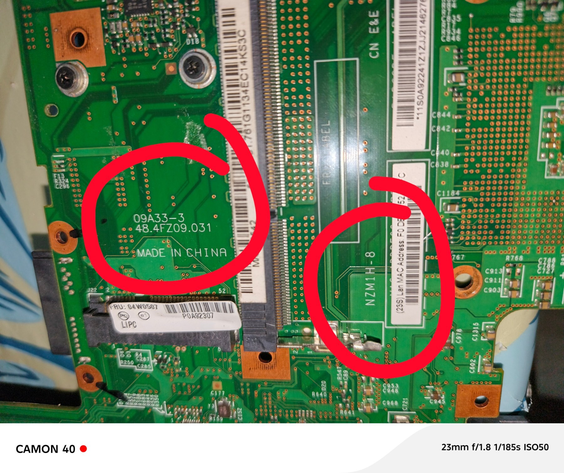

    DEVICE: Laptop
    Model: lenovo thiinkpad t410
    Board Id: 09A33-3 48.4FZ09.031
    NZM1H-8

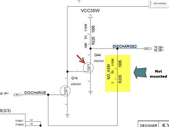

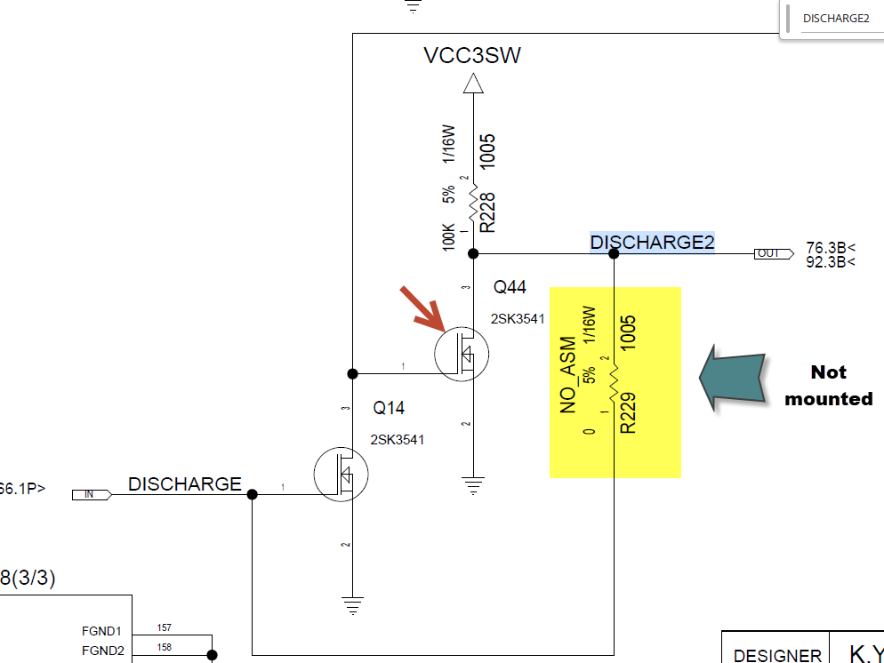

            We are reviewing DISCHARGE2 netname. See attached.
            Flux and remove Q44 and keep it separate from the othe removed part. After removal, is the resistance to ground on DISCHARGE2 line still a low resistance?
            • kalilinux25
              • Mar 2018
              • 2089
              • ZAMBOANGA SIBUGAY

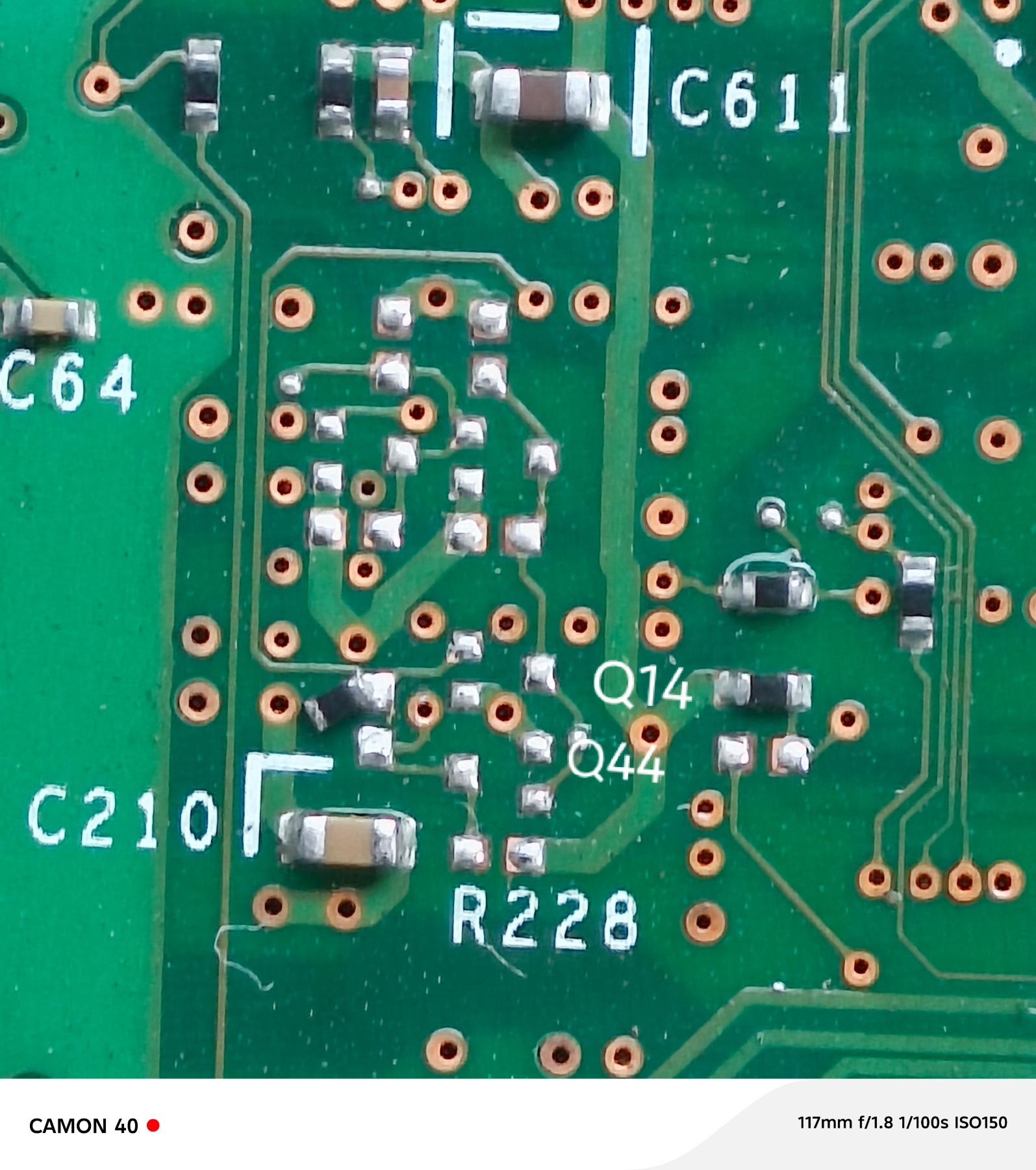

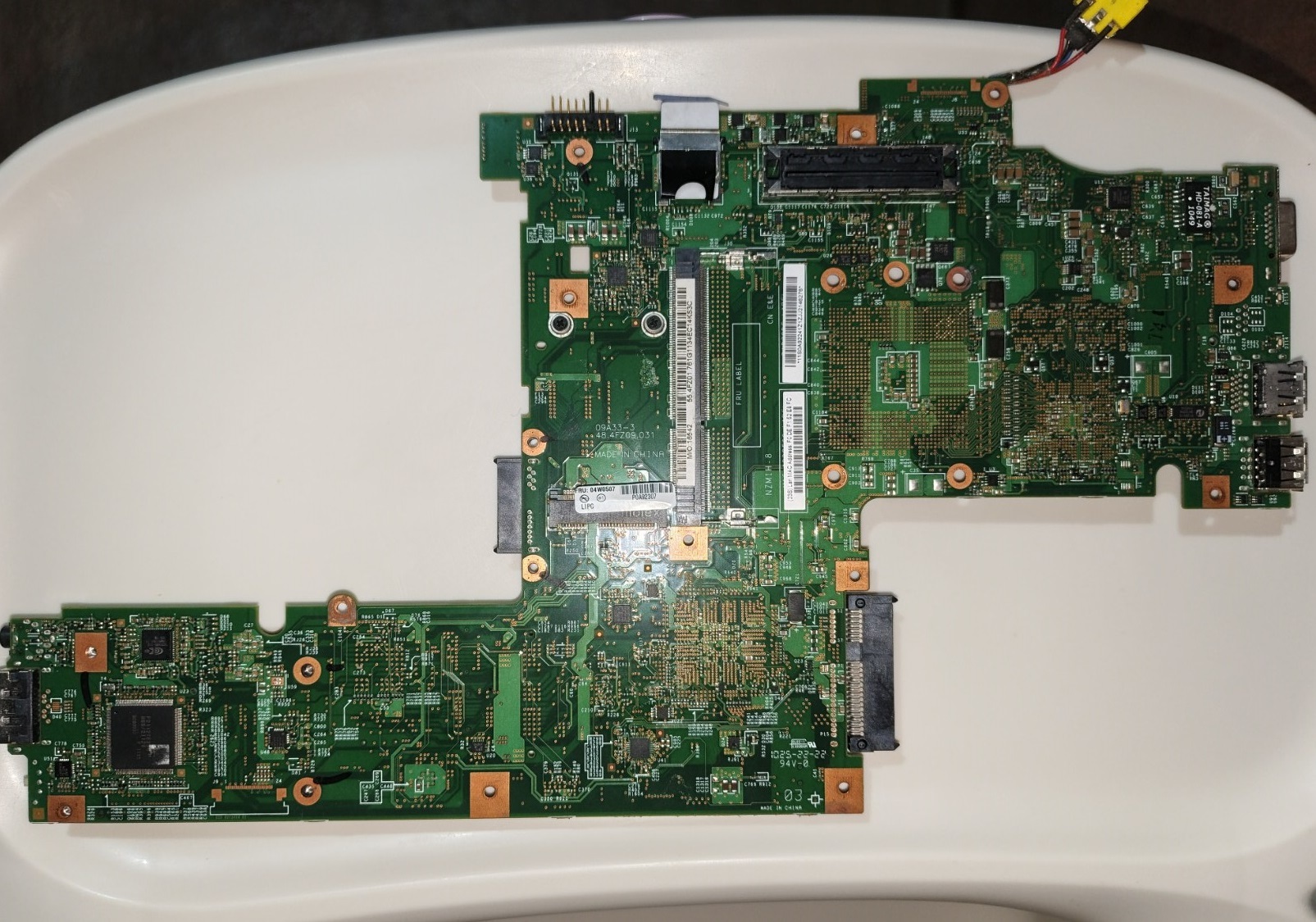

              Q14 and Q44 and R228 is not present on board ONLY the R229 and C210
              • mon2
                • Dec 2019
                • 14673

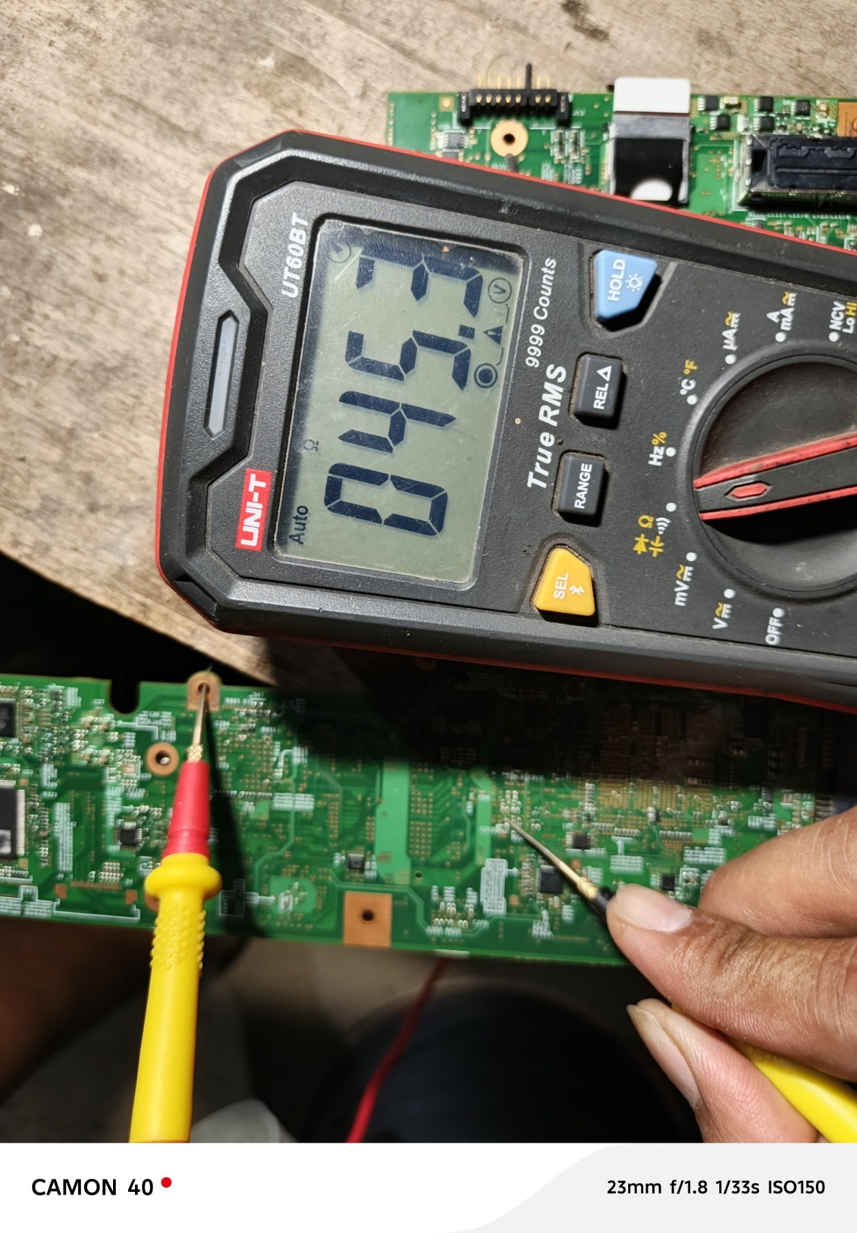

                Post a pic of the meter face while measuring this short condition.
                • kalilinux25
                  • Mar 2018
                  • 2089
                  • ZAMBOANGA SIBUGAY
                  DISCHARGE2 -has 45.3 ohms but if I remove the R229 im having 45.3 ohms in DISCHARGE line. Click image for larger version

                    According to the schematics, R229 is marked with 'NO ASM' so it is not stuffed. Measure the resistance across this part you suspect to be R229.
                    • kalilinux25
                      • Mar 2018
                      • 2089
                      • ZAMBOANGA SIBUGAY
                      it measure 0hms if i measure resistance to gnd im having 0.45 ohms also

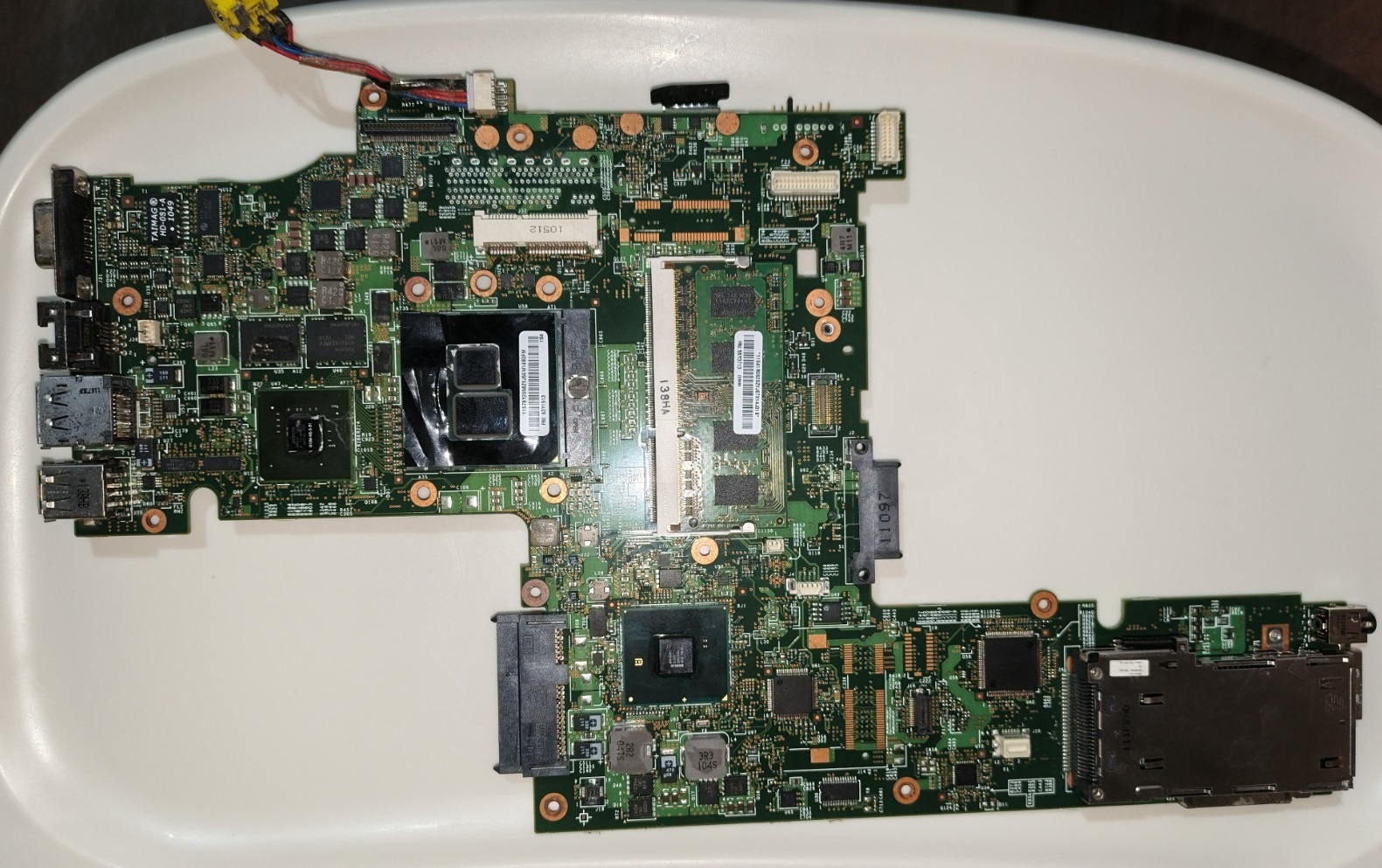

                        i thi the boardview has some missing parts also like there is no GPU chip present on the board view and the schematic is for NZM1H-0 not NZM1H-8
                        • kalilinux25
                          • Mar 2018
                          • 2089
                          • ZAMBOANGA SIBUGAY
ID:	3682061Ill just upload it here
                          • mon2
                            • Dec 2019
                            • 14673

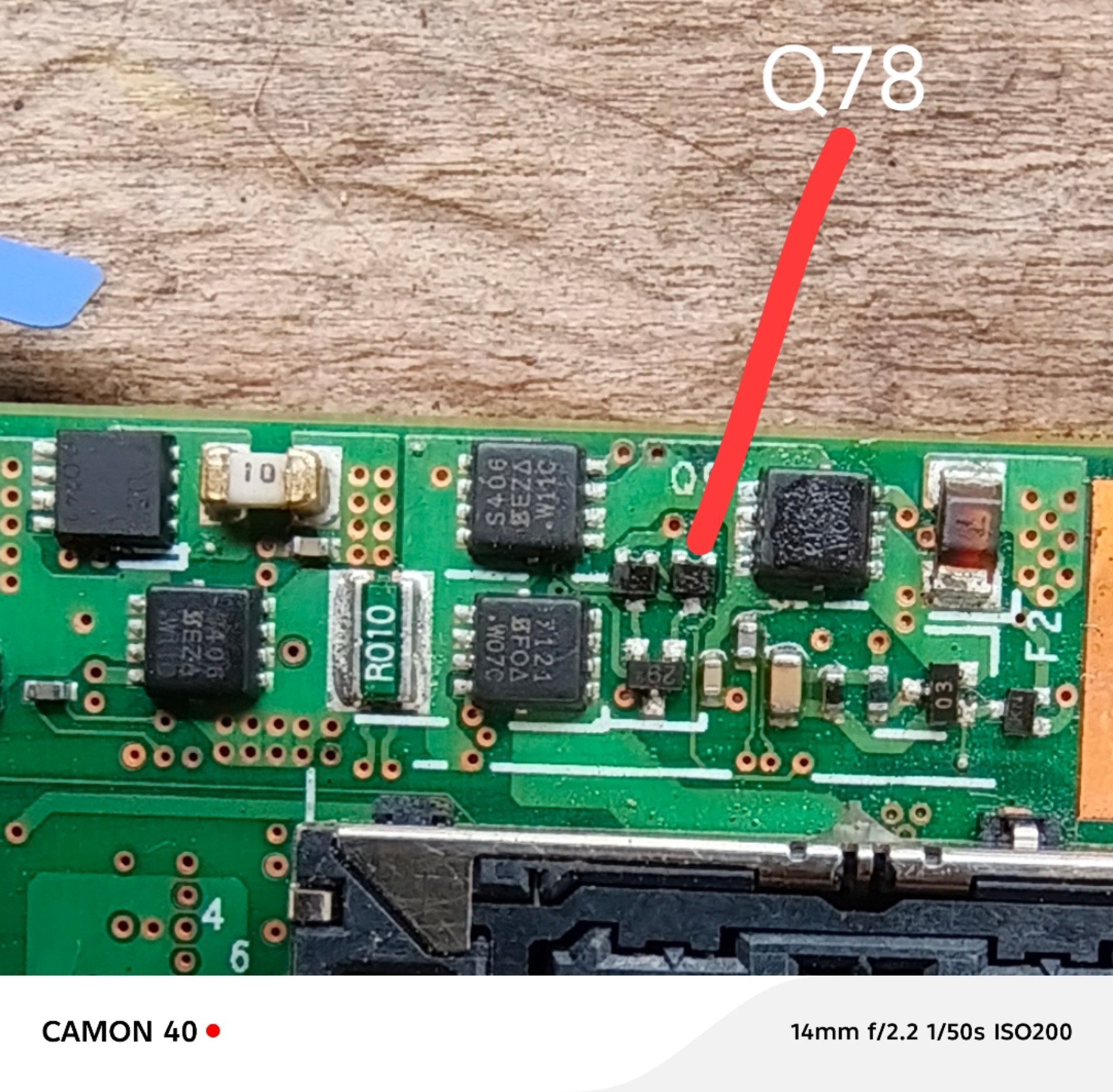

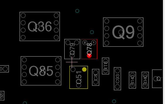

                            Is there a Q78 onboard? If yes, flux and remove it and measure again.
                            • kalilinux25
                              • Mar 2018
                              • 2089
                              • ZAMBOANGA SIBUGAY
                              Yes there is Q78 after removing it checking the resistance to ground to the DISCHARGE it still gives me 45.3 ohmsClick image for larger version
