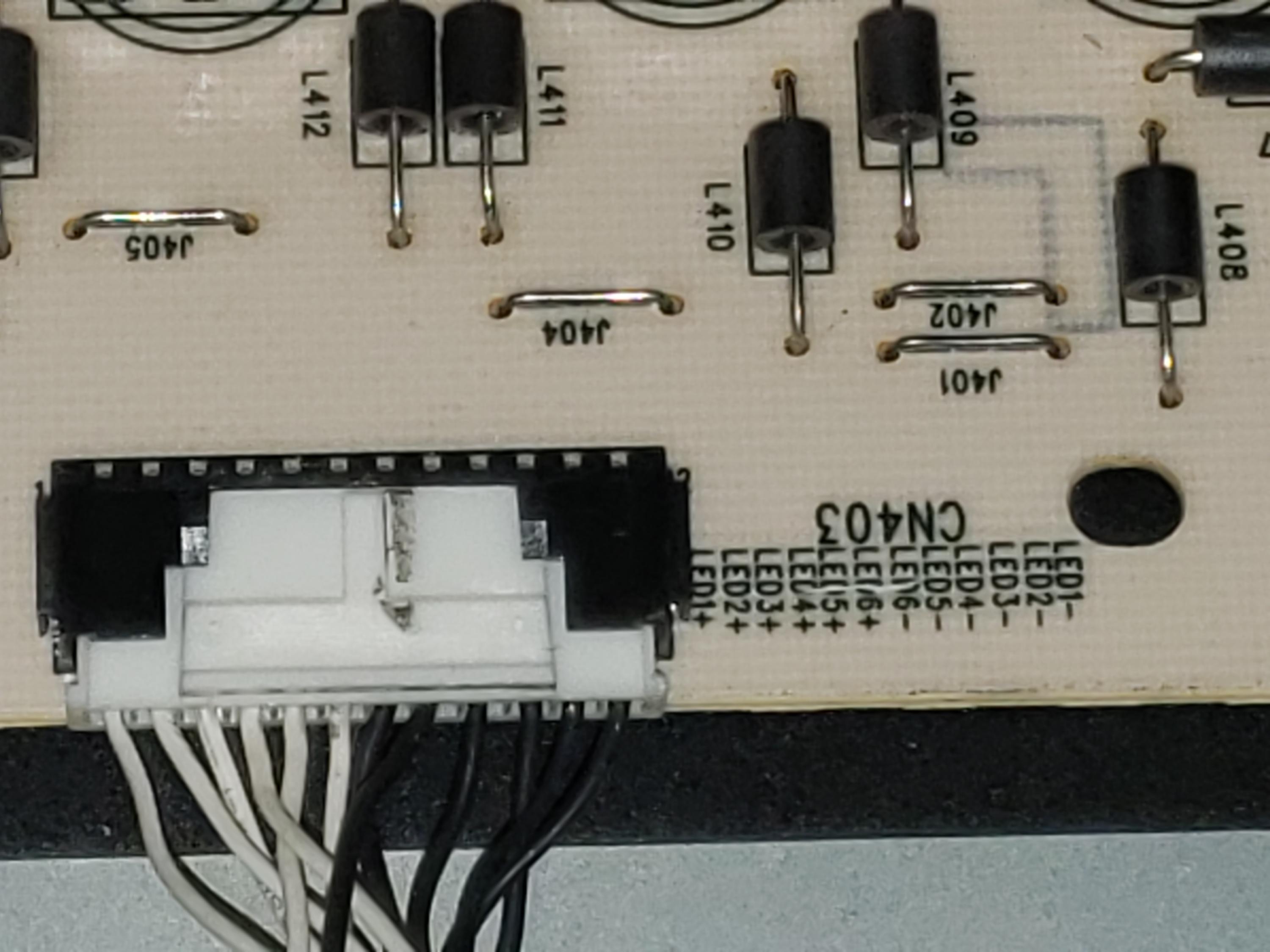

            Is that meaning string LED5 has defect? I'm measuring on the back of the connector (Side that is directly connected to LED strips so no connector "connectivity issue" it seems

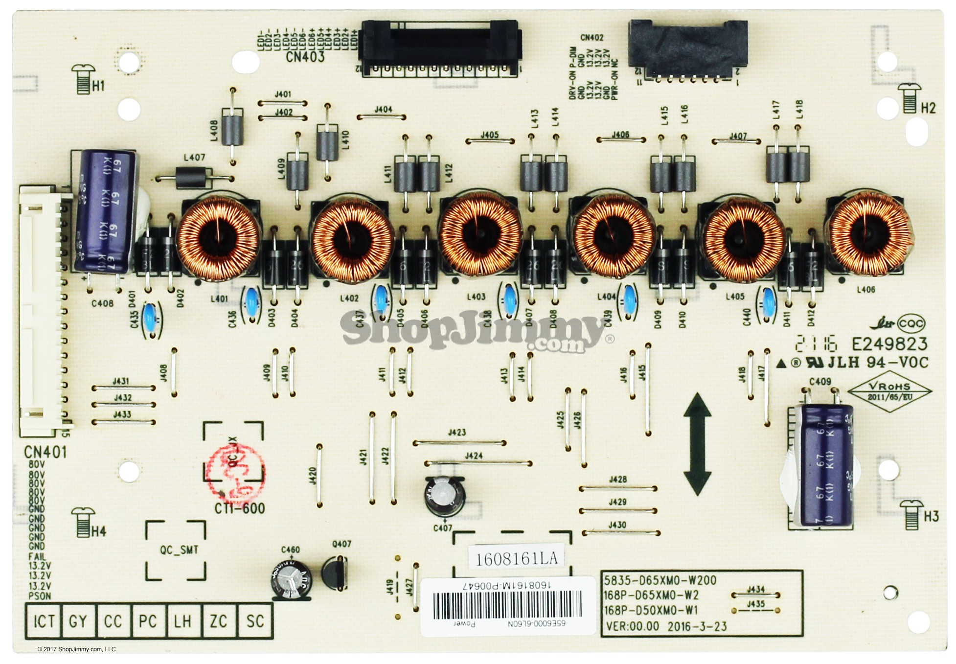

                  So this TV has 24 strips, each with 5, 3-V LEDs. There are 6 supplies on the LED Driver board, so each supply should be providing at least 60 V Differential for the Strips to turn on (I'm assuming each supply is driving 4 strips = 20 LEDs)
                  The fact that I'm getting only ~40V differential tells me the LED driver is not doing its job?? Am I on the right track?
                  Is there another control signal that tells the LED Driver to turn on other than the STB that's going to the power supply? Or is the Power supply turning the LED driver board on by simply turning on the 80V rails (From 60 to 88?) I see PWR_ON and DRV_ON on the Driver LED coming from Main board.
                  Just trying to determine if this is a LED Driver board issue or still a power supply issue and I simply got a bad power supply this time too (2 bad supply boards)

                    Swap LED1+ and LED1- with LED5+ and LED5- and see if the slightly different voltage reading moves.

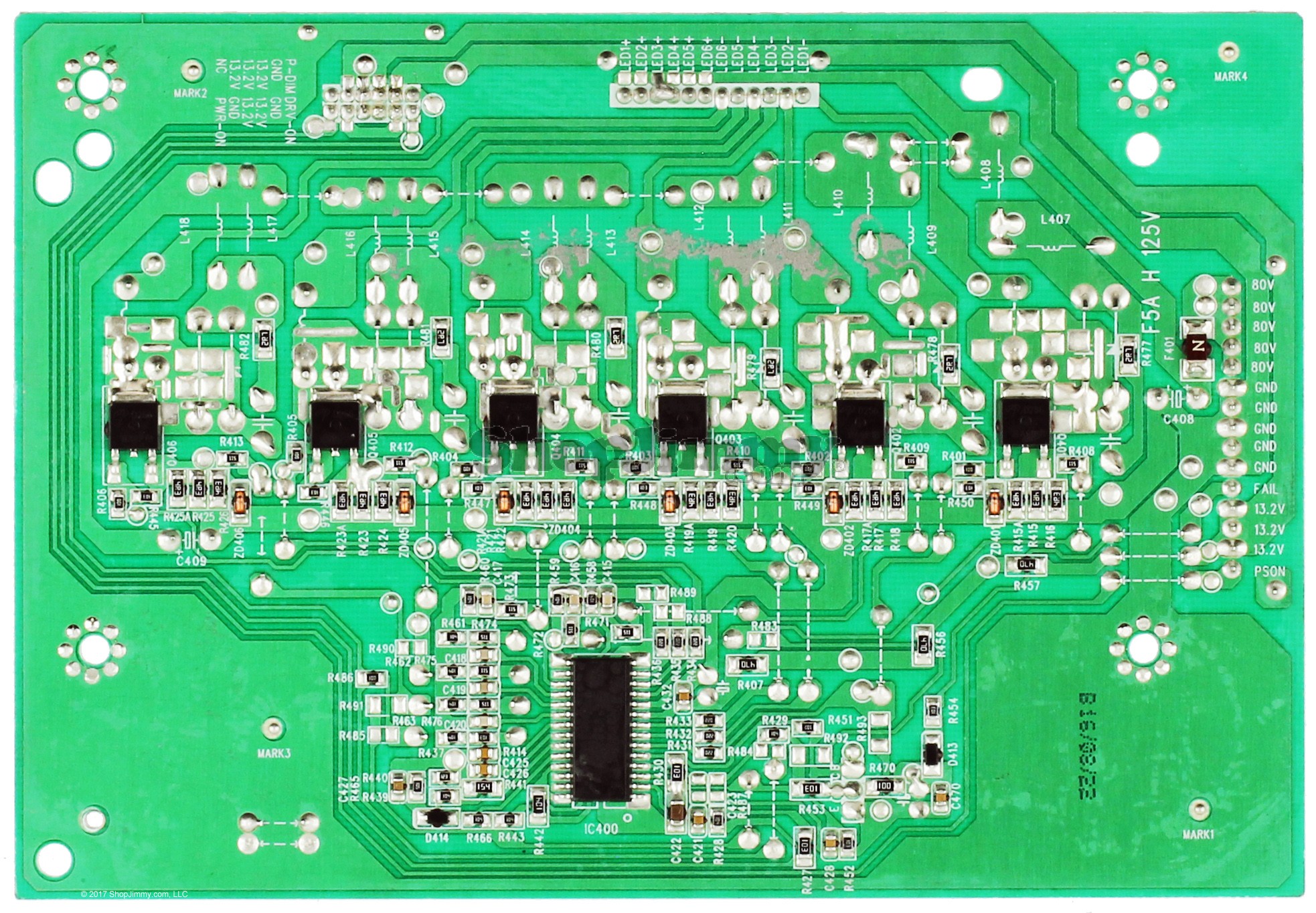

                      Ok, further measrement on the LED Driver board yielded something intersting:
                      The PWR-ON (pin 1 on CN402) has 3.45 V when I turn TV ON. DRV-ON (Pin 11) however has only 1.5 V. Momentary contact between these 2 pins (Pin 1 and Pin 11) turns the Backlight on and keeps it on.
                        #51
                        Re: LG 65UH5500-UA Backlight flash on first power up only
                        PWR-ON is the PS-ON for the power supply boar, the LED driver board is used for routing that signal to the power supply board, it is not used by the LED driver circuit.
                        For the backlights LED driver board to works it needs DRV-ON (BL-ON) and the P-DIM signal.
                        So you are able to force on the Backlights by using the PS-ON signal, at this point the image, sound, and all other function of the TV are OK?
                        What do you get at the P-DIM pin?
                        What is the Voltage reading between the two leg of cap C409?
                          P-DIM is pin 12 and is not accessible - I'll get a pair of sharper tip leads and report shortly.
                          C409 reads 88.x V
                          Traced DRV-ON back to the motherboard - seems something has changed, either resistors changed value from nominal (not labeled - 603 package) or leakage in the path is higher, but the main board generates 3.3 V, but after resistor networks by the time it gets to the LED Driver Pin 2 of OZ9906 (Chip Enable) it's down to 1.5 V - not sufficient "ON" logic.. given that I don't have 603 resistors and I can't see the darn things anyway, I replaced one of the series resistors (there are several between the main board and the LED Driver) with a blob of solder and that did the trick.. so far so good.. LED Driver is seeing 2.9 V on the EN pin of the controller - Backlight comes on..
                          Now.. back to the weird problem that appeared on 2 power supply boards - why are the large caps seeing 385V always... PFC not operational on 2 boards ??? very odd

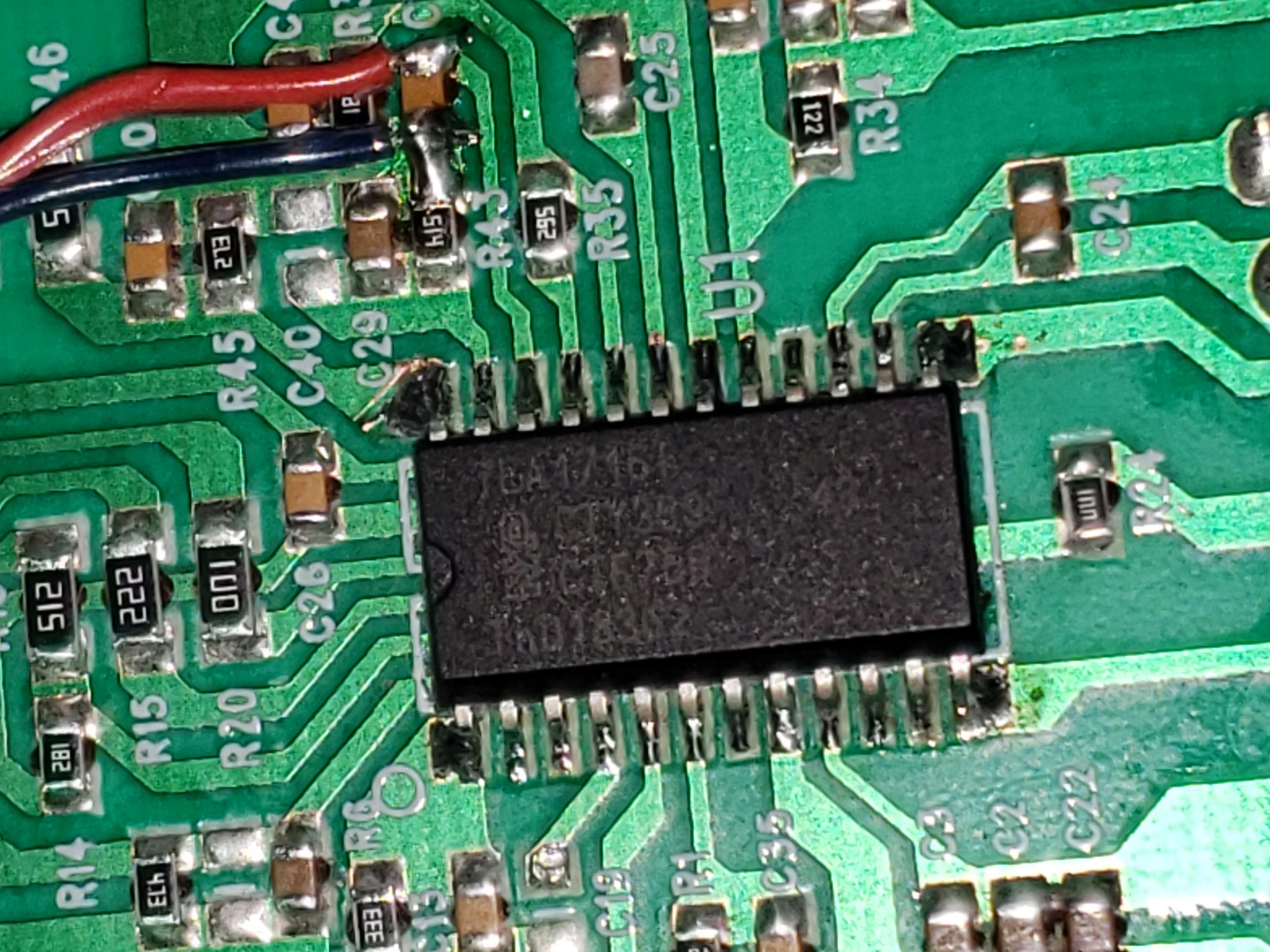

                                See spec sheet of the IC on the page that I pointed out to for what the Voltage should be on pin 22.
                                • jason123
                                  • Oct 2015
                                  • 1154
                                  #56

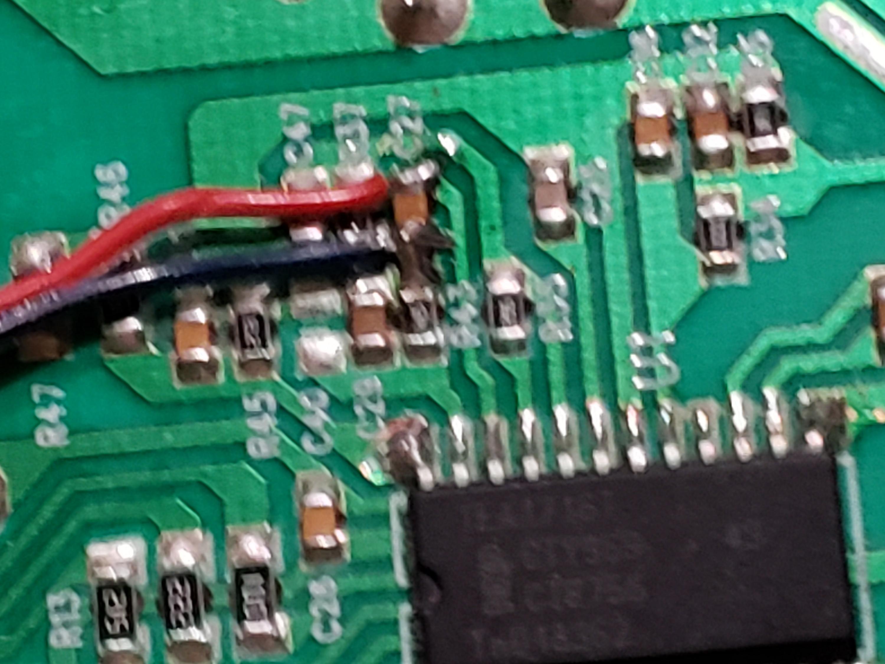

                                  So not the cleanest solder job...but pin 22 connects to cap then to hot gnd, so i soldered across the cap. Just measured again from pin 22 referenced to large cap gnd and same results.
                                  I see what you're referring to on page 34.. table 5 on page 32 lists range for that pin as -1.4 to 12 v..(abs max maybe)...used in a different mode? This pin doesn't seem to be driven by a voltage.. just has a cap to hot gnd?

                                      Both measurements are referenced to hot gnd. First reading was pin 22 references to the pad the capacitor is connected to, which is shorted to negative lead of large cap. Second measurement to confirm for you was pin22 referenced to negative lead of large cap.
                                      I tried continuity check between pin 22 and the traces exiting top and bottom of chip and there doesn't seem to be a connection
