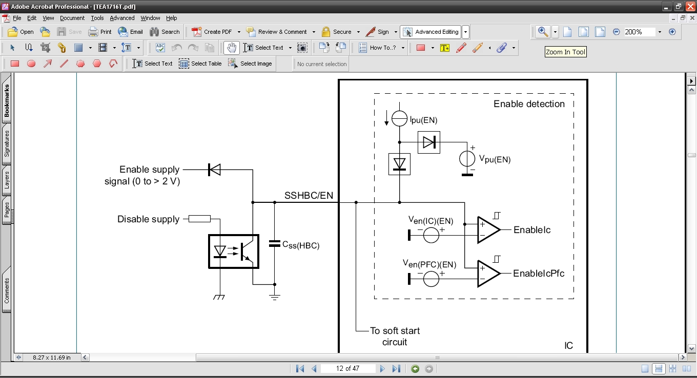

    #61
    Re: LG 65UH5500-UA Backlight flash on first power up only
    https://www.badcaps.net/forum/attach...1&d=1576726423
    1.2V = Enable PFC only
    2.2V = Enable PFC + HBC
    BTW, If that pin is connected to anything then it should not change state.
    • jason123
      • Oct 2015
      • 1154

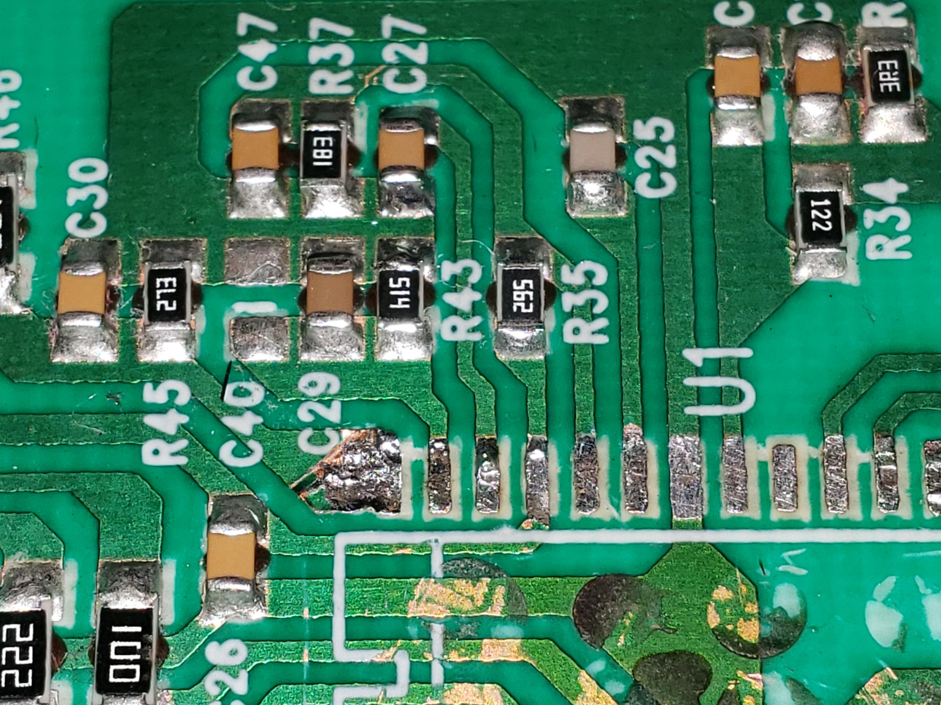

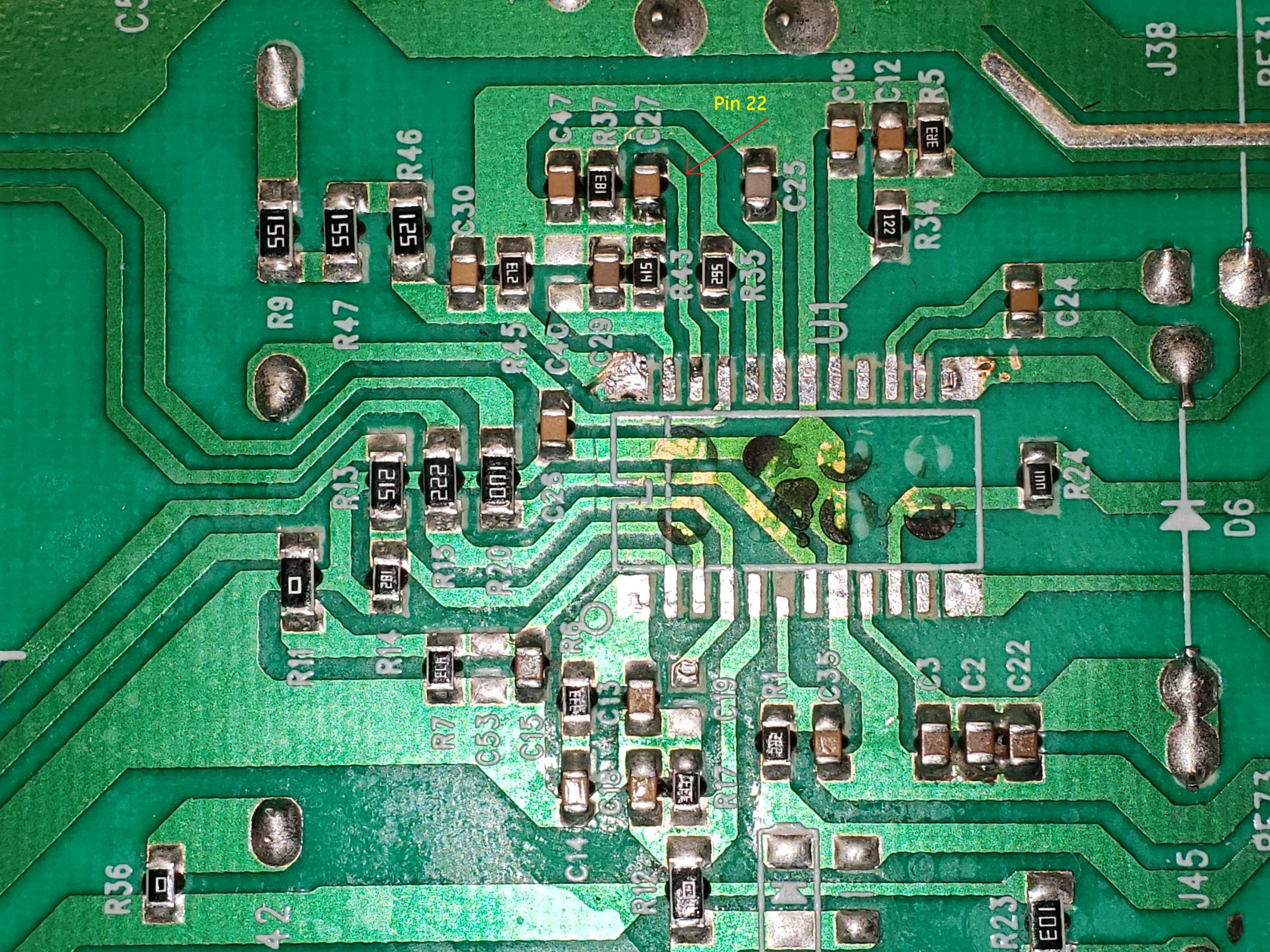

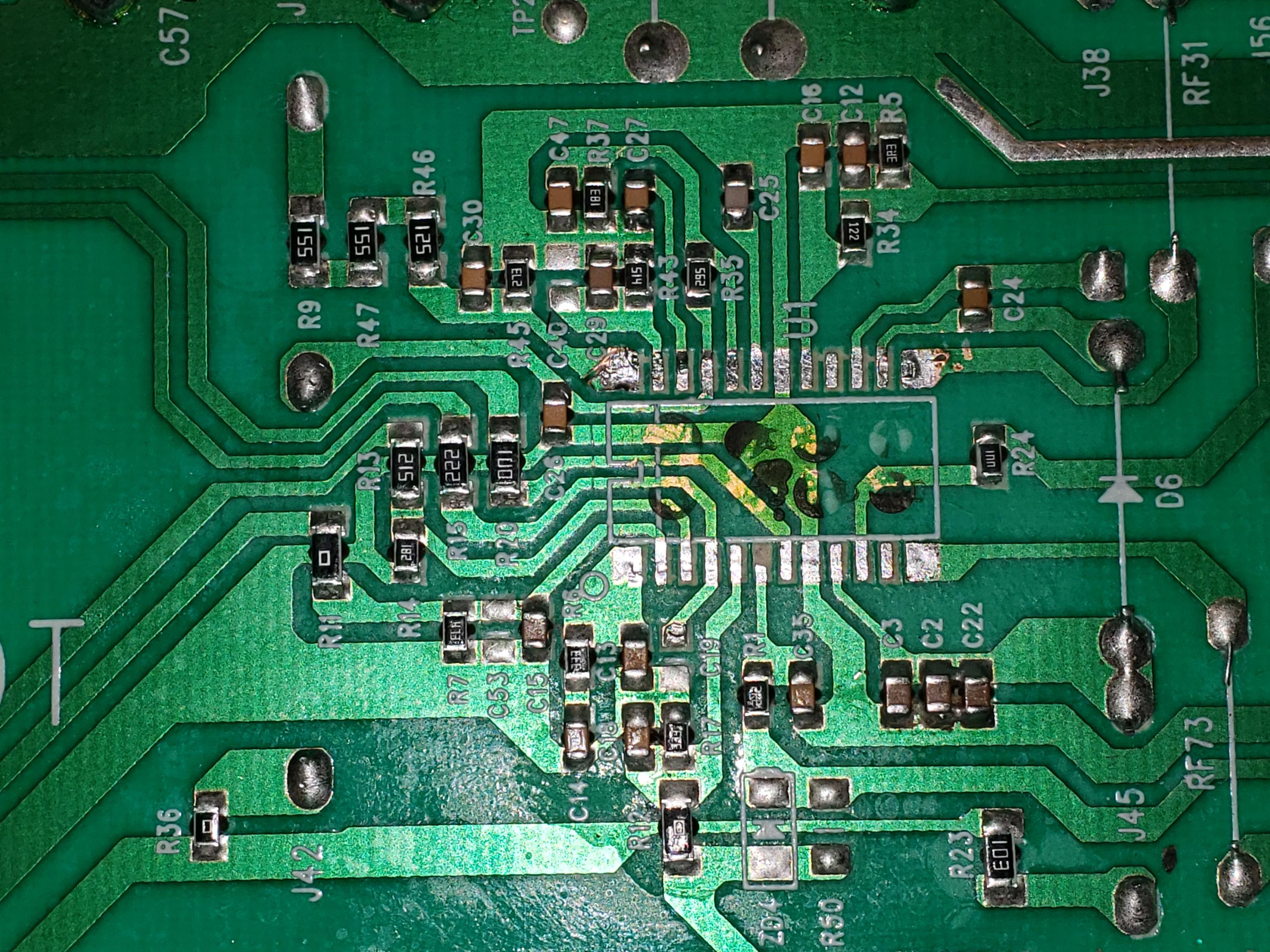

      #62
      So after several attempts at finding what else that pin 22 is connected to, I took the IC off the board again (hopefully no major damage!) and sure enough, that pin 22 (unless I'm counting incorrectly) is "ONLY" tied to that cap (Used for soft start mode only) - I don't see a way it's connected to an opto / enable function.
      What am I missing?
        #63
        OK, I read page 11 and 12, the IC has internal pull-up circuit for pin 22 to start the IC, you then pull it down when you want to disable the IC.
        So basically, this board the PFC/HBC are always running.
