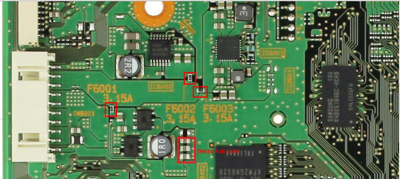

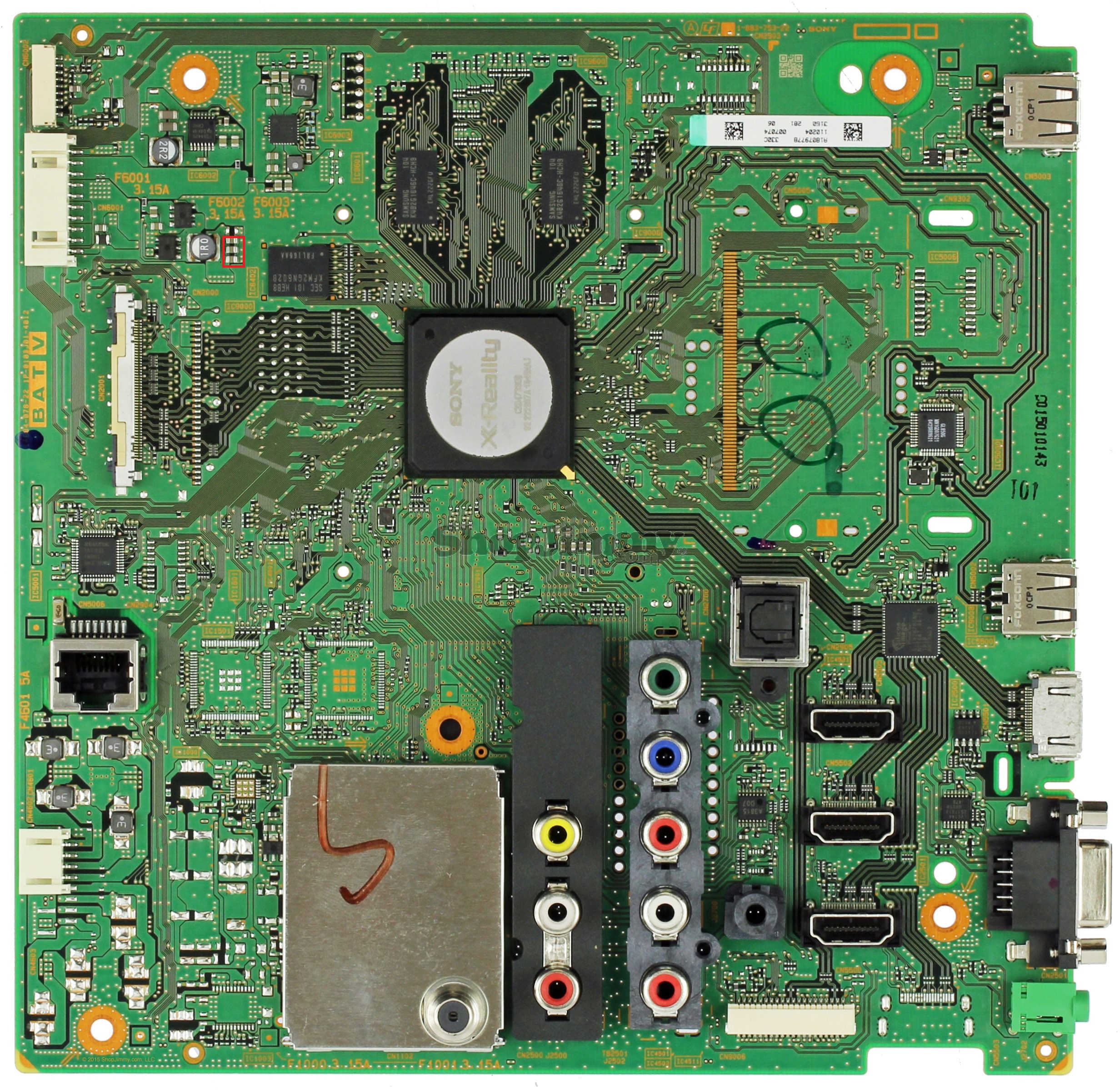

                Re: Sony KDL-46ex520
                https://assets.shopjimmy.com/media/c...78-b-top_1.jpg
                Did you check the fuses F6001, 002, 003 on that main board by the LVDS connector?
                I suspect F6001.
                                  Okay..just got home from work..I have put a red square around the 3 fuses in question.I wanted to make sure these are the 3 fuses in question.
                                  • neilc6
                                    • Nov 2015
                                    • 1550
                                    #37
                                    F6001 is below the silkscreen. F6002 and F6003 have arrows pointing to them.
                                      #38
                                      Those are caps.
                                      See the fuses as marked in the picture.
