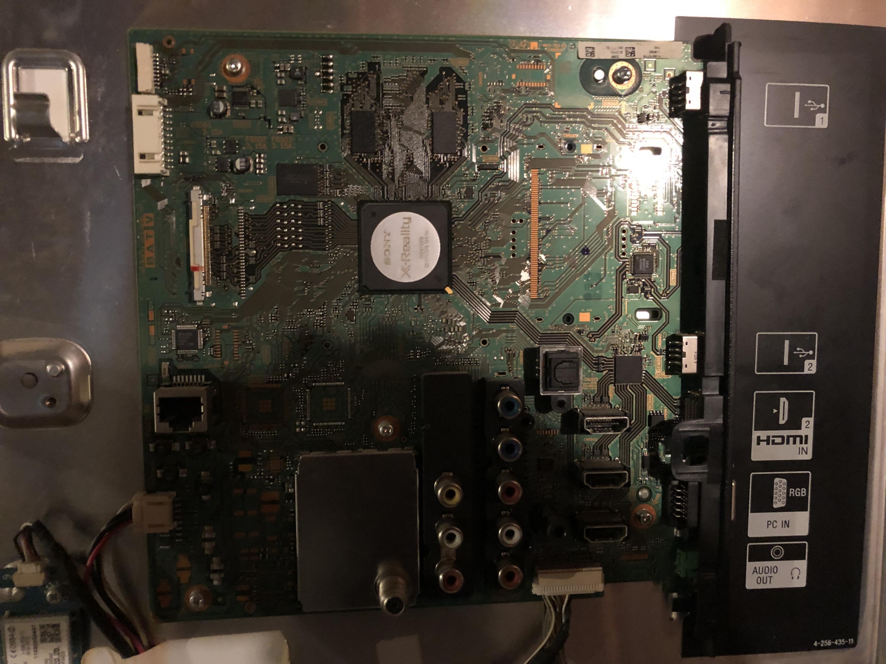

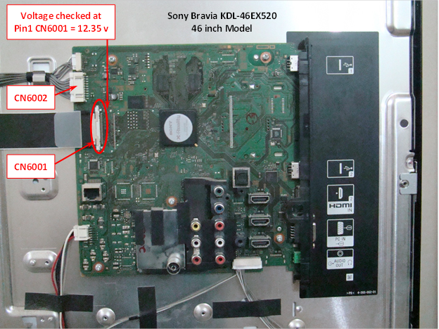

    Hello Everyone,
    I am new to the group and trying to figure out some voltages.I am in the
    process of troubleshooting a voltage issue.I am trying to figure out where a certain voltage comes from.In the picture that I have attached it shows 12.35 volts at pin 1 of CN6001.My question is,that voltage generated from the main
    board in the picture, or is it a direct voltage from my power supply board.
    If so, where can I check to see this voltage on my power supply board.Power
    supply board has no markings of voltage reference points. The tv I am working
    on has no 12.35 voltage at that test point.

    The 12V for the tcon is generated on the power supply board and switched through the main board. You should give a more general description of the problem you are trying to fix and pics of the entire back of the tv and power supply board. The 12V will pass through a fuse on the tcon that should also be checked. Sonys typically flash diagnostic blink codes if you count the number of blinks.

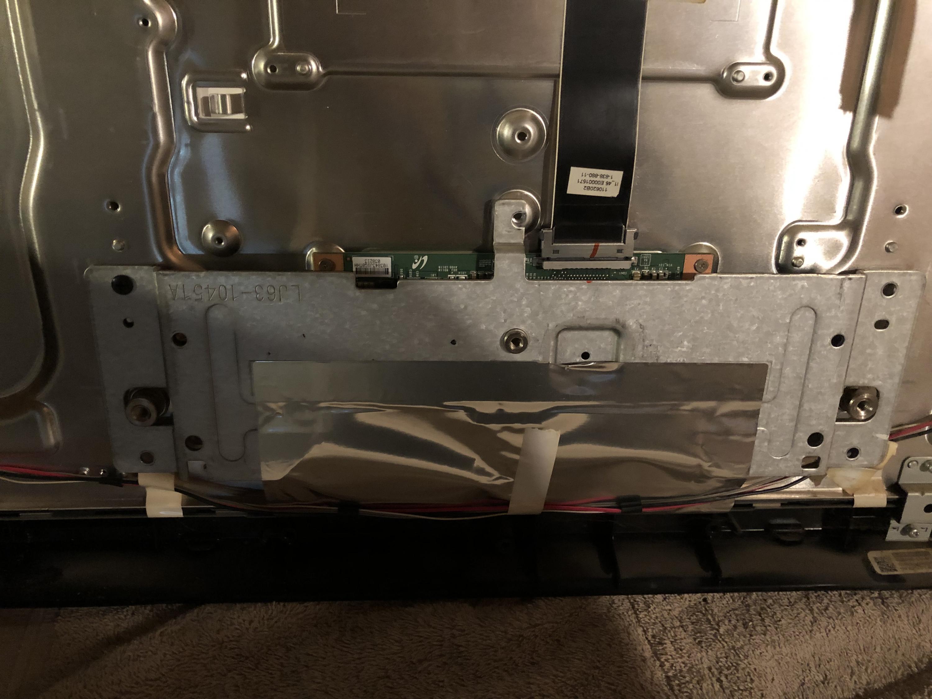

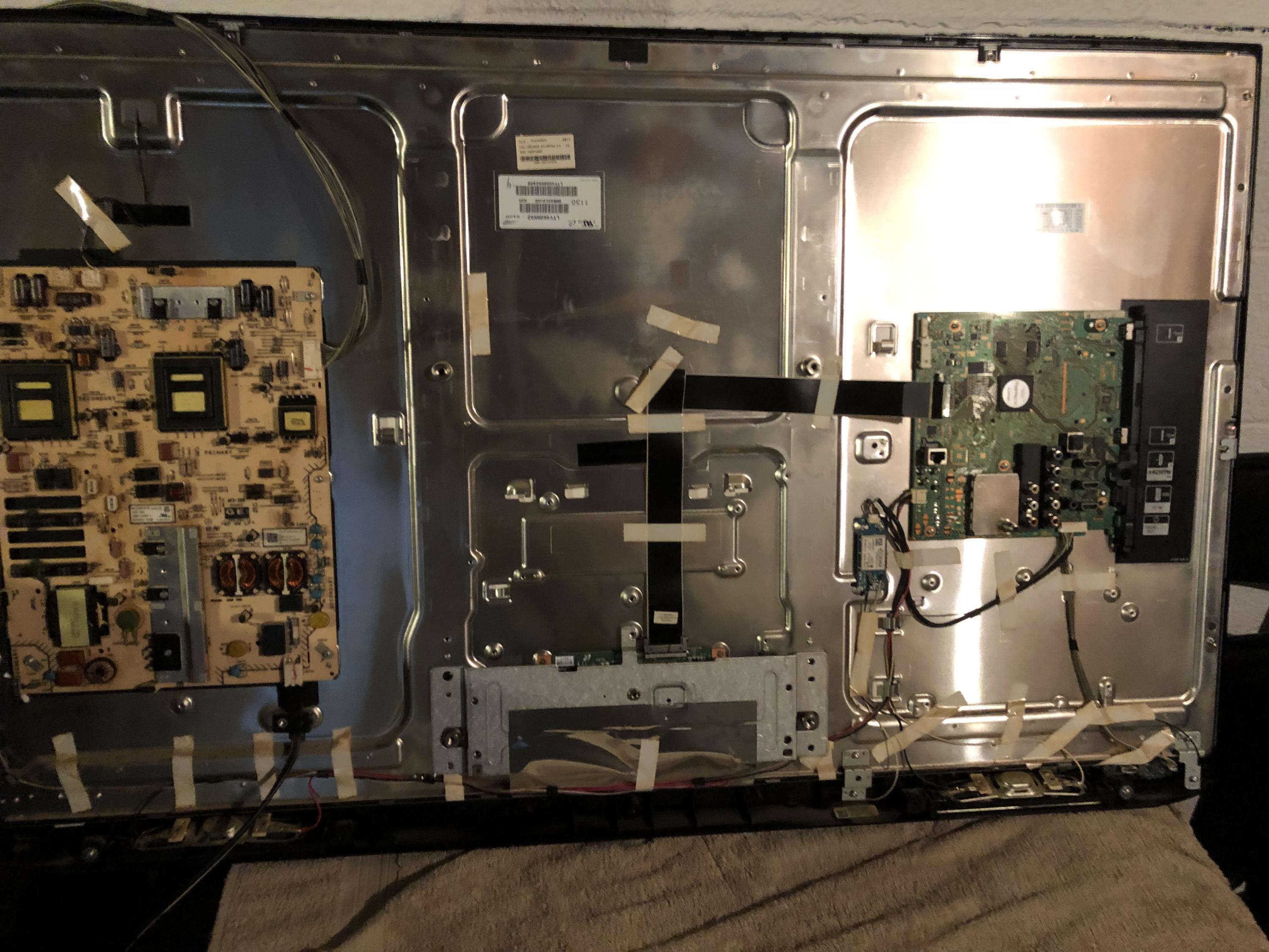

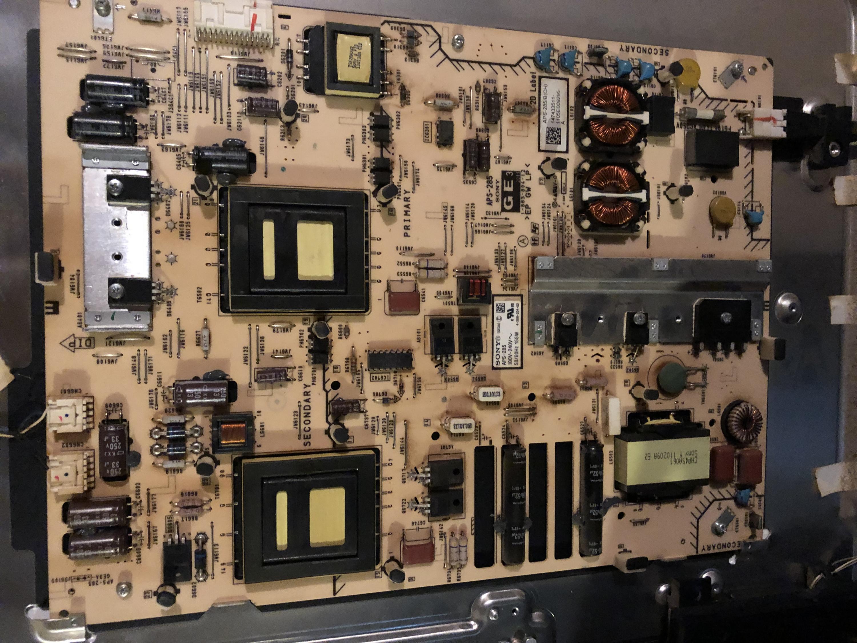

      Thanks for the reply.I have uploaded more pictures of the back showing the
      boards.Led blinks 5 times then loops again.As I mentioned in the first thread
      there is no 12 volts at that Pin..that 12 volts get sent to the T Con board.
      Since that is not present, thats why I am getting the 5 blinks.

                Ok, be CAREFUL on this test, with everything hooked up, it's testing the big filter capacitors on powerboard, looks like you have 3 of them, the ones that say 450 volt, KILLER voltage, with tv in standby meter on 600 dcv, negative probe on negative side positive probe on positive side, should get about 160 v in standby, then power up tv, should be about 400 v or a little less, only touch the capacitor legs with the meter probes, keep hands well away.
                • Global Safari
                  • Nov 2019
                  • 32
                  Re: Sony KDL-46ex520
                  I only have 2 on my board.In standby and power on, I get 393 vdc.
                  Scratching my head on this one.

                        Not sure, maybe check diodes D6602, D6603, D6604, so what's going on with the wire harness? do any of the connector ends look burnt, you can check it for continuity, just be careful not to expand the connector ends.

                                        Maybe take the powerboard out and check underside for bad/cold solder joints, sometimes they look ok but can be loose, look closely at anything on a heatsink and the transformer legs joints, they take the most abuse, be very CAREFUL not to touch the HOT parts, they can hold a BIG charge for quite a while.
