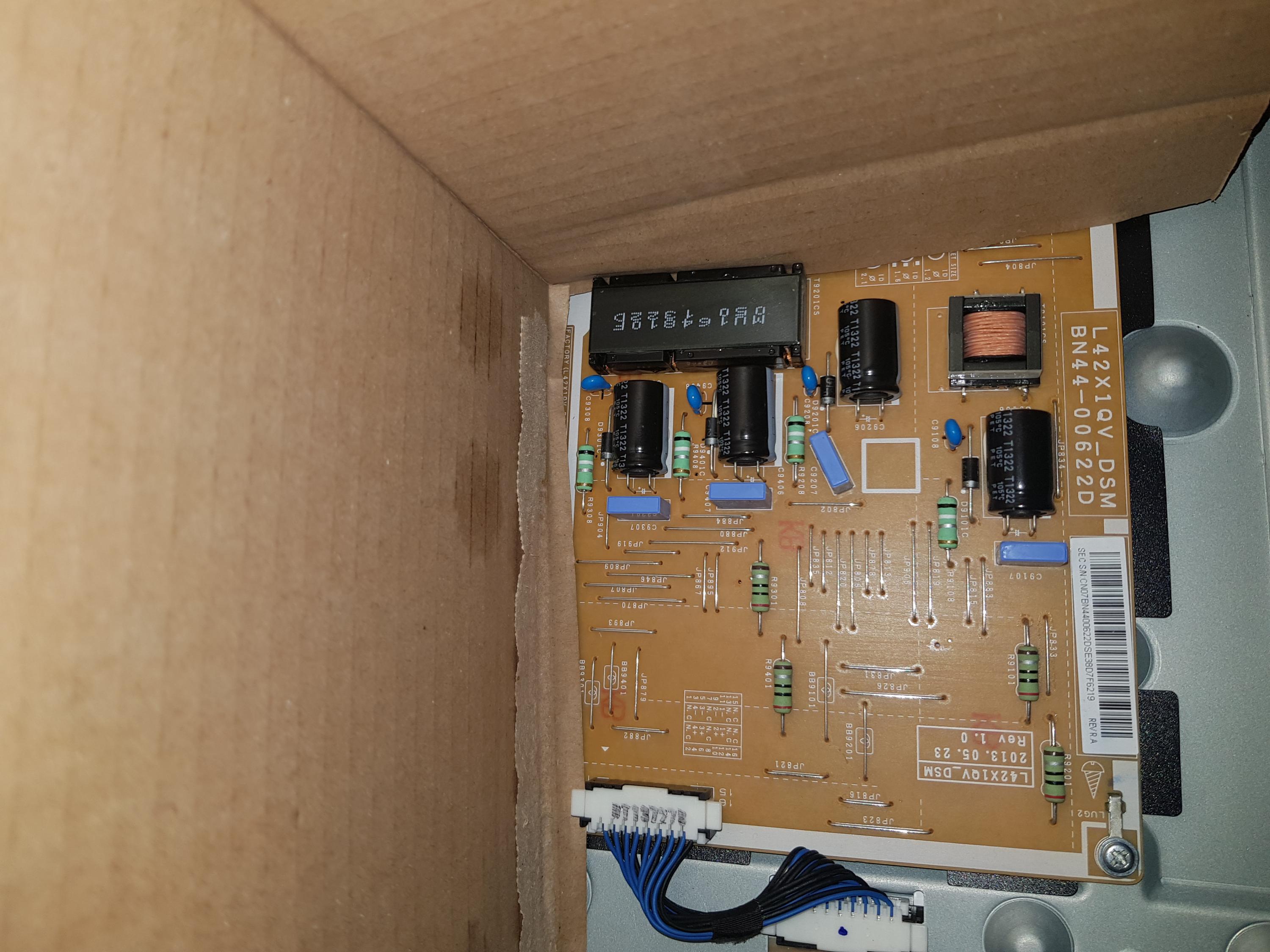

    If you disconnect the power supply from the main board and jumper A5V to PWR ON/OFF using a 1K resistor and switch on, does the B5V and B13 supplies come on.
    1k resistors came this morning, no difference to B5V and B13V when jumper A5 to pwr on/off, exact same result with or without resistor.
    Does it matter which way round resistor goes?

      With power cord unplugged, unplug cable from powerboard to mainboard, plug power cord back into powerboard, backlights should come on and stay on=powerboard selftest if backlights don't come on the problem is in powerboard or backlights which need to be fixed first before messing with mainboard which may be ok or not.
        Hi, Ive already unplugged main board and the backlights dont stay on, still just clicks and comes on for a second, then immediately off again, and repeats over and over.
        Even if nothing at all is plugged into the powerboard, except the mains power cable, it still clicks repeatedly.
        Would the whole powerboard need replaced, or just some capacitors etc?
        I have read that around the time this TV was produced Samsung were known for fitting undervalued capacitors??

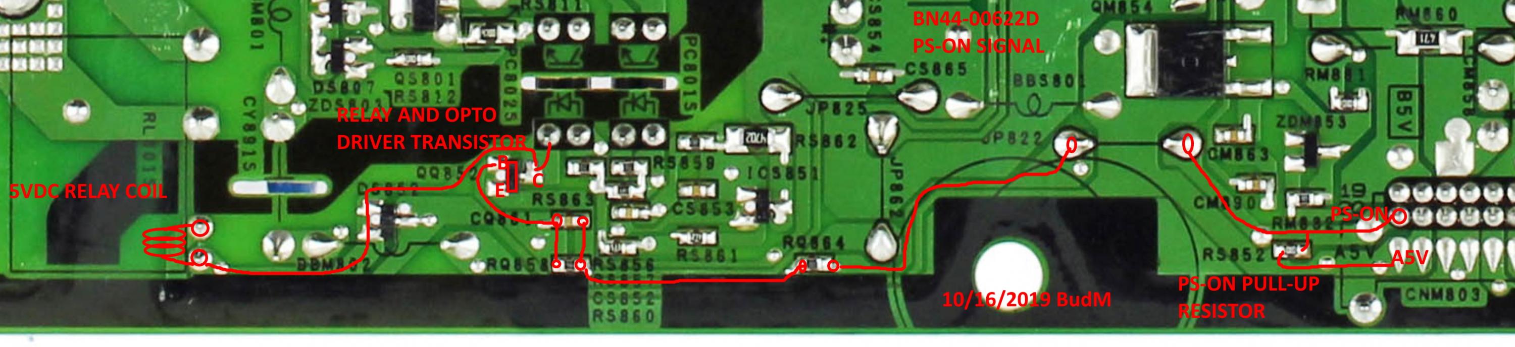

                Re: Samsung UE40F6320AK on / off boot loop problems
                PS-ON signal.
                So PS-ON is stable? I still think that for the PS-ON to be going and down, the A5V has to be going up and down also because the PS-ON pull-up resistor is connected directly to the A5V as shown in the picture.

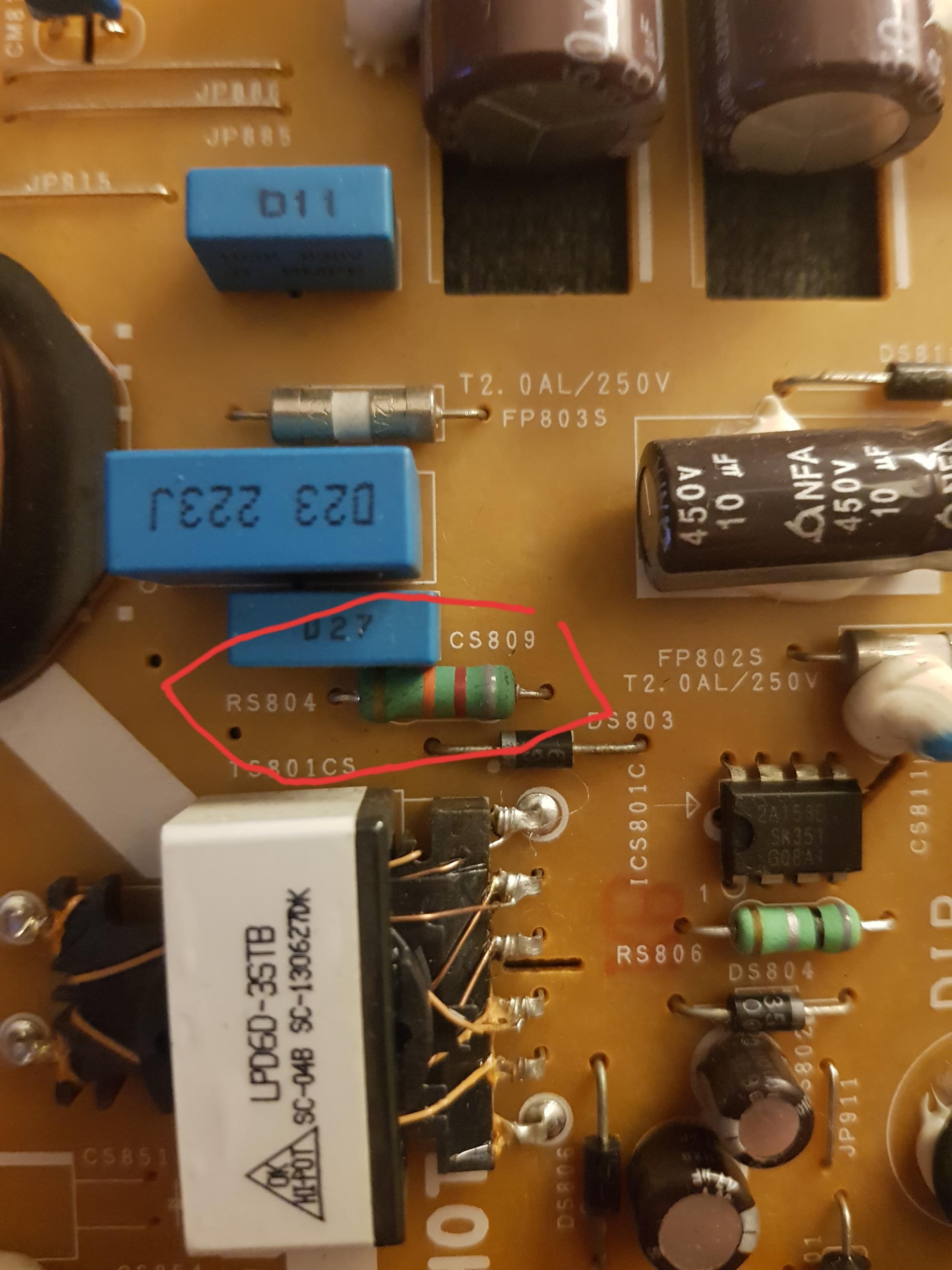

                  Hmm, now maybe try narrow down the area heated to when it comes on, thinking its a bad cap, maybe heat the electro caps small section at a time see if it comes on then the blue ceramic. Could test the caps it's hard to know the esr tho without an esr meter.

                    I would try just heating up the standby power supply section and see especially around those two lytics caps, https://www.badcaps.net/forum/attach...3&d=1571254351

                      Is that the right picture Bud it's a resistor circled?
                        #31
                        This OP picture? https://www.badcaps.net/forum/attach...3&d=1571254351

                          Ok, I see, you mean he should start in that area.

                                That resistor is 82K Ohms, it is for the RC snubber network for that standby power supply section, I just do not understand why people will use diode mode to test resistor.
                                  Wasnt testing them as such, but as I was there testing the diodes, I thought id see what happened if I tried on the resistors

                                    It would appear, that heating this section is what allows it to start
                                          Can I see good clear hi-res of the whole bottom side of your power supply board?
